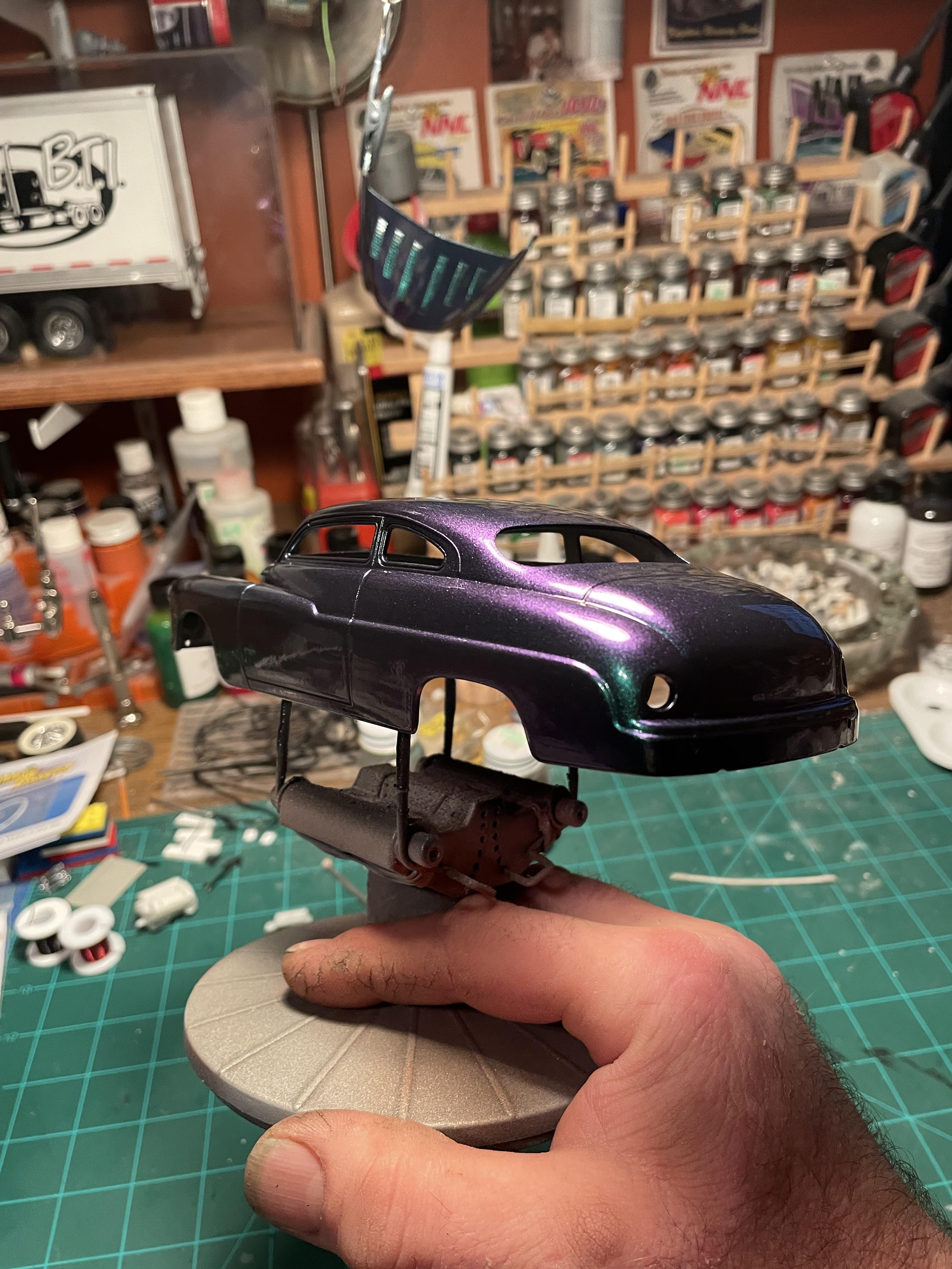

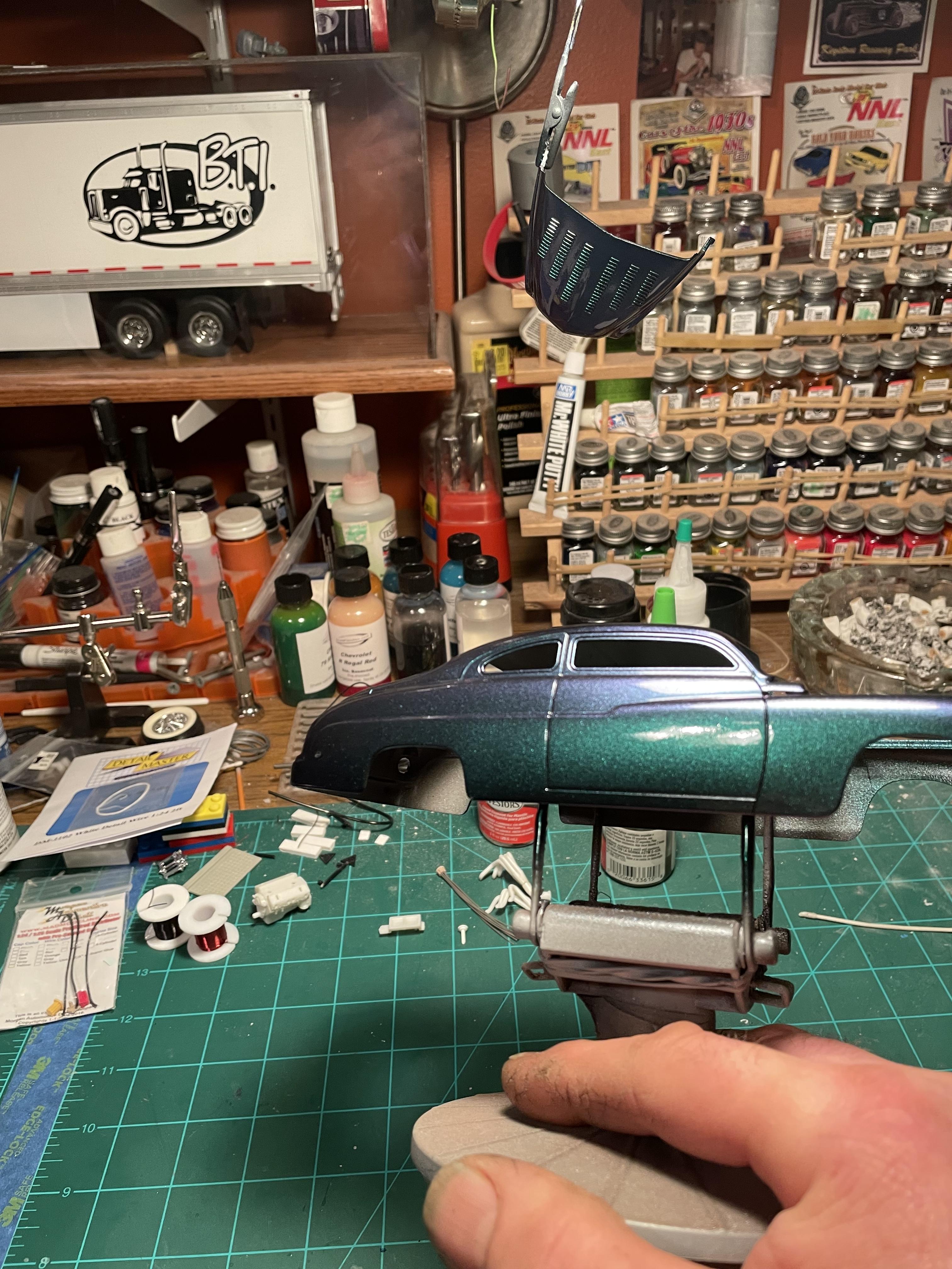

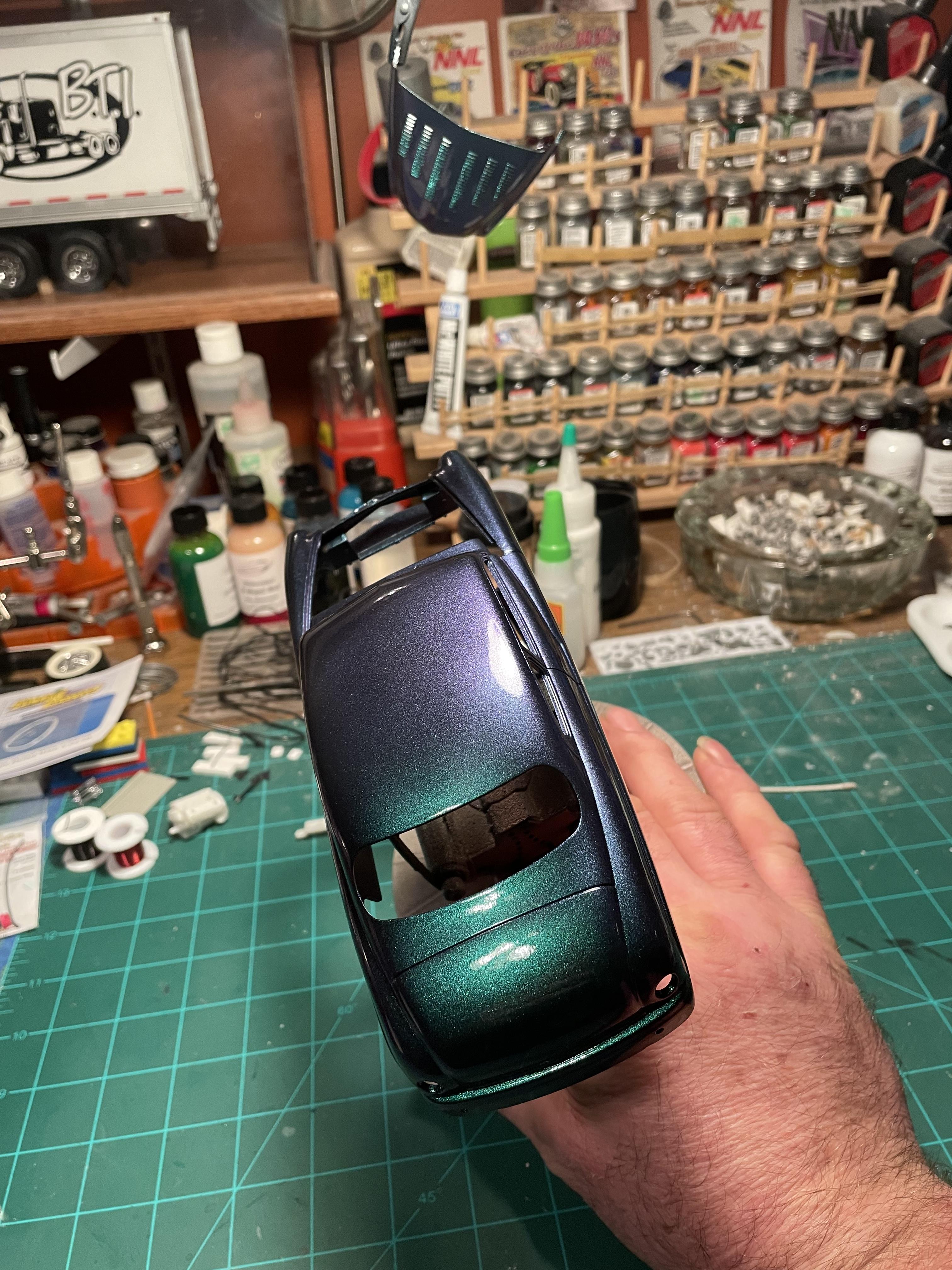

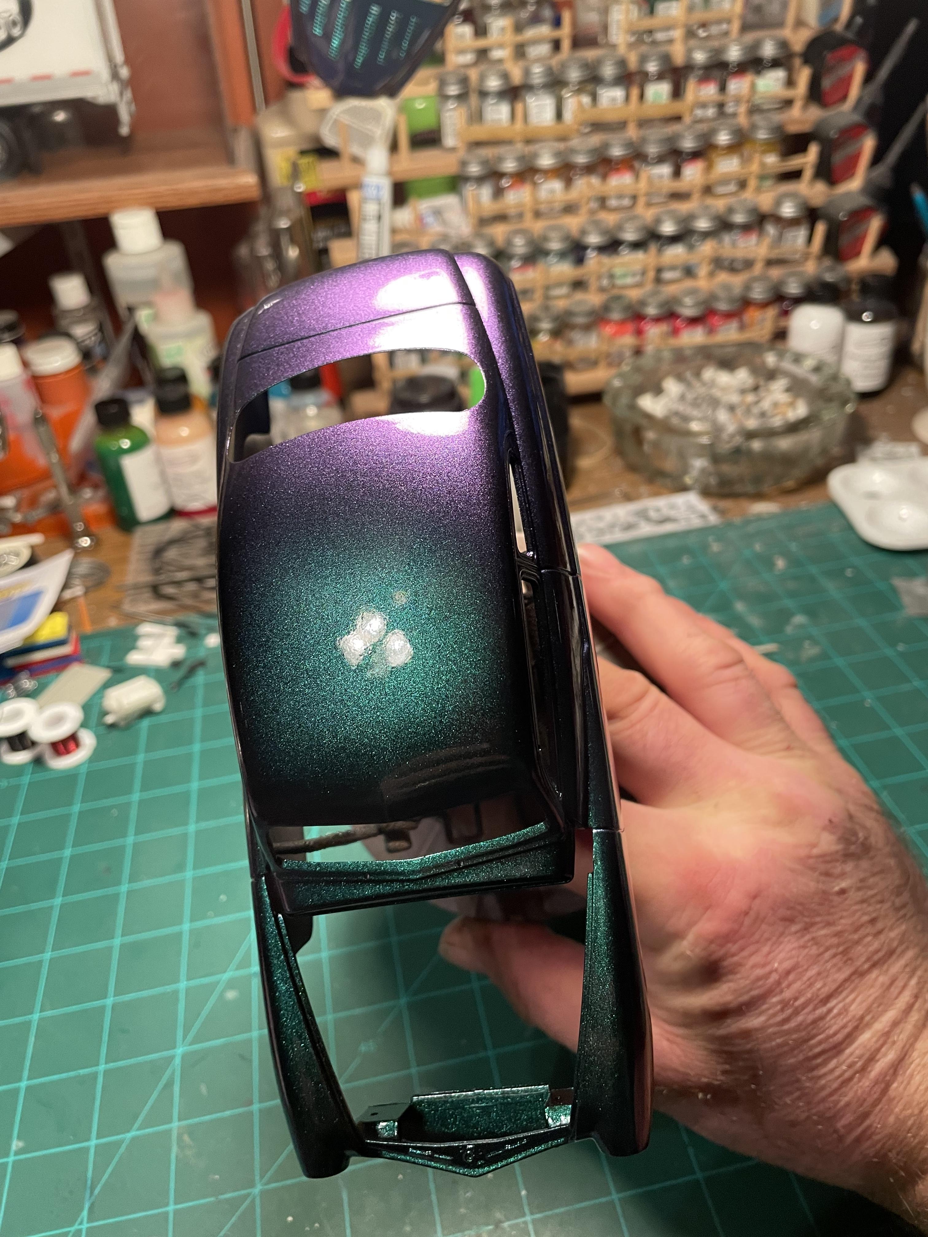

I did a mercury body a couple weeks ago with the colorshift paint from scale finishes, iwata neo with a  .35 needle, 20-30 psi, painted it as I would with a spray can, came out pretty good. I just used the same technique as my spray bomb jobs. I used Tamiya ts-13 clear
