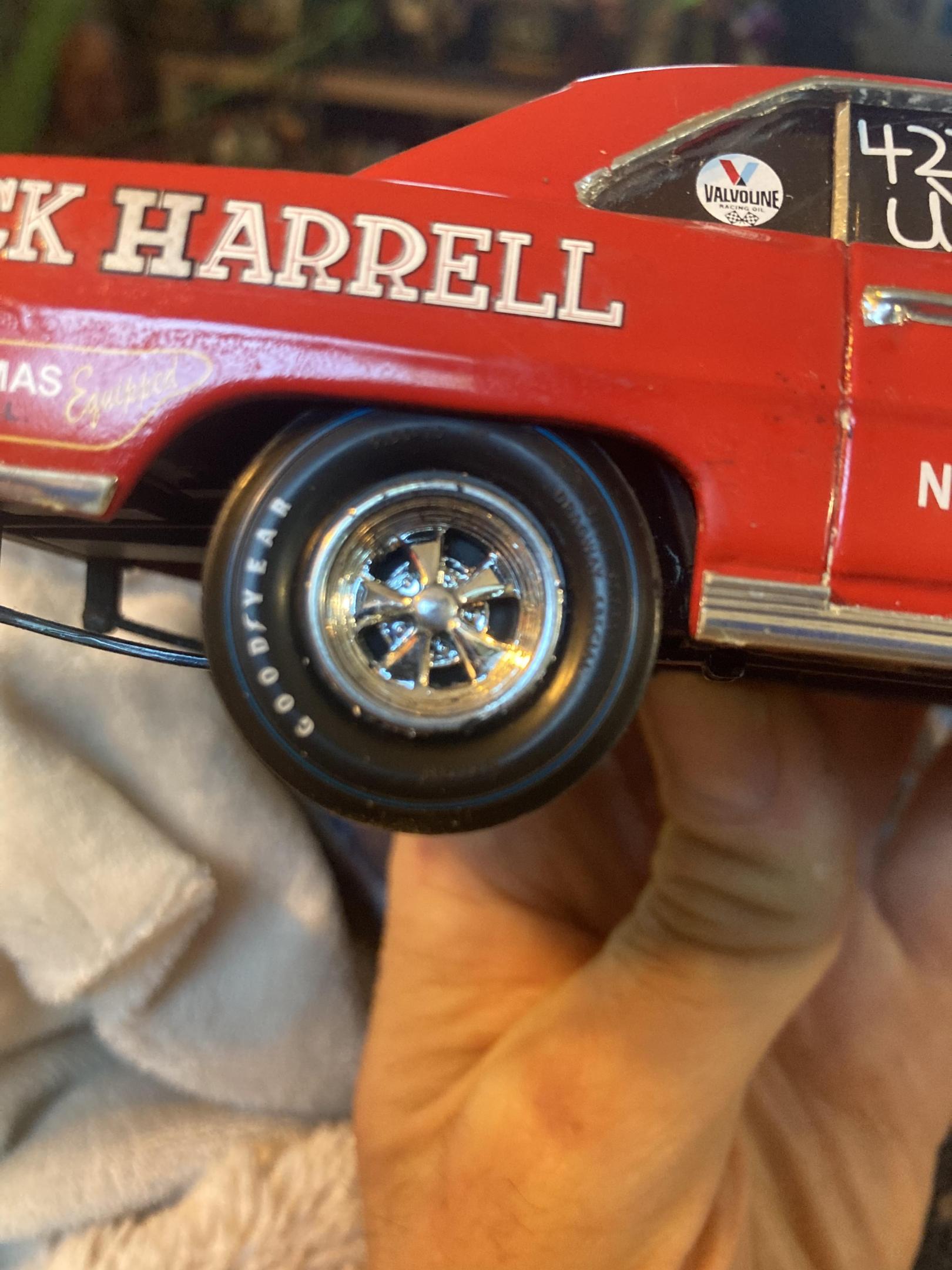

FD6F16C4-1DF7-4ACA-9124-3568DBCF7C9A.thumb.jpeg.fbf7fe4b09052588991c9cfecb104186.jpegThis one started off with the amt nova pro street kit. I altered the rear wheel wells separated the front fenders and made a one piece flip front end . In the engine compartment is a big block from the amt 1967 pro street chevelle kit with the injector manifold from the amt 63 corvette the stacks are aftermarket , the timing chain cover was in the amt 1939 ford sedan The wheels are from the old pro nova . The front leaf springs came from the amt 1933 Willy’s the axle is aluminum tubing . I made the roll bar from  0.80 plastic rod . The hurst t- handle shifter is from the mpc flip front 1953 ford pickup. Amt blue streaks out back and Firestone supreme tires up front. The beautiful red enamel is plain old testors topped with slixx decals.

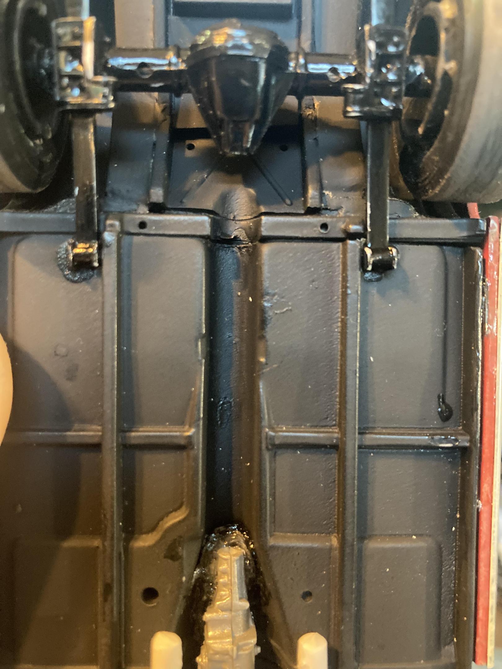

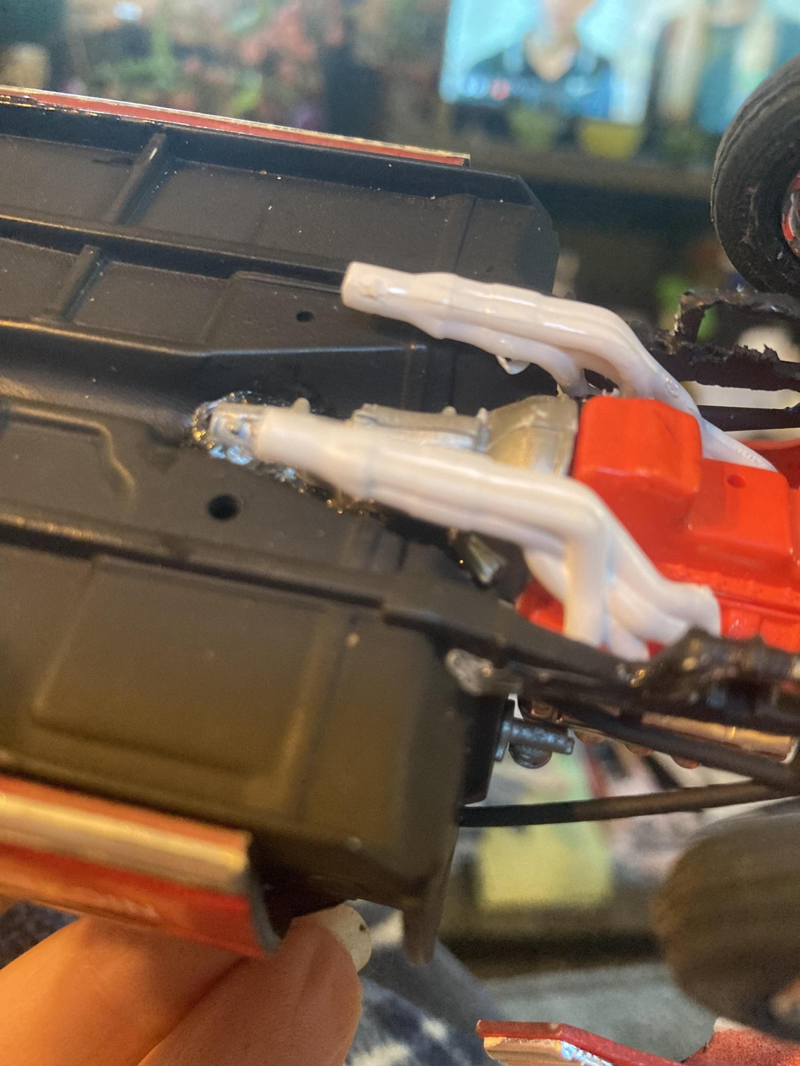

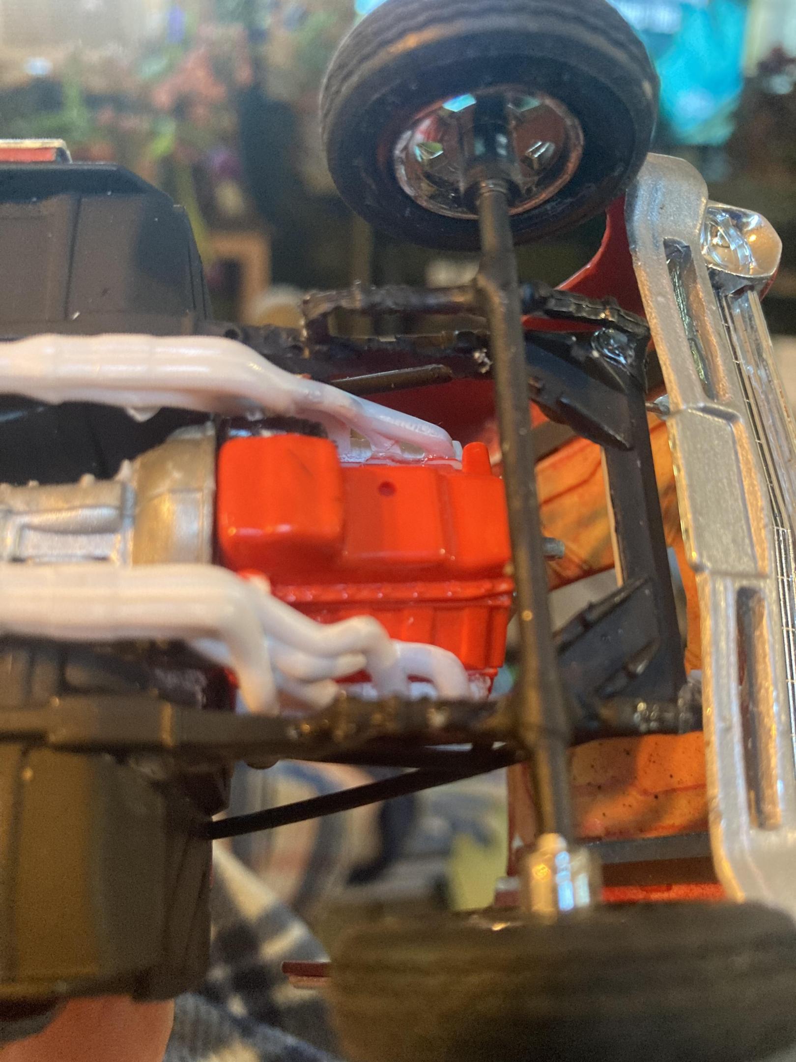

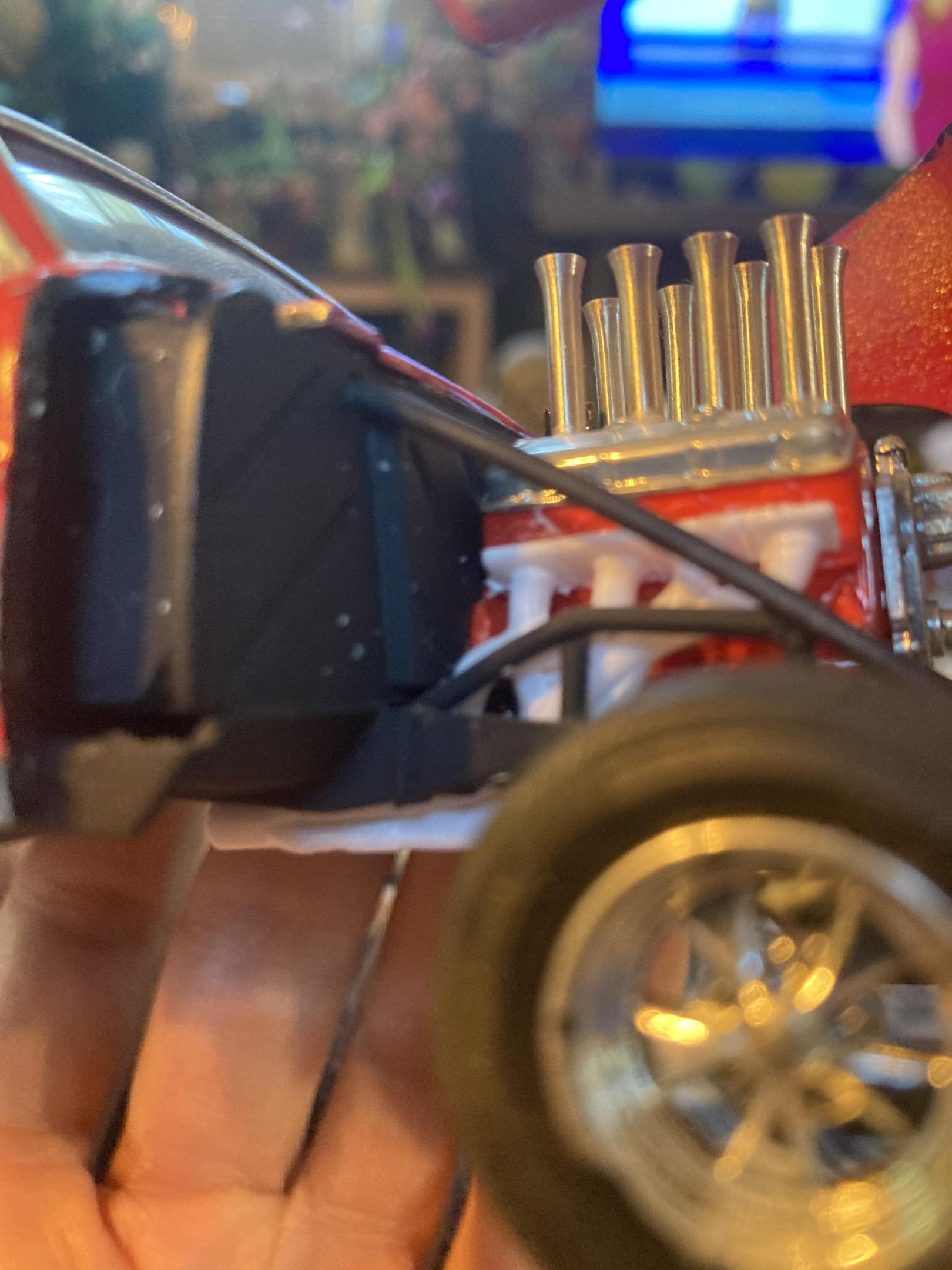

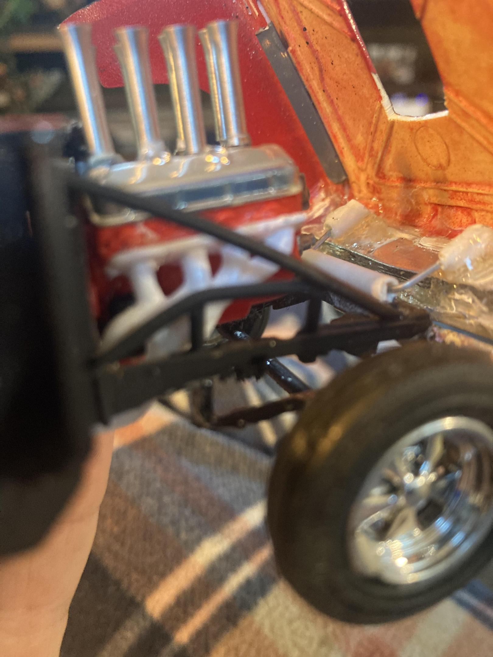

Hi John, I used the amt 66 Chevy 2 front frame rails and just made some bracing up with  0.080 plastic rod .while this might not be 100% accurate I built most of this car long before the internet so I just made what I thought looked right it originally had Fred cady decals as the slixx one’s went out yet. When I finally got around to finishing it some thirty years later I stripped them off and used the slixx ones.As far as sacrificing a moebius kit just for the front clip I would save the money. I used the front leaf springs from amt’s 33 Willy’s kit I used aluminum tubing and a leftover amt metal axle. You could also make the springs from metal strips cut to length and superglued together . I brought a thin square piece of steel at my lhs and cut it into strips with a tin snips. I took some close up pictures that might help. I cut the chassis right behind the front rear spring perches to move the rear wheel wells forward. The headers I used are actually hemi parts from revell’s dart or charger. I hope this helps you out if you have any other questions just let me know I’m always happy to help out a modeler. You always do a great job with nice detail work my friend.  Mike D775B54A-45AB-4C7C-8BC5-1B012C93C019.thumb.jpeg.bd3bf4f5997f716e970738e271e02c47.jpeg34751E4A-6176-41C6-8DA8-41DE33CE9559.thumb.jpeg.d7ea2813c4587e2ce0b41be0e1dc883d.jpeg2F436ED4-B64B-4E8A-A88B-0A3F888630FC.thumb.jpeg.3076b954c4ce1d56a1285427673f9054.jpeg357D7B4B-399D-4284-B749-D96EC4BFE9AD.thumb.jpeg.acee4360ab8b23a22330328d9d7d95cf.jpegD0EFEB80-587A-48D1-9FB7-4F5974ECFFE6.thumb.jpeg.f50b1552e5139c8a8754dba2f927cf1d.jpegCE1E920B-1DA0-4694-8FFD-B555BA5218AD.thumb.jpeg.4c41ef3f307a9f7ff5cf502634fdf7d3.jpeg
