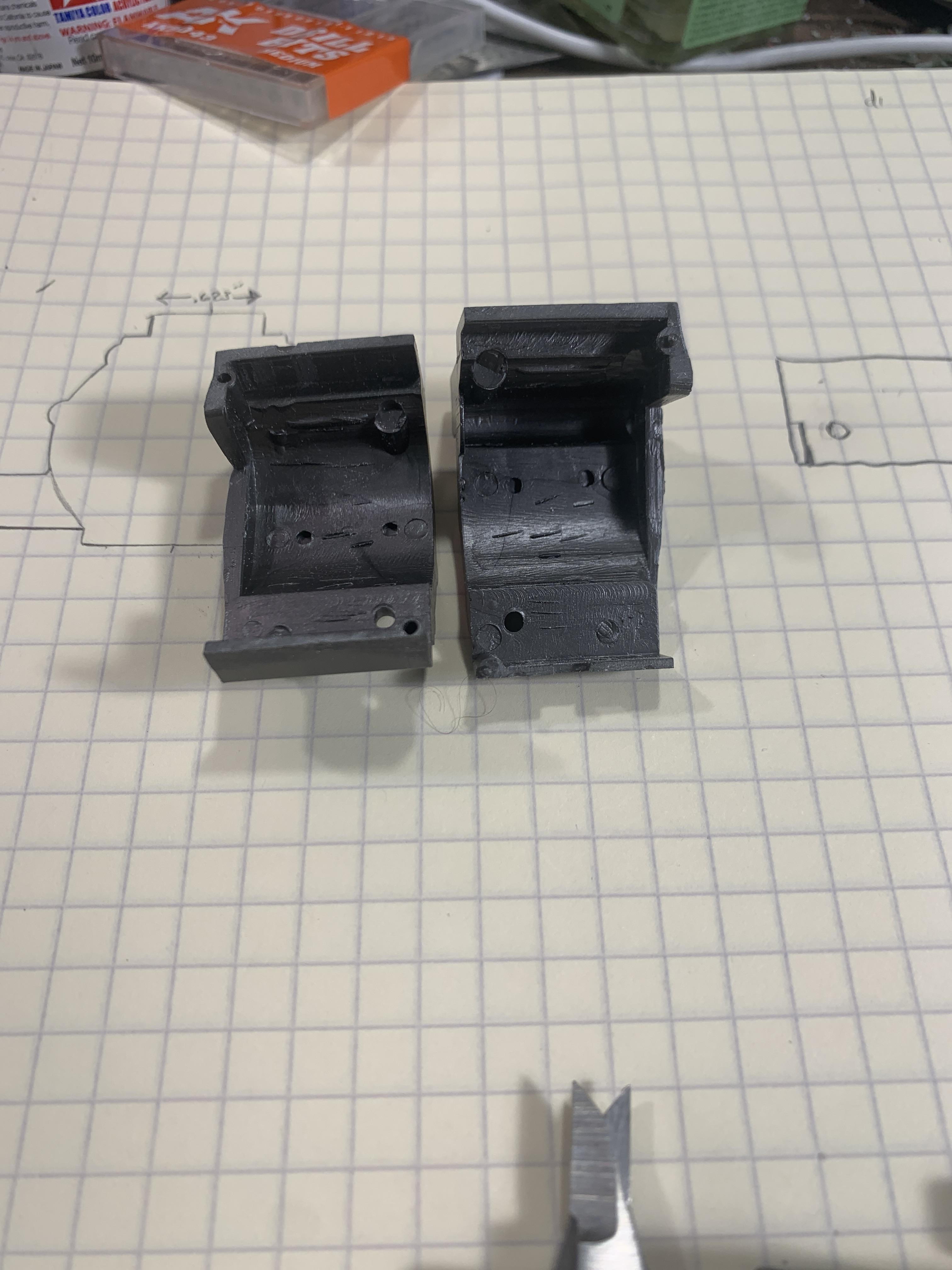

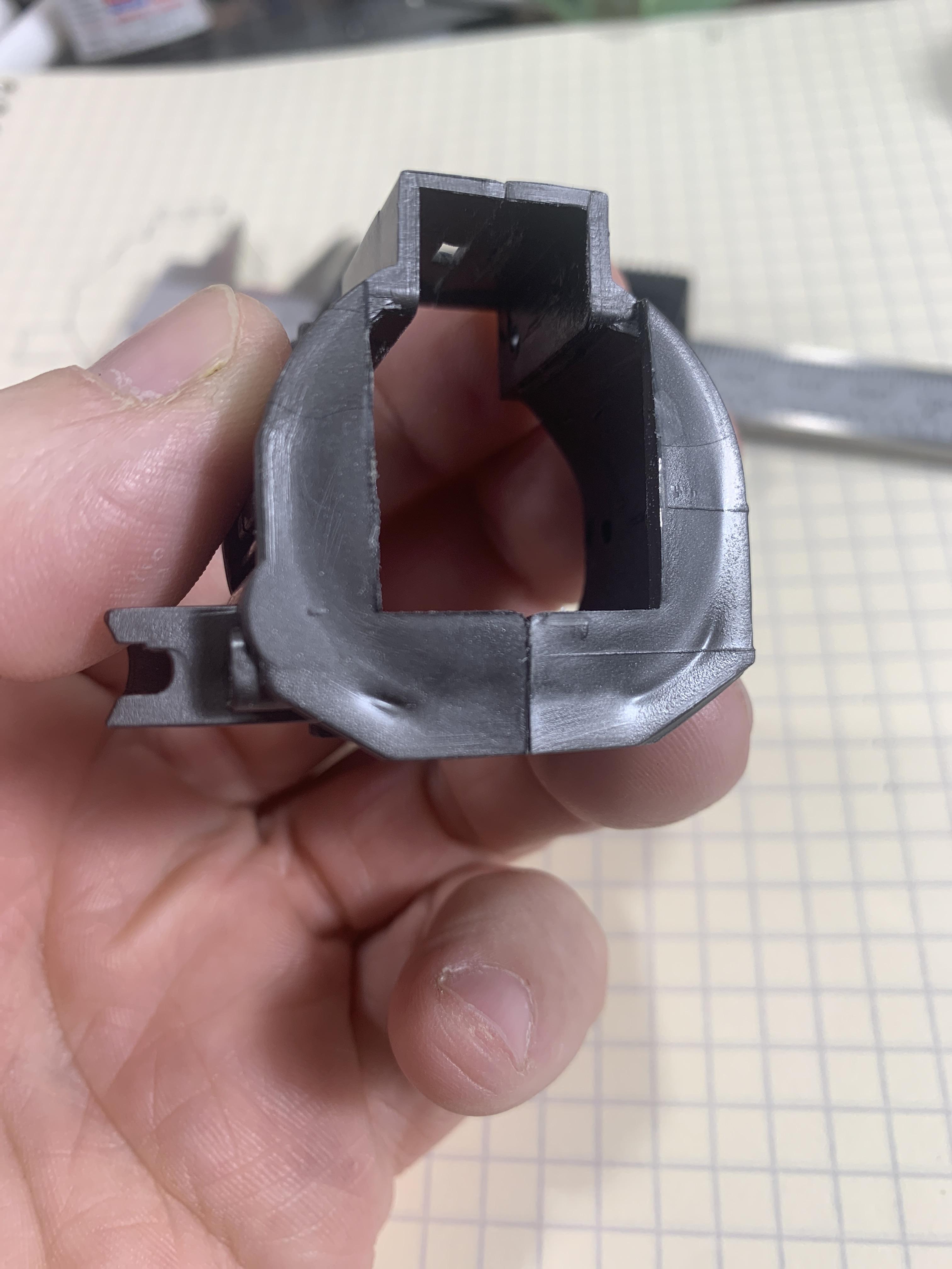

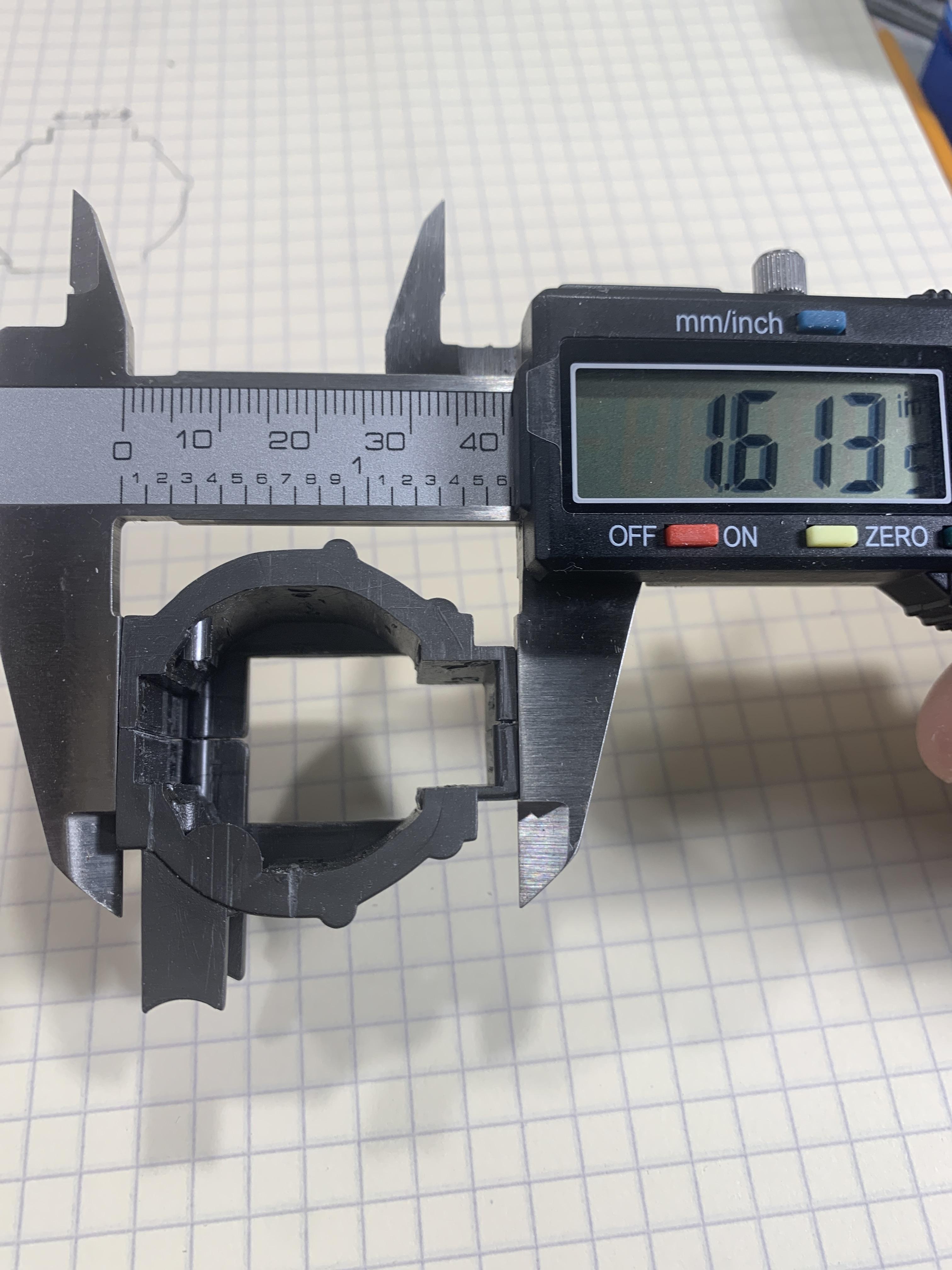

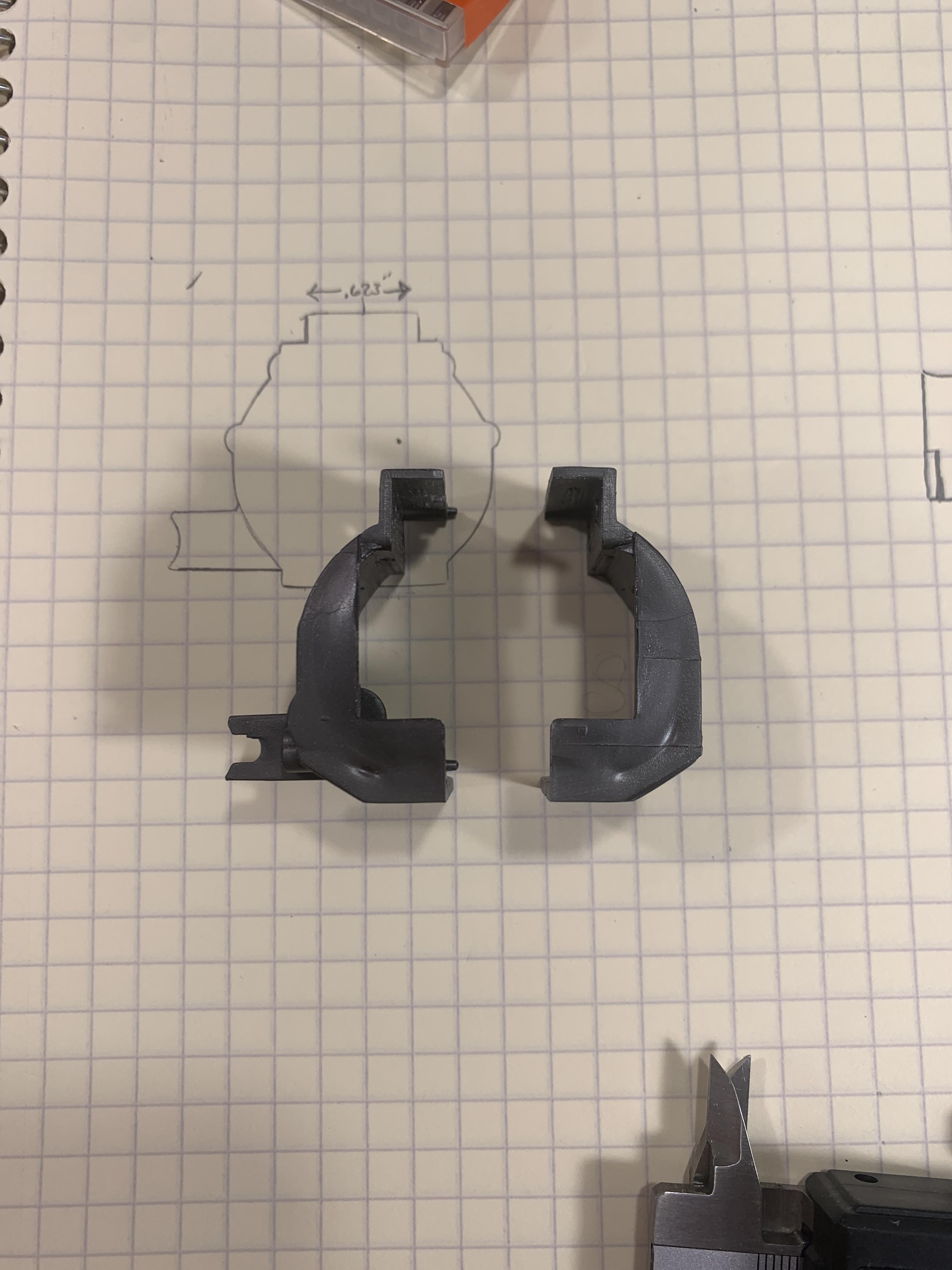

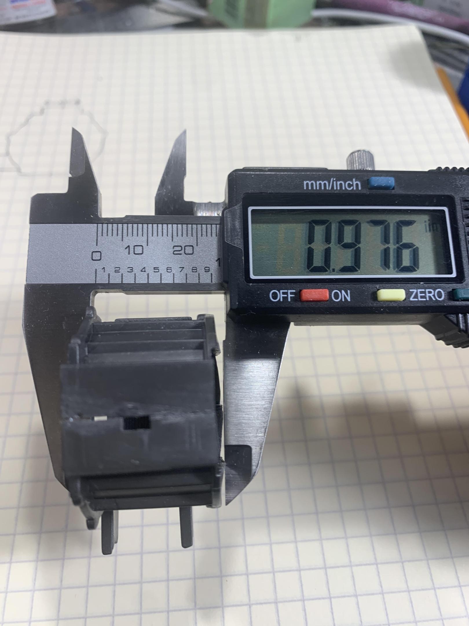

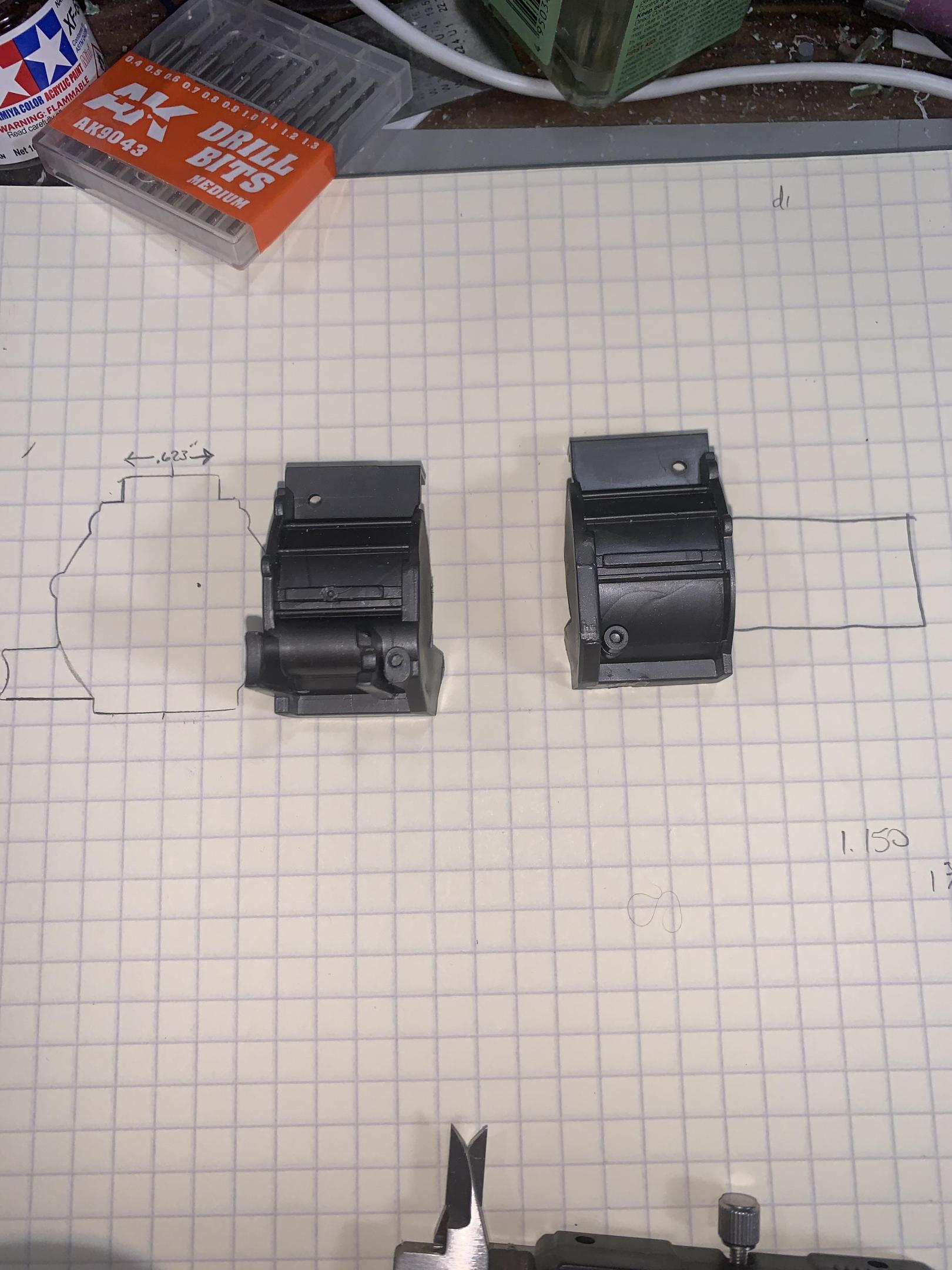

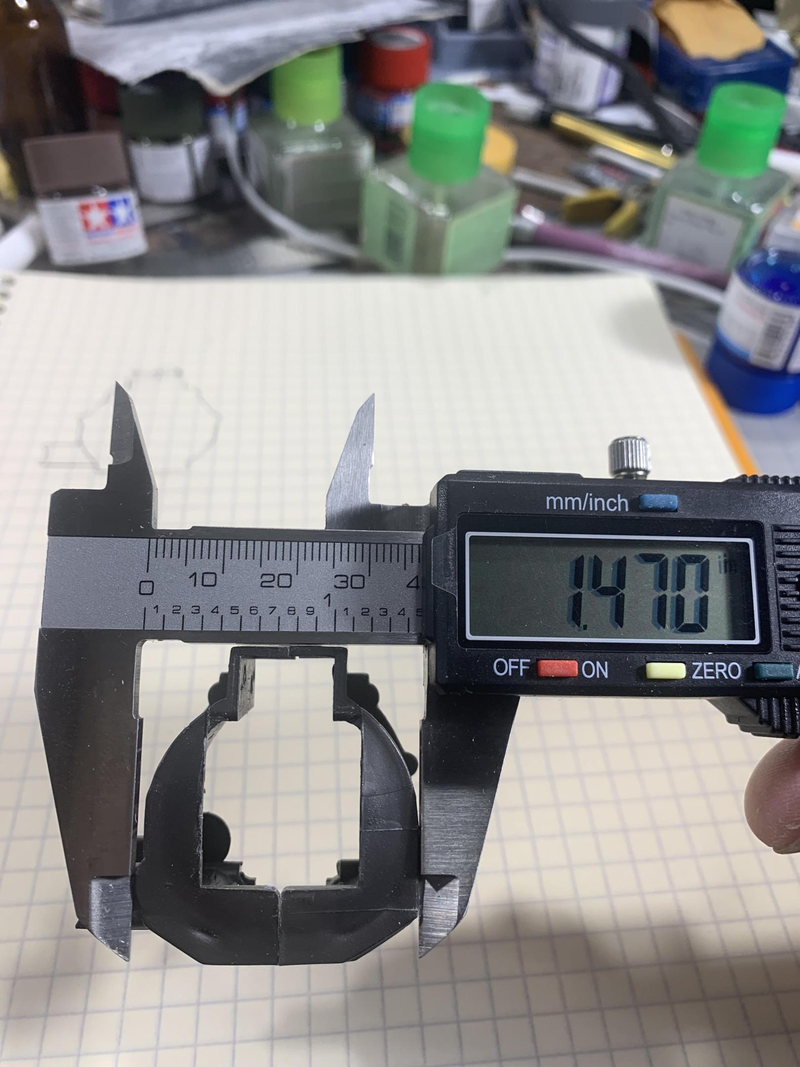

LDO Posted February 4, 2024 Posted February 4, 2024 It’s part of the 1/8 scale McLaren M23. A guy on Facebook wants measurements in order to build a copy from scratch. I think it would be very difficult to get enough measurements build a copy without having the real part in his hands. The back side has compound curves that would would be very difficult to measure properly. Can this part be copied in resin at a price that would not be cost prohibitive?

LDO Posted February 4, 2024 Author Posted February 4, 2024 This is made of two pieces. I also thought of the JPS Lotus. I’m sending all kinds of measurements and photos, but I don’t know if it will help the guy.
Ace-Garageguy Posted February 5, 2024 Posted February 5, 2024 On 2/4/2024 at 9:23 PM, LDO said: ...Can this part be copied in resin at a price that would not be cost prohibitive? Expand Yes, particularly if you don't care if the copies are solid resin, not a two-part assembly as is OEM. Any reasonably competent resin caster can easily make a silicone mold with the split-line where it is on your original, and cast as many as you could possibly want from that.
