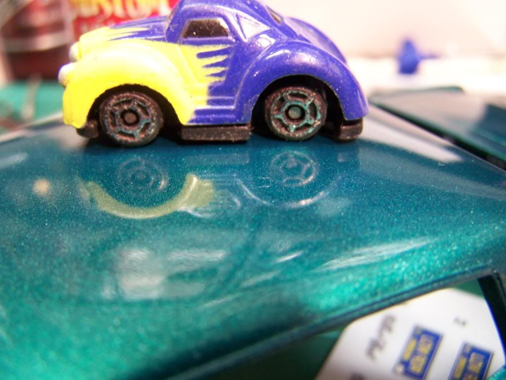

Not trying to be obtuse to Anthony, but you can get a first rate shine out of cheap clear too. I almost exclusively use Dupli Color clears on every build. I also use a Black Gold polishing kit with 1:1 KIT Carnauba wax. By the time I have gone through the polishing cloth's, the clear coat actually looks like glass.....then I put the wax on to "bring it out".
this one I did with Krylon Crystal Clear Glaze
this is BEFORE any polish :lol:
So with that said, you can do it without spending a lot of money....just gonna take a little patience and good ole' elbow grease.
