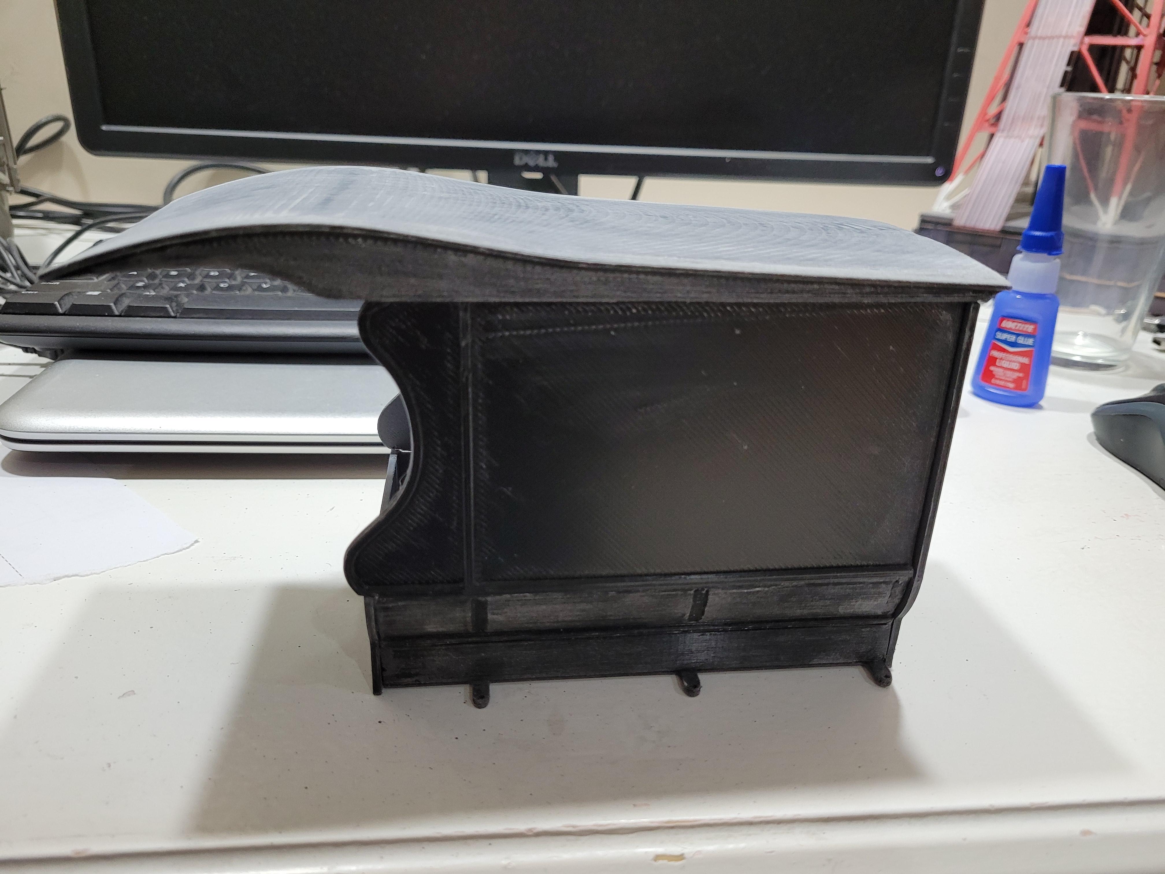

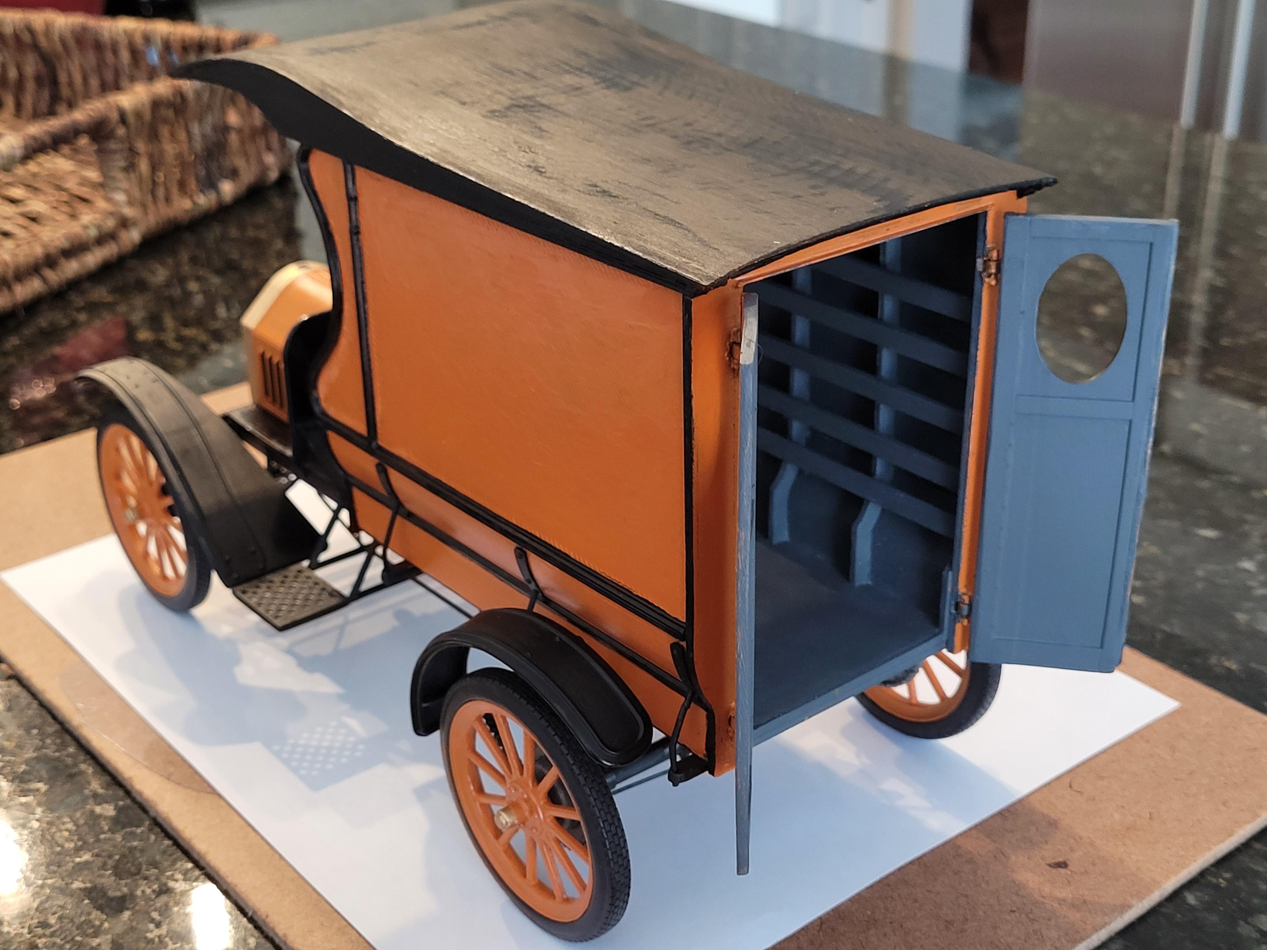

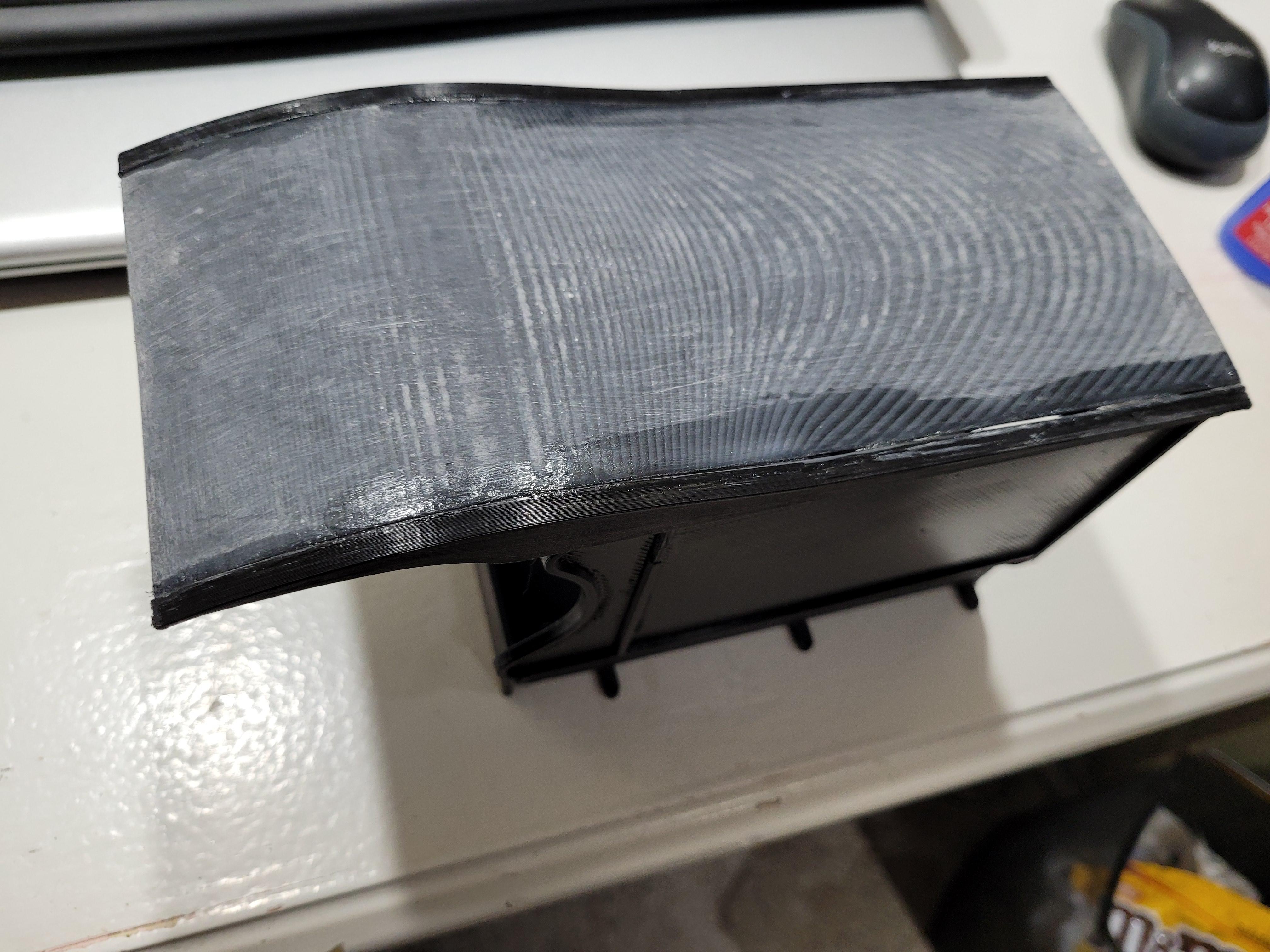

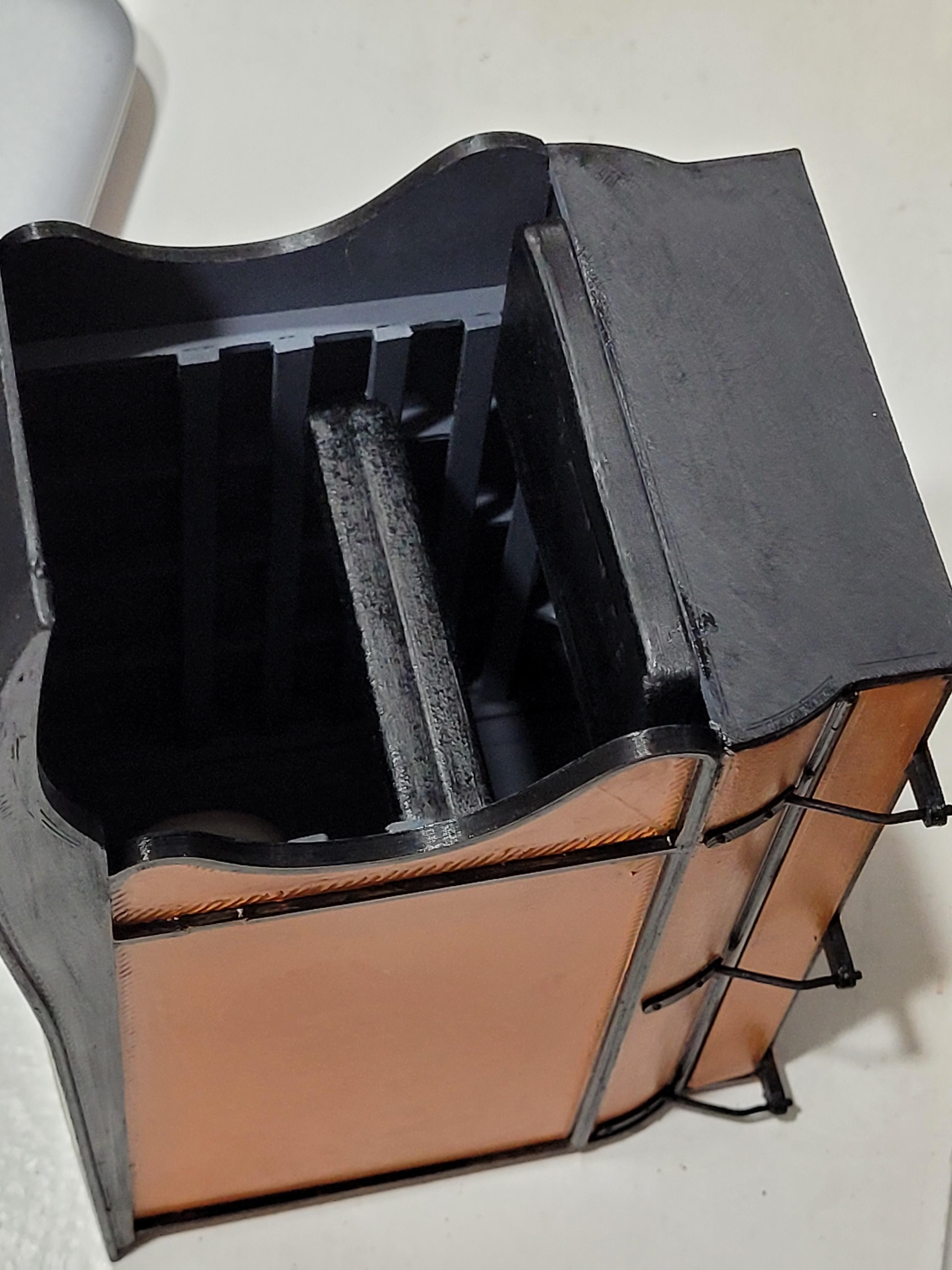

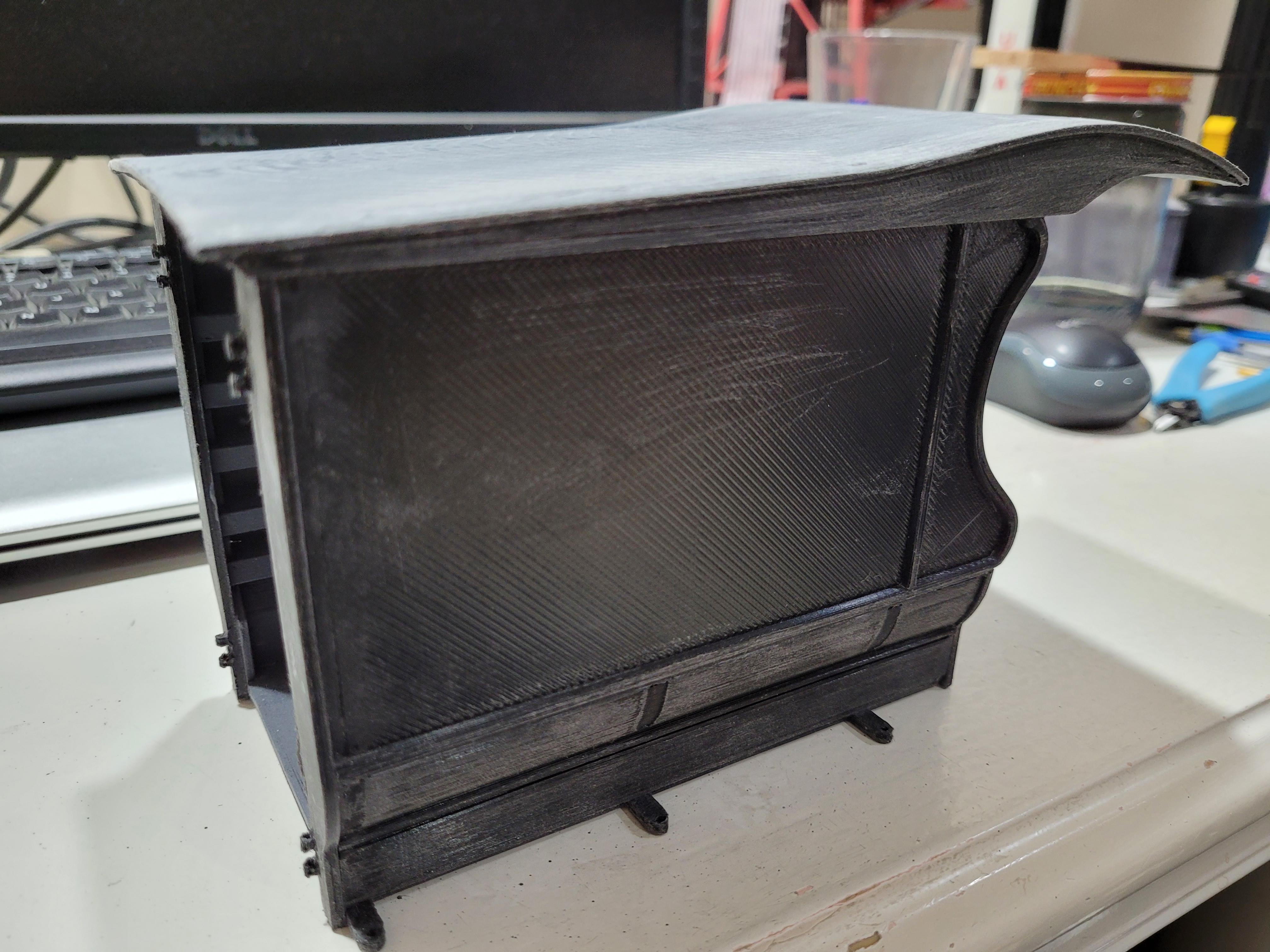

kenlwest Posted April 19, 2024 Author Posted April 19, 2024 The roof panel is sanded and stitched into the cargo box. Being a perfectly square part, it serves to remove any warp in the cargo box assembly as well.

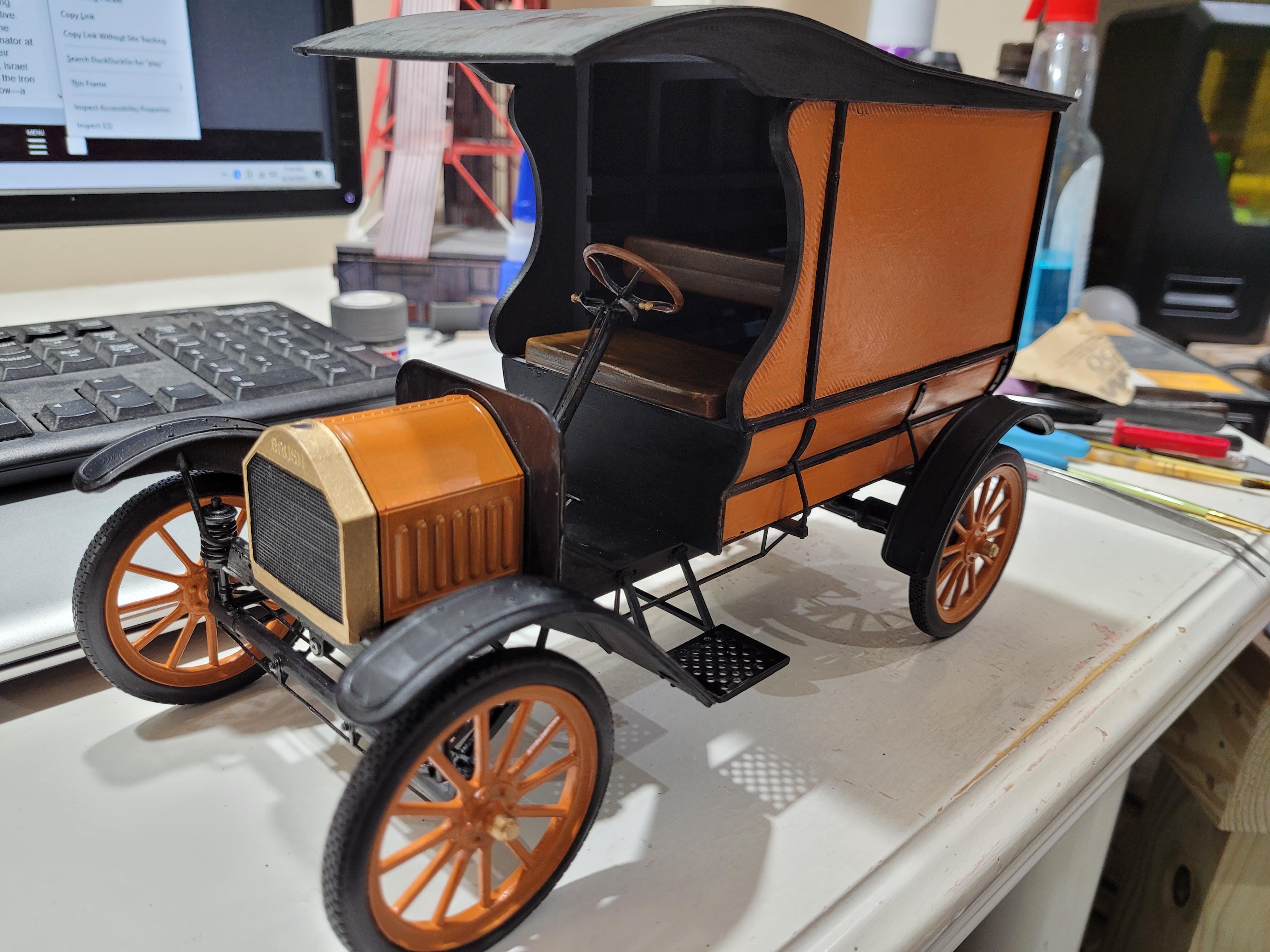

kenlwest Posted April 19, 2024 Author Posted April 19, 2024 The roof is ready for thick primer. I don't strive for perfection on these old cars, because to me, a little imperfection seems to add to the realism at this scale. The 1:1 subjects are sometimes not much better. 2

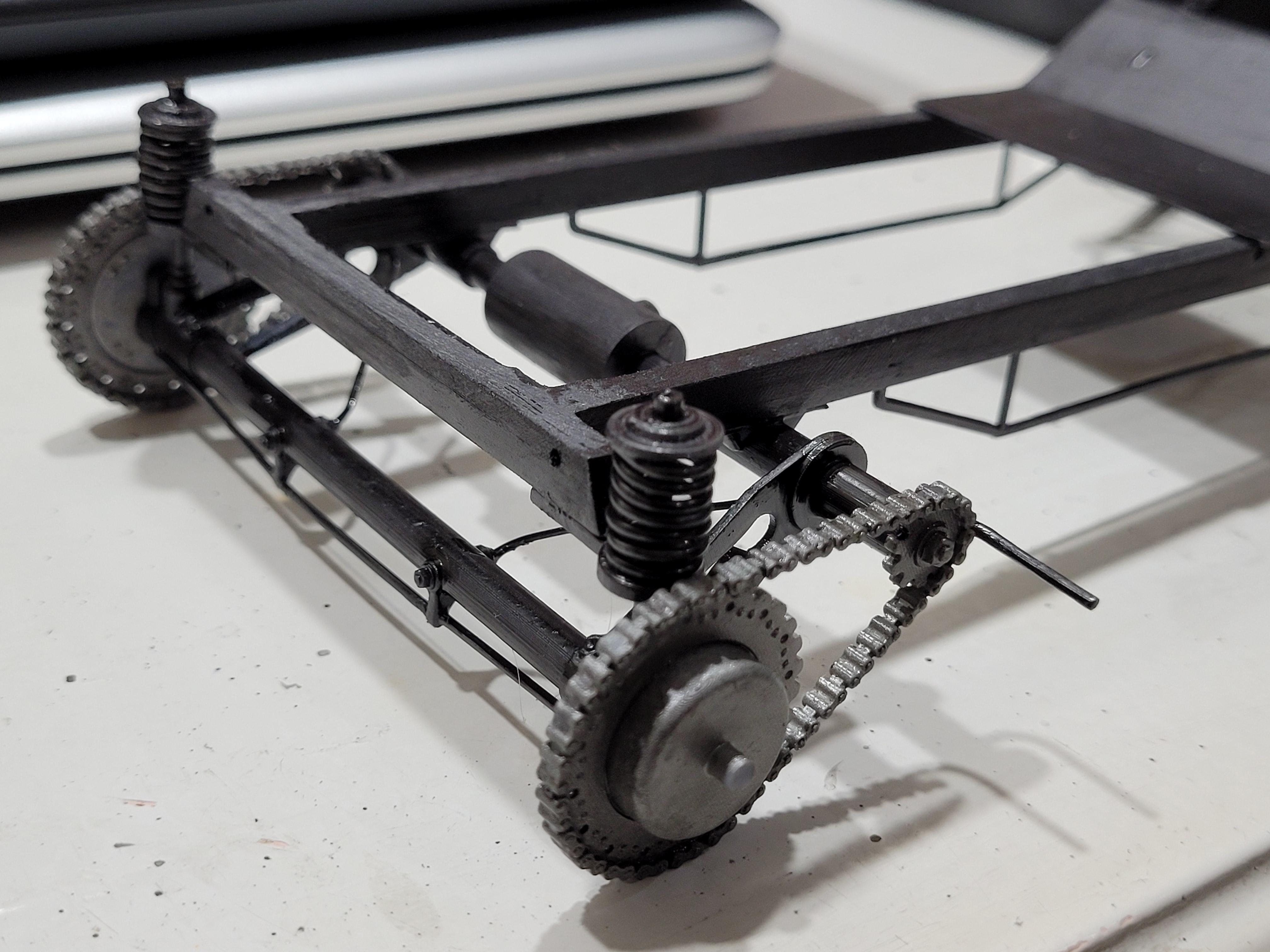

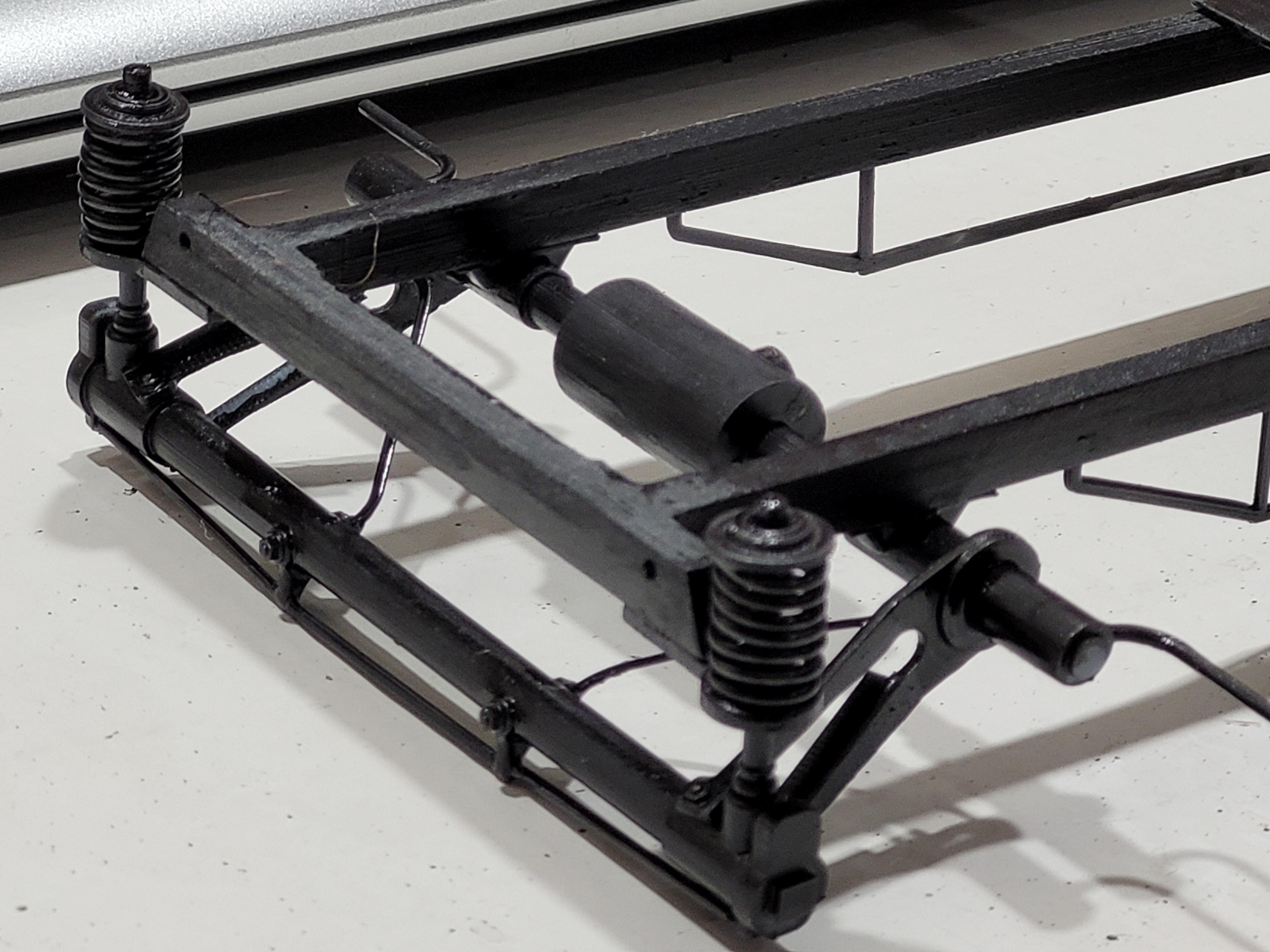

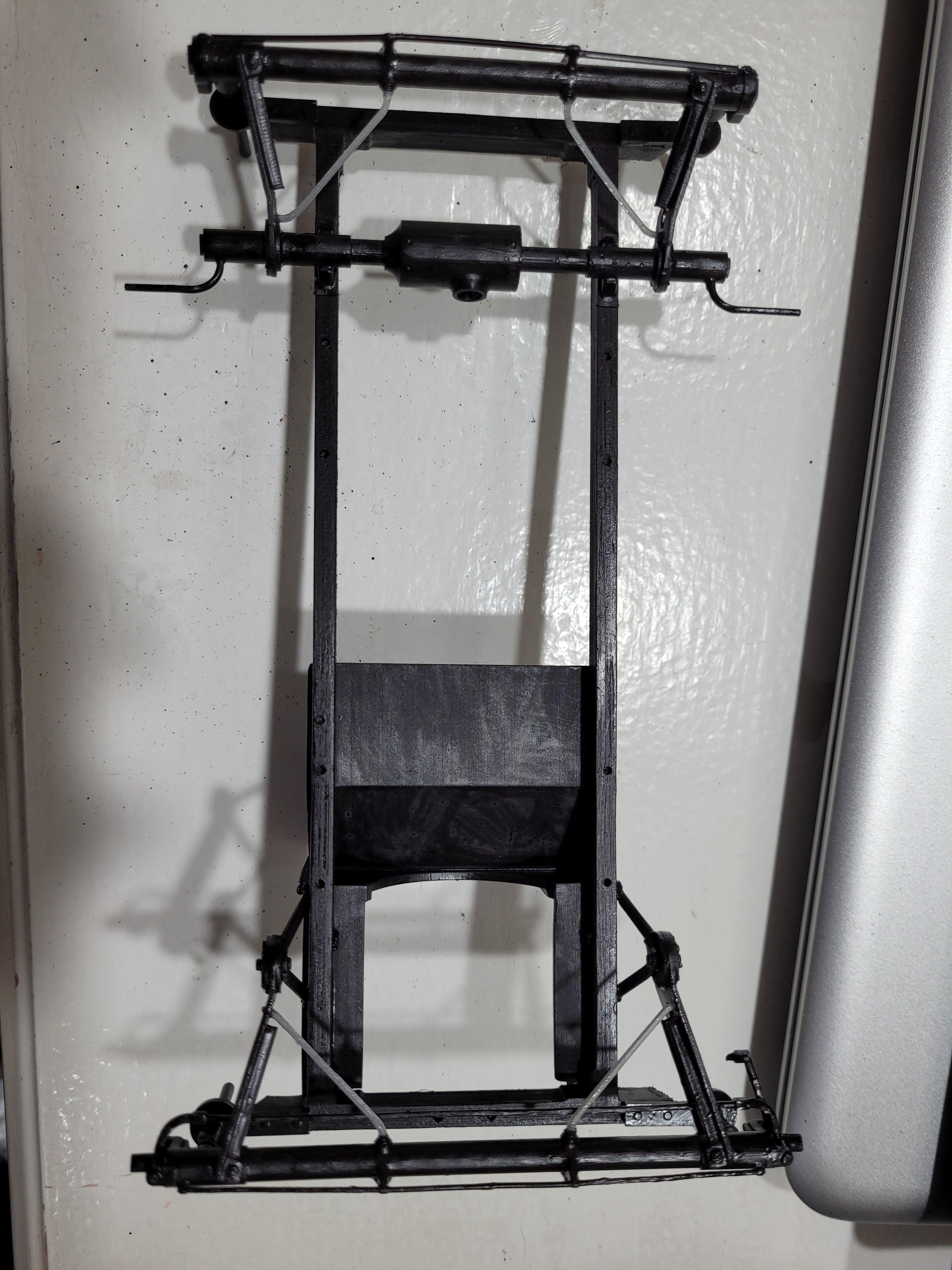

kenlwest Posted April 20, 2024 Author Posted April 20, 2024 The 4 gray braces are designed to stabilize the axles from side to side movement.

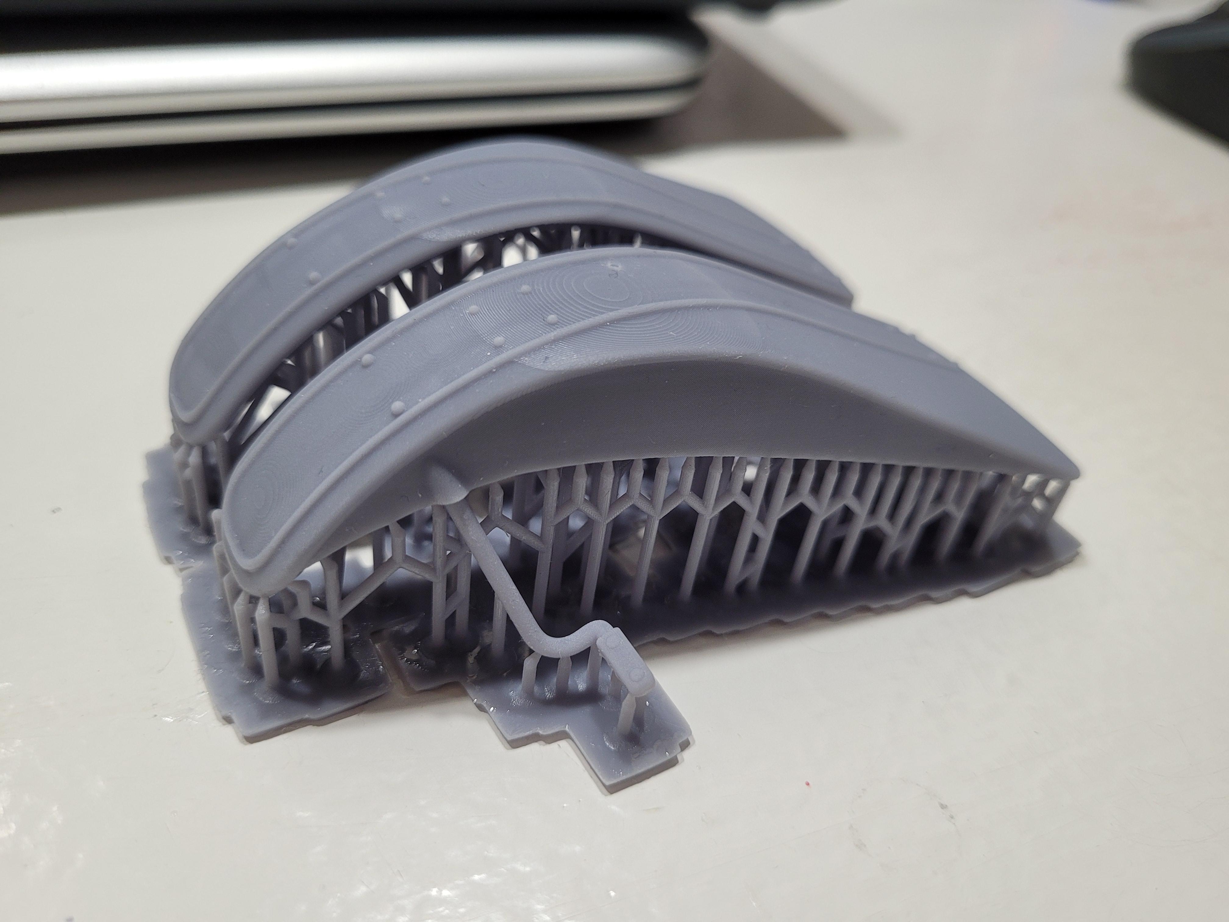

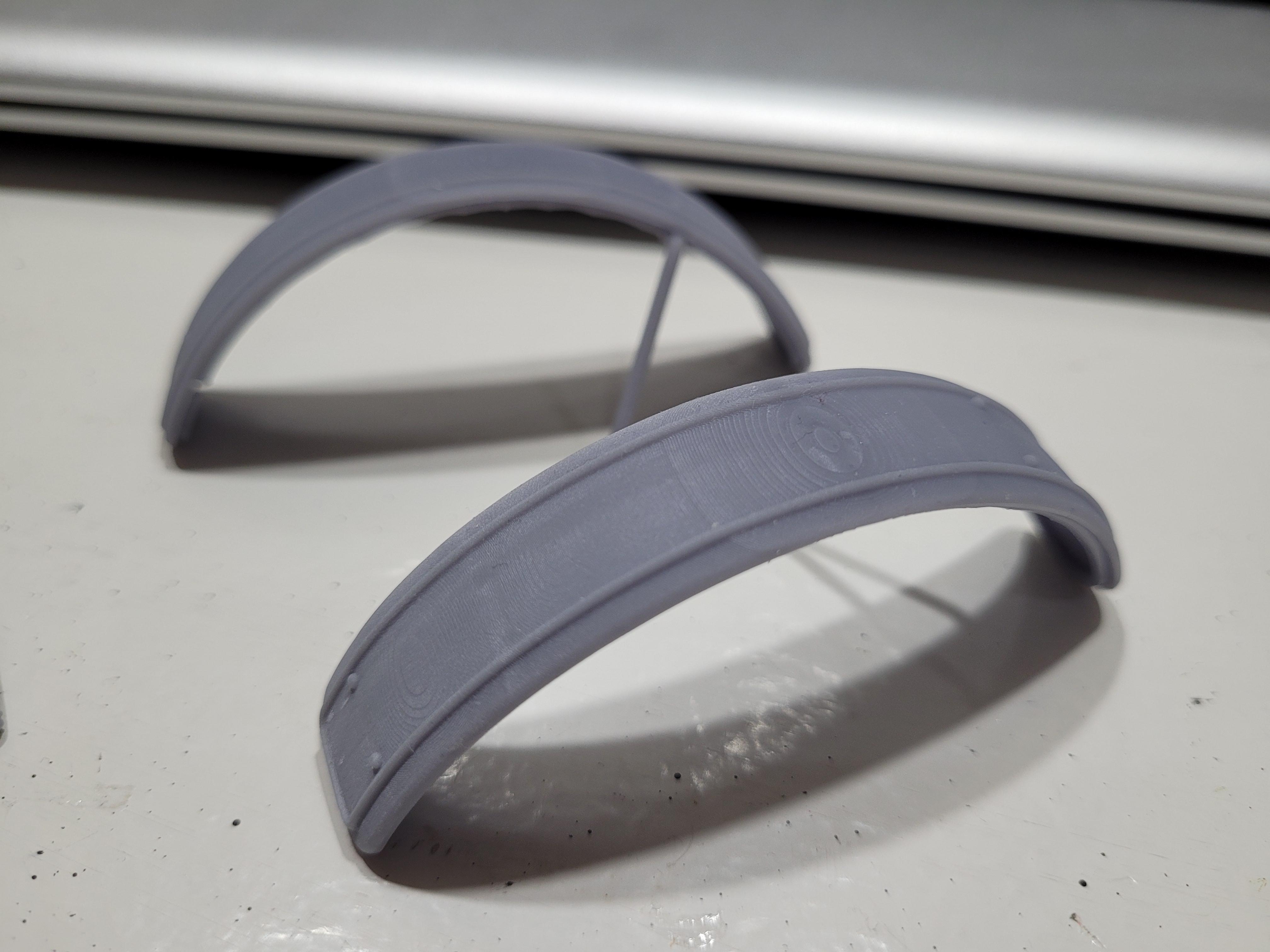

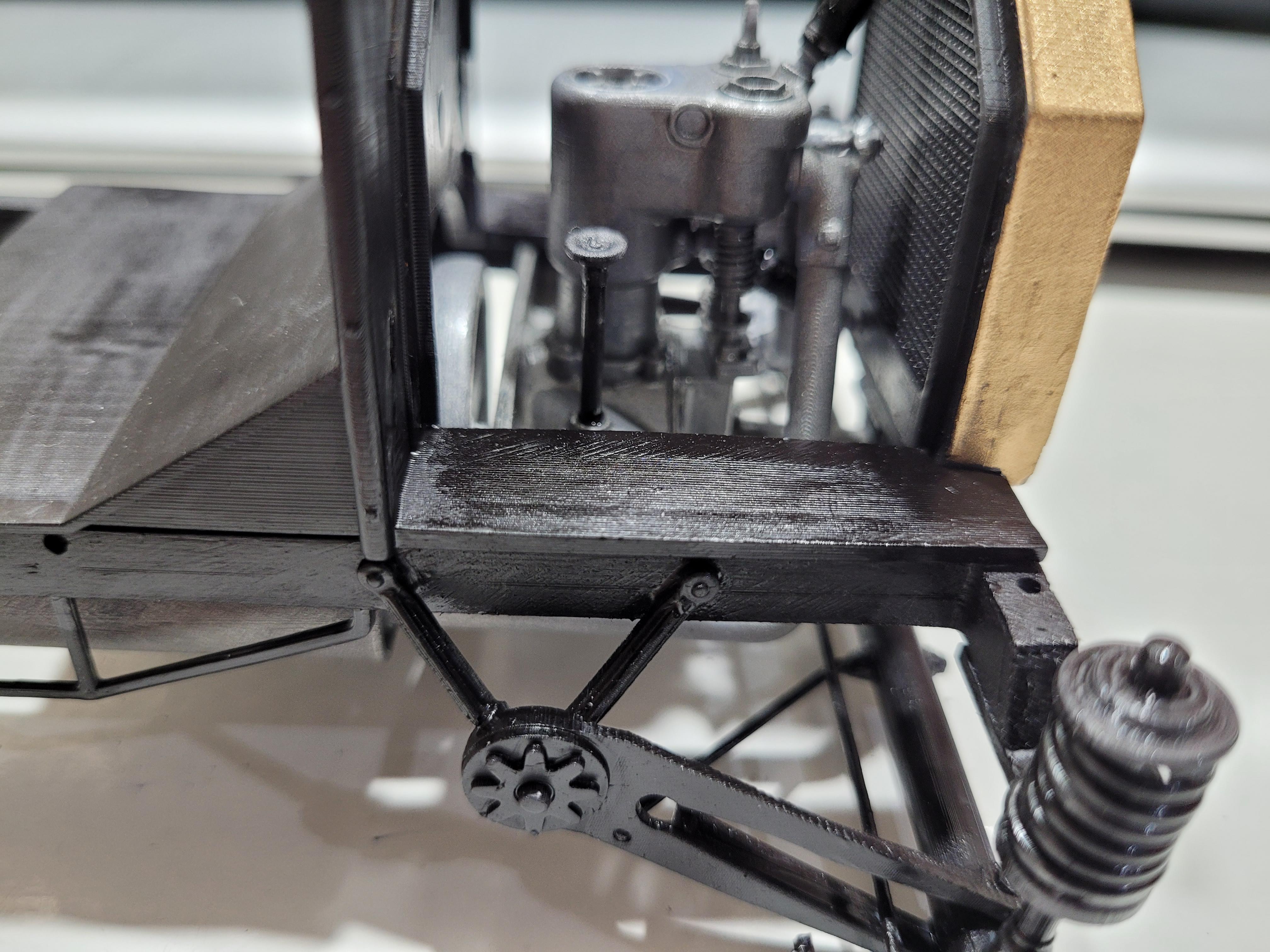

kenlwest Posted April 20, 2024 Author Posted April 20, 2024 These ladder-looking parts were designed to stiffen the wooden frame.

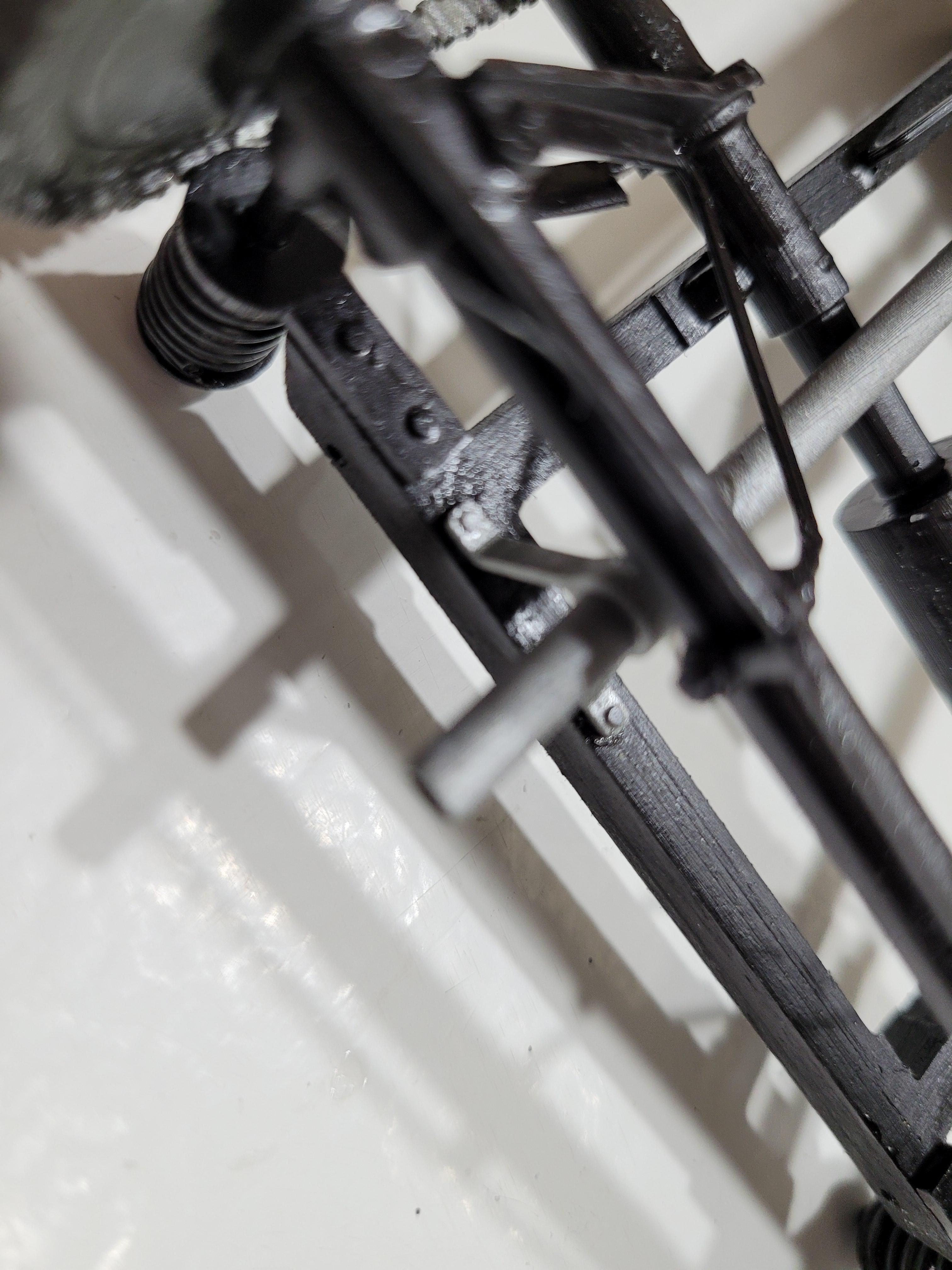

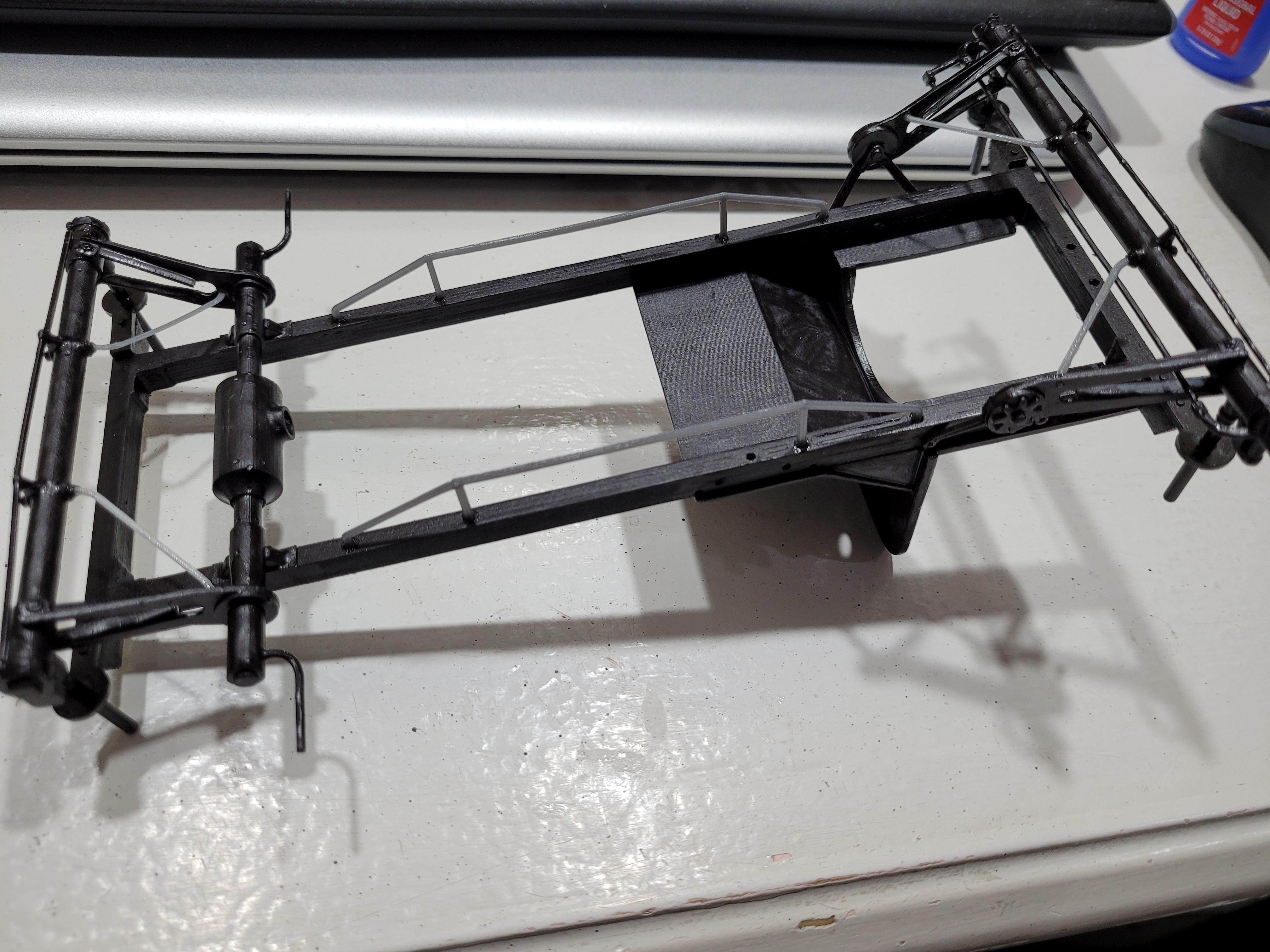

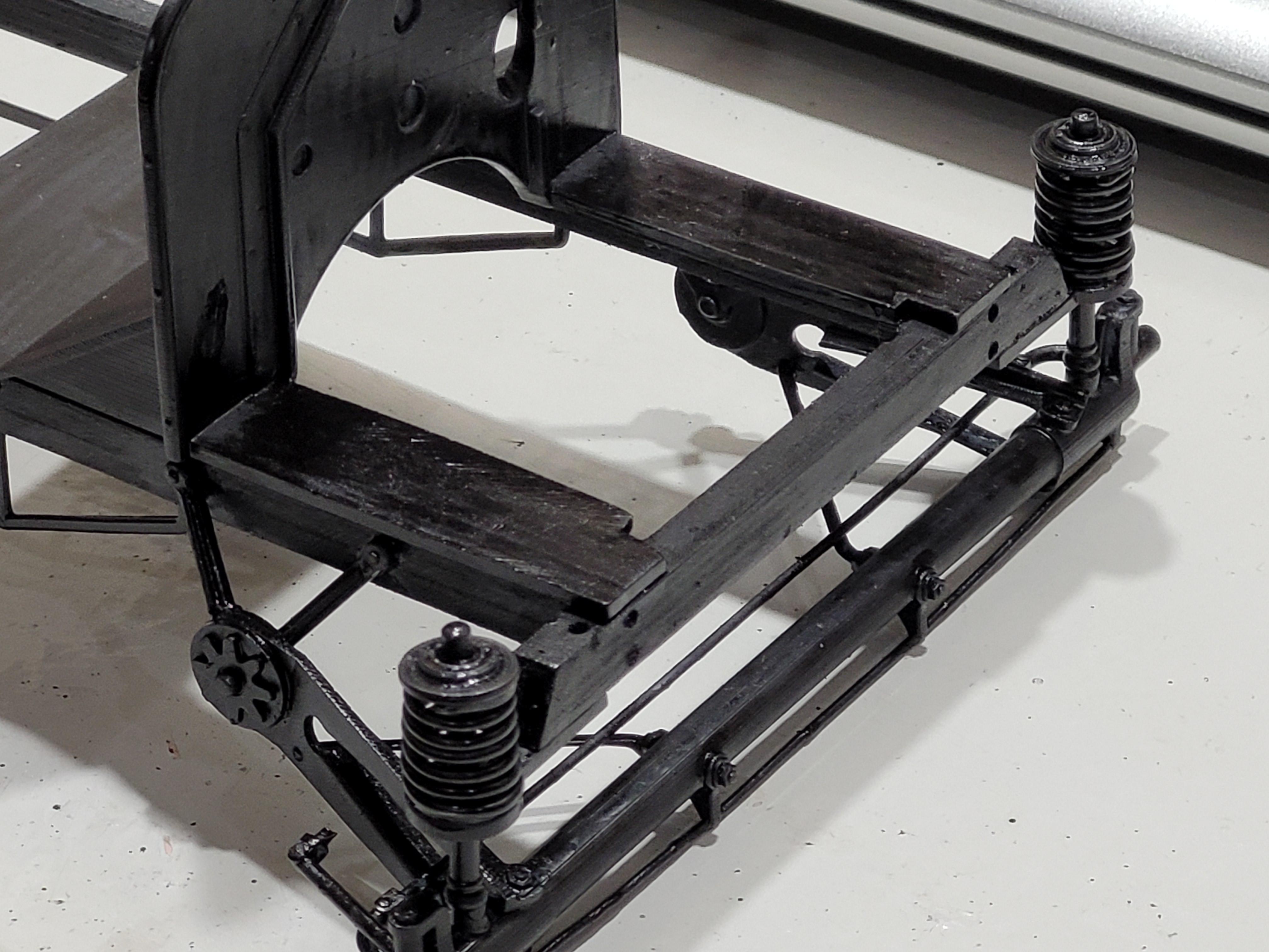

kenlwest Posted April 20, 2024 Author Posted April 20, 2024 The four-corner extension springs in place.

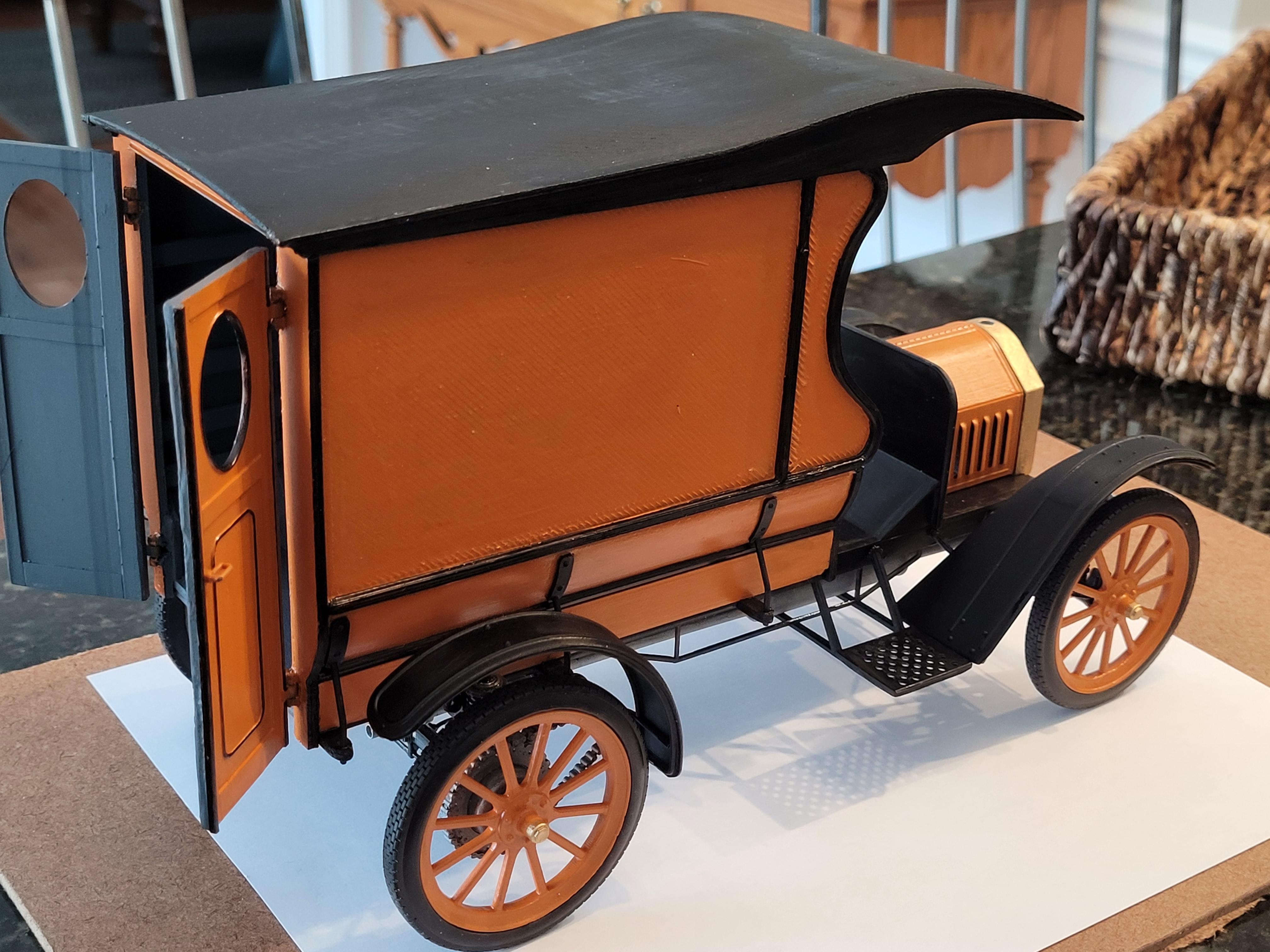

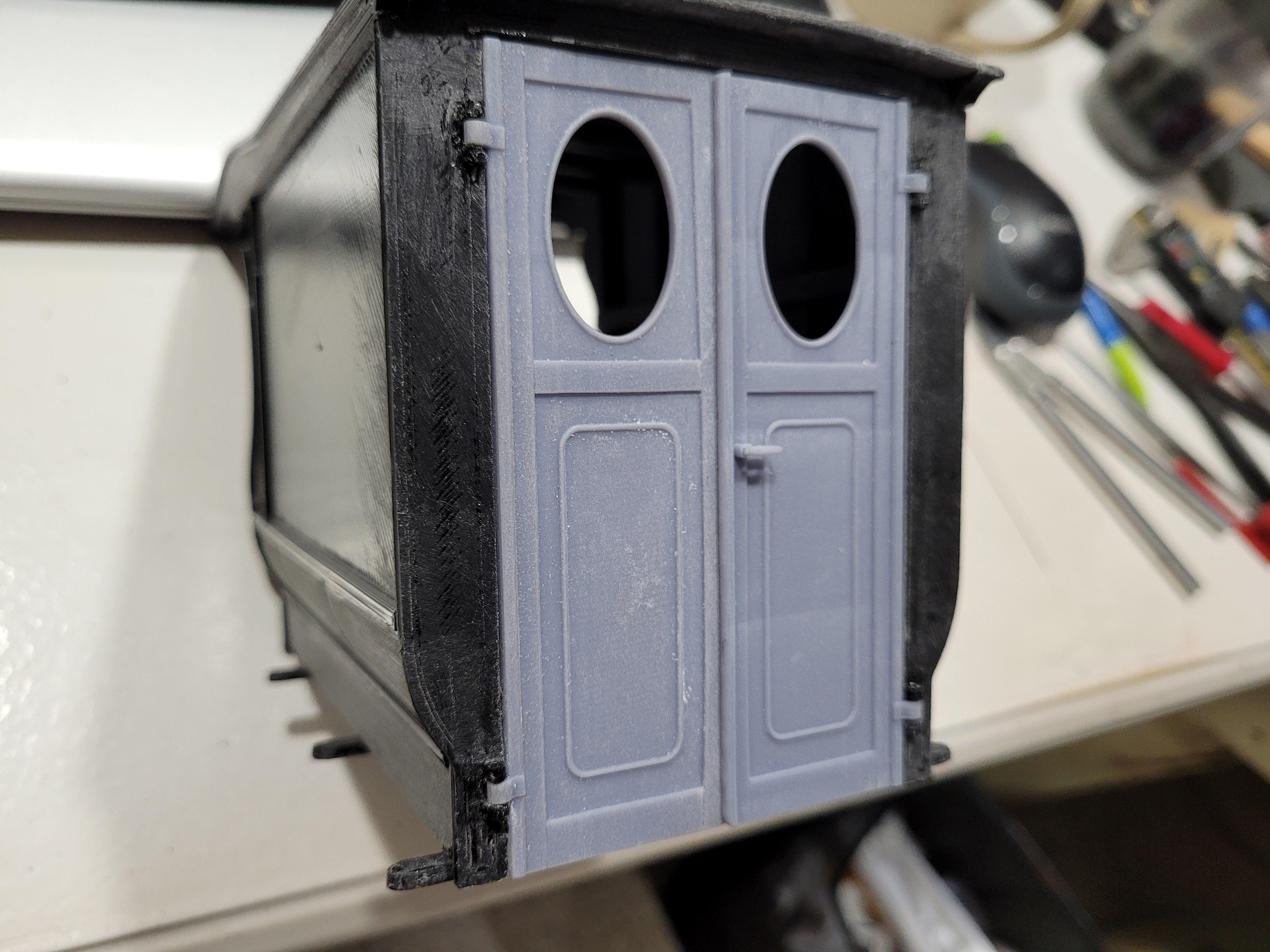

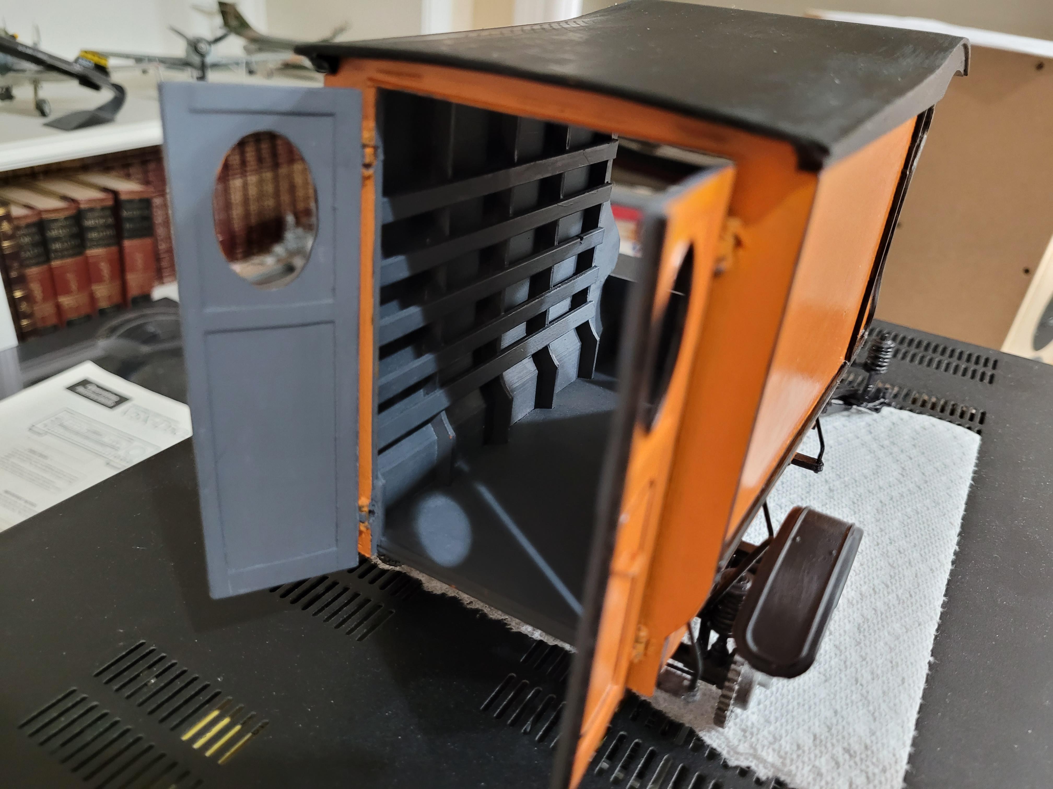

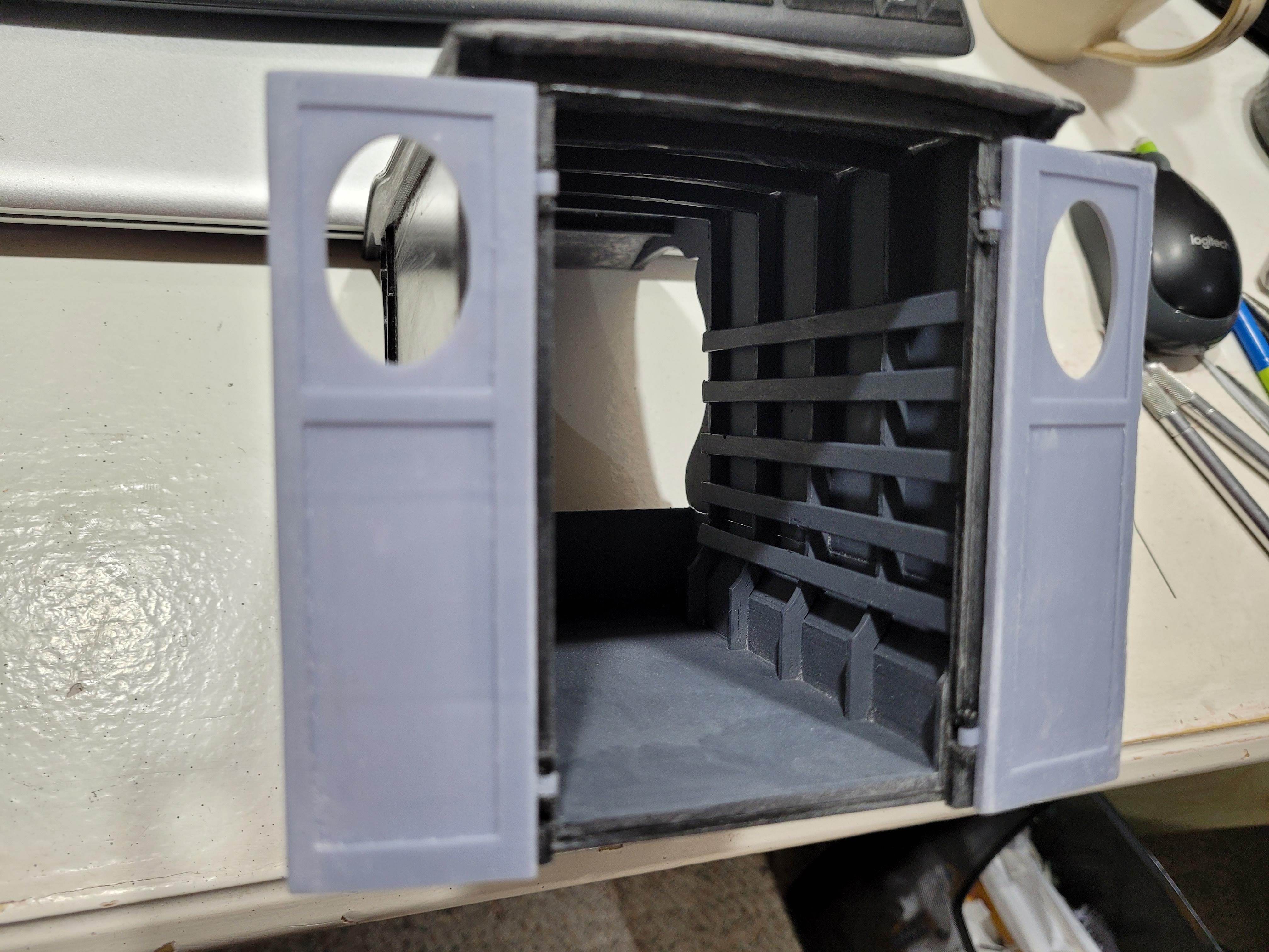

kenlwest Posted April 20, 2024 Author Posted April 20, 2024 The rear cargo doors open and close. A lot of filing and grinding to get them parallel and tight when shut.

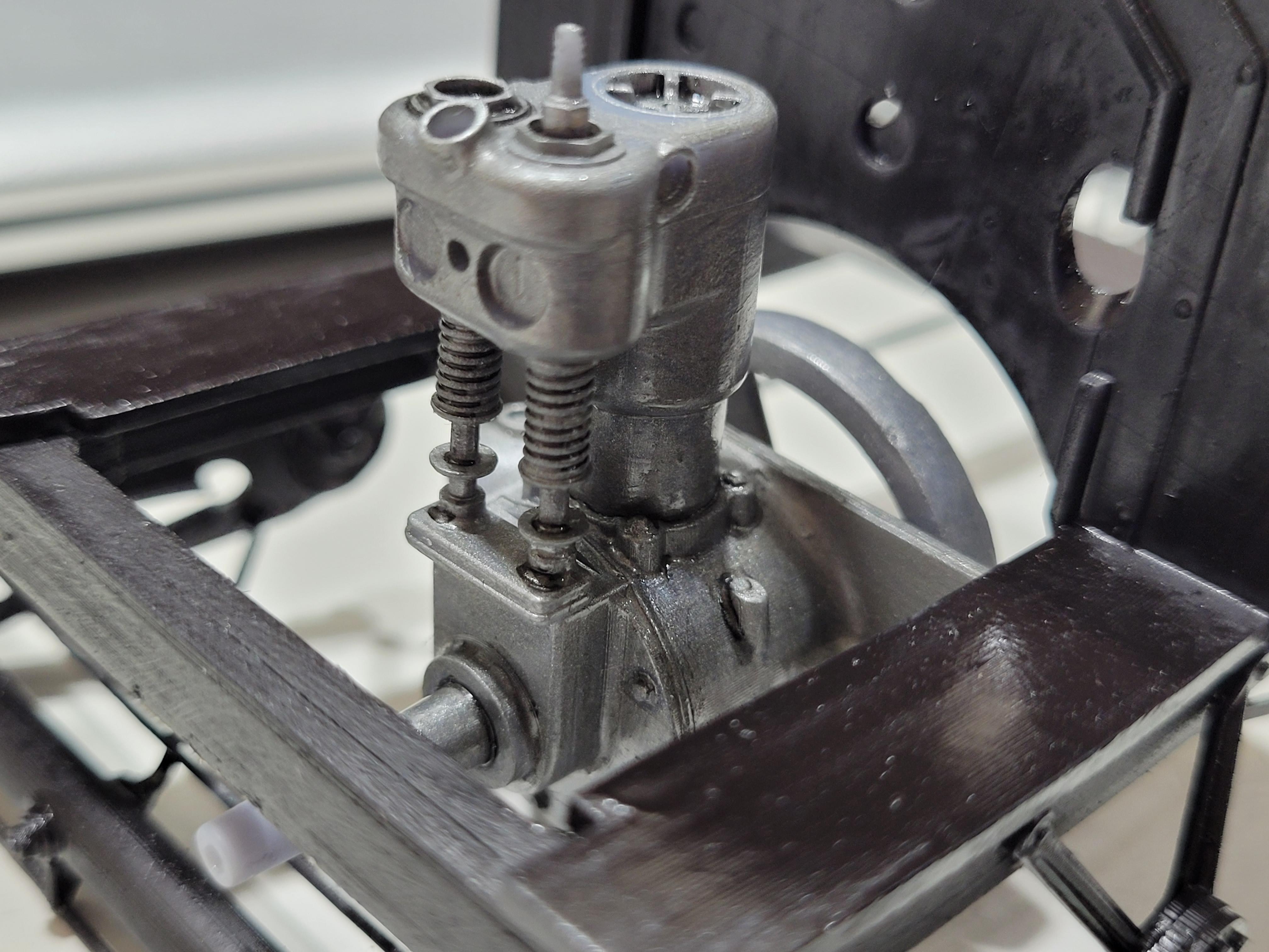

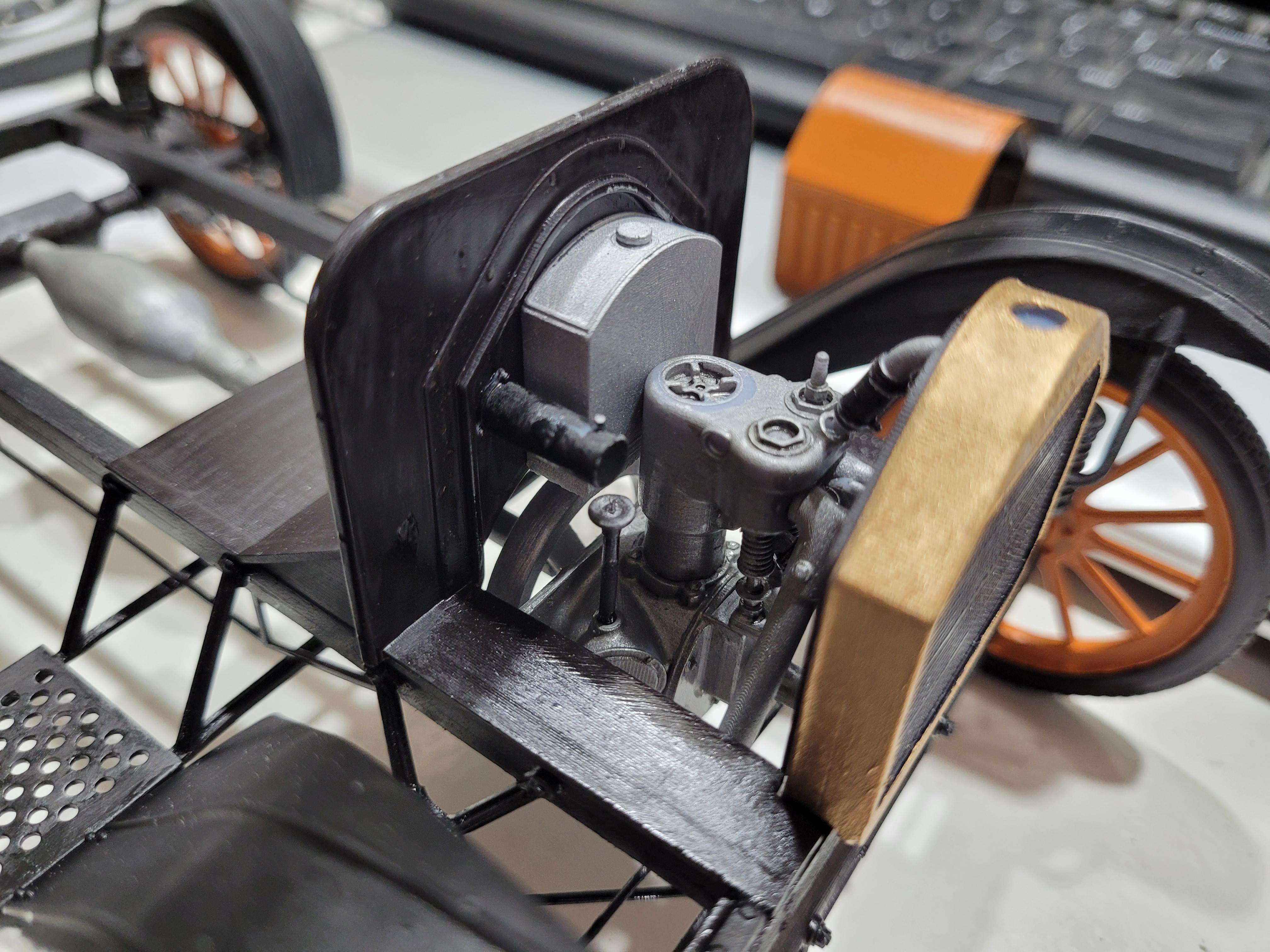

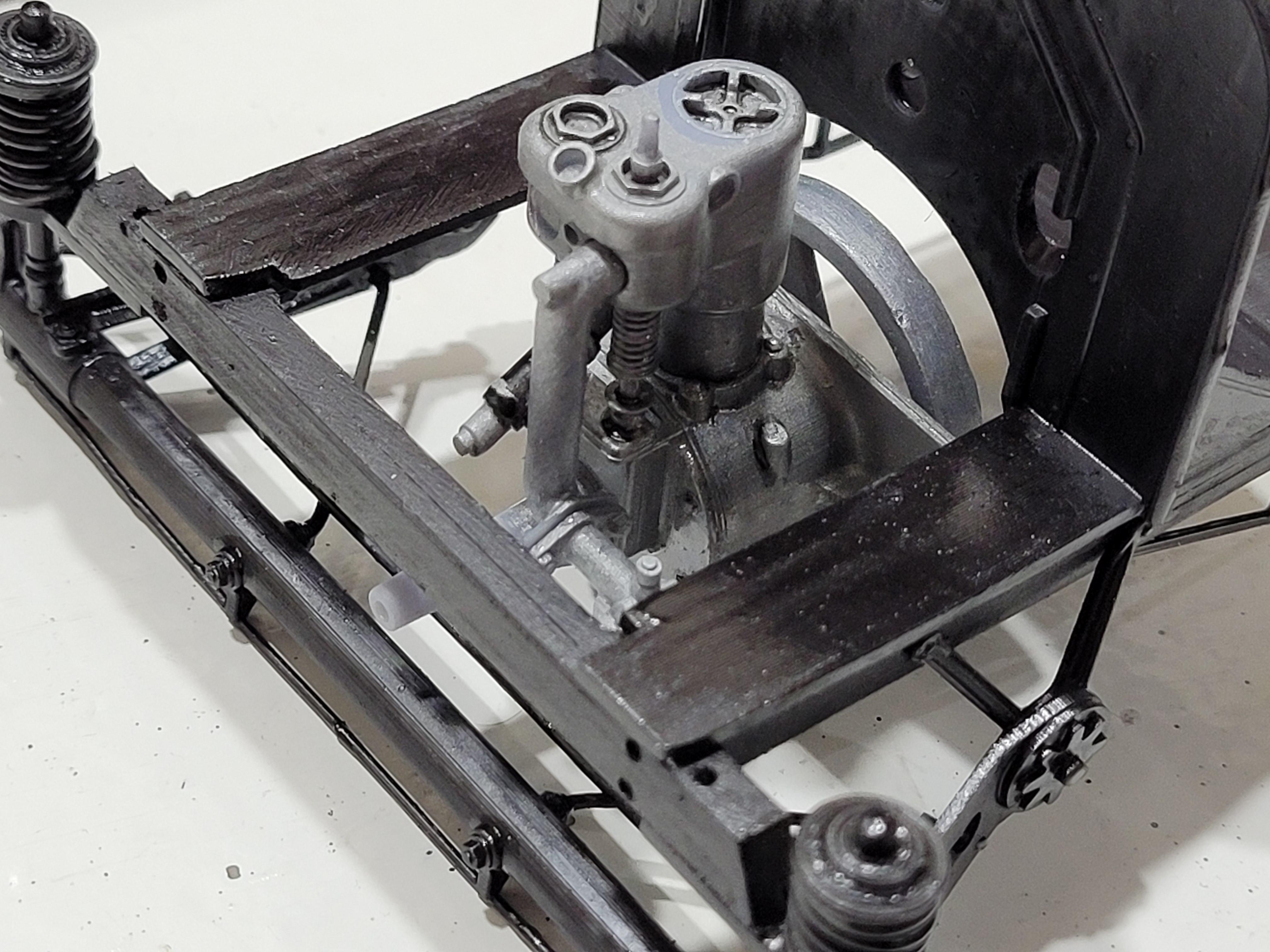

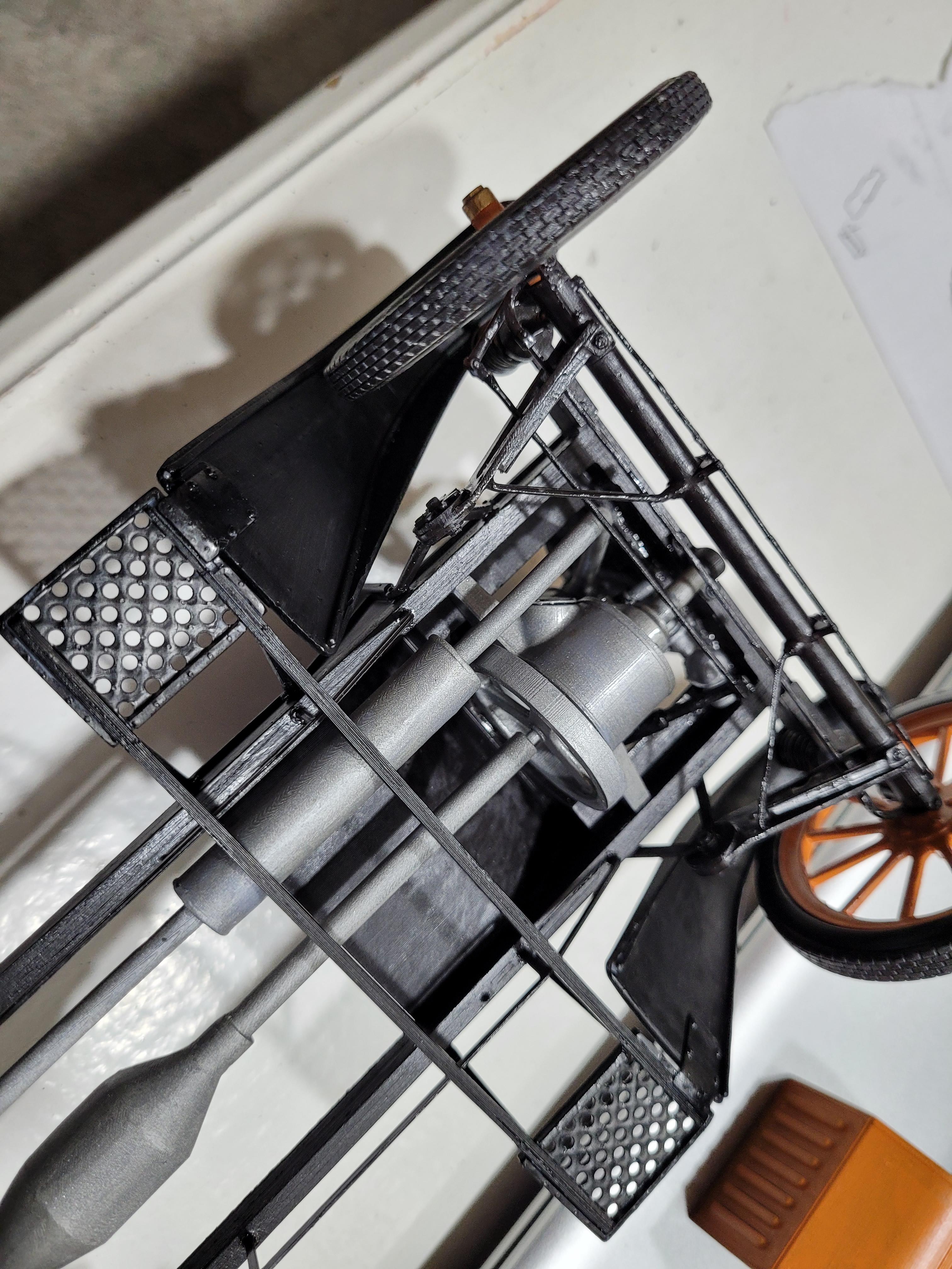

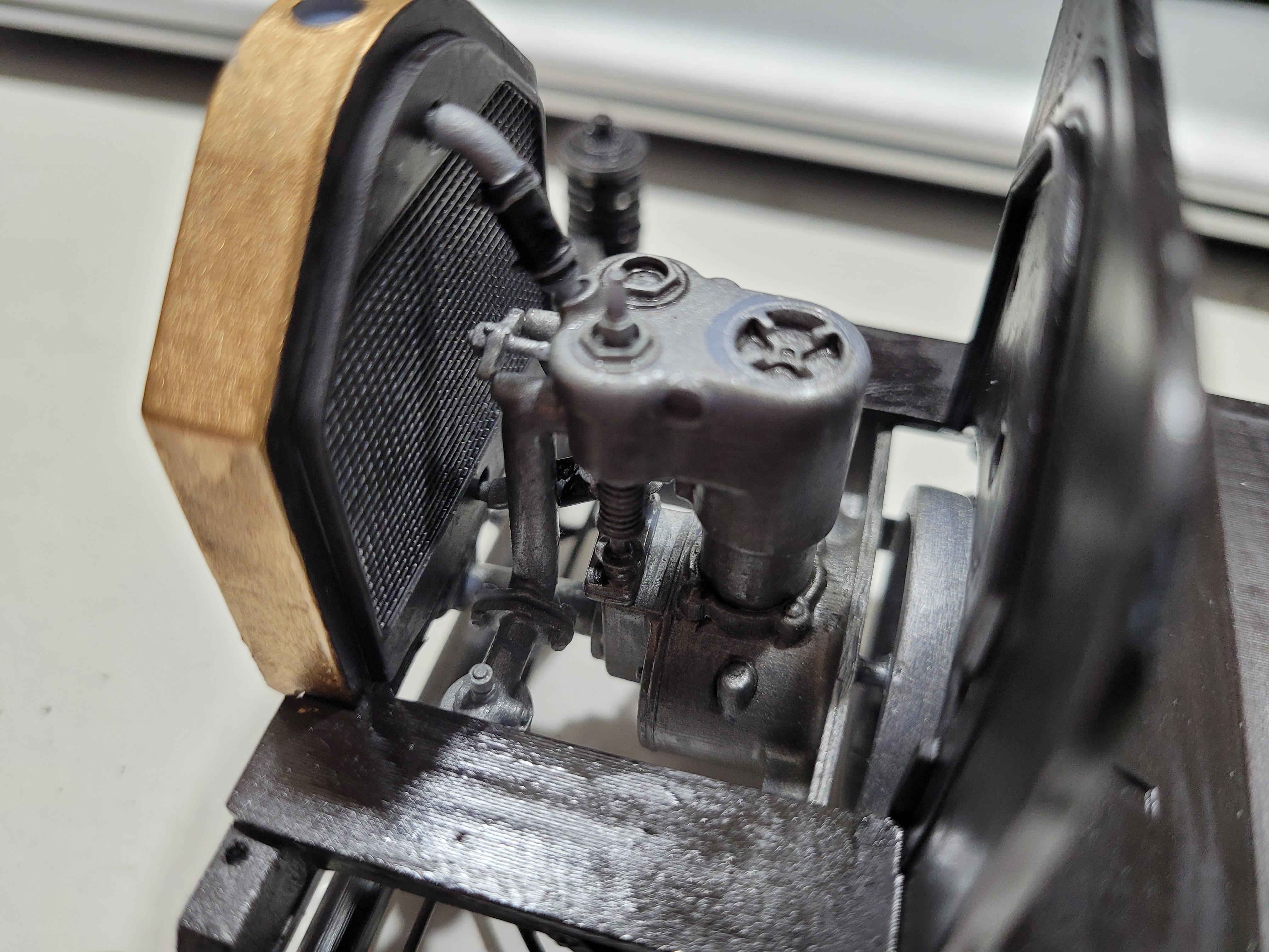

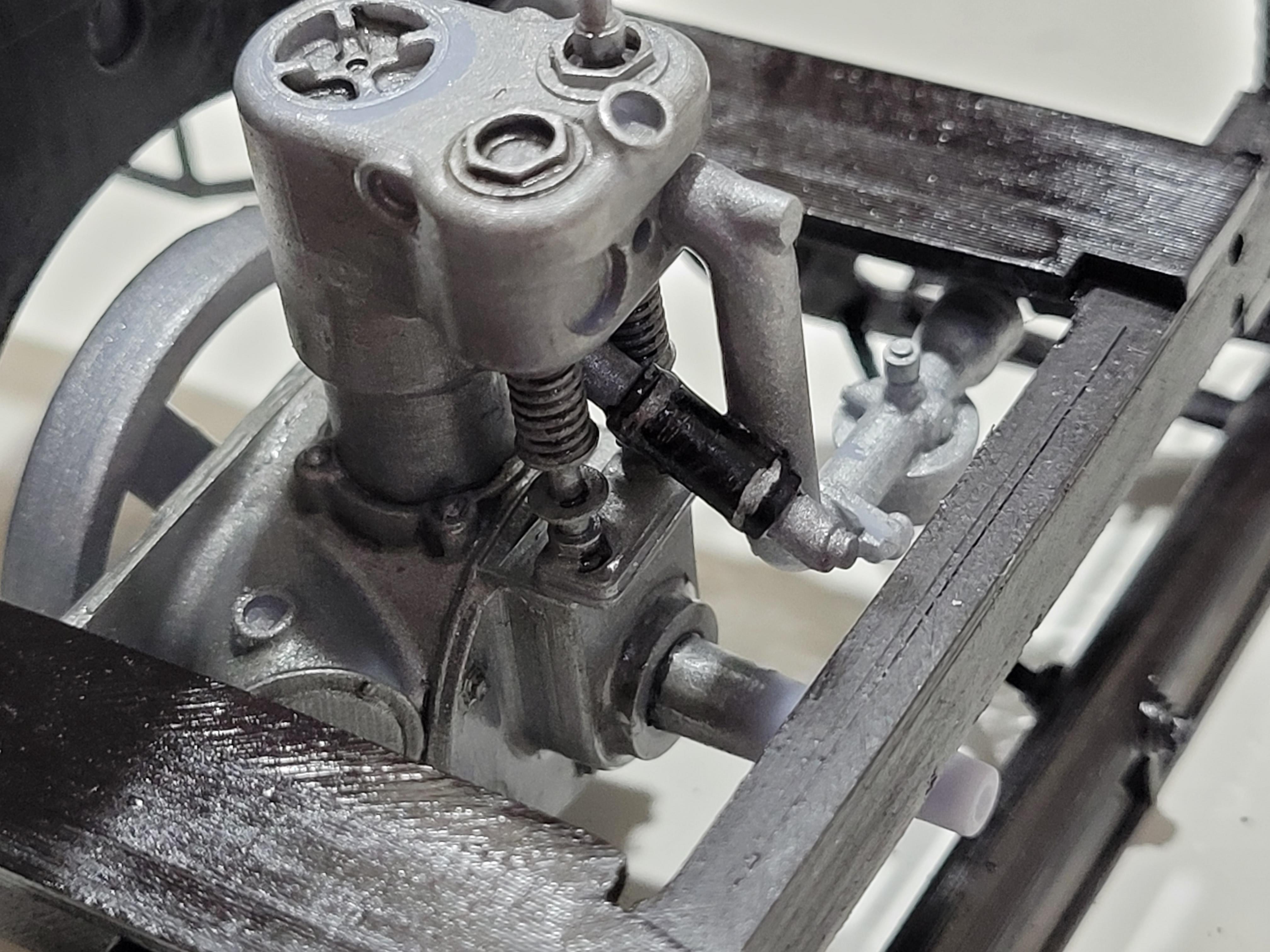

kenlwest Posted April 21, 2024 Author Posted April 21, 2024 Engine in place. There is a crank starter shaft bearing that will pull the engine back to a vertical position.

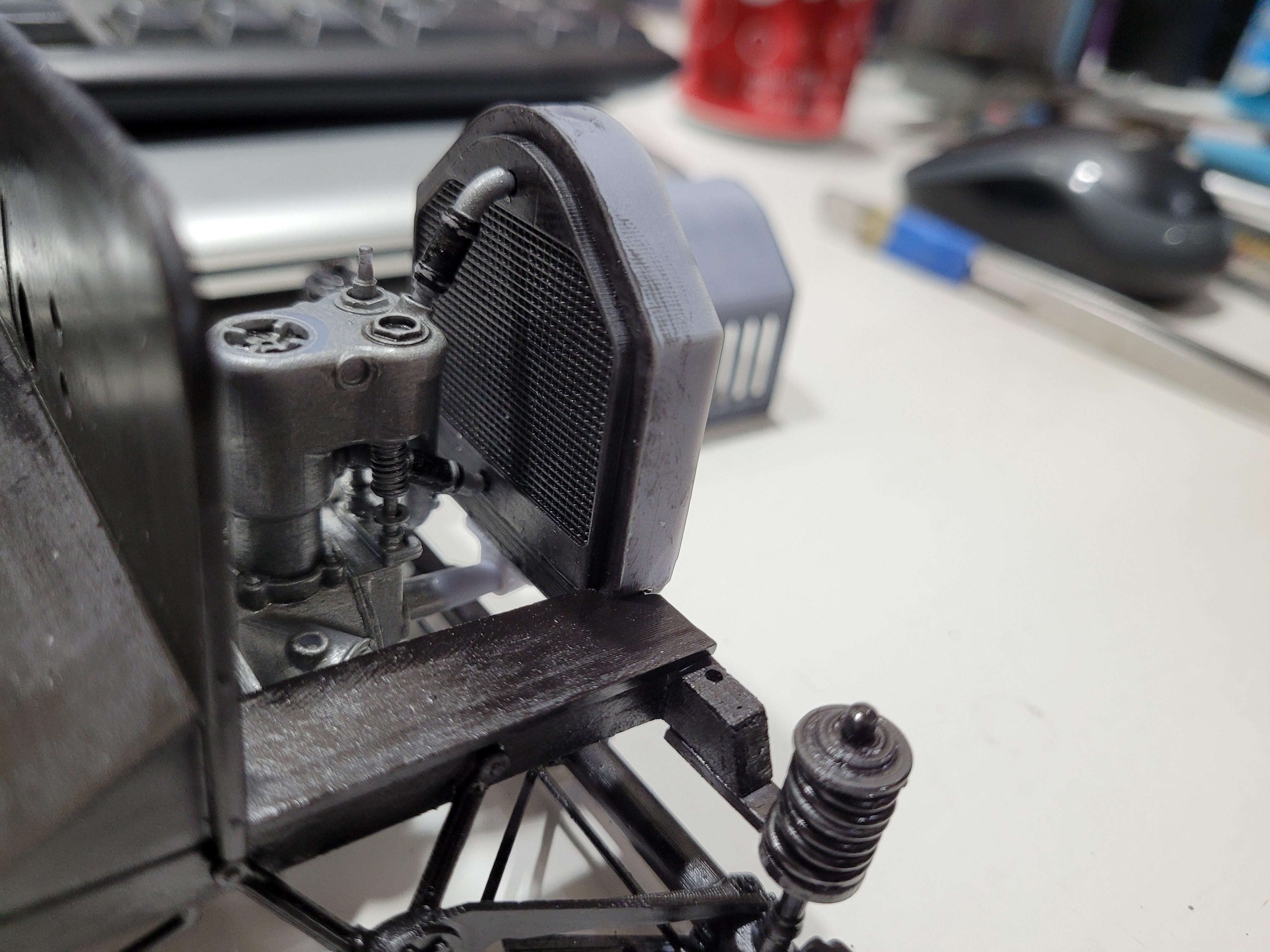

kenlwest Posted April 21, 2024 Author Posted April 21, 2024 Intake pipe, carb, and lower radiator hose. 1

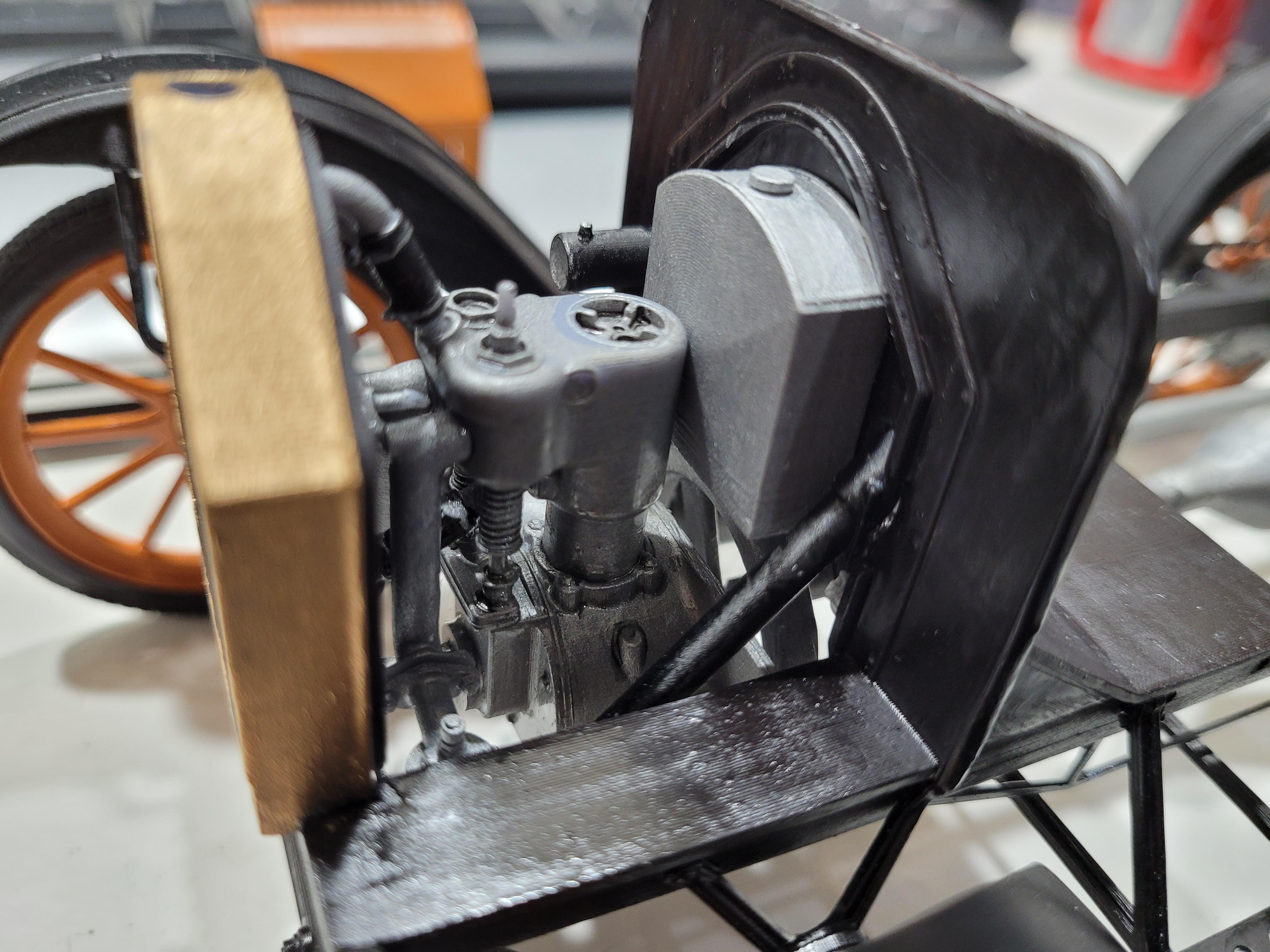

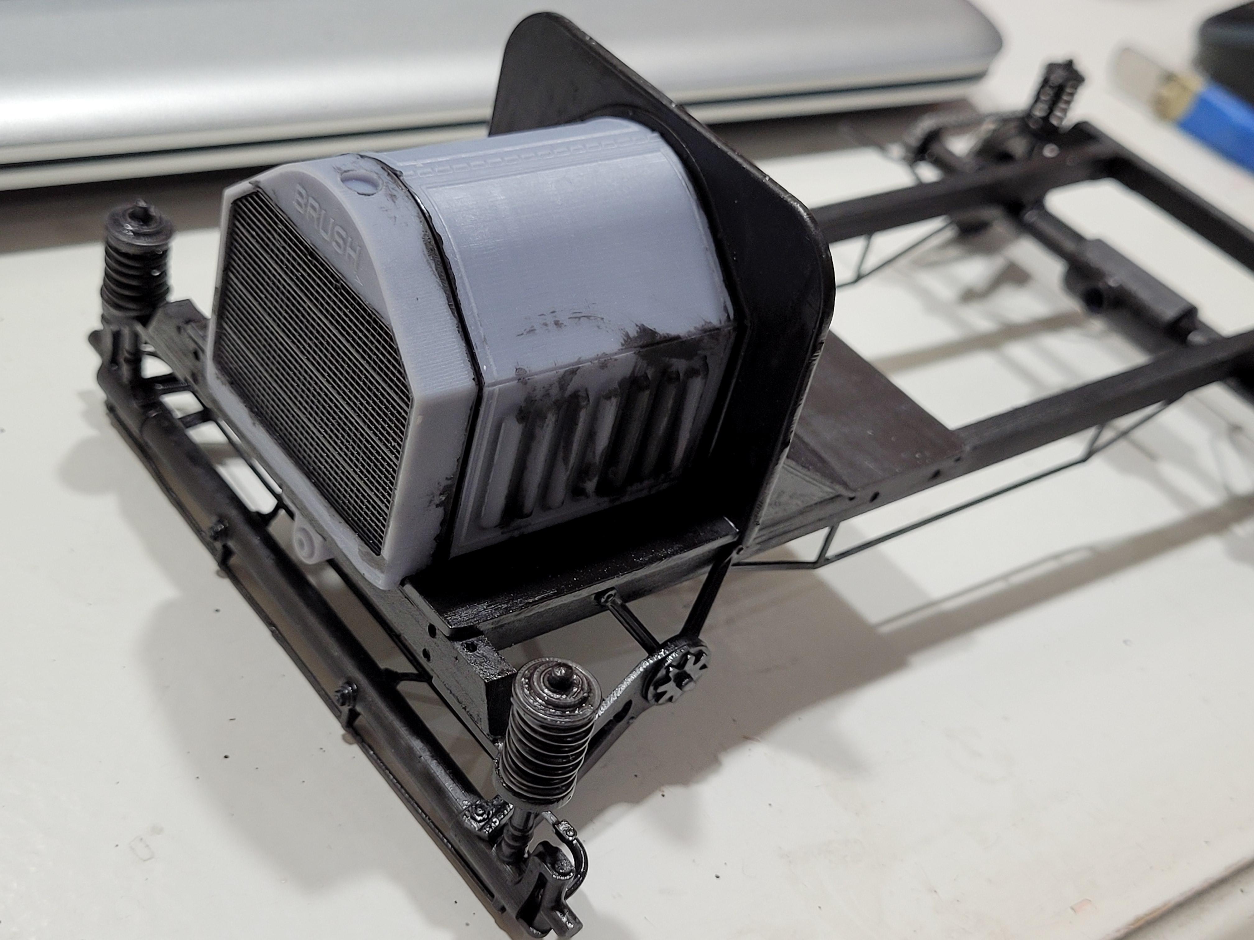

kenlwest Posted April 21, 2024 Author Posted April 21, 2024 Upper radiator hose attached. The hood is used as a locating guide to make sure the radiator is properly set. This also ensures the the hood fits tightly between the cowl and radiator. 1

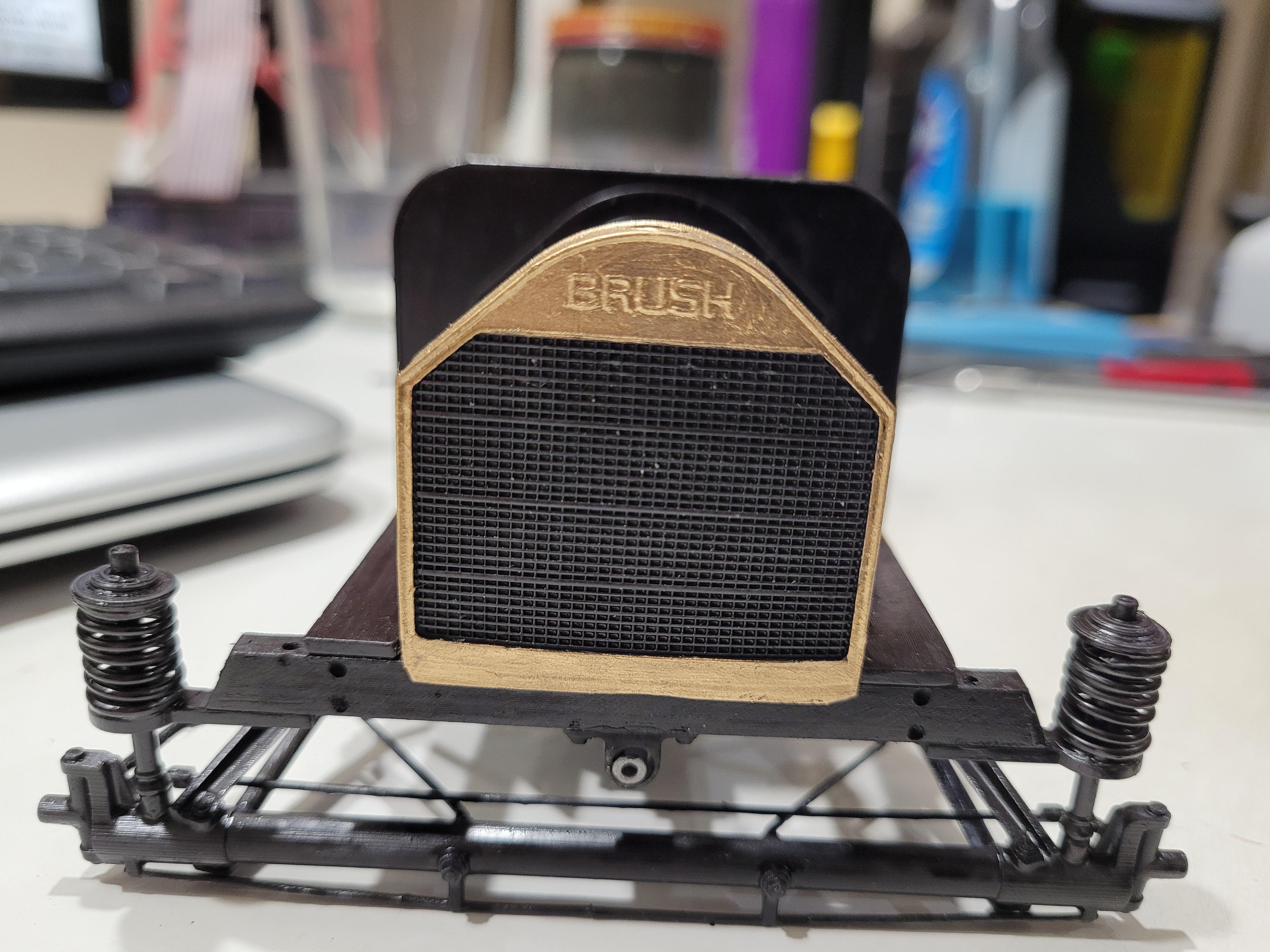

kenlwest Posted April 22, 2024 Author Posted April 22, 2024 The "BRUSH" logo is stamped into the radiator shell, as depicted here.

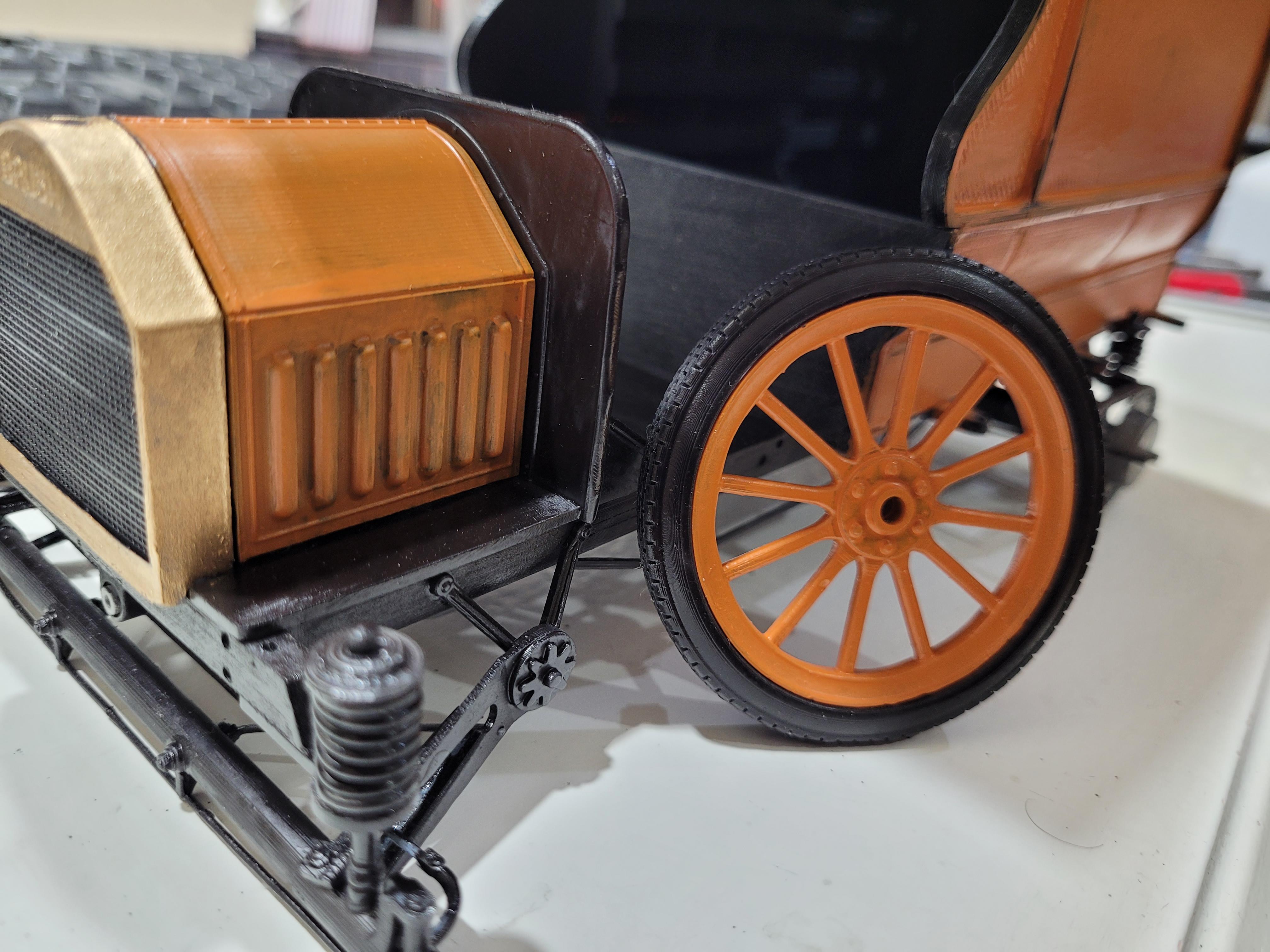

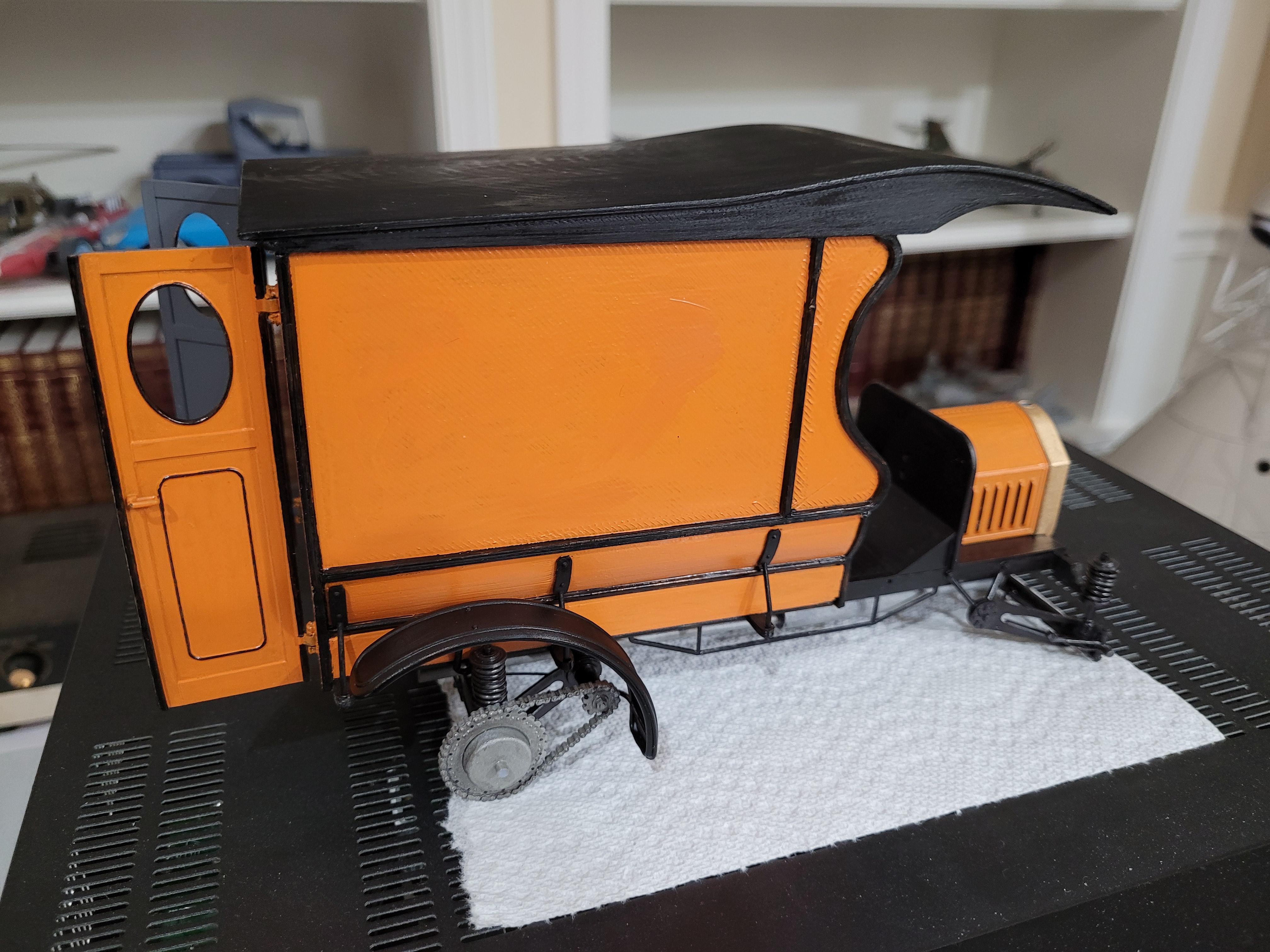

kenlwest Posted April 22, 2024 Author Posted April 22, 2024 A preview of the final color. Rough at this point, but I like the color. I'm still looking for an appropriate business logo for the truck. Most likely a lumber company.

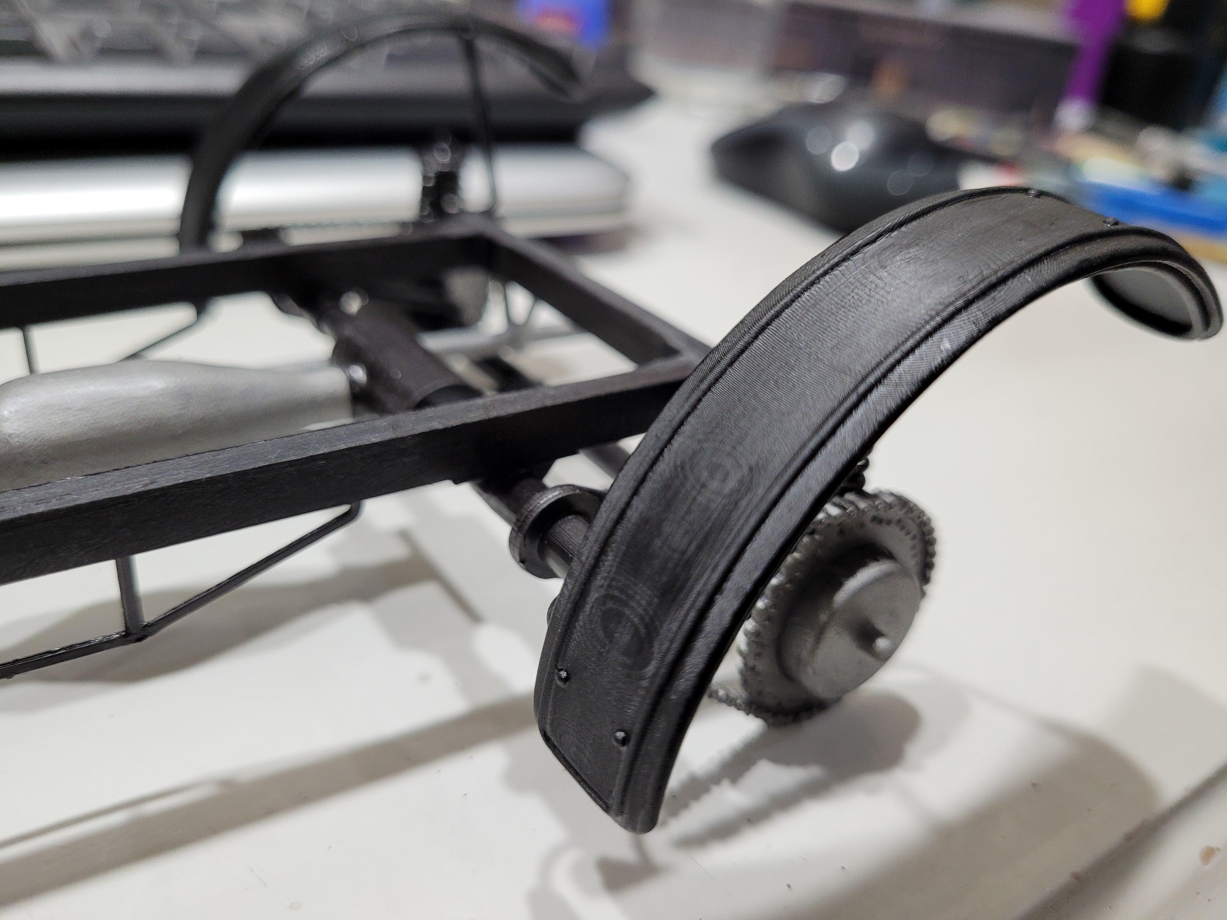

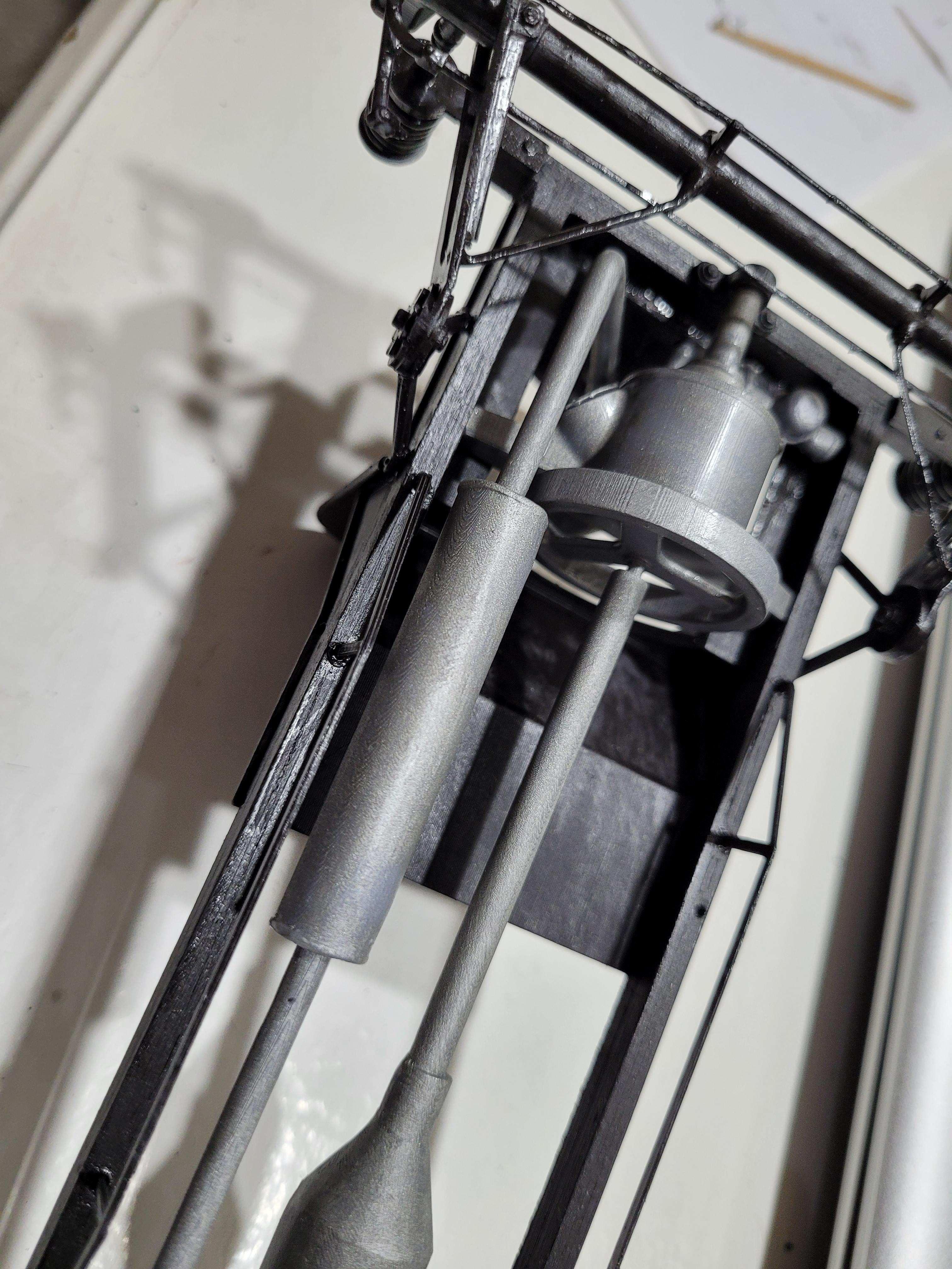

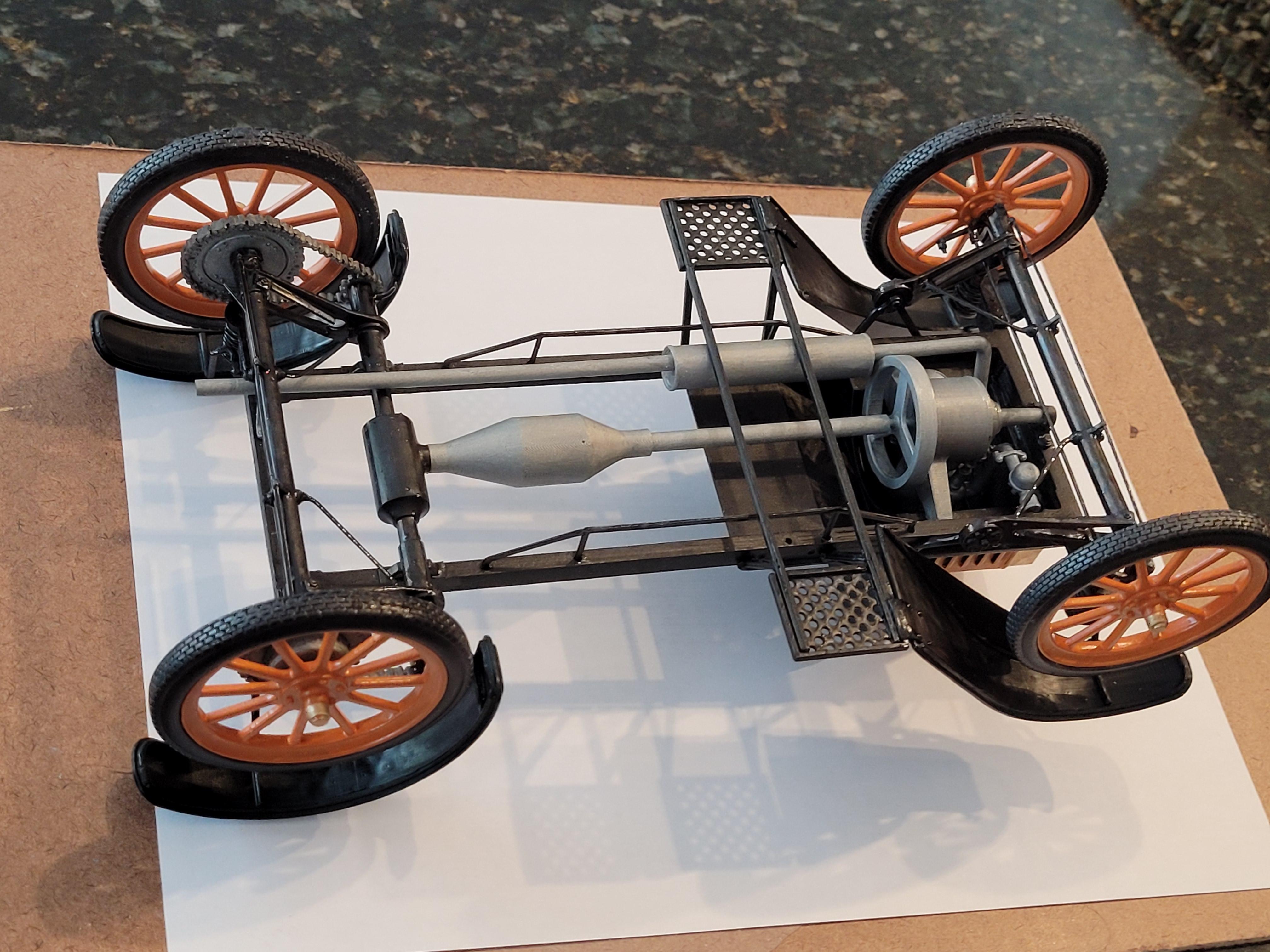

kenlwest Posted April 22, 2024 Author Posted April 22, 2024 The driveshaft, exhaust pipe, muffler, tailpipe and bracket. Note the t-bracket that compresses the intake and exhaust pipes to the head.
kenlwest Posted April 23, 2024 Author Posted April 23, 2024 The vertical golf tee-looking thing is the oil filler tube. The tube is open at the top, but it does have a filter screen to keep larger particles out of the engine.

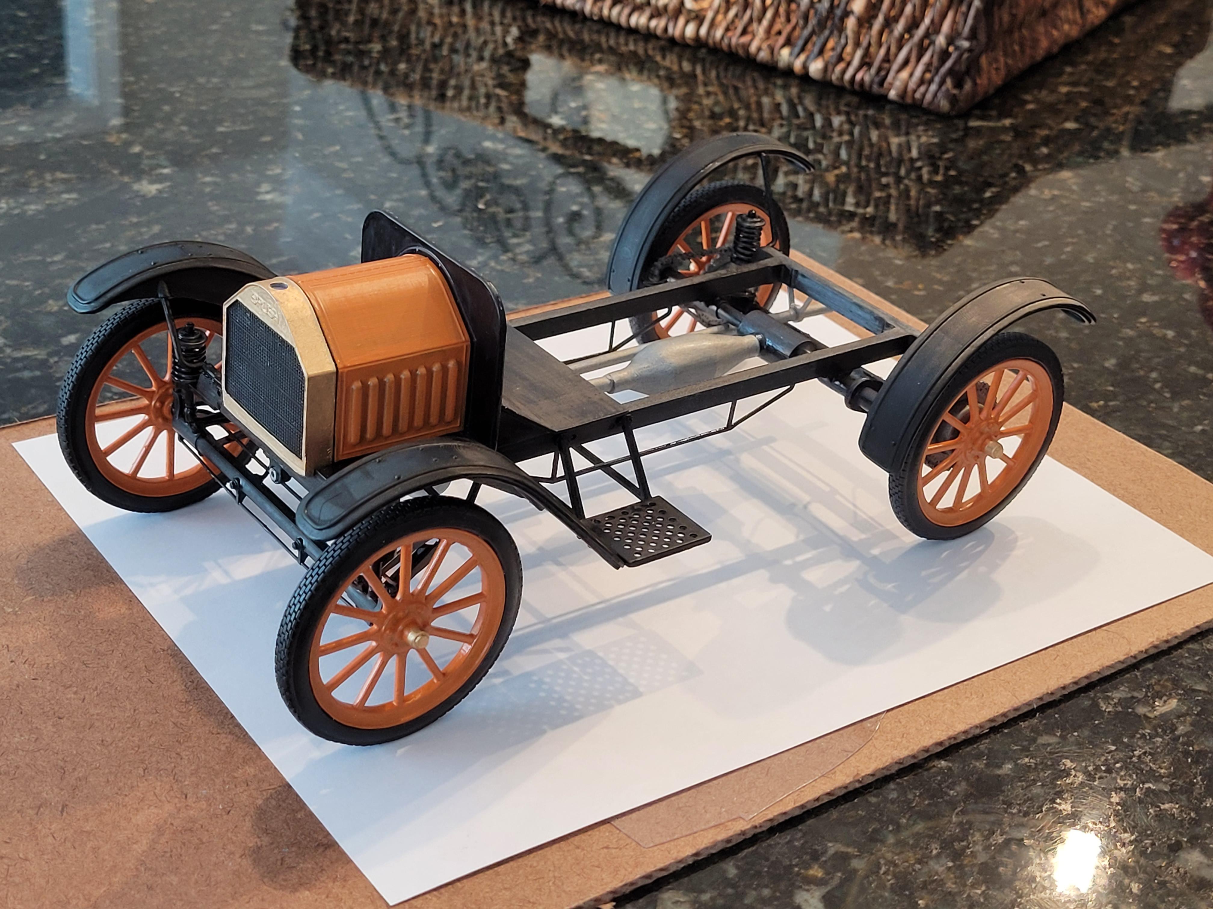

kenlwest Posted April 23, 2024 Author Posted April 23, 2024 Like many other unique features of this vehicle design, the cross braces are used to support the steps, and also to support the front fenders. The wheels are mounted. A lot of details yet to be added. I am still looking for a fake business logo for the side panels.

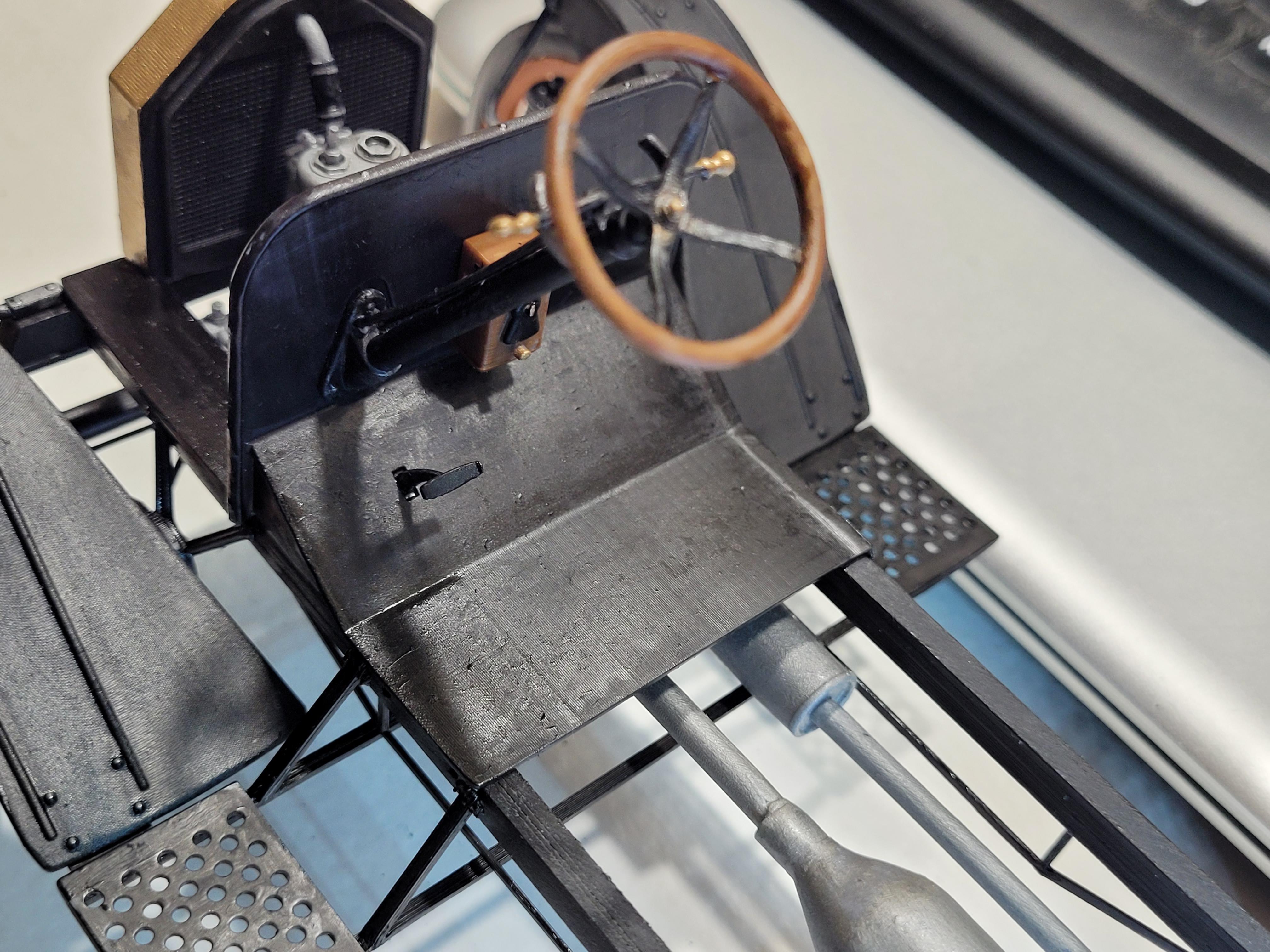

kenlwest Posted April 24, 2024 Author Posted April 24, 2024 The seat cushion and seat back in place. You will notice that the paint finishes on this project look rough and dull. This is intentional. The final coat will be a water-based polyurethane. In my experience, this creates a more antique period look.

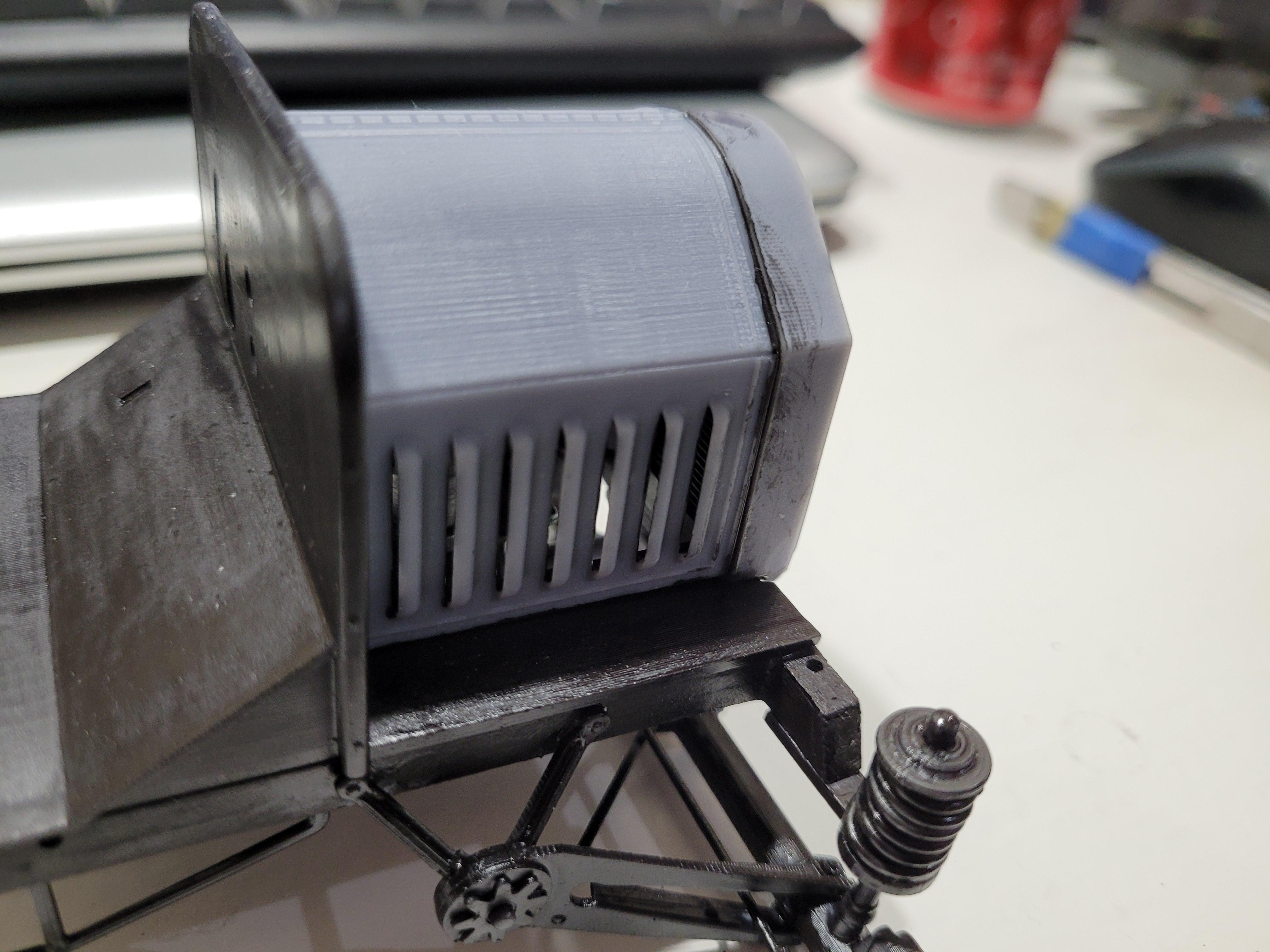

kenlwest Posted April 24, 2024 Author Posted April 24, 2024 The fuel tank is mounted on the cowl panel. I am not sure what the horizontal black cylinder is for. The engine side of the steering column is in place and connected to the drag link.
