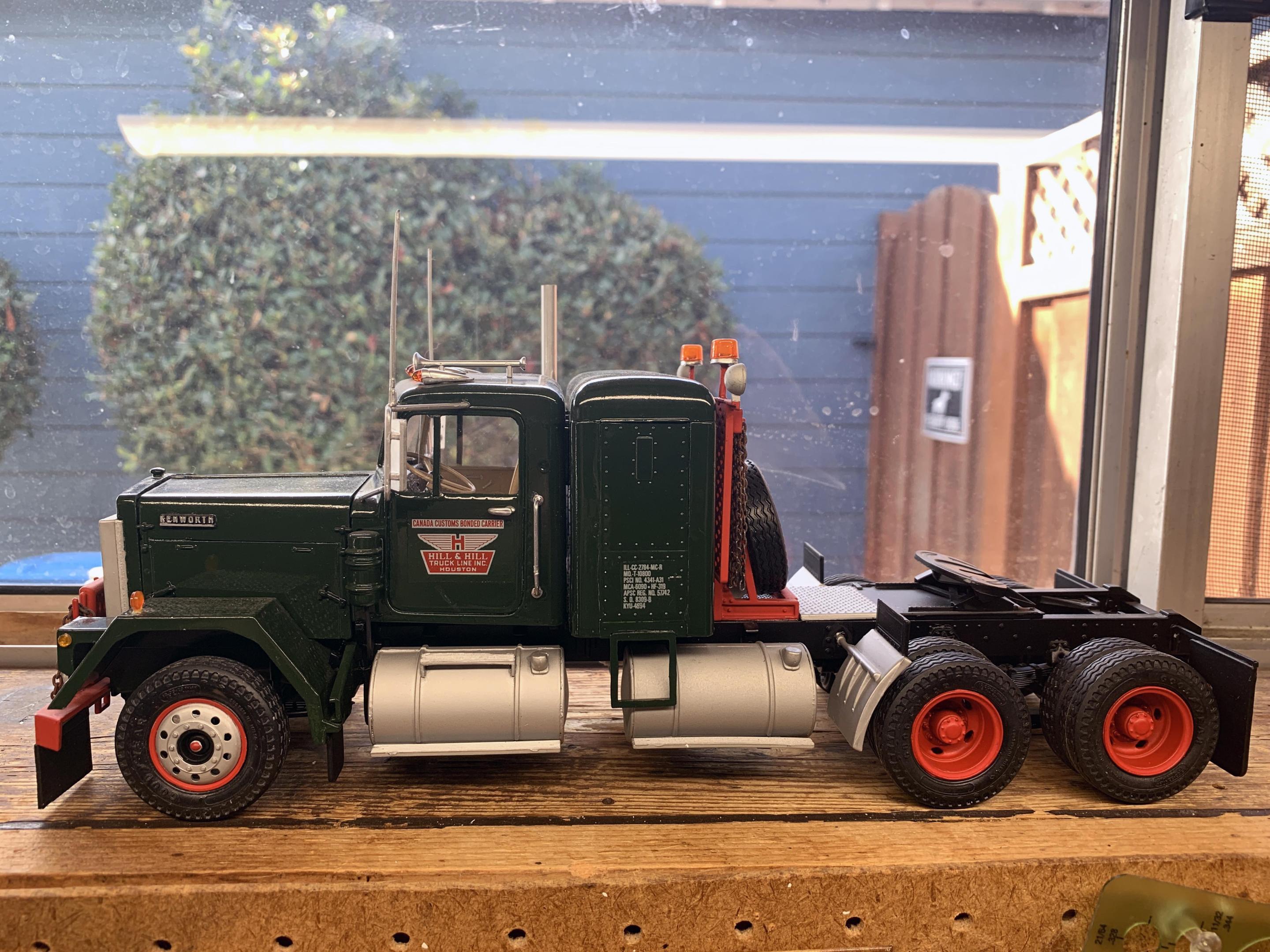

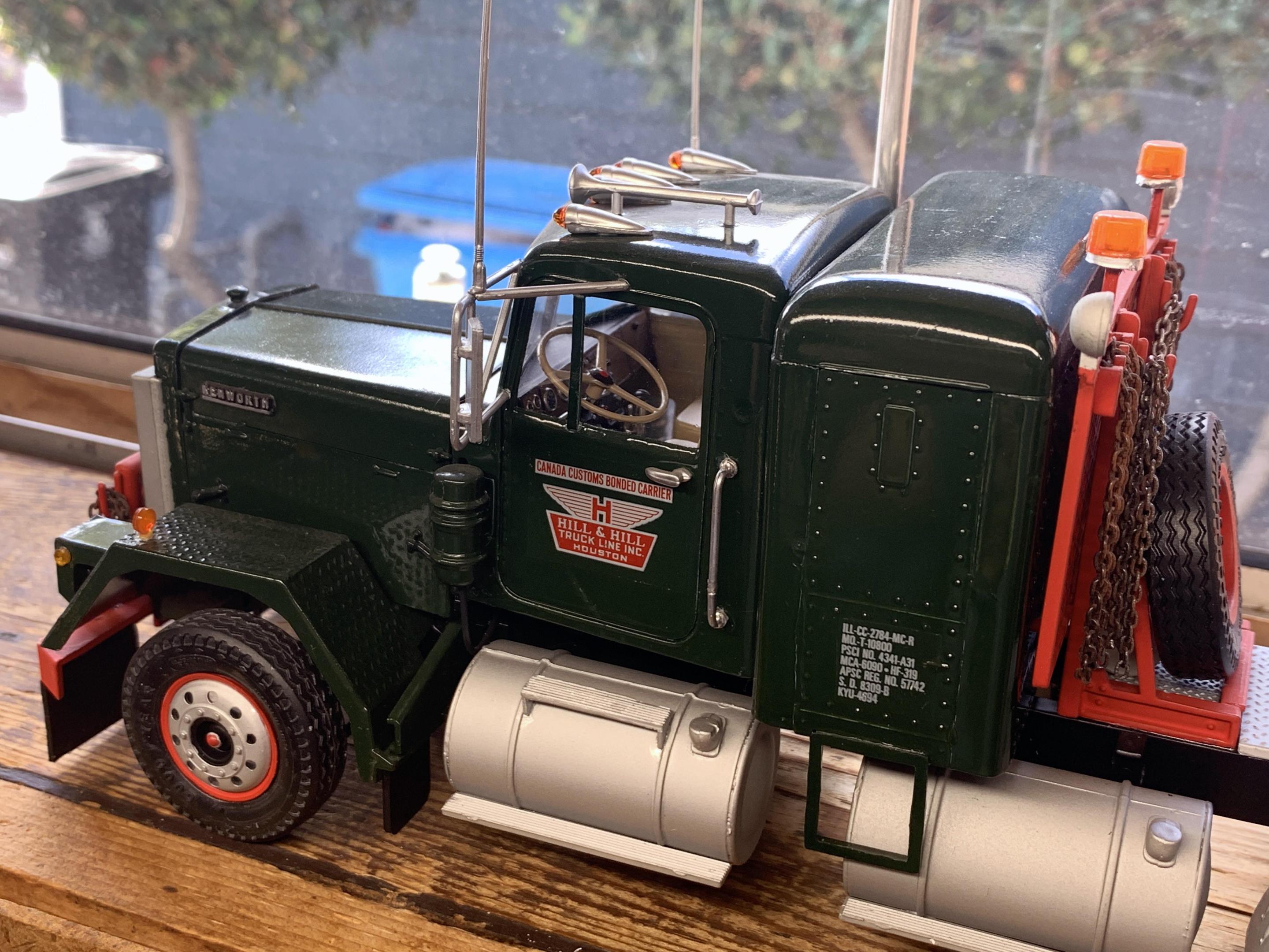

JerseeJerry55 Posted May 6, 2024 Author Posted May 6, 2024 So after having this play over in my mind in what seems like forever over the weekend I am back to questioning what/how I want to build her. Since the Alaskan Hauler comes with all the parts to actually build it as a W925 I am at a bigger impasse. The following is what I am tossing around in my mind. The Watkins unit is easy, the Alaskan Hauler not so much. The AH questions I have are below. Do I use the visor? Most pictures I have seen of the Hill & Hill units they did not. How do I modify and remove the left side air cleaner part molded into the cab? An exacto knife then sand it down even? Single or dual air horns? Where the left exhaust stack goes are the two holes how do you remedy that? I figure putty would work, but I suck at puttying, sanding smooth. The left side of the cab has a small hole to the left, and slightly above the vent near the door. I actually thought about mounting a luberfiner there as I saw a couple of pictures of a Hill & Hill unit with a painted luberfiner. I'm sure I will have a billion more questions so apologizing in advance. Thank you. Kind regards, Jersee Jerry
steve1970 Posted May 12, 2024 Posted May 12, 2024 If doing the AH (I think it's a W-923) I've mostly seen the following: • single air horn • no visor • single stack (passenger side) • single air cleaner (passenger side) • putty (or glue) in the holes for driver side stack. • Driver side luberfiner • extra gas tank, driver side • some variation of green or red on radiator
