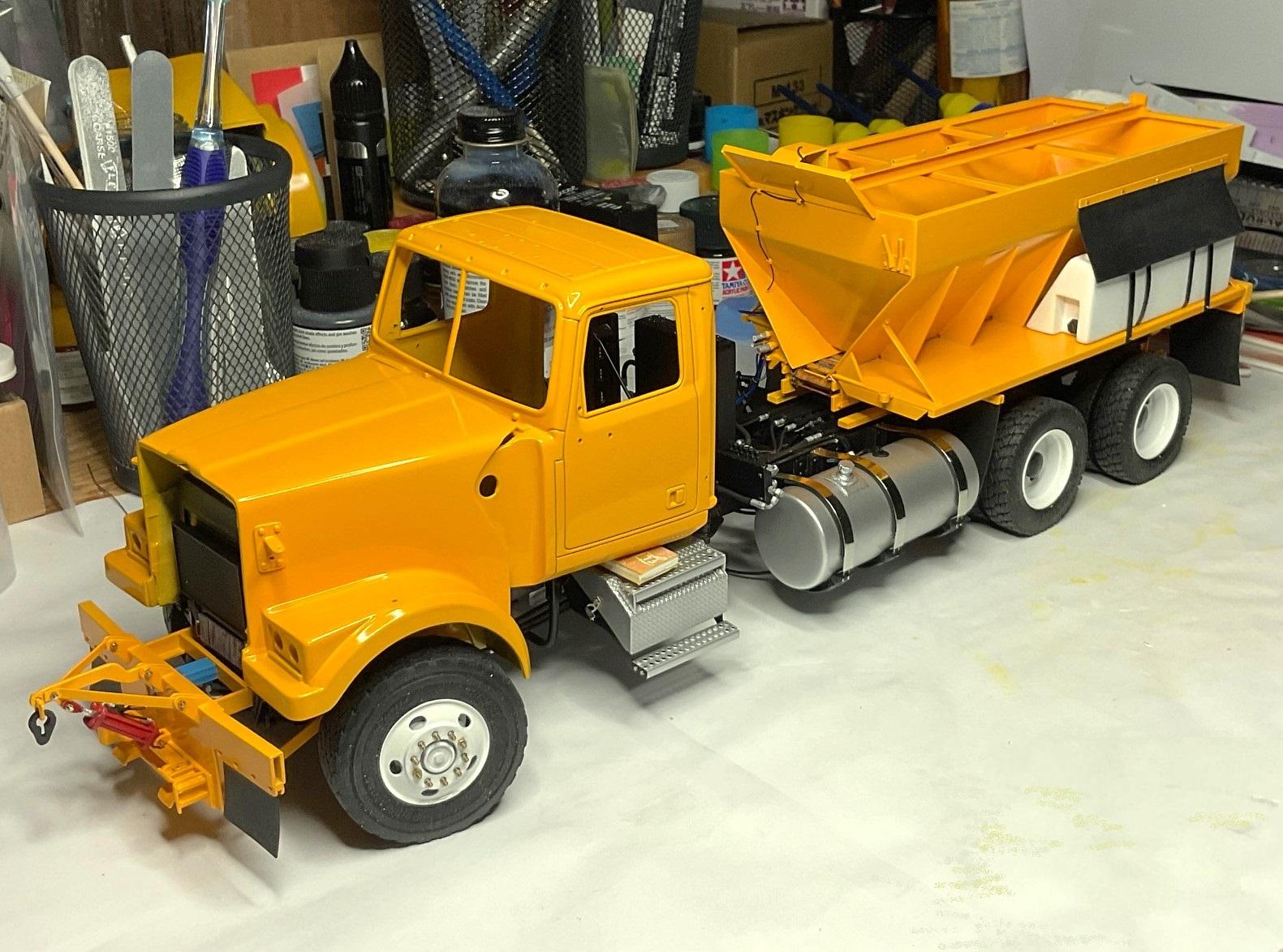

BK9300 Posted Wednesday at 10:53 PM Author Posted Wednesday at 10:53 PM (edited) Paint pictures sure aren't the most exciting part of this build, so bear with me, as the pics will show me all the things I need to work on. It must be said that I have had more than a few bad results, way back when, so, was quite pleased with the first colour coat for the cab, hood and day cab panel, today. Have a good ways to go, yet, to improve the finish from where it's at now, but happy having some colour underway! Just about too warm to be painting - never thought to check till after I was finished . . . I'm using an Iwata Neo, siphon feed with a small bottle, so didn't have to stop and refill along the way. Some colour unevenness showing up after first coat, but that can be remedied Looks more like the real truck's paint, in sunlight - Colour unevenness more evident under the desk lamp - will have to take note, for next coat. I may need to rig up a holder so I can paint them both at the same time, maybe. Will see after second coat tomorrow _ In spite of much fussing with prep work, priming, sanding a bit, priming, there are still some sanding marks to clean up. Also, once cured a bit, will start in right away with the orange peel. I noticed with the sander, after sanding out some dust spots between coats, the following coat(s) were much smoother - that process might be well known to others, but was a nice surprise to me. I'll try to be more thorough and intentional with the light sanding between coats this time. I am, however, quite happy with how the work on the top rib on the hood and the fender to hood skirt repairs look under paint. That was another big concern I had for today - grateful how it has turned out, so far! Going to let things set up for a day, or so, and then get to some light sanding. Meantime, I can work on re-chroming the bits for the cab. I won't have much of an opportunity to sand out any problems with those tiny pieces, so, once chromed, they may just 'be what they will be'. Take care! Edited Thursday at 12:12 AM by BK9300 typo 4
Biggu Posted Thursday at 12:14 AM Posted Thursday at 12:14 AM Wow. That is nice. Almost like a show truck. Flagship of the fleet. Your paint is way better than anything I do. Are you using lacquer paint? Sure looks smooth to me. Lovin this.
BK9300 Posted Thursday at 12:32 AM Author Posted Thursday at 12:32 AM (edited) 18 minutes ago, Biggu said: Wow. That is nice. Almost like a show truck. Flagship of the fleet. Your paint is way better than anything I do. Are you using lacquer paint? Sure looks smooth to me. Lovin this. Appreciate that, Jeff! I'm using a lacquer - Tamiya TS-34, Camel Yellow - a pretty close match to Wheatland Yellow, without mixing in anything else. I did decant a couple spray cans, to use in the air brush. Paint looks ok, if no light reflecting off a flatter surface, but close inspection shows lots of smallish orange peel. I didn't sand final primer layer, so maybe that's why? Hoping to improve on it with prep for next coat. Thanks, again! Edited Thursday at 12:33 AM by BK9300 2
