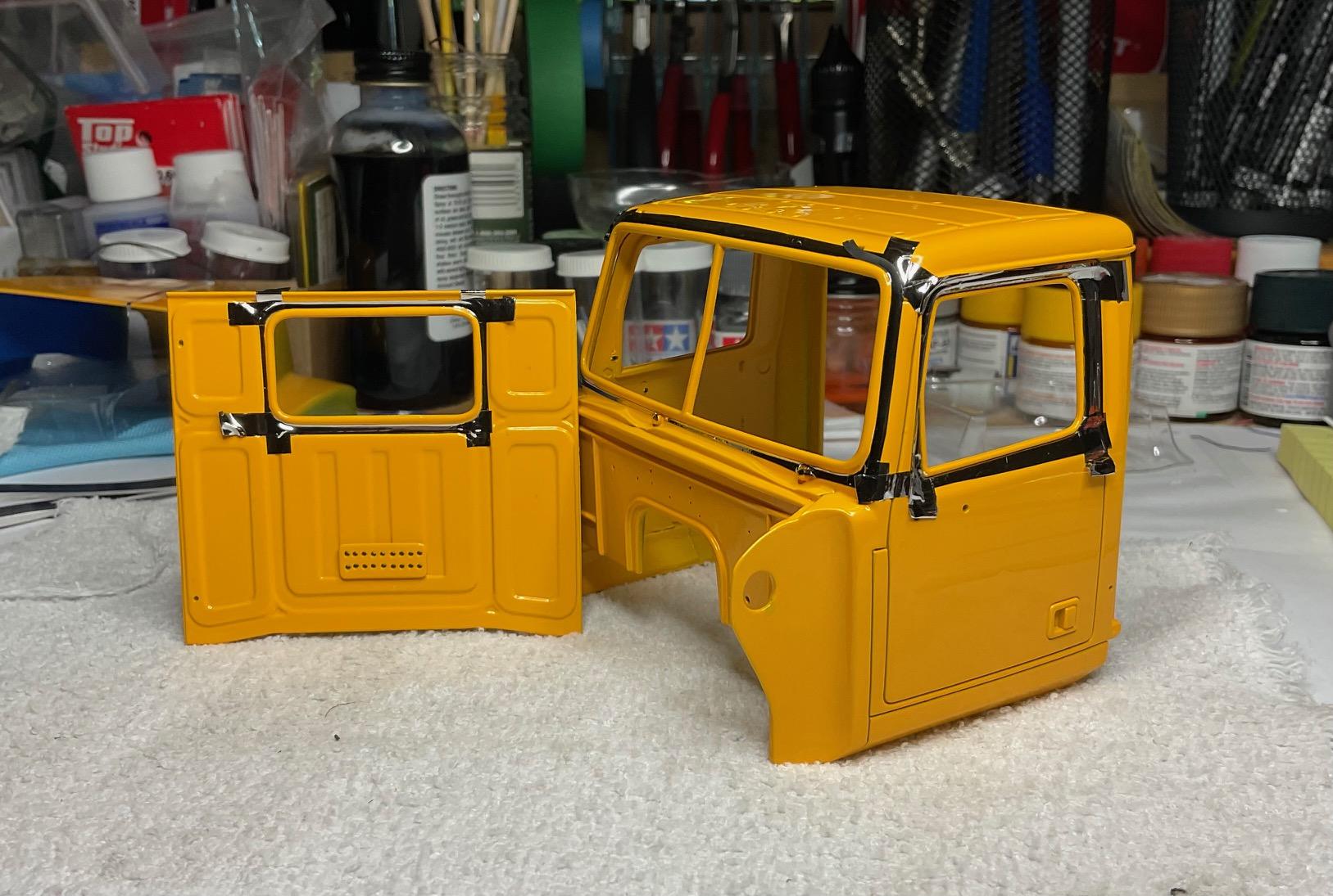

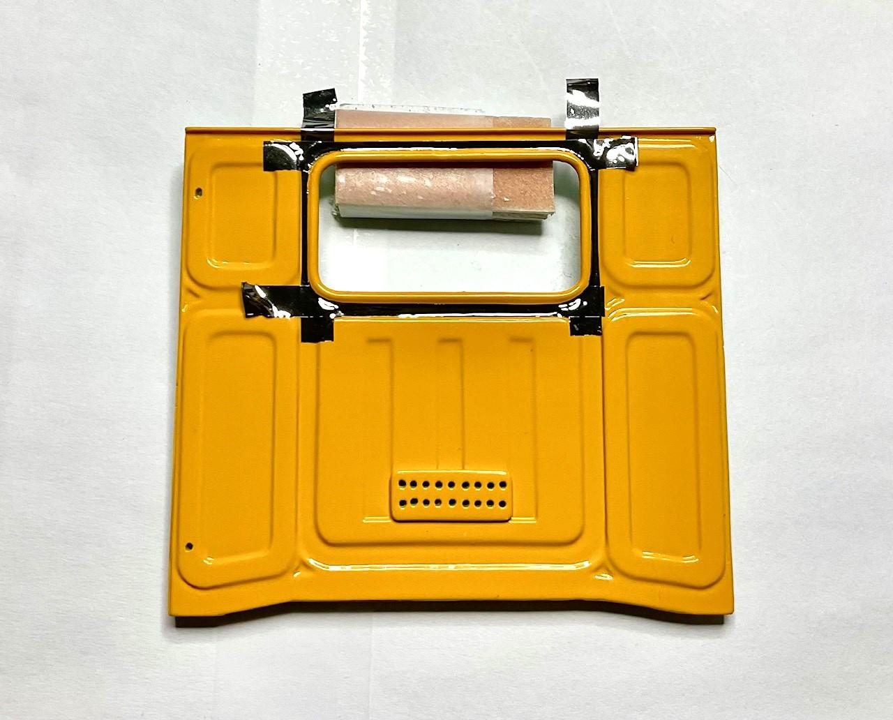

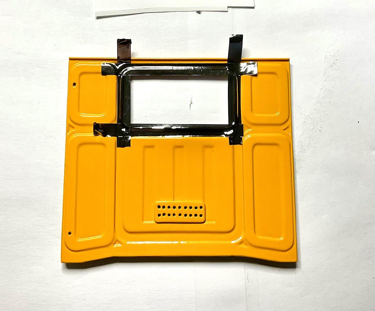

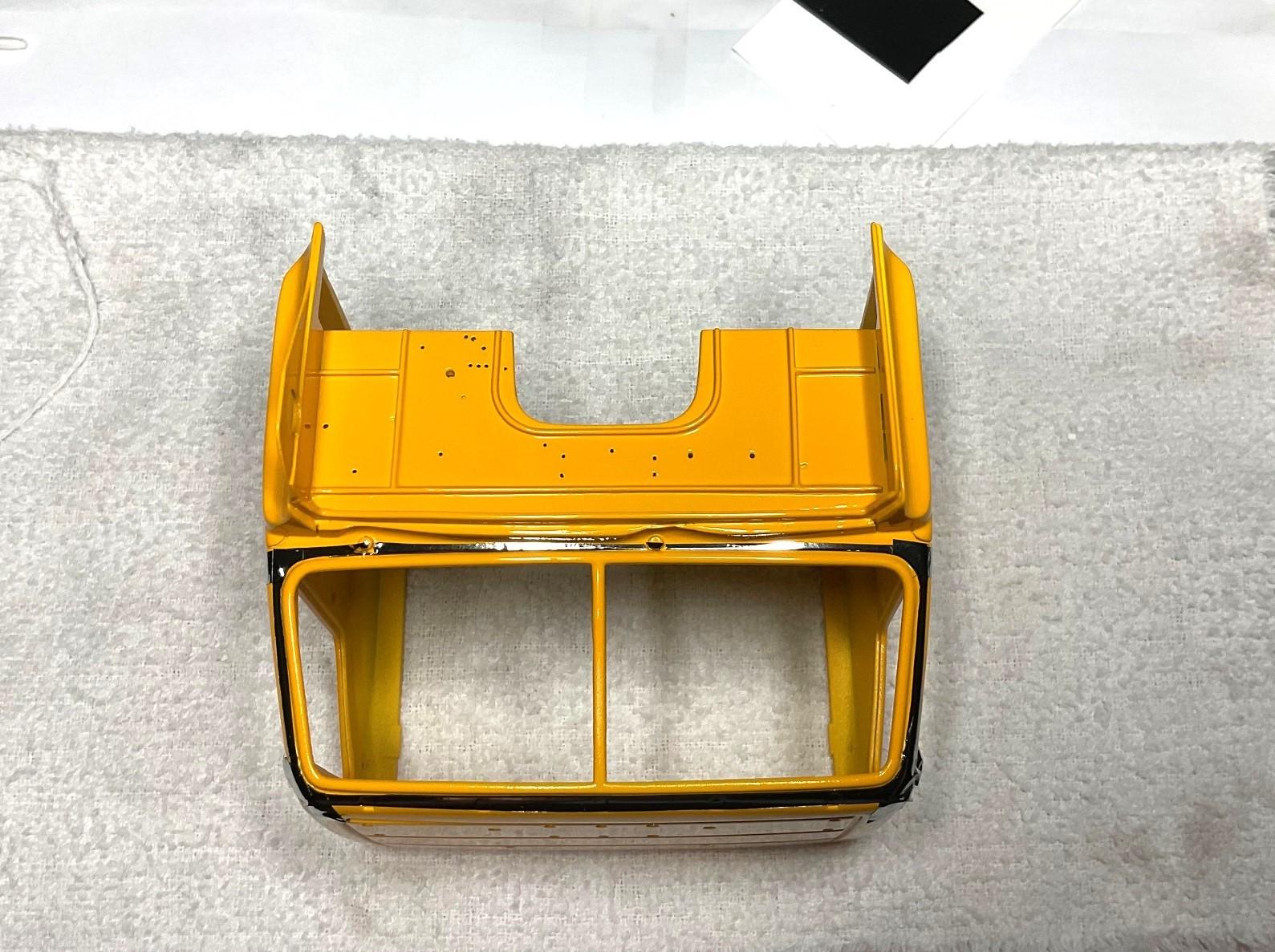

I started in with cab again, this morning, intending to get the window seals painted black.  Thought about masking the whole cab, leaving just the seals, and spraying them, and just as quickly talked myself out of it - worried about a screwup on the polished finish!  I never got to painting today, but did manage to get the seals isolated by using some stretchy, Tamiya chrome film.  Said it before, but I'm finding myself more uncertain doing the fine detailing, than at any time doing the actual building of the the model - go figure!  Maybe I'll still brush paint the seals later today.
So, the plan was to use strips of the adhesive, stretchy film to cover a small border around the seals, and re-expose the seals by using a new X-acto blade to trim and remove the tape covering the seals -
This was the third effort to apply the film and make clean cuts all the way around the rear seal - I've still ended up with a bit of mess in the upper, driver's side corner -
Wasn't able to get any overlap at the windshield wiper mounts, so will have to be careful painting those areas -
Doing all that, I managed to re-break/crack the center windshield support post at the old break - not visible now, but is when the windshield is pressed up against it -
Really hoping this will work out - looking at the pics, I'm sure I can't put too much paint on, or removing the film might chip the paint.  Maybe remove the film before the enamel paint has fully set up.  It will either work, or could be faced with an unwelcome do-over.  I'd rather build another front plow than face that prospect!
