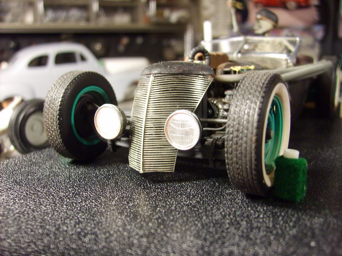

Bobdude Posted April 11, 2009 Posted April 11, 2009 Has anyone ever had any luck getting one of these grilles formed up and attached to a model?
James W Posted April 12, 2009 Posted April 12, 2009 This is a tough one but it can be done, I was just glad I did not need it perfect. First I bent the halves to the curves needed, then I began gluing from the top. About a quarter inch to start using CA glue. I added a piece of wire to the back to give it more material for the glue to hold, then I bent the halves together and worked down the center seam. When the halves are correctly bent, they will sit with the center seam flat on a surface like a table, then they could be glued together all at once. Not easy, but not impossible. As long as you don't wad it up you can keep trying until it works.
