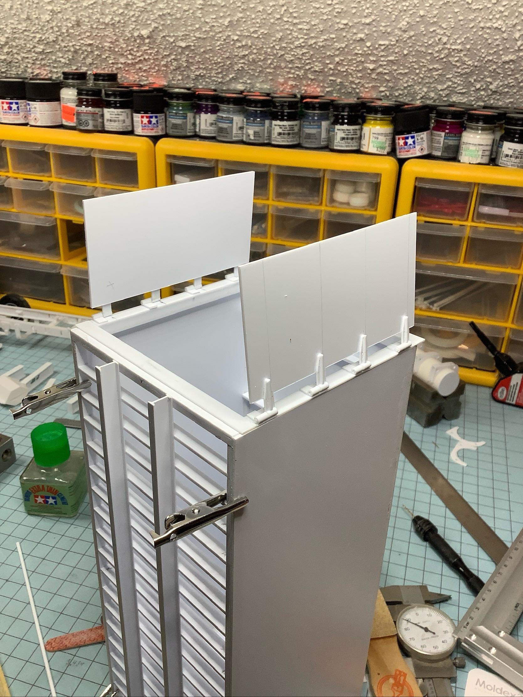

Gary Chastain Posted October 30, 2024 Author Posted October 30, 2024 Can I get some feedback from you guys. The top hinge is the original I made (looks a bit bulky), the bottom hinge is .010 thinner but I added a center rib because I am afraid it will flex and break the glue joint. requires more finish work but you get the idea. Does it need to be longer, reach further out into the door. Appreciate any feedback. 2
Jürgen M. Posted October 30, 2024 Posted October 30, 2024 I think your self made hinge looks pretty good! Not at all bulky! The additional rib on the other one looks very authentic. Why not add that to the self made one? If it needs to reach further into the door depends on the power your glue has got! Just for looks I wouldn't make it longer! But that's my opinion! 1
BK9300 Posted October 30, 2024 Posted October 30, 2024 In my opinion, with your addition of the strengthening rib, and the fact that you intend to put three hinges on each door, the weight of the doors shouldn't stress the hinges enough to make them fail. I think where the hinge plate attaches to the hinge barrel will be the weakest point - even so, with three hinges, each door should work well. 1
Biggu Posted October 30, 2024 Posted October 30, 2024 Gary I think your hinge looks really good, but maybe a little longer and one or two more? This trailer has 5 hinges, and a quick look about , most have at least 4 and most have 5, not sure how detailed you want to get or how much work you want, but this just may make the waters a bit more muddy..... 1
Gary Chastain Posted October 31, 2024 Author Posted October 31, 2024 5 hours ago, Jürgen M. said: I think your self made hinge looks pretty good! Not at all bulky! The additional rib on the other one looks very authentic. Why not add that to the self made one? If it needs to reach further into the door depends on the power your glue has got! Just for looks I wouldn't make it longer! But that's my opinion! 5 hours ago, BK9300 said: In my opinion, with your addition of the strengthening rib, and the fact that you intend to put three hinges on each door, the weight of the doors shouldn't stress the hinges enough to make them fail. I think where the hinge plate attaches to the hinge barrel will be the weakest point - even so, with three hinges, each door should work well. 4 hours ago, Biggu said: Gary I think your hinge looks really good, but maybe a little longer and one or two more? This trailer has 5 hinges, and a quick look about , most have at least 4 and most have 5, not sure how detailed you want to get or how much work you want, but this just may make the waters a bit more muddy..... Thanks guys for taking time to give me feedback. Going to build the hinge with the rib, I will use four hinges per door as the box is shorter than a semi trailer. 1
Jürgen M. Posted October 31, 2024 Posted October 31, 2024 Sounds like a good compromise! I'm sure it'll look great! 1

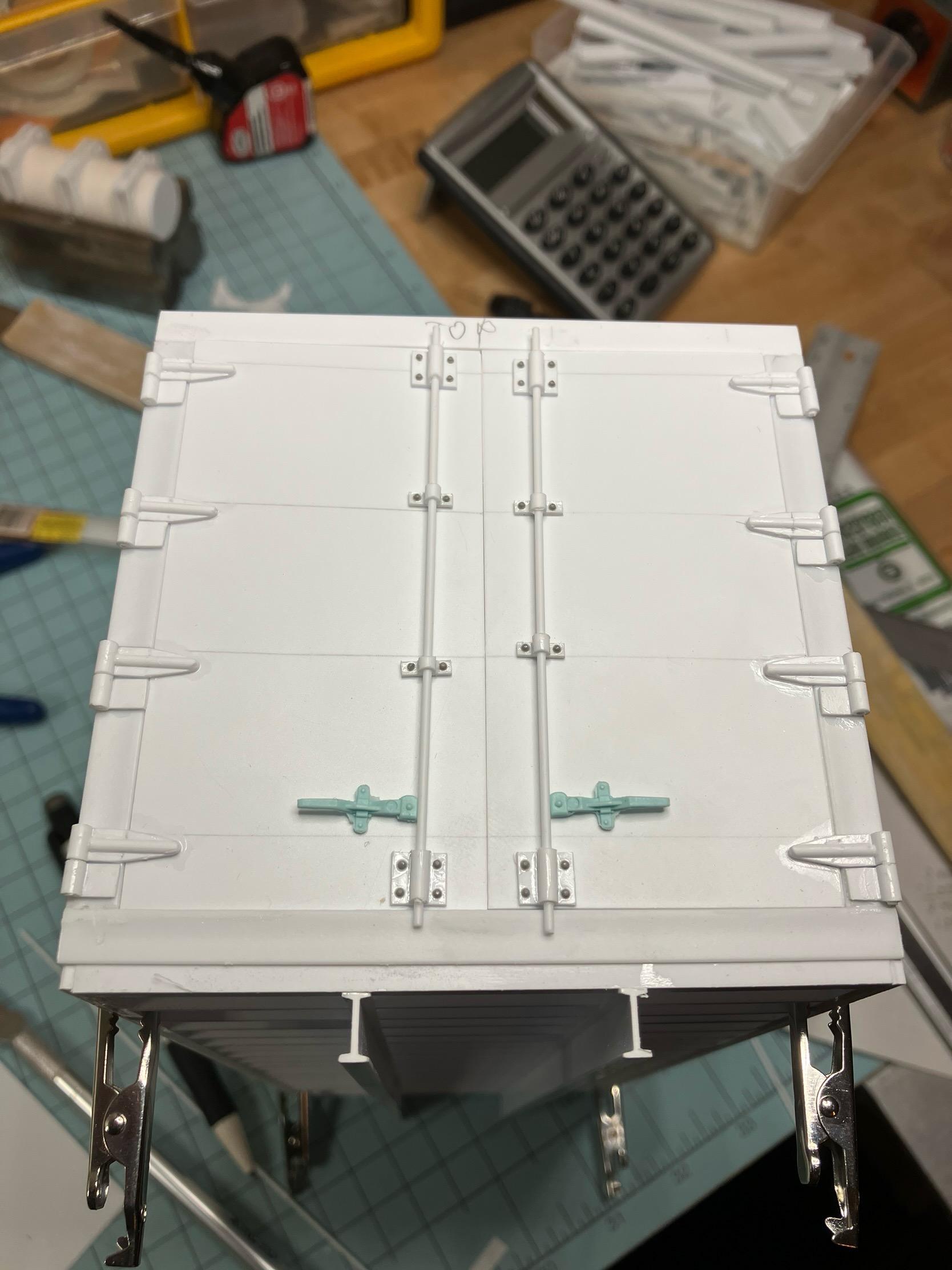

Gary Chastain Posted October 31, 2024 Author Posted October 31, 2024 (edited) Rear door hinges fabricated up, next layout position and glue. Need some minor finish work. Edited October 31, 2024 by Gary Chastain Spelling 3
Gary Chastain Posted November 4, 2024 Author Posted November 4, 2024 And they actually work, got the hinges wrapped up and glued on. Now to build the door latches. 3

Gary Chastain Posted November 4, 2024 Author Posted November 4, 2024 (edited) Need to make the latches top and bottom for each door, next. will not glue latch assembly on doors until after paint, doors will be painted white with an aluminum color around the perimeter of each door, latch will be painted aluminum then attached. I should be able to slide the decal under the latch for the beer logo. Edited November 4, 2024 by Gary Chastain Added verbage 3
Biggu Posted November 4, 2024 Posted November 4, 2024 Those doors are beautiful. Love the hinges and with the latches look top drawer ….. all we need now is BEER! ??? 1
Rockford Posted November 5, 2024 Posted November 5, 2024 What a tidy, squared up job! Your usual standard. 1
Gary Chastain Posted November 5, 2024 Author Posted November 5, 2024 23 hours ago, Biggu said: Those doors are beautiful. Love the hinges and with the latches look top drawer ….. all we need now is BEER! ??? Thanks Jeff, agree on the beer 7 minutes ago, Rockford said: What a tidy, squared up job! Your usual standard. thanks Steve, trying to reach your build standard??, you guys just keep raising the bar. I’m just trying to keep up and stealing ideas from you guys. 1

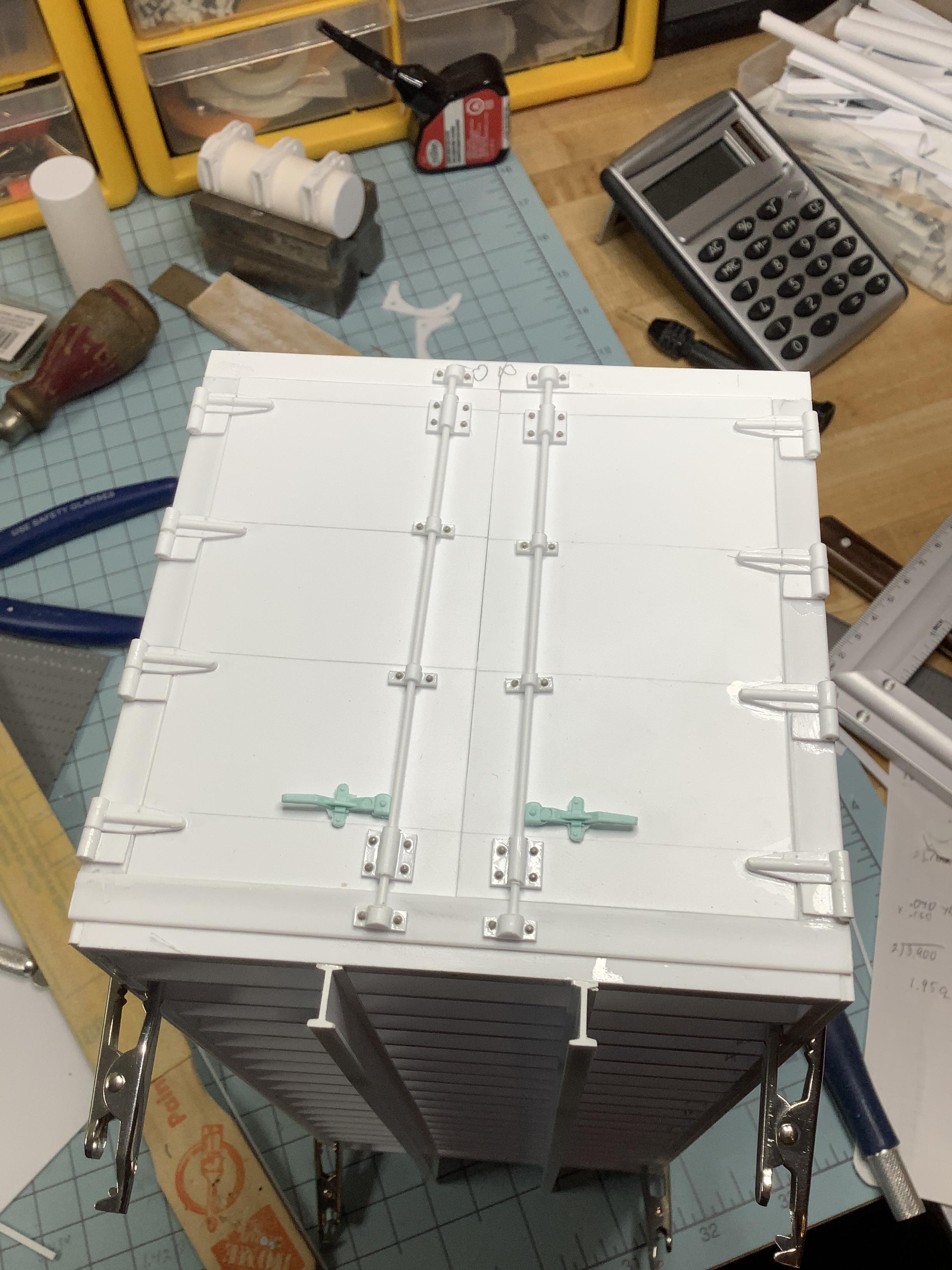

Gary Chastain Posted November 7, 2024 Author Posted November 7, 2024 Wow, these little parts are a pain with my old fat fingers. I think everything is made for the back doors, if I am missing something please speak up. Now I can attach the rear door panel to the box and start finishing the box. didn’t loose any tiny bolts this time?, only made the door latches three times trying to get the correct size. 2
BK9300 Posted November 7, 2024 Posted November 7, 2024 The fiddly stuff can sure be frustrating and I totally get having to do things more than once. Sure looking good! 1

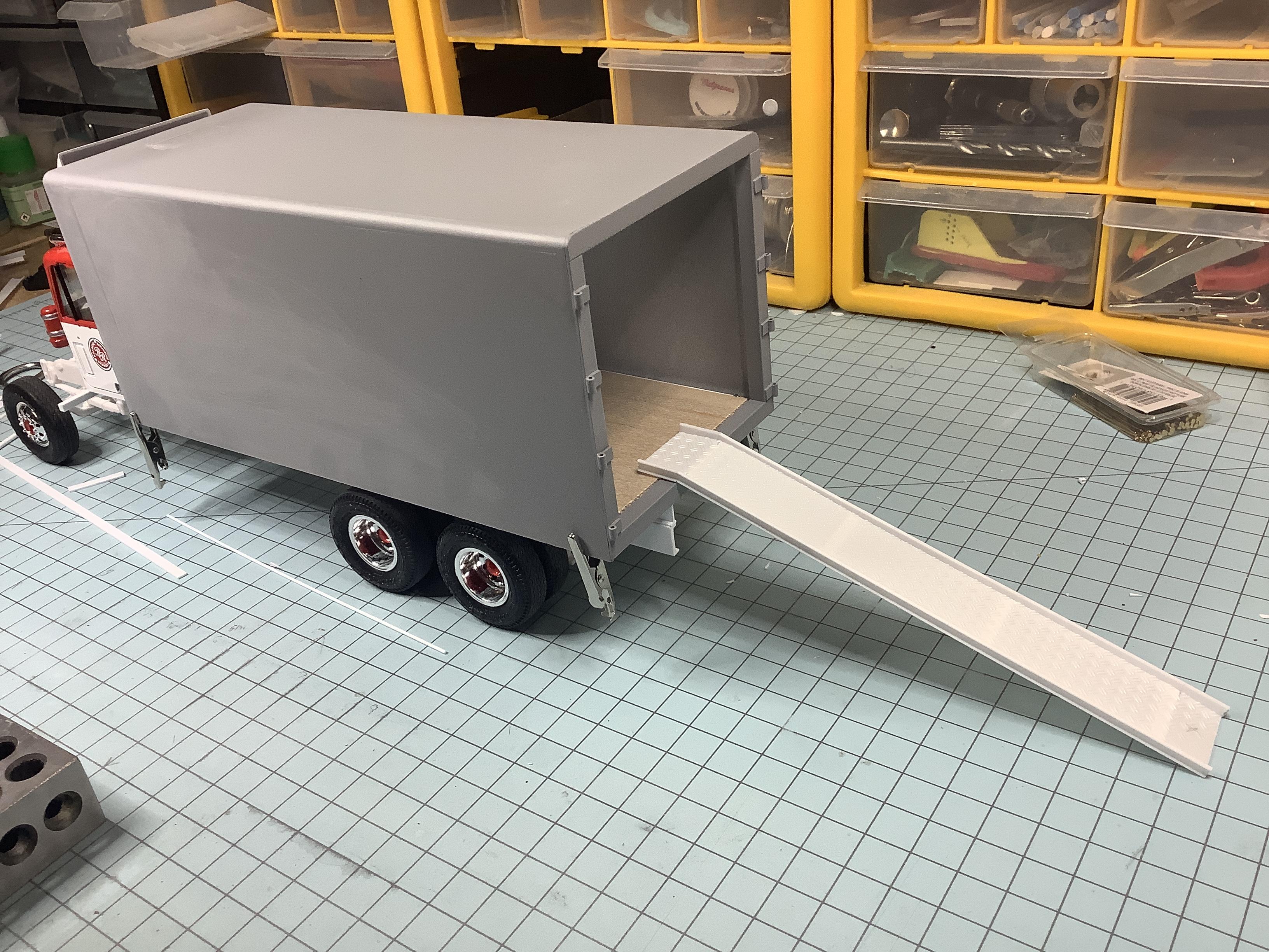

Gary Chastain Posted November 9, 2024 Author Posted November 9, 2024 Progress, getting primer on the box and sanding, over and over and repeat. Got the loading ramp fabricated, now to build the storage for the ramp. 4
Biggu Posted November 9, 2024 Posted November 9, 2024 That loading ramp look spot on. Sure didn’t take you long to fabricate. Perfect addition …
Rockford Posted November 9, 2024 Posted November 9, 2024 Looks great. I remember the draywagons delivering beer barrels in UK had a stuffed sack that they used to throw on the floor and would drop the barrels onto the sack then roll them down the hatch in the floor to the cellar. You've got my nostalgia muscle flexing Gary! 1
Gary Chastain Posted November 9, 2024 Author Posted November 9, 2024 21 minutes ago, Biggu said: That loading ramp look spot on. Sure didn’t take you long to fabricate. Perfect addition … 9 minutes ago, Rockford said: Looks great. I remember the draywagons delivering beer barrels in UK had a stuffed sack that they used to throw on the floor and would drop the barrels onto the sack then roll them down the hatch in the floor to the cellar. You've got my nostalgia muscle flexing Gary! Thanks guys,will add more detail later, chains, grab handle and stuff. Looked up specs for a load ramp, base on the ground to deck height, it suggested a 14 ft ramp. Didn’t know there a specs for ramps. 1
