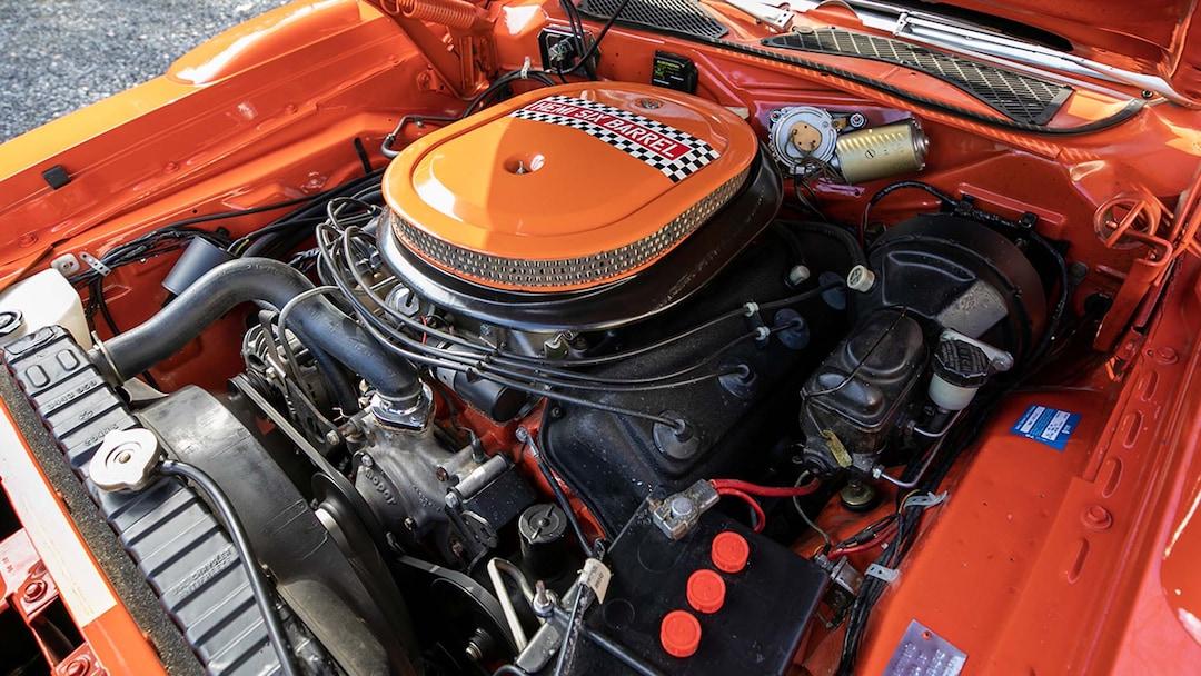

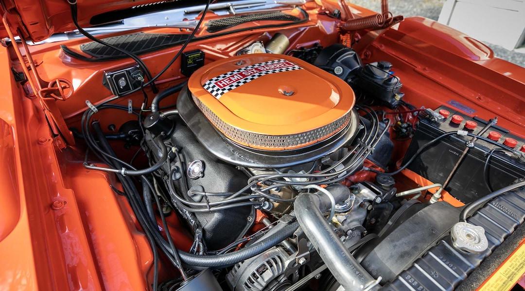

How's about a little inspiration????.... I found these pics on the net....😁👍
014-1971-Plymouth-Superbird-Charger-Beineke-prototype-wing-car-NASCAR-Mecum-472-HEMI-six-barrel.jpg
011-1971-Plymouth-Superbird-Charger-Beineke-prototype-wing-car-NASCAR-Mecum-Holley.jpg
008-1971-Plymouth-Superbird-Charger-Beineke-prototype-wing-car-NASCAR-Mecum-Hemi-Six-Barrel.jpg
Yes folks, that's a genuine 6 barrel Hemi motor....🙂

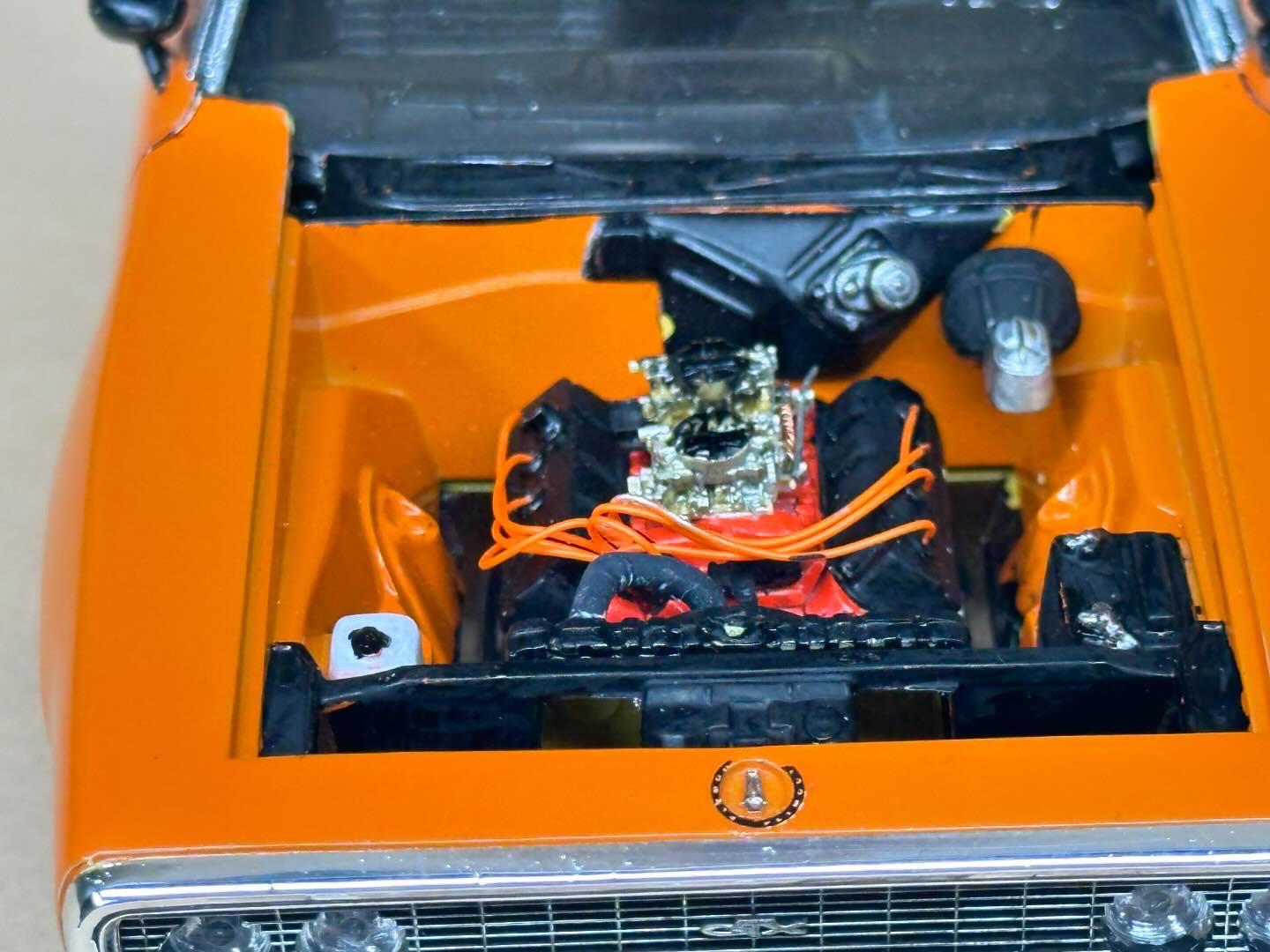

I have the standard revell/monogram gtx kit 1/24 and I swapped in a revell 1/25 hemi from the 67gtx? I think fits and guy can’t tell the difference, I added. Fireball model works resin carbs and some details but either way it will work
