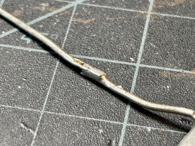

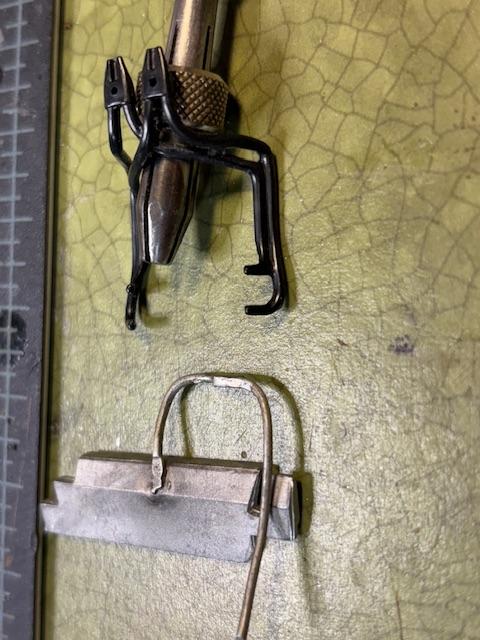

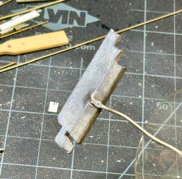

absmiami Posted August 12 Author Posted August 12 Exhaust pipes are what keep me up at nights - making them out of metal presents this problem - annealing brass or nickel softens the material - but repeated bending and shaping causes the metal to “work harden” - and you can use solder to make a pipe - but solder doesn’t like glue - any glue - so …
absmiami Posted August 12 Author Posted August 12 I decided to see whether i can solder silver solder - that has a hi temp melting point - to something - in this case - a random peice of white metal - using lo temp solder …. It worked …

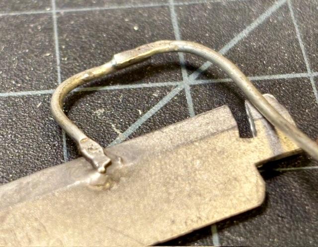

absmiami Posted August 12 Author Posted August 12 (edited) How about lo temp soldering two pieces of solder together ? Hell’s bells - it worked … Edited August 12 by absmiami
absmiami Posted August 12 Author Posted August 12 (edited) For instance on the 25 - you need to bond exhaust pipe ends and then bend them in and around the cylinder heads …. This is doable with lo temp solder wire and hi temp silver solder - away we go …. Edited August 12 by absmiami

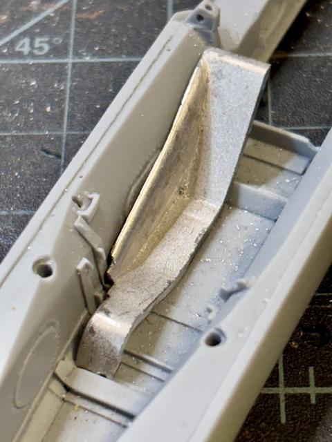

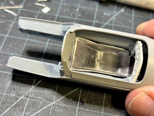

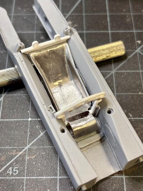

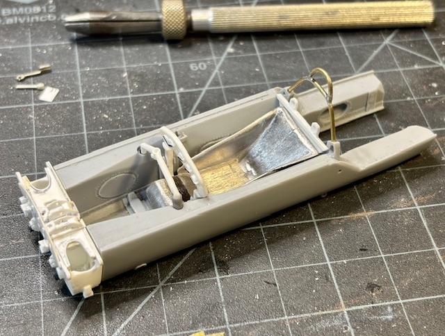

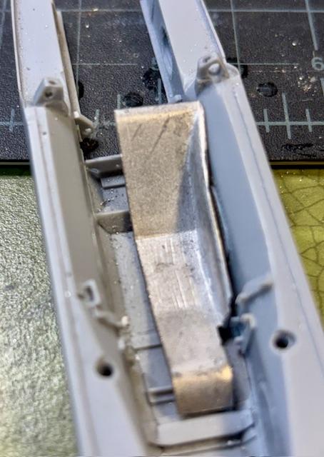

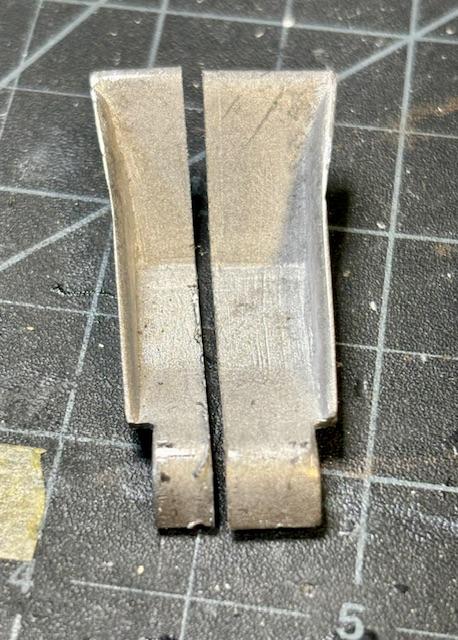

absmiami Posted August 13 Author Posted August 13 Seat time - the Auto-Kits 25 white metal seat has the correct shape but is a bit too wide for my monocoque - so its gone to surgery …

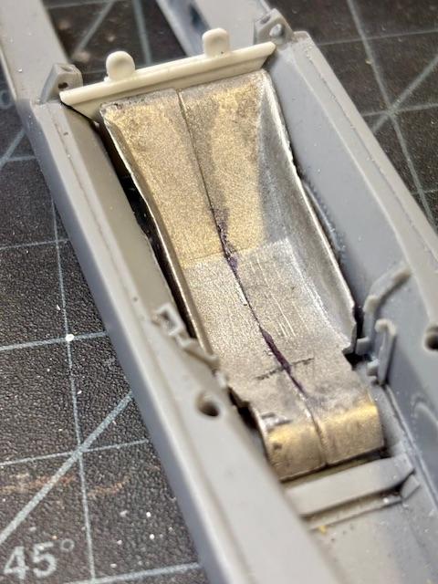

absmiami Posted August 13 Author Posted August 13 (edited) And thanks to lo temp solder - its now one peice again - Edited August 13 by absmiami
