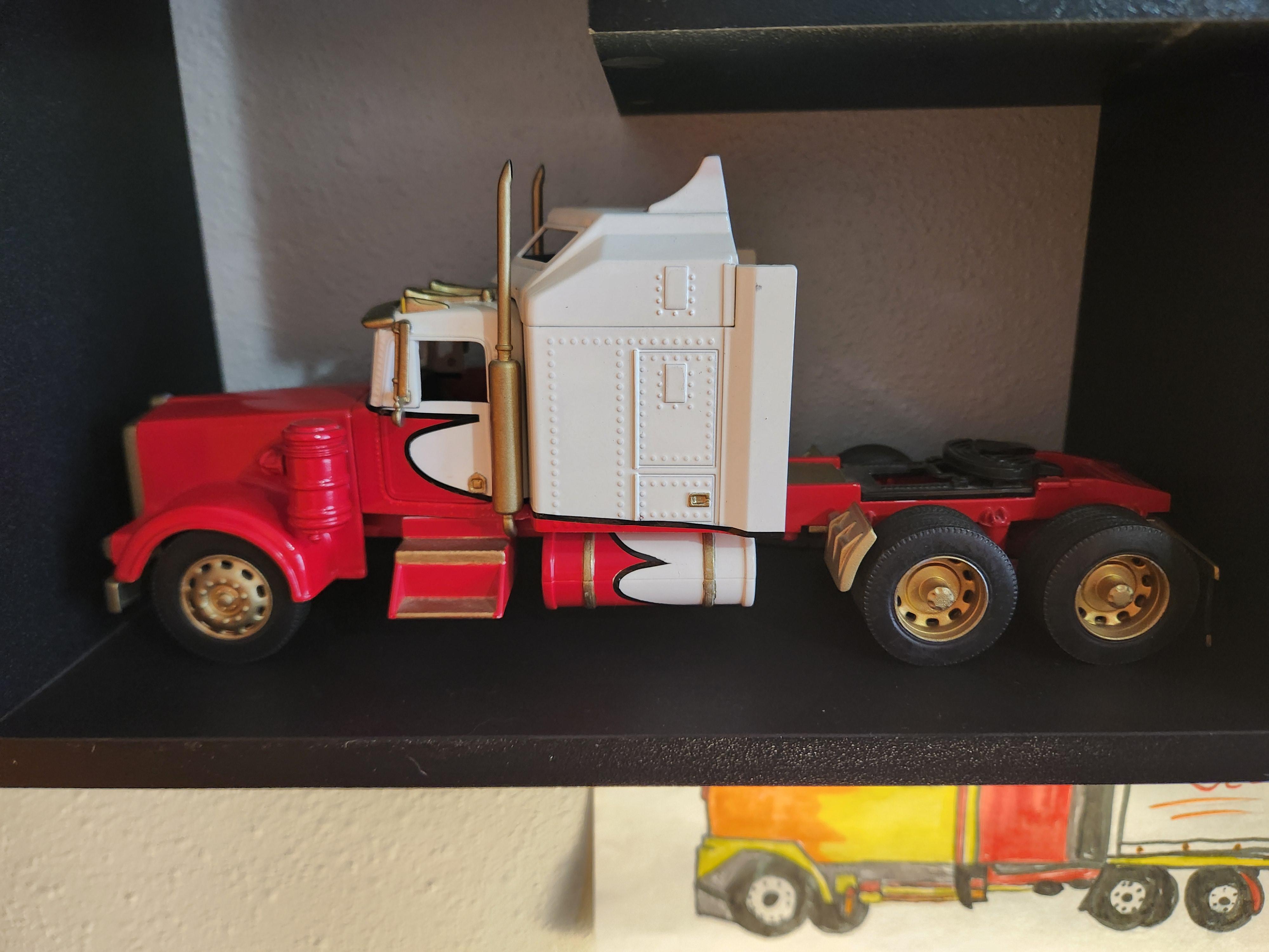

I wasn't planning to repaint the entire body. That's why I bought a red model. I had planned a fairly aggressive grit sanding of the area I want to paint white, followed by a white primer, with a topcoat of gloss white. I found 1/32" pinstripe tape to use on the border of the scallop pattern. I didn't want to sand the existing paint down too far as I don't want to end up with a step at the color break. I've done something similar with another diecast. That one started as a white truck. Again, just looking to add the two tone pattern. This work was done 25 years ago in the sleeper berth of my truck during breaks.
