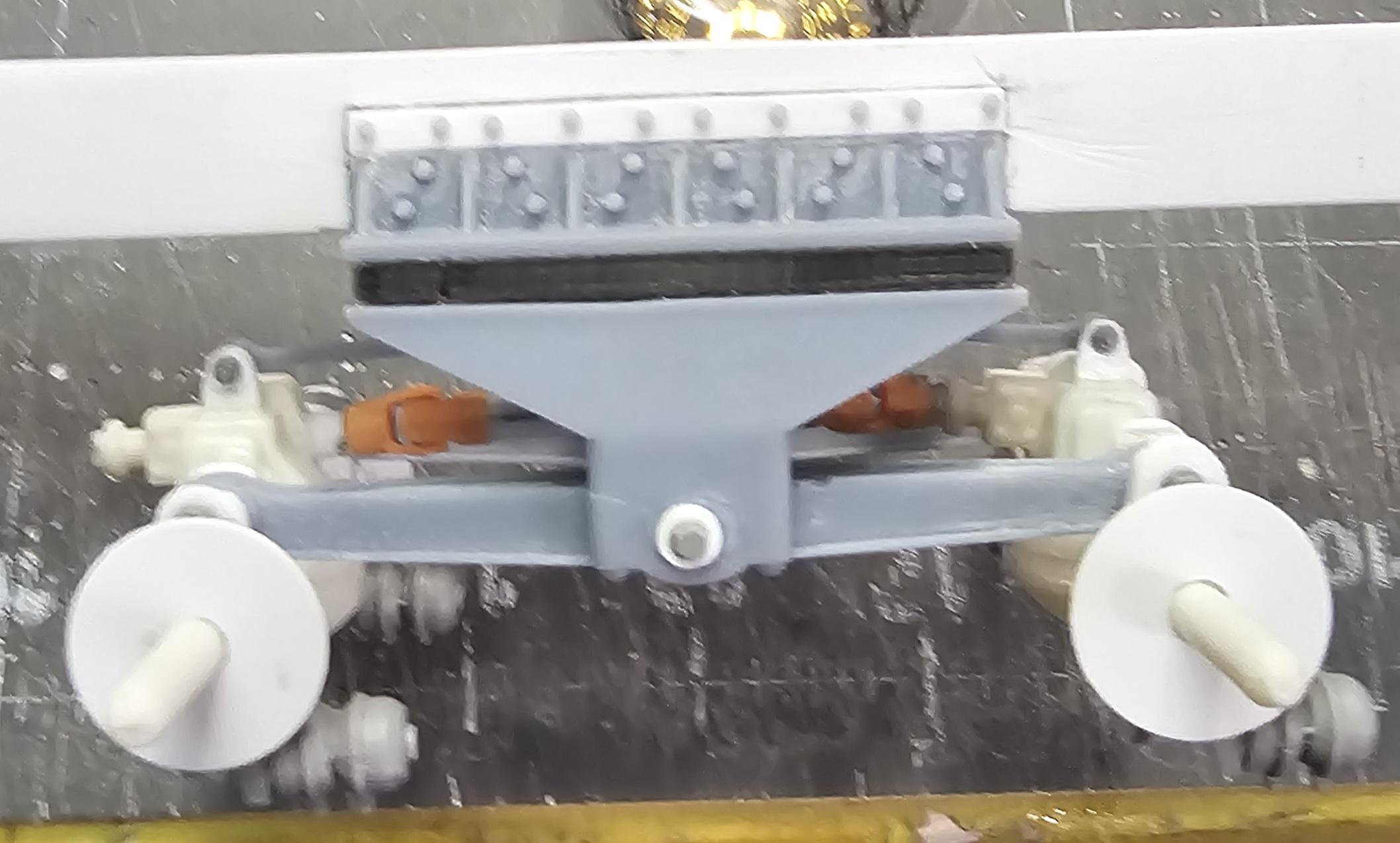

20250314_130619.jpgThis view shows the suspension as I received it from 3D Concepts.
20250314_130625.jpgThis view shows the inside of the main mounting bracket and walking beam.
20250314_130705.jpgThis view shows the outside of the main mounting bracket, walking beam and the thr frame mounting bracket. The black thing is a rubber block.

20250314_164451.jpgThis view shows the suspension mounted to the frame. As you can see I have to alter the torsion rod lengths.
20250314_164517.jpgSide view of the rear suspension.

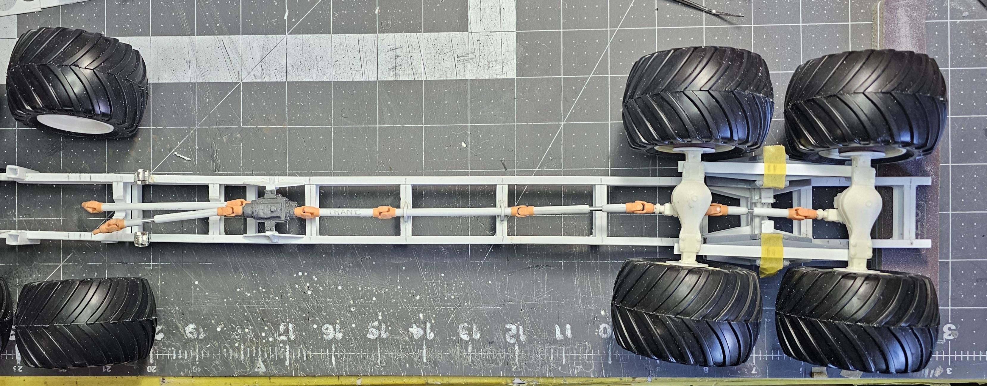

20250314_170034.jpgThis view shows the whole frame rear and front.

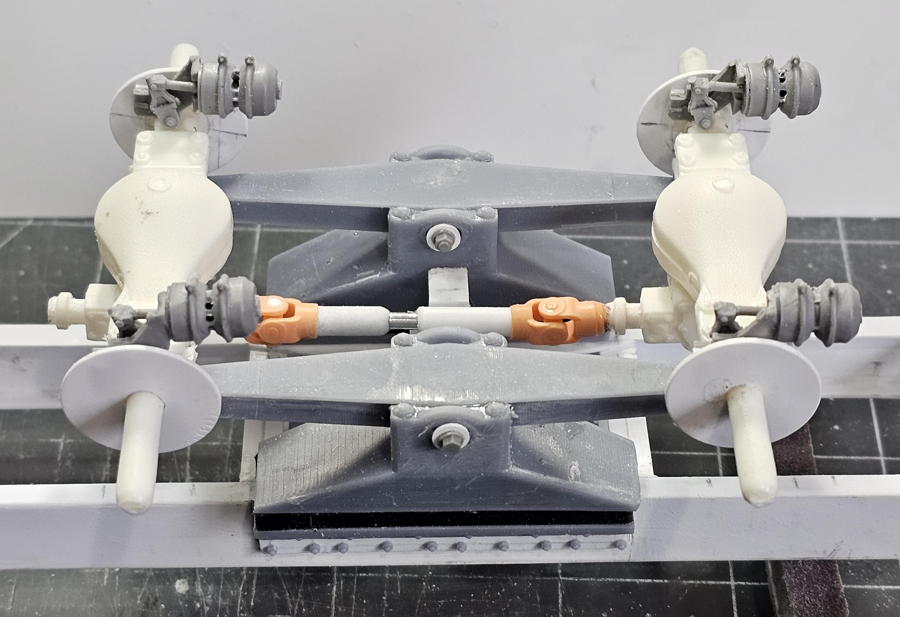

20250326_131614.jpgThis view shows both W/T's on the axle.20250326_135201.jpgBottom view of the rear suspension, rear axles and the drive shafts.
20250326_154018.jpgThis view shows all the rear "U" joints.

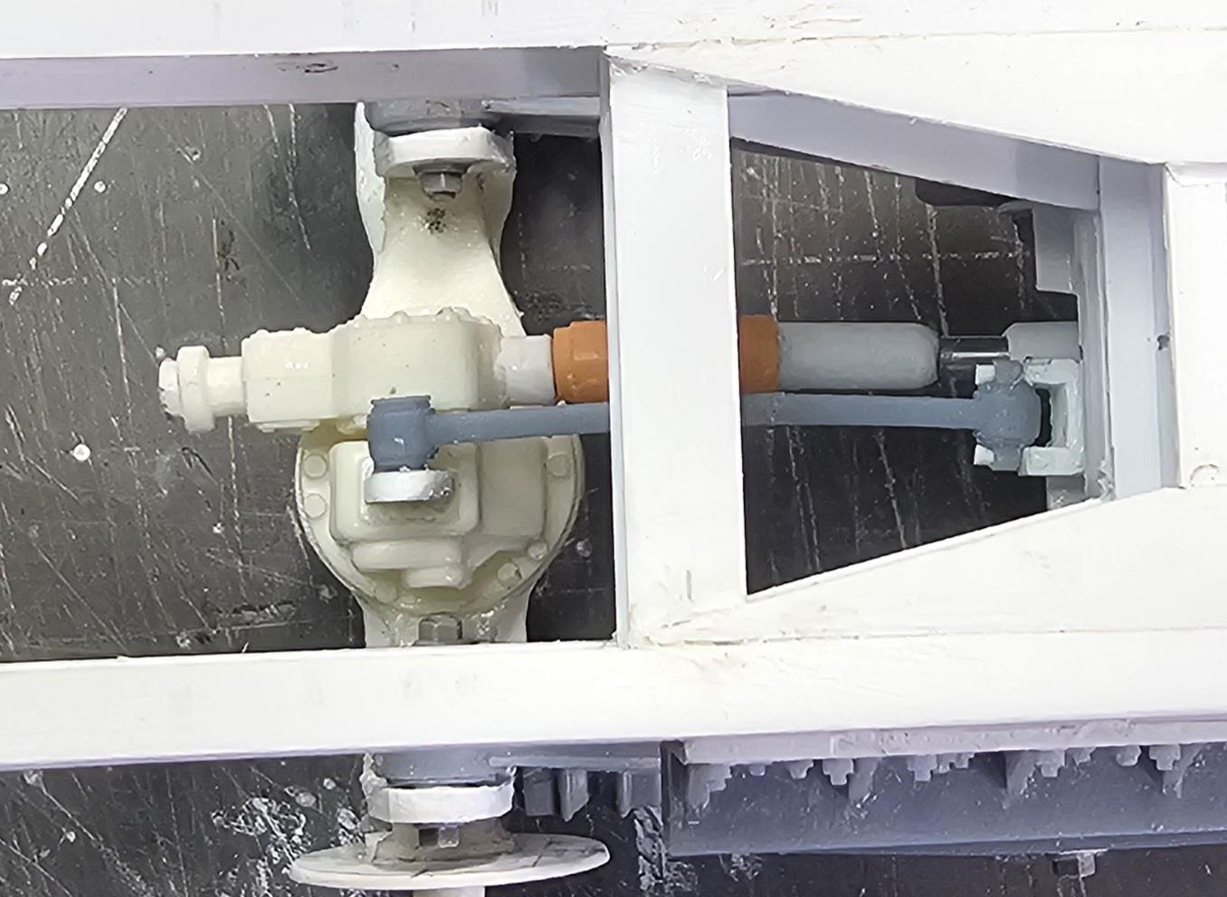

  Hello Everybody
  I have been working on the rear suspension and I now have it almost done. I just need to add a few nuts and bolts and paint it black and it will be complete.
20250330_131702.jpgThis view shows all the holes I drilled in the mounting bracket. I had to replace the top portion on both sides because the resin broke when I tried to drill it out.
20250330_131642.jpgThis view shows the bolts that I used for the mounting brackets. They are from Paul at ST Supply.
20250330_131743.jpgThis view shows the bolts added to the bracket.

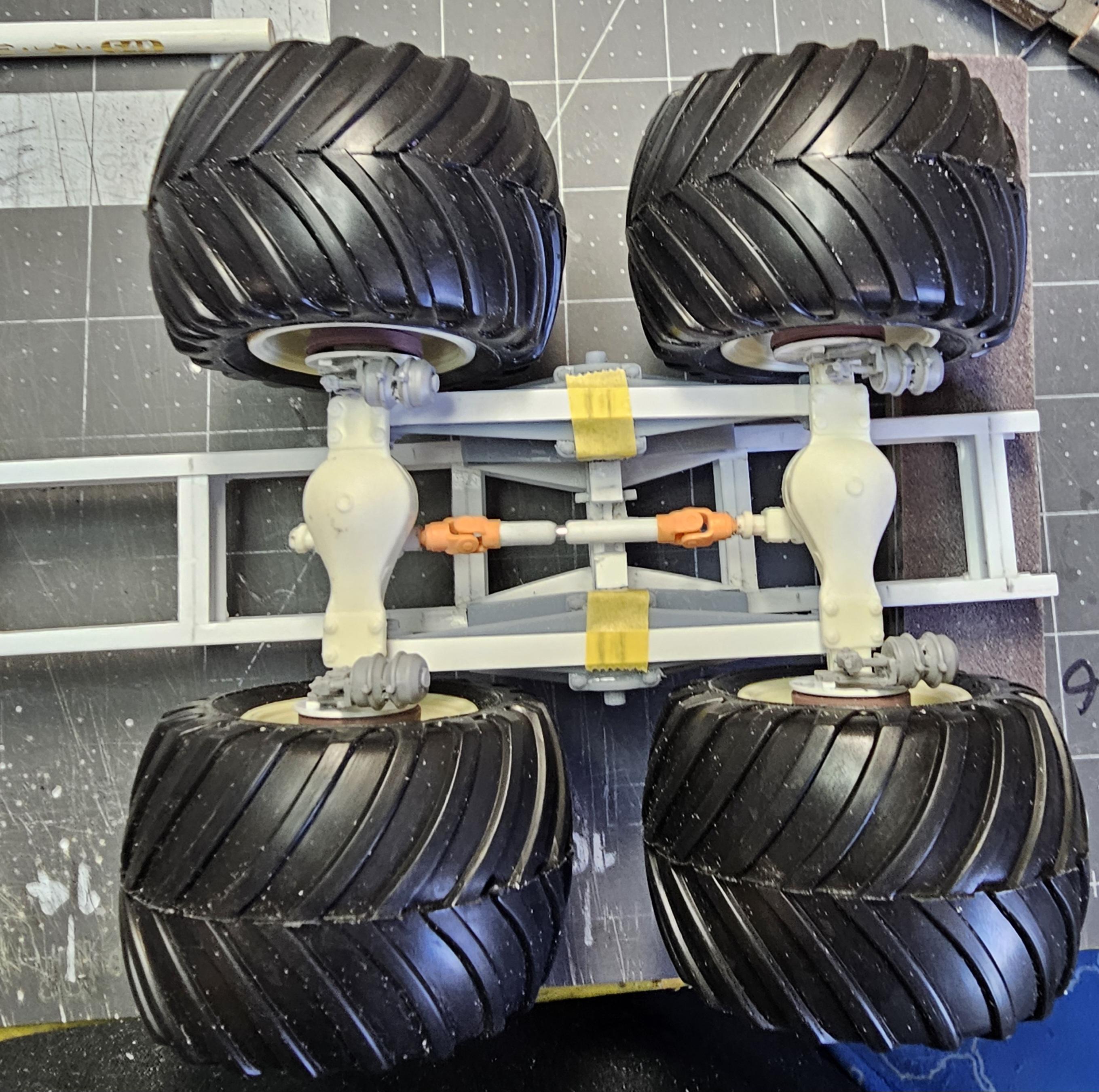

20250330_161524.jpgThis view shows the rear axles and drive shaft mounted to the walking beam suspension it also shows walking beam mounting bolts.
20250330_161624.jpgThis view shows the scratch built axle mounting brackets and there bolt heads.
20250330_161956.jpgThis view shows the set-up with the wheels/tires added.
20250330_172905.jpgThis view shows the front torsion rod installed.
20250330_172910.jpgThis view shows the rear torsion rod installed.
20250330_173837.jpgThis view shows the bolt heads added to the torsion rod mounts. Well that's it for now be back with more updates soon.
