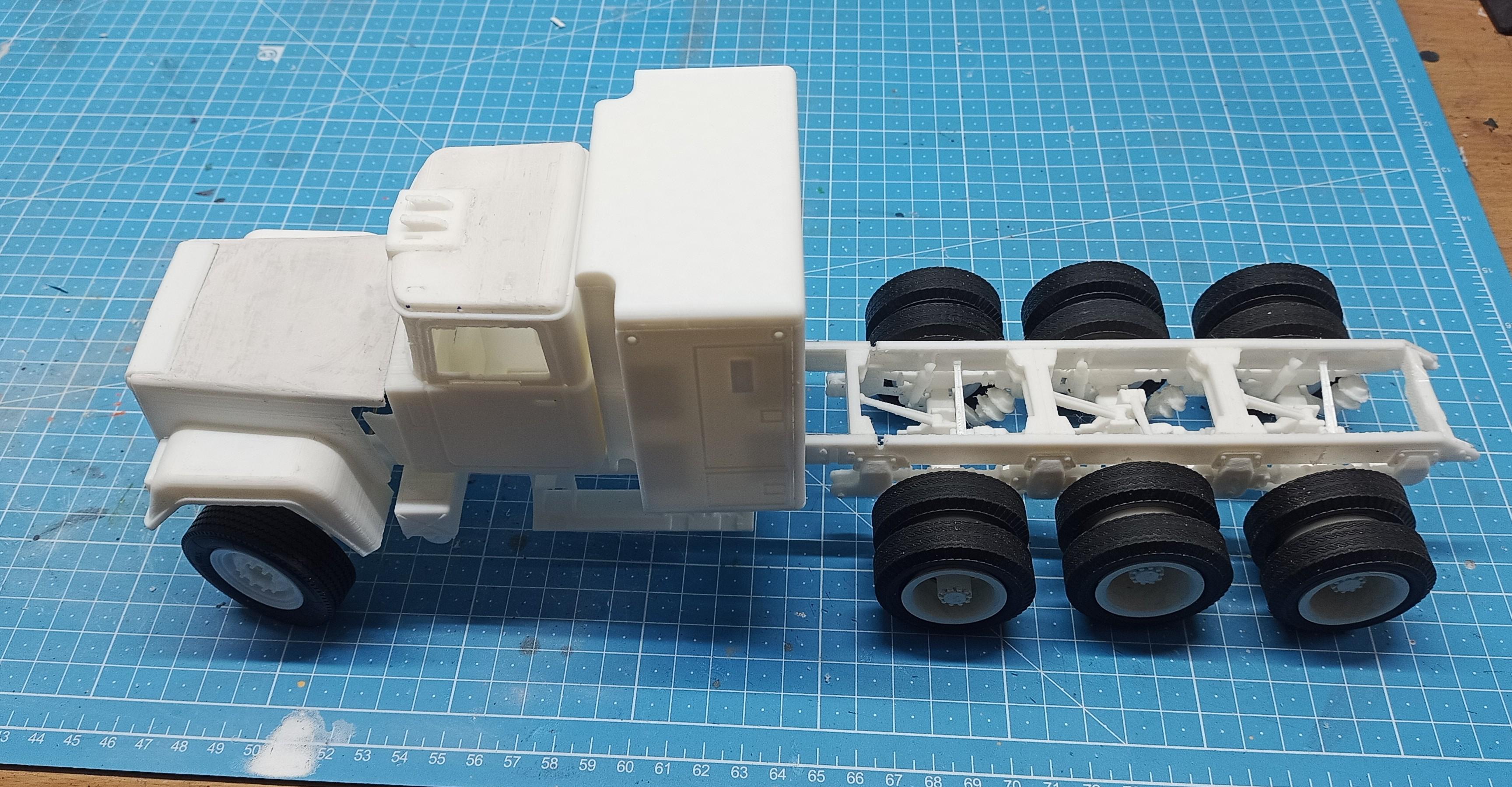

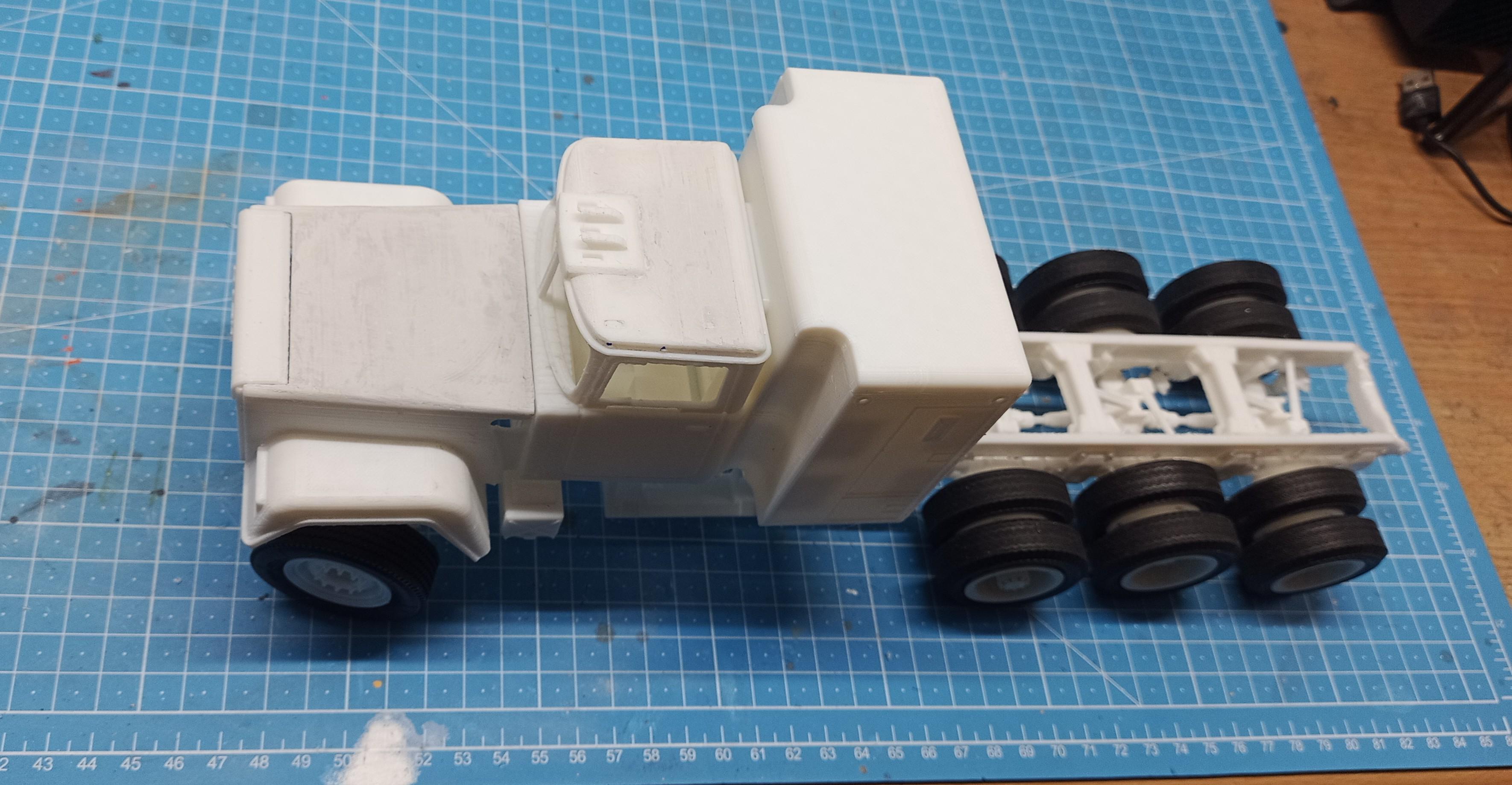

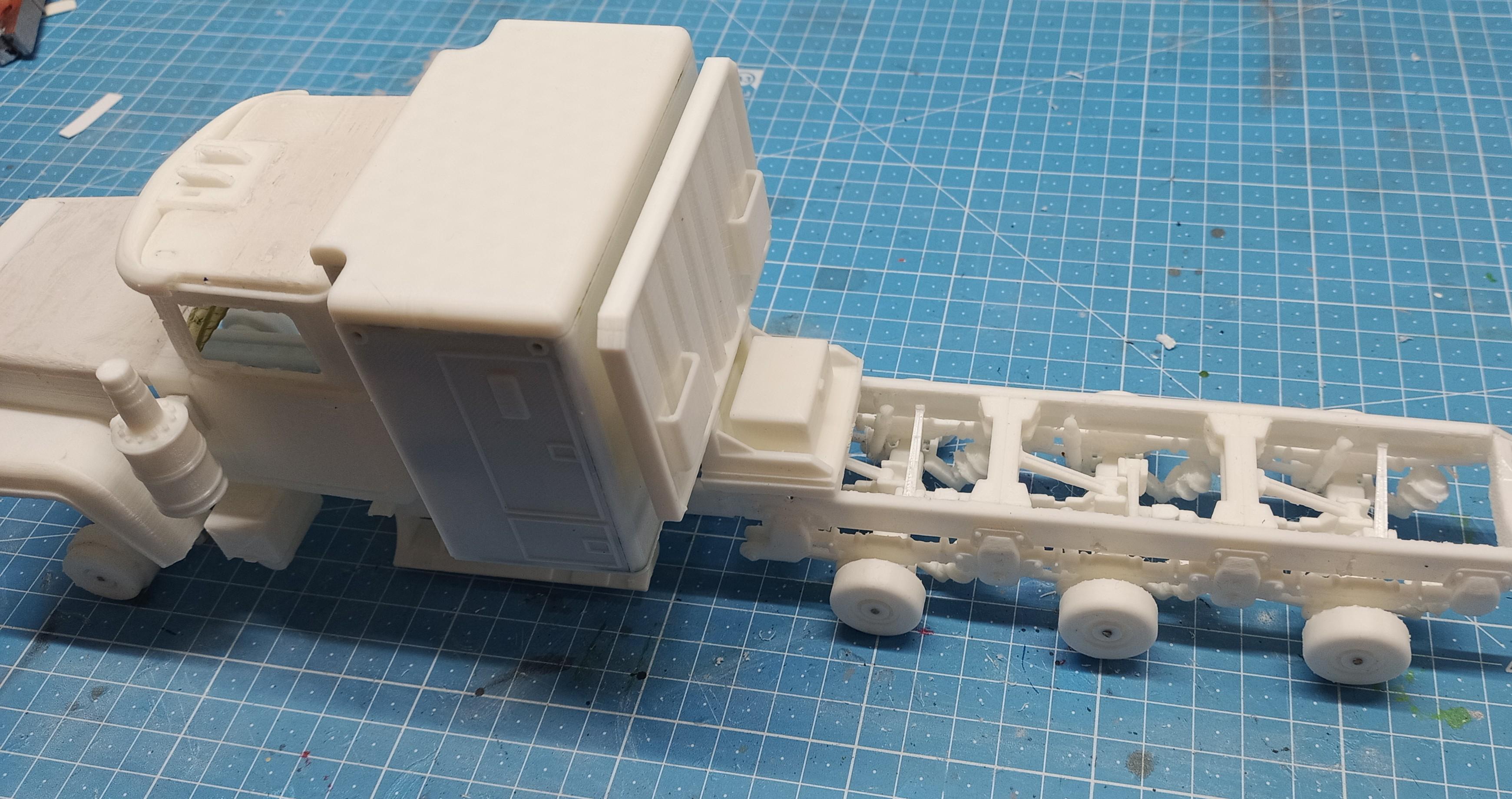

If you can even out that hood surface nicely, I bet the result is going to be superb!
Edited by cifenet
  • Like 1
That's already happened! 👍
I puttied it on top. The sides are sanded. I'll see what it looks like when it's primered.
Maybe a bit of rework.

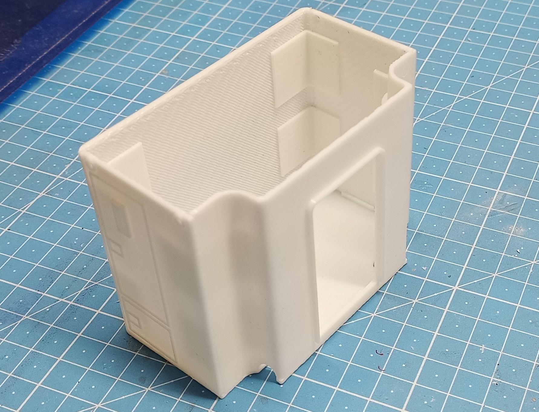

I also printed the sleeper in single pieces lying down to avoid the printing lines.
It should look better than previous builds!

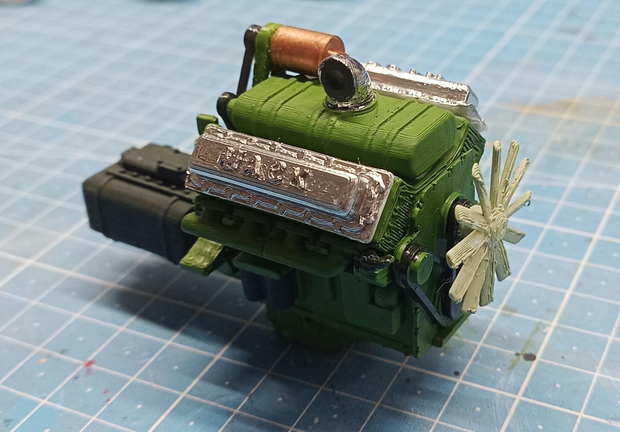

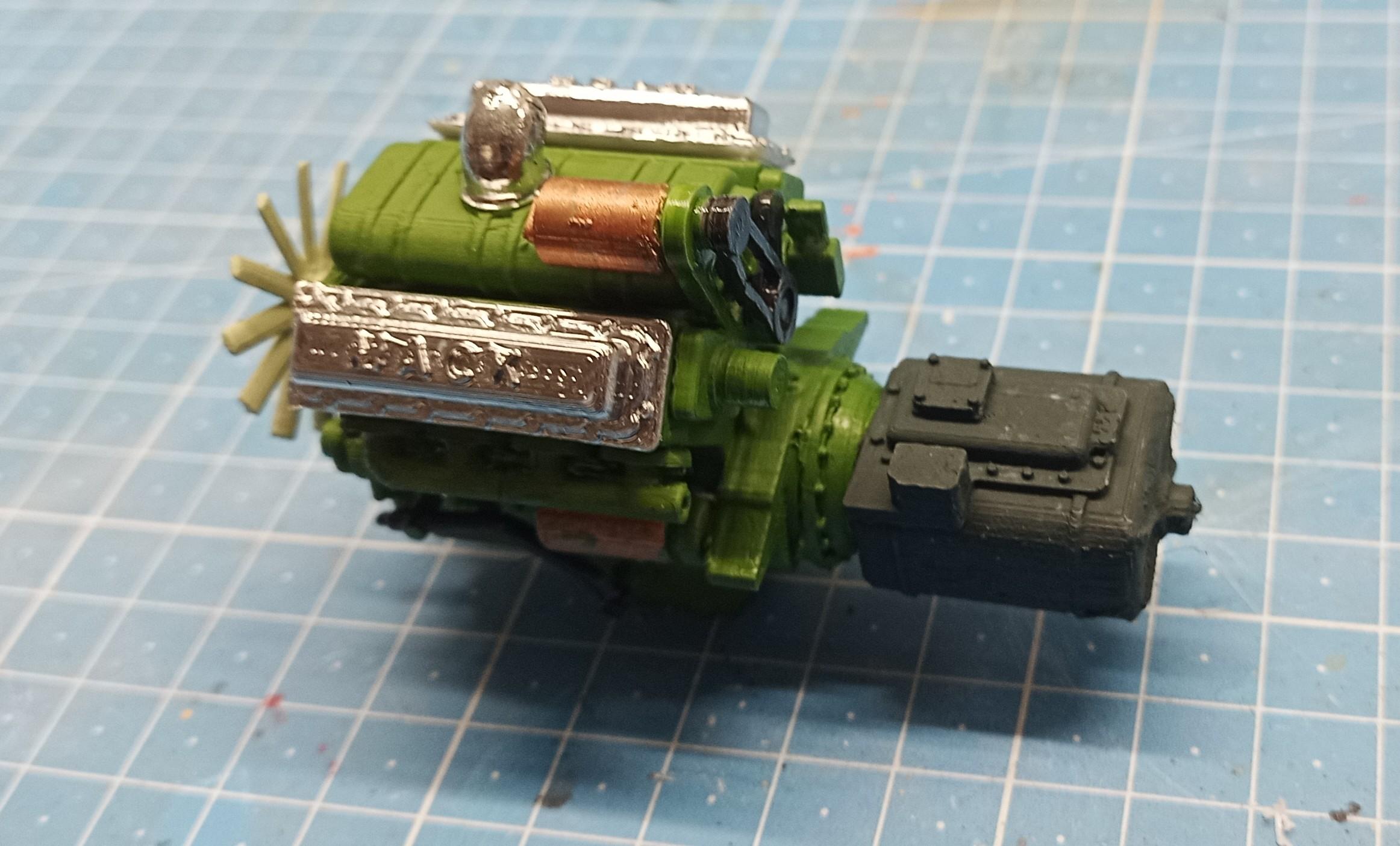

This is the V8 I designed.
I used the instruction sheet of the Amt GMC General and tried to reproduce the parts shown there mixed with attributes of similar looking engines found on pics in the internet.
I didn't go too far into detail and I think I'll leave the plumbing, at least most of it.
Hope you like it anyway!
The gear box in the drawings I took over from the Marmon Herrington to make it complete but I'll probably use a different one! I designed all engines and gear boxes so they would fit together in any combination I choose!

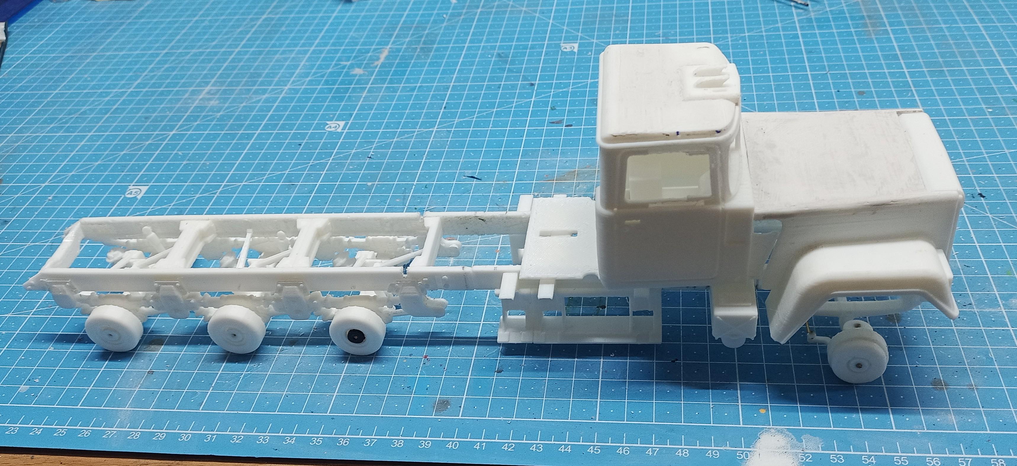

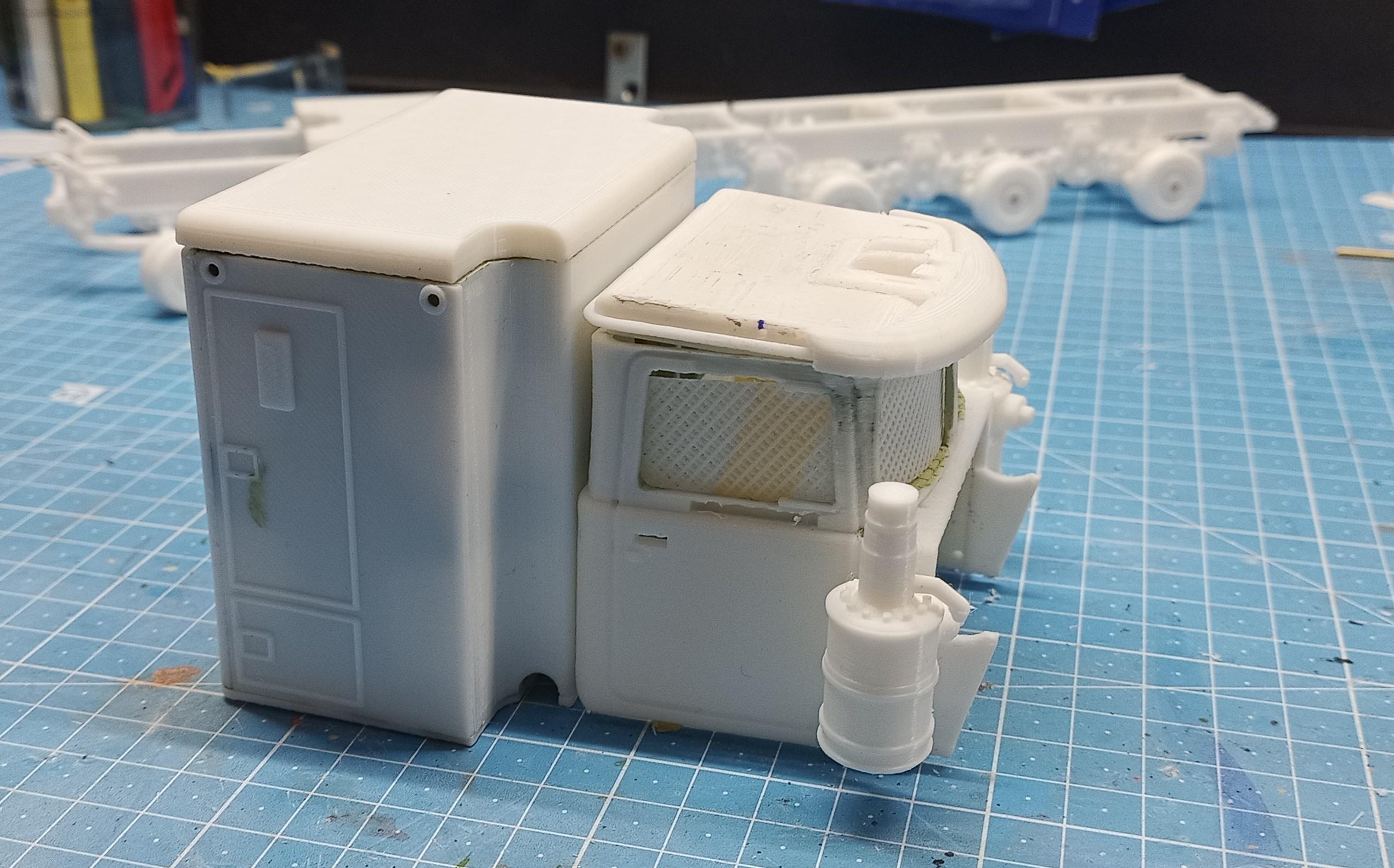

Got the cab and sleeper ready for primer!
I used a so called "raft" from printing which I cut to size to mask the window gaps. That way I don't need so much tape!
Then I used double sided tape to hold the cab and sleeper rooves so they don't get blown off by the air gun!
  • Like 2
The V8 is just about ready to be installed!
First I have to paint the chassis though!

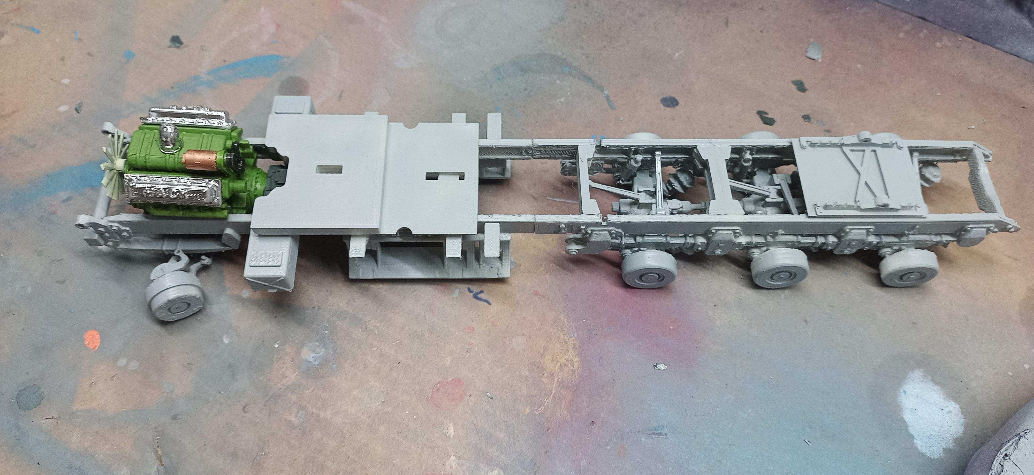

I finally got to painting the chassis:
The rims are also painted. Mocked up to see how it looks!
I'm satisfied!
Next will be primering the cab and sleeper! I puttied the cab between sleeper and roof so I have to sand a bit more before putting the primer on.
The quarter fenders will probably be chromed as well as the fuel tanks and the grille.
If you're wondering why the hubs of the first drive axle are sticking further out than the others, simple explanation:
I used the wheels that I had originally printed for the Marmon. For that the hubs were too long so I had changed them and printed them again.
Then the wheels turned out to be too big for the Marmon so I used the smaller Amt round 1 tires with smaller rims leaving the larger rims in the box for further projects. Like this one!
So I used the four doubles with the shorter hubs and two with the longer ones. I thought why not? Some trucks have different rims on each axle so why not have different hubs?
