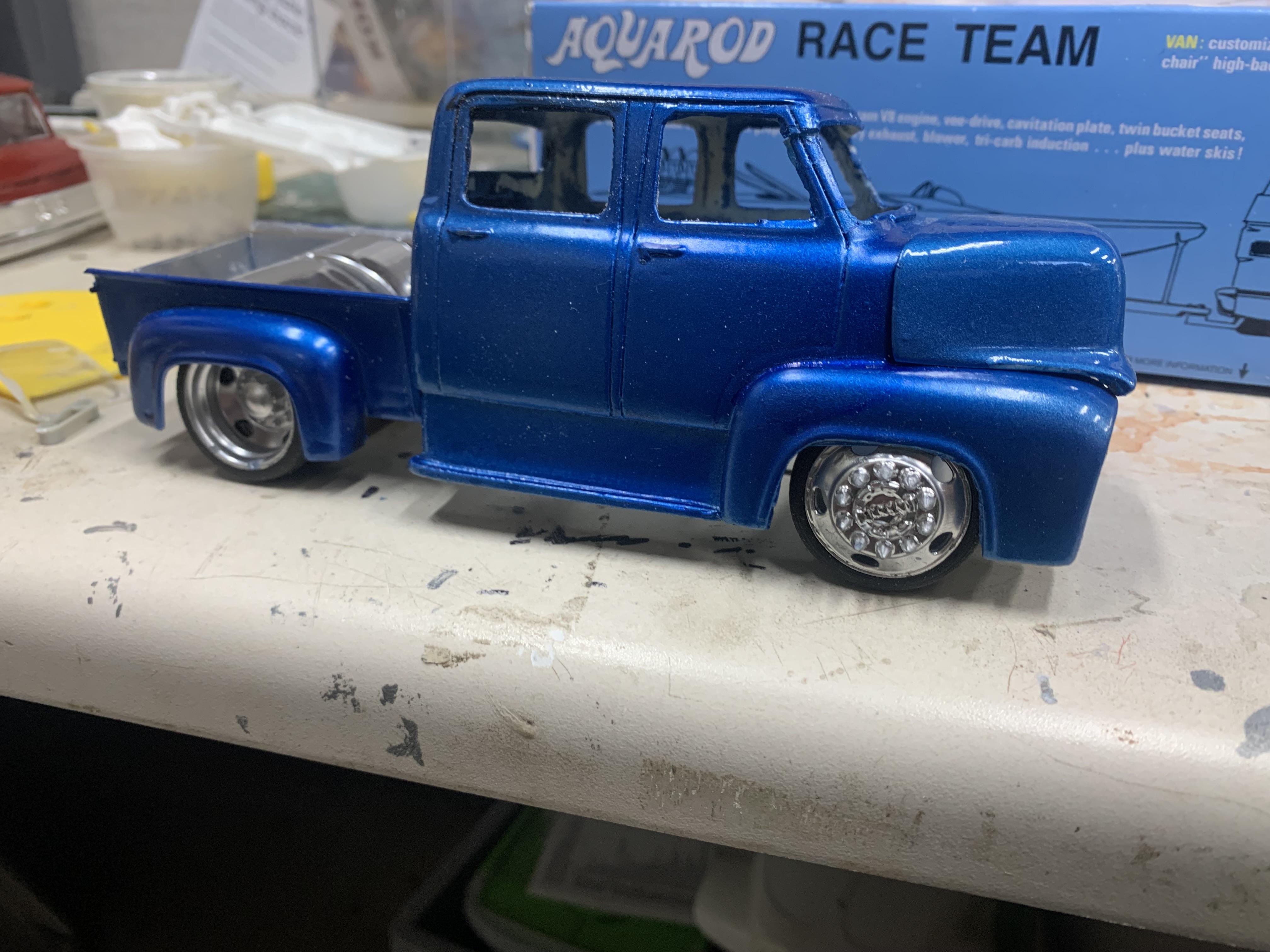

I built this using the Flintstone resin. I cut the COE parts away and used Revell fenders and bed.
But the windshield came from the AMT 53 kit.
Dop build!  Looks amazingly off the hook!
