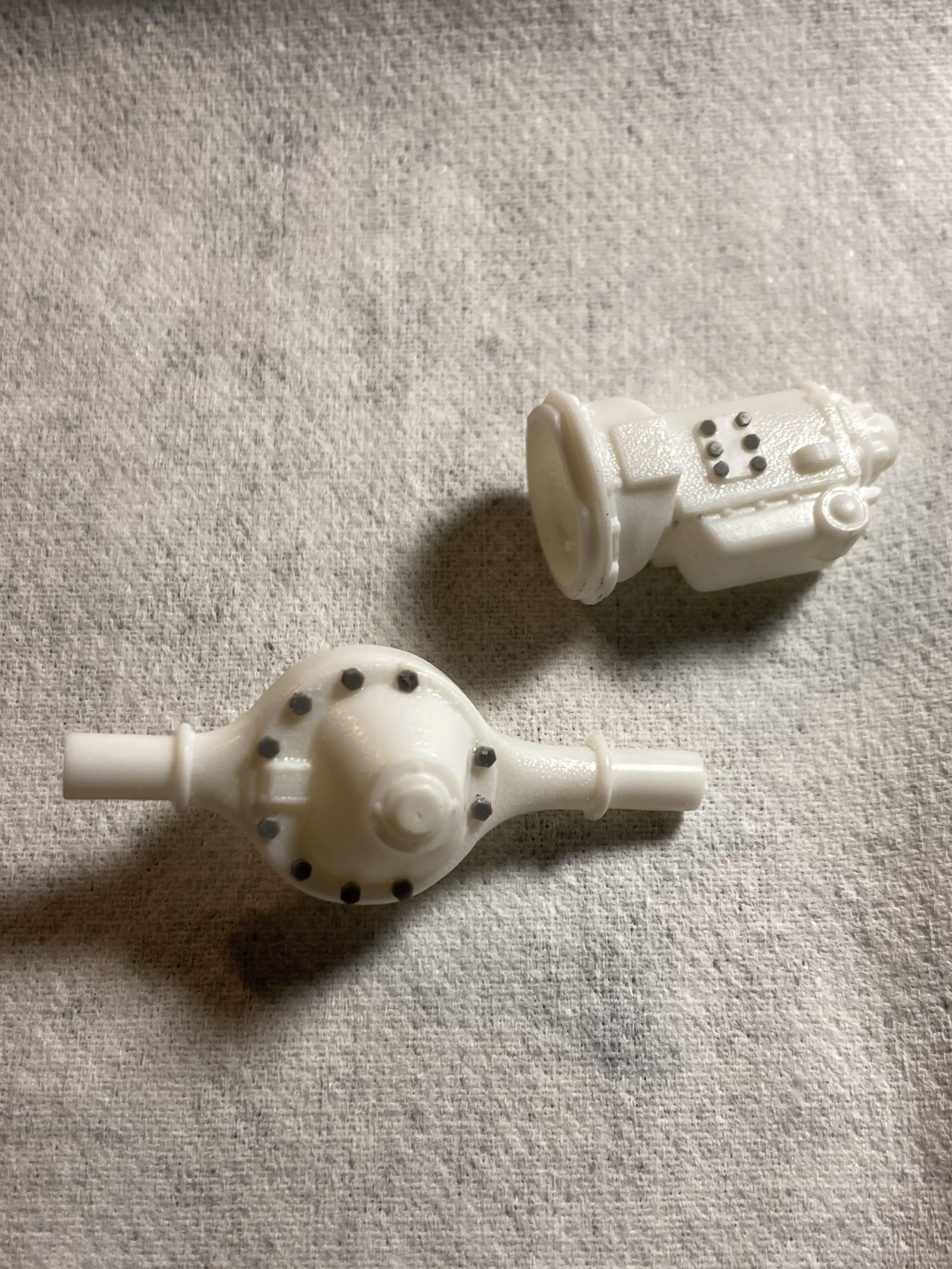

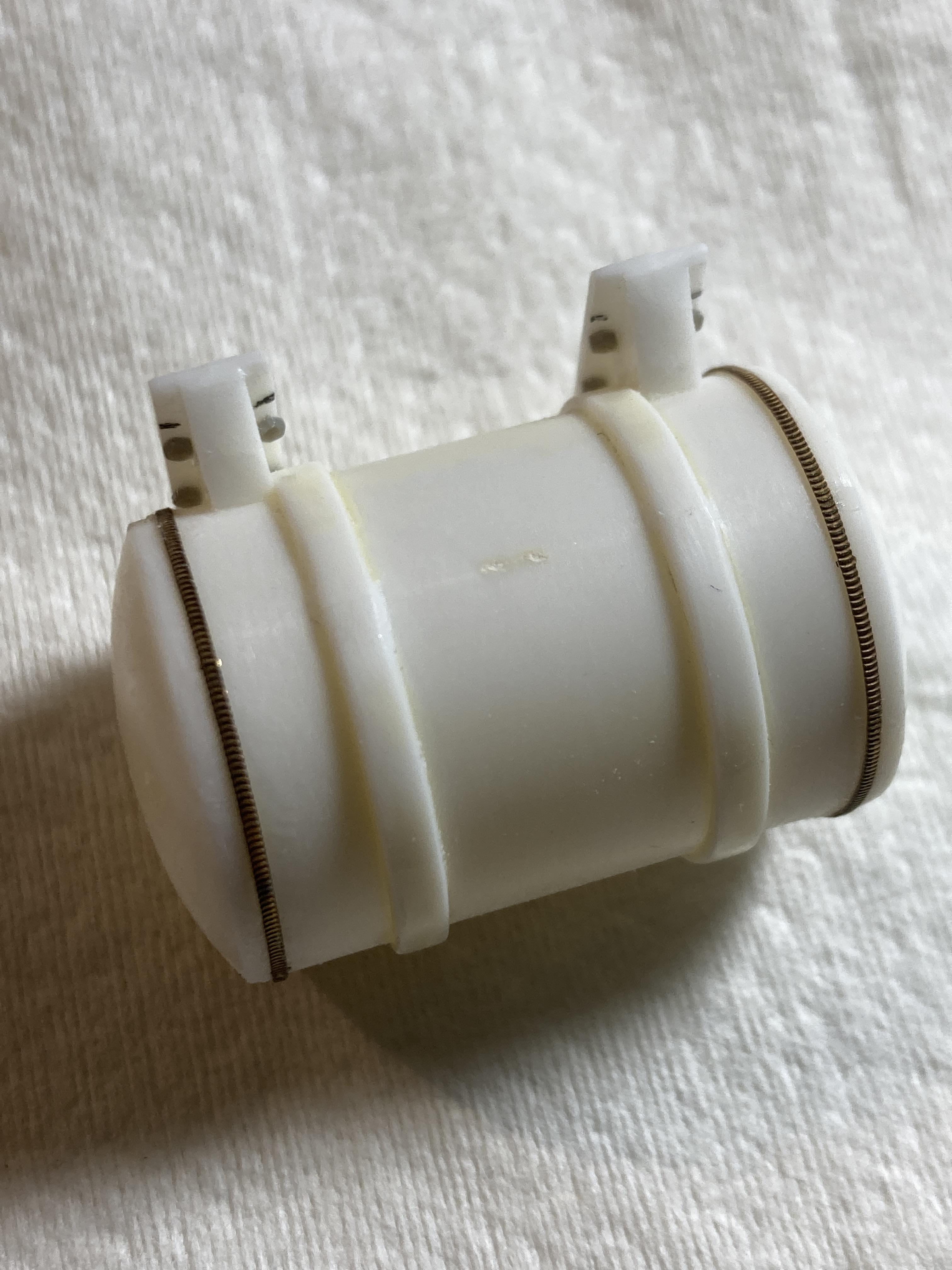

Biggu Posted April 4 Author Posted April 4 Looks like it’s been a couple weeks since I last put something up ….. so I have the engine block ‘roughed’ out and there is nothing to see there ….got the transmission together and rear end. Added appropriate bolt action to liven them up. And for the record. The bolt pattern on the rear end is exactly as the real one was, I didn’t misplace or forget any bolts. Also added a little detail to the fuel tanks and hanger brackets. There will be more adde to them shortly .. 1

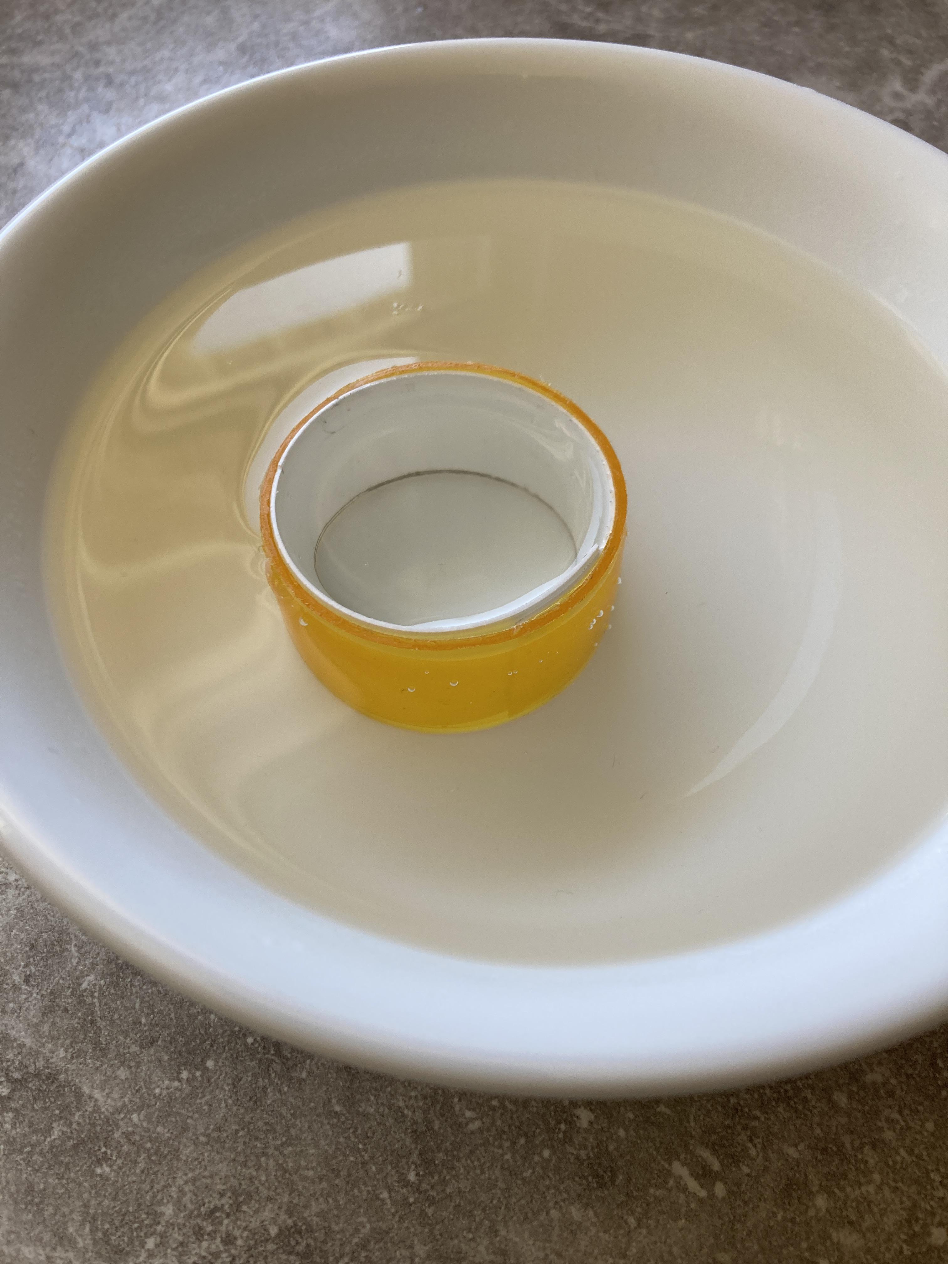

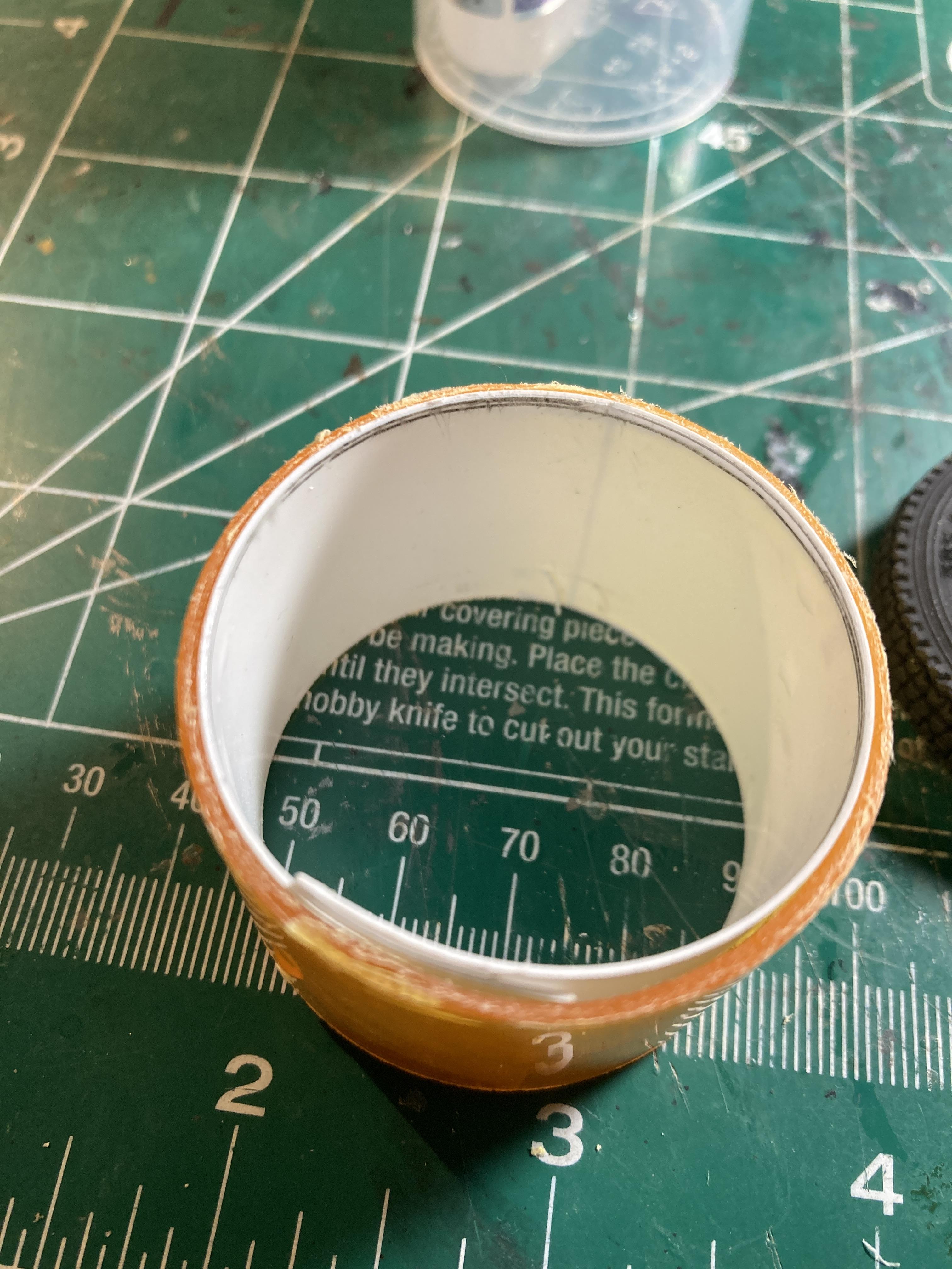

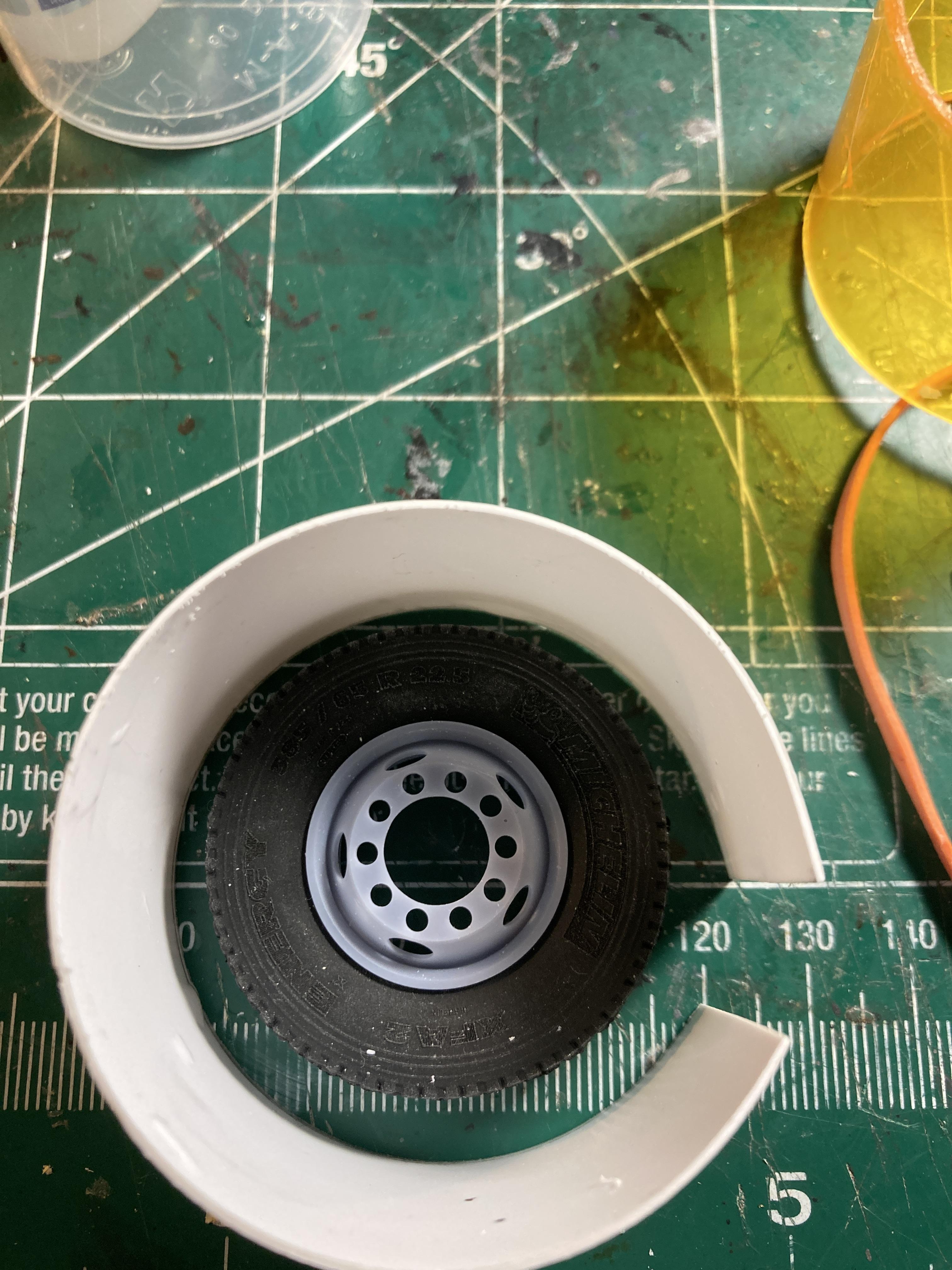

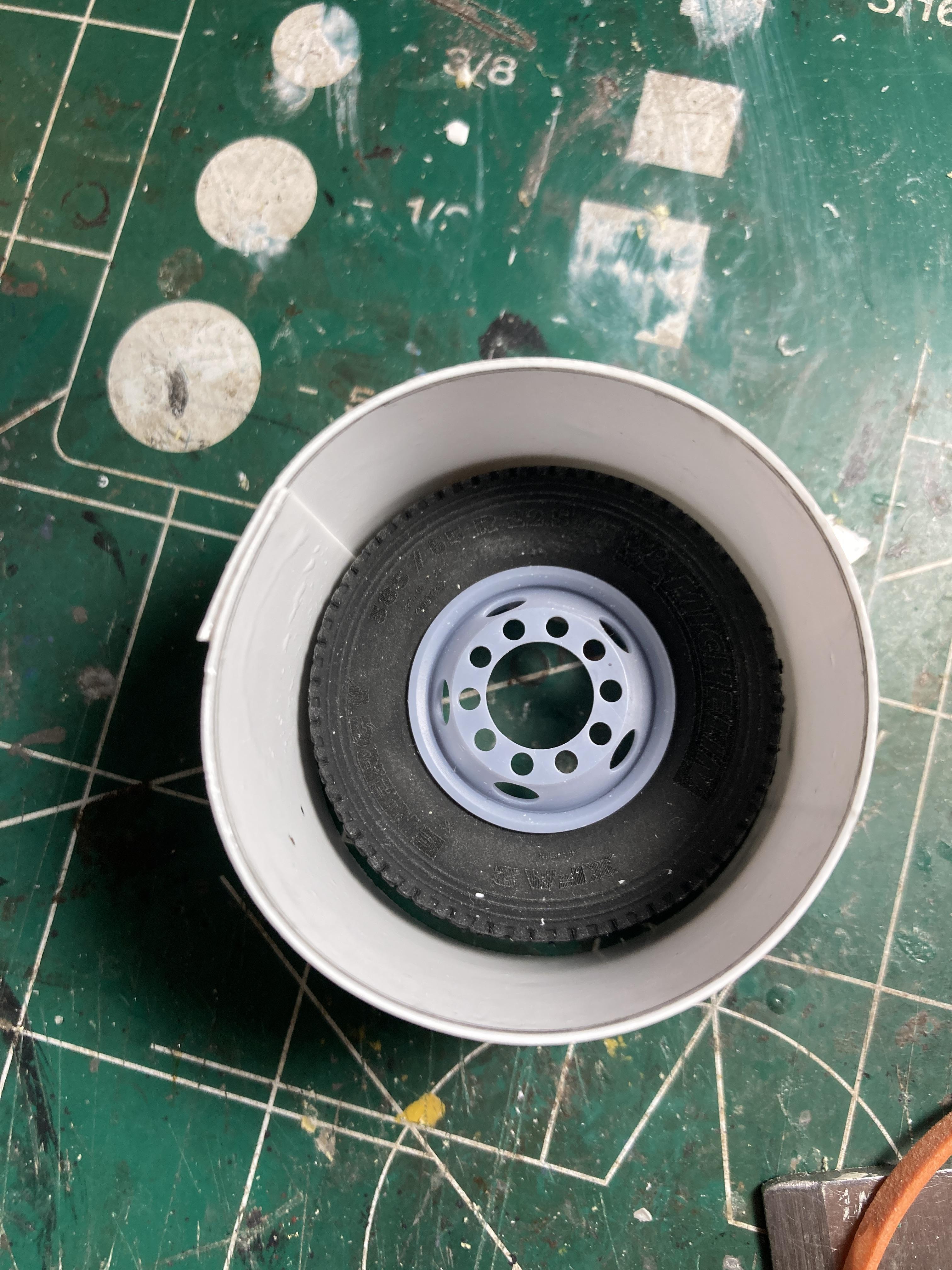

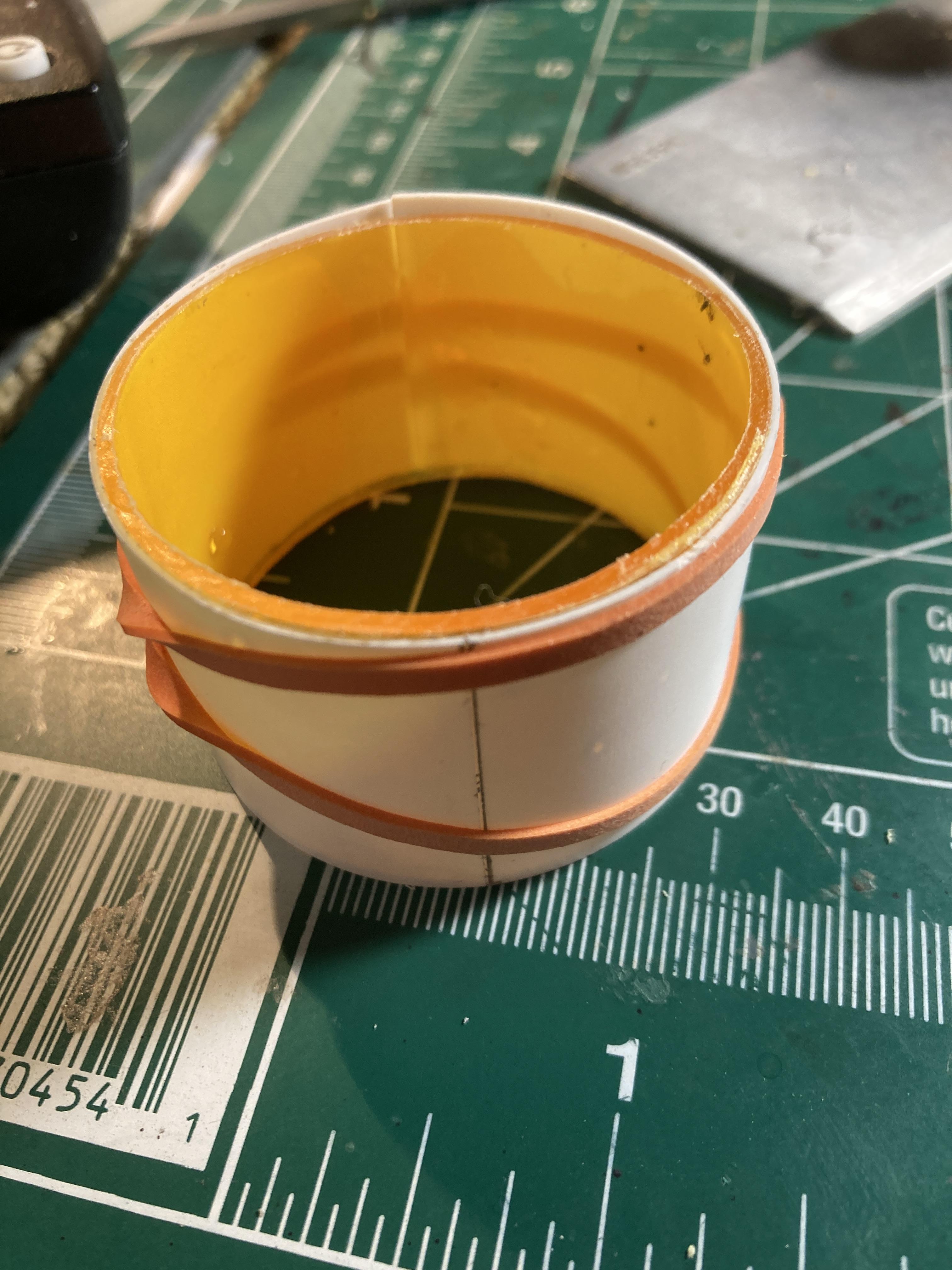

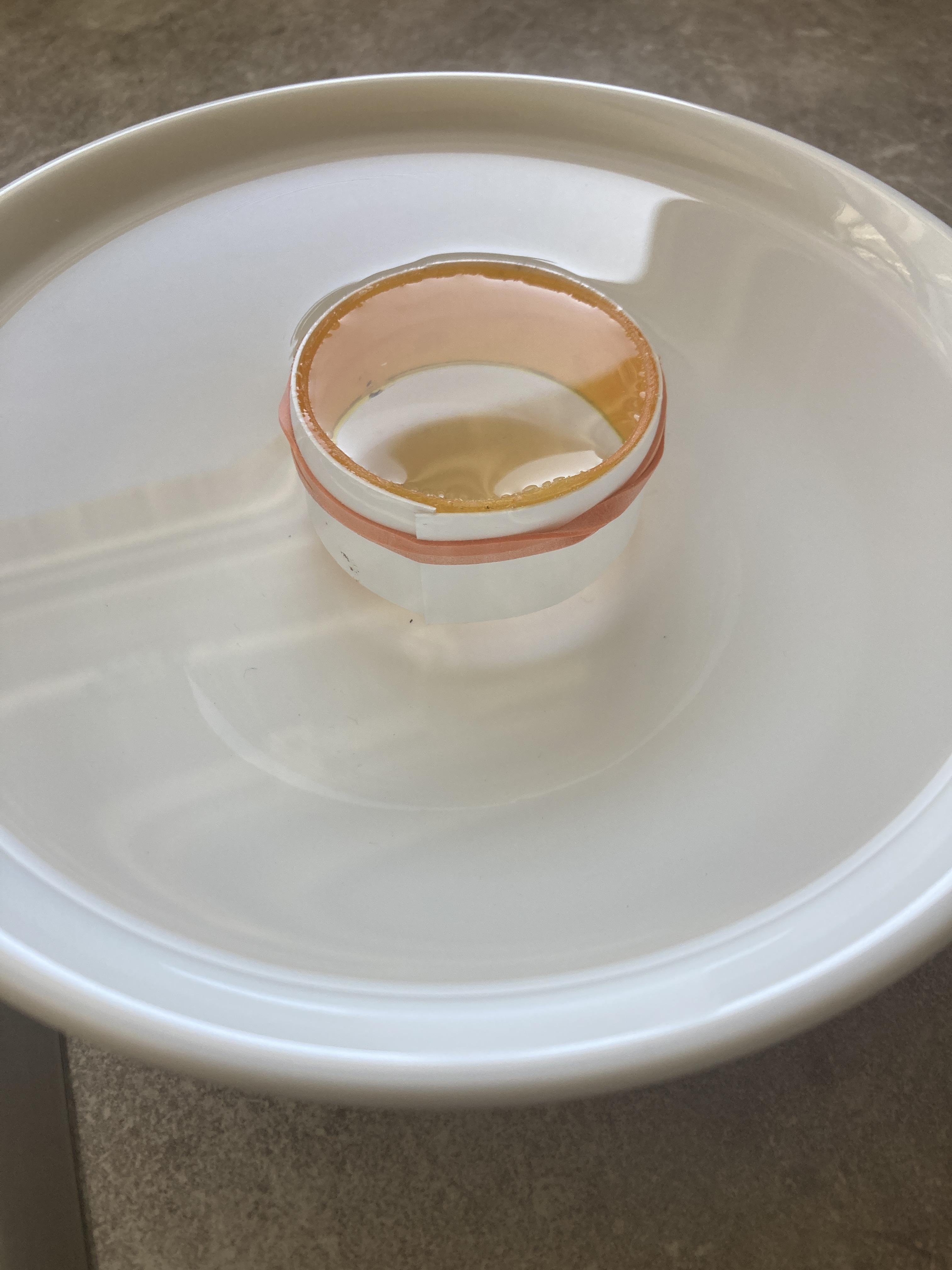

Biggu Posted April 4 Author Posted April 4 I have also keep doing research on the vintage Ford distributors. All are basically the same but all a little different, so this is not a specific truck build per se’. It is also a sort of international build. My good friend Jurgen is doing some of his magical designing, and the very generous Bren is doing the printing. Hopefully I can do justice to what I am receiving. So with what I see is coming my way, this unit will need some rear fenders. I was seriously thinking of getting an aftermarket set but then looking at what I have and figured I could probably make a set. Not much of a scratch builder but this should be fairly simple. And so far it is. Mounting them straight, level and at the same height may be a challenge but we are not there yet. The first part is to bend some sheet to look like a fender. So, I cut a section of sheet the correct width of a set of duals and the length to cover left and right. Was even smart enough to score the sheet so it will be easy to split after rolled. I had an old pill bottle and cut a section out of it and used it as a template . The basic procedure was suggested by ‘Shaky’ Ron , and then the top professional 30 odd years of expert service working with plastics , Gary, gave the best advice and suggestions then said I should post this. 🙄🤭🤣 First try I wrapped the sheet on the out side of the bottle tossed it in very hot water for a few minutes and it ‘worked’ but not well enough. It was a bit too big for the application. So with good solid consultation with Gary , I put the partially curved sheet on the ‘inside ‘ of the bottle part and very hot water bath for about 2 minutes, then I immersed it in cold water, as per Gary’s suggestion. I removed the sheet and it is Perfect and is the right curvature and will be firm and solid once a reinforcement is installed. I will try to put the pics in order.. the sheet will be cut in half so one fender for each side. Thanks to Ron for telling me it will be ‘easy’ , Gary for his expert advice and Brian for encouraging me to push the boat out and step out of the old comfort zone … 2 1
Gary Chastain Posted April 4 Posted April 4 That was fun, and caused me to do a little reading. Apparently after retiring for 5 years now I had forgotten some stuff. But all in all, nice job Jeff. Good exercise in thermoforming. 1
Biggu Posted April 5 Author Posted April 5 11 minutes ago, Gary Chastain said: That was fun, and caused me to do a little reading. Apparently after retiring for 5 years now I had forgotten some stuff. But all in all, nice job Jeff. Good exercise in thermoforming. Thanks Bud, from where I was sitting…. You hadn’t forgotten anything. I learned a lot. Thanks for the advice and great information.
BK9300 Posted April 5 Posted April 5 Neat trick, Jeff (and Gary)! Looks like the curve will keep it's shape. 1
Biggu Posted April 5 Author Posted April 5 4 minutes ago, BK9300 said: Neat trick, Jeff (and Gary)! Looks like the curve will keep it's shape. Gary is an expert when it comes to plastic. He says it will, and I will add a couple light braces for visual appeal and a little security.
cifenet Posted April 5 Posted April 5 Looks very promising, Jeff! The heating method did the trick! Fenders wrapping the wheel quite nicely here~. And the wheel looks beautiful btw. 1
Biggu Posted April 5 Author Posted April 5 29 minutes ago, cifenet said: Looks very promising, Jeff! The heating method did the trick! Fenders wrapping the wheel quite nicely here~. And the wheel looks beautiful btw. Thanks Steve… I think once the fenders are separated and hanging on the truck the vision will be out front. I agree the wheels are really sweet. They will look period correct. I hope. Thanks for checking in.

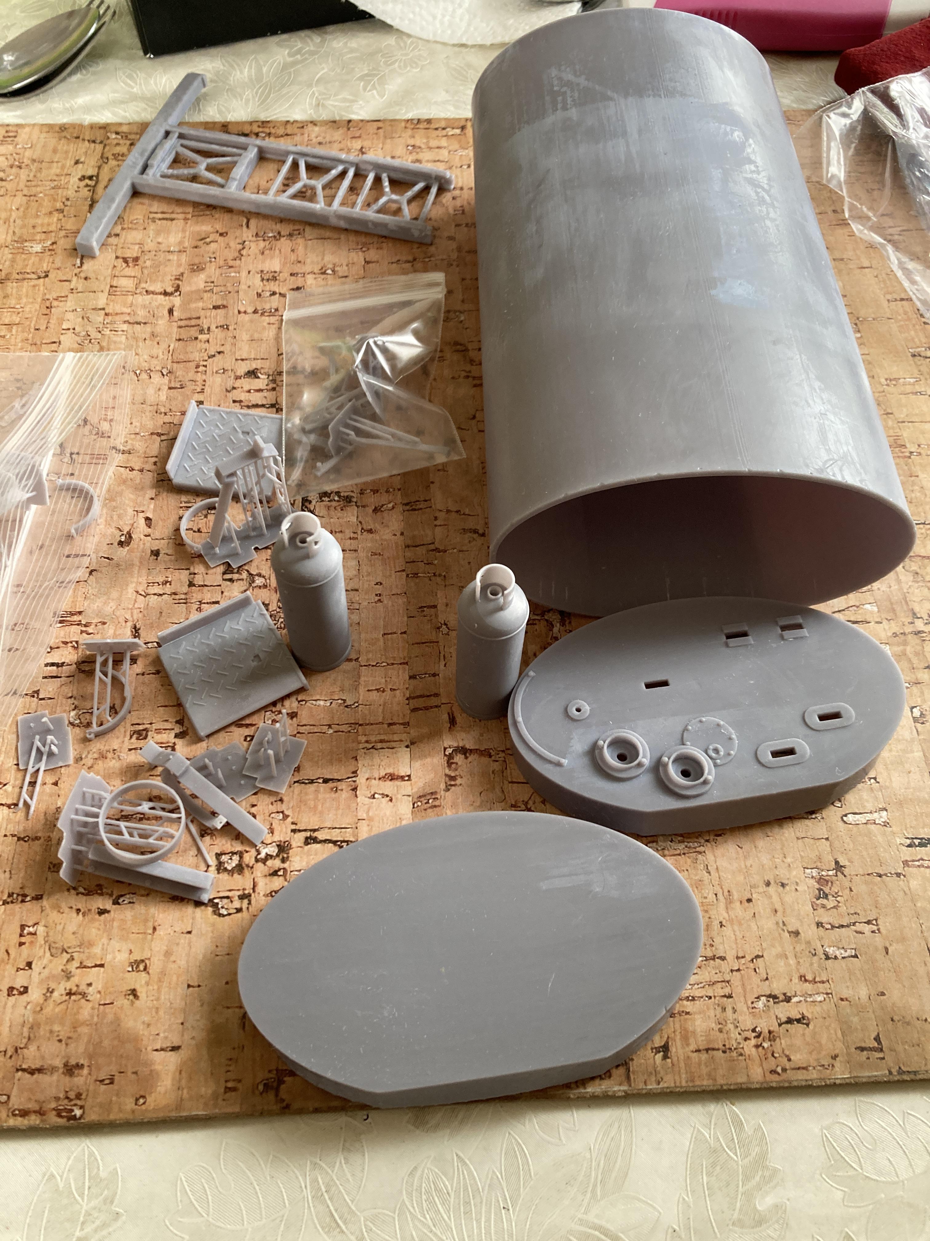

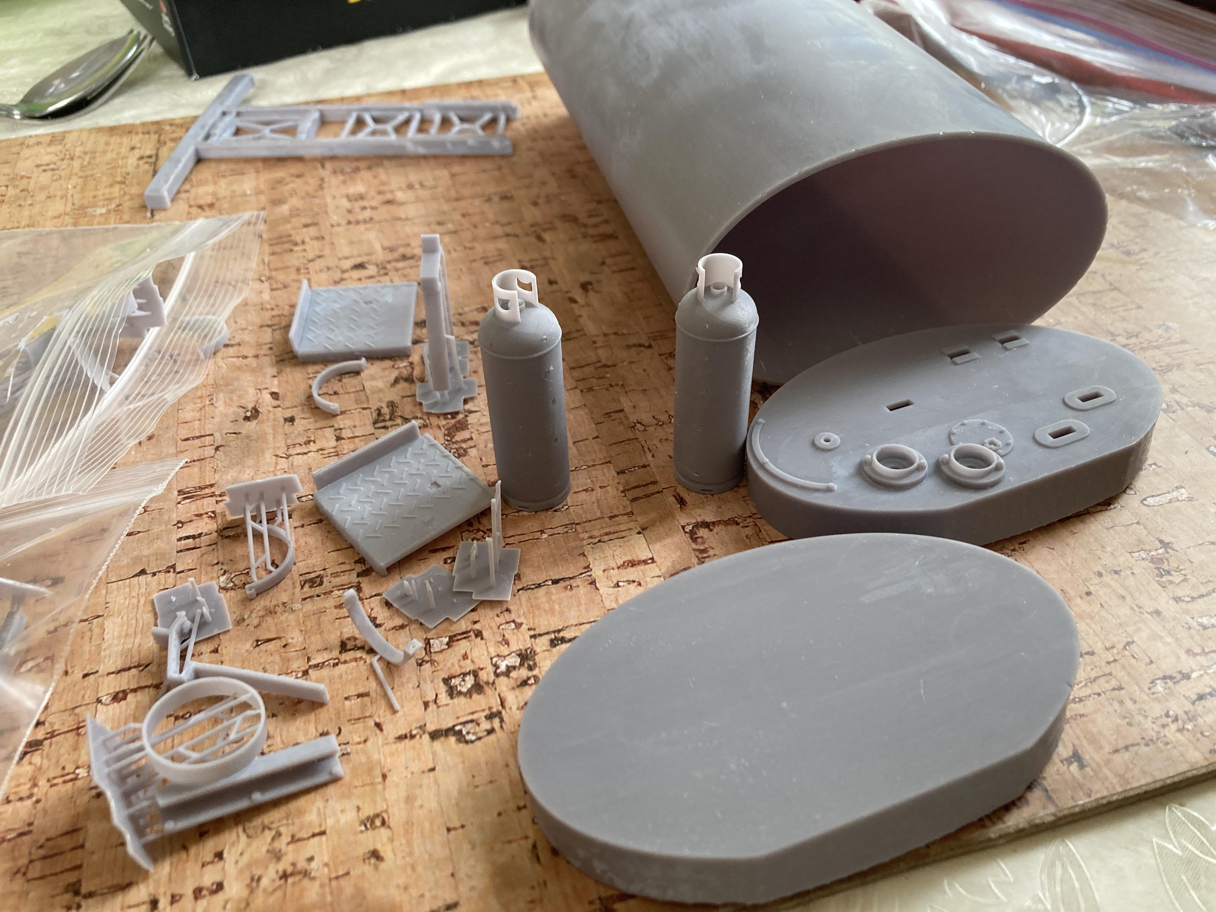

Biggu Posted April 24 Author Posted April 24 I see it’s been a while since my last post. Nothing really much to post, just the usual stuff going on, cleaning and sanding making bits fit. I did get the ‘bracketry’ work mostly. Engine block together , frame together. Just that mundane stuff. No need for pics. But what I can share is a photo of the latest batch of printed parts for the distributor tank. Incredible detail to these bits. Vents, ladder, work platforms , brackets, tools, spray bar, out rigger spray bars, burners and even a well designed and printed hand wand, for spraying the emulsion into tight spots the truck can’t access. A fabulous small detail. The printing quality and detail of the printing is exquisite. I thought this would be a simple project and easy. I was very much mistaken. It started with a vision of “hey this may be cool”. Some good conversations and my good friend Jurgen on the other side of the world , a few mediocre photos plus a little information from working with this stuff and a magnificent design was the result. The files as we know were went to Bren who offered to print them. The results speak volumes. The printing and details is exquisite. The final result of ‘my’ vision is I got three other guys involved, Brian, Bren, and Jurgen …. And a comprehensive 32 page assembly sequence diagram, and a 65 piece addon for my homely Ford C series. This oil distributor tank with all its accoutrements is a complete kit within itself. Now it seems I have to get going on this and so my best to show all these wonderful pieces in the best light I can. This will be a unique model on my shelf for sure. With the weather getting better it will be a bit more difficult to hit the bench but this build will be progressing…. As always comments are welcomed. Tell me what you think .. 3
BK9300 Posted April 25 Posted April 25 Jeff, you're going to need a bigger bottle of CA glue! Should look terrific once you have it all together and some of your classic weathering (and tarring!) applied. 2
Biggu Posted April 25 Author Posted April 25 17 minutes ago, BK9300 said: Jeff, you're going to need a bigger bottle of CA glue! Should look terrific once you have it all together and some of your classic weathering (and tarring!) applied. Thanks Brian. Yeah I may need another bottle or two for sure. I had no idea there would be this many highly detailed parts! And yes all ‘tarred’ up. 🫢😉
