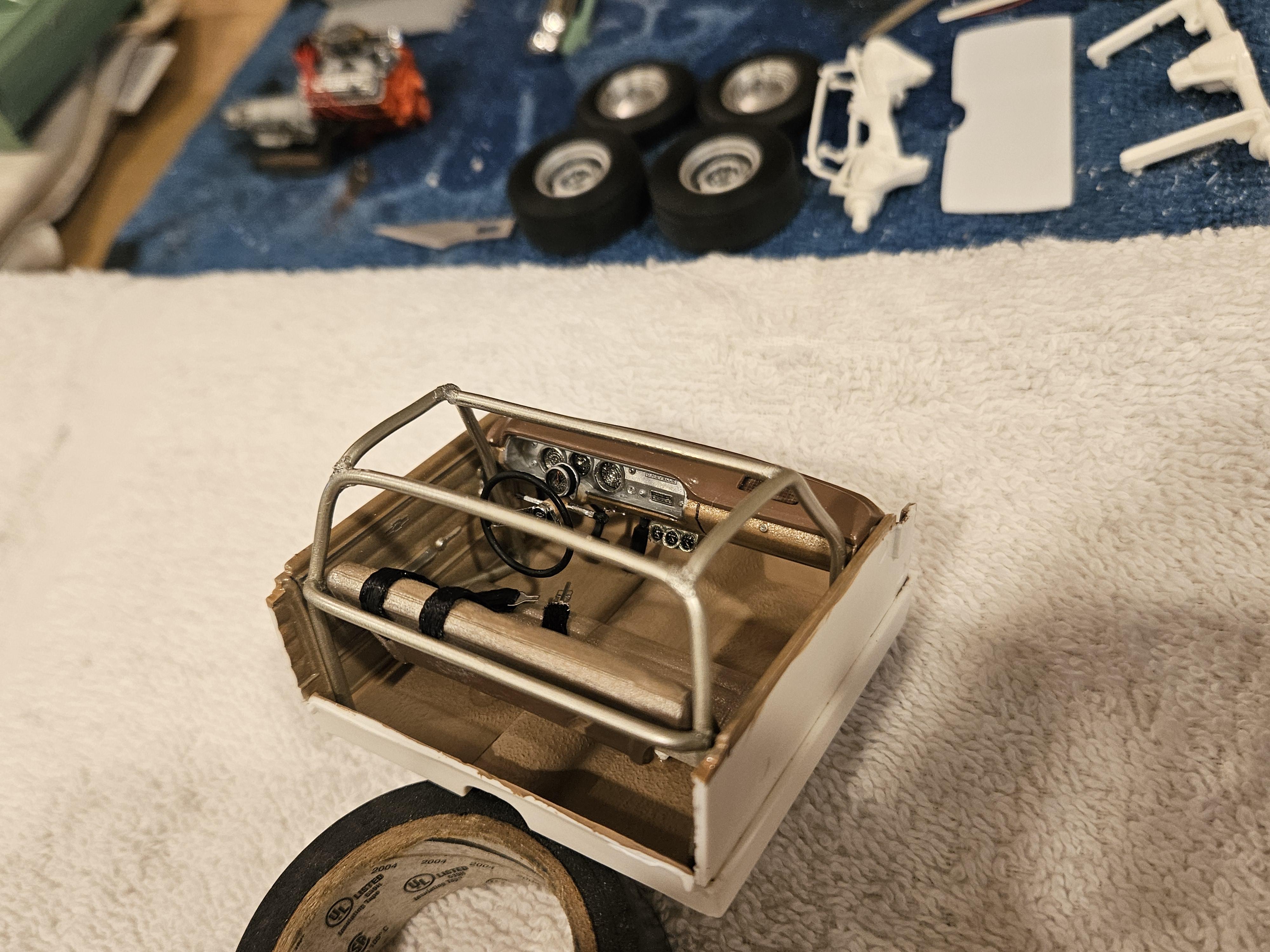

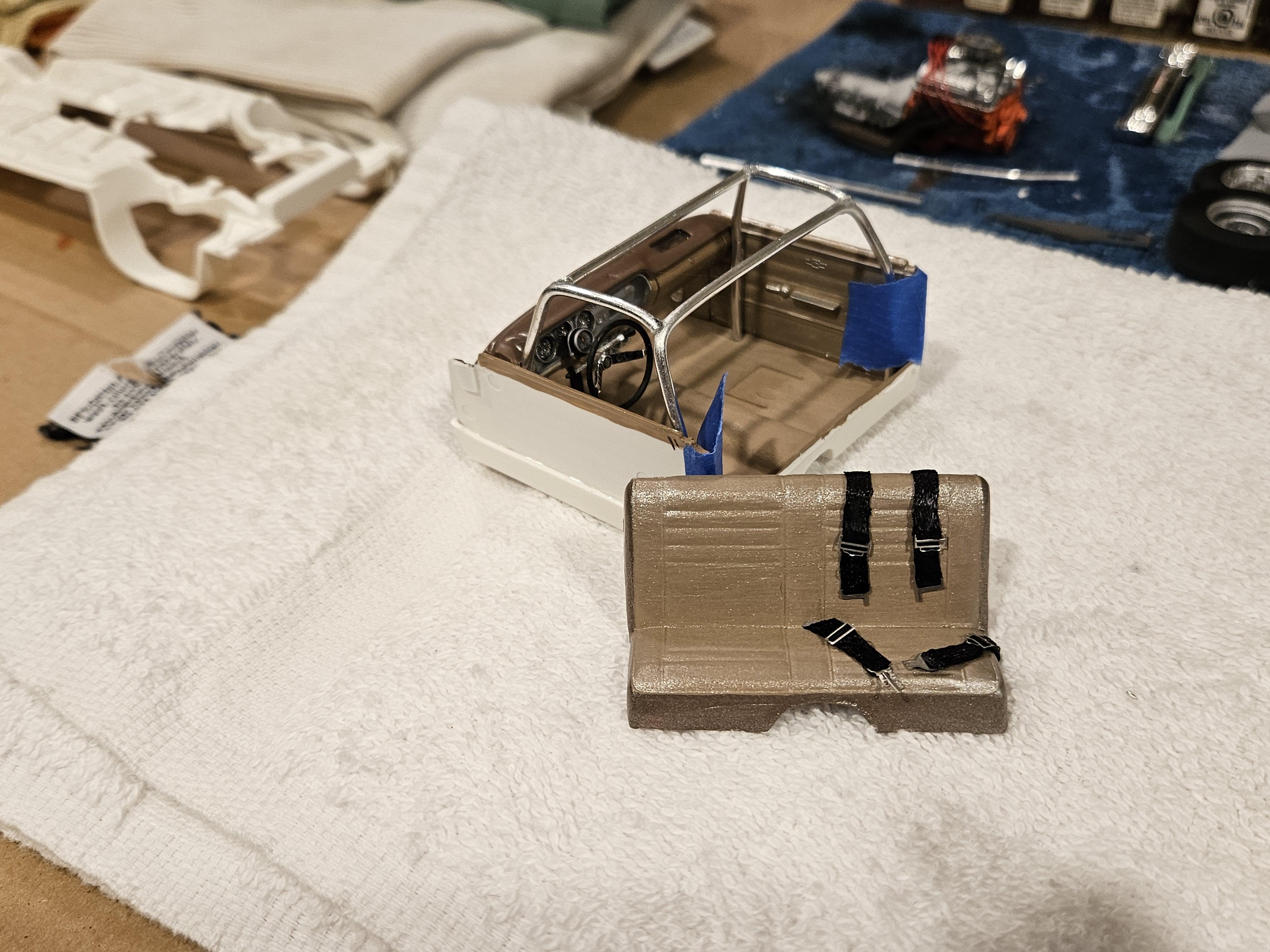

keviiin86 Posted July 18 Author Posted July 18 I added some BMF around the windows and glued in the glass to figure out how much room i have to the headliner for the cage. This roll cage has been kicking my butt, keep needing to tweak and cut and rebend the bars to get it to tuck up close to the headliner. I must have test fit the body chassis and interior together 30 times to get to this point lol. While I was waiting for the glue to dry on the roll cage I added a basic 4 point harness to the bench seat also. 1
Calb56 Posted July 18 Posted July 18 Looks excellent. May I ask what gauge of Aluminum wire you used for the roll bar cage? It looks spot on. 1
keviiin86 Posted July 18 Author Posted July 18 38 minutes ago, Calb56 said: Looks excellent. May I ask what gauge of Aluminum wire you used for the roll bar cage? It looks spot on. Thanks! I think it was 12 gauge jewelry wire from Michaels.

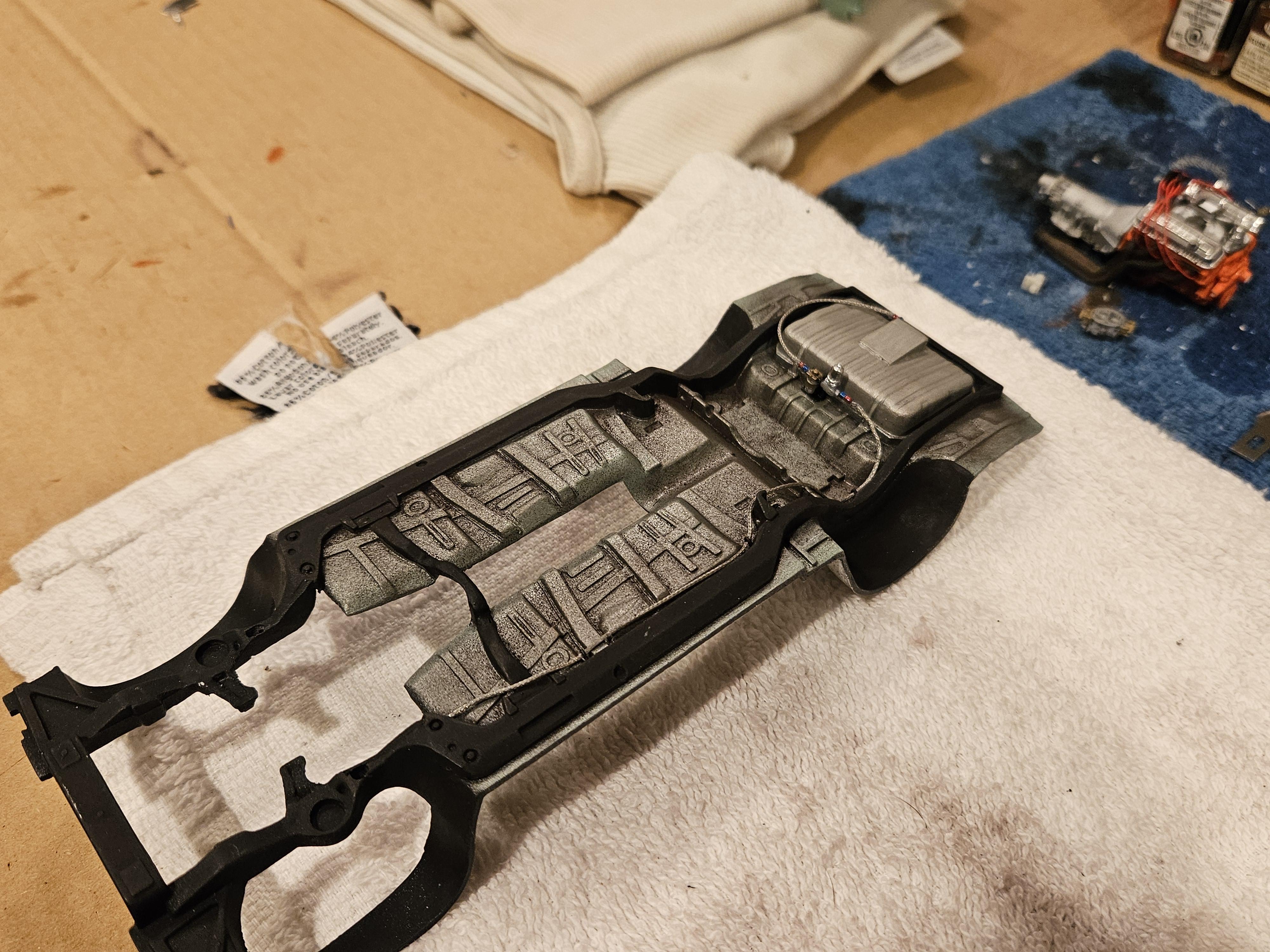

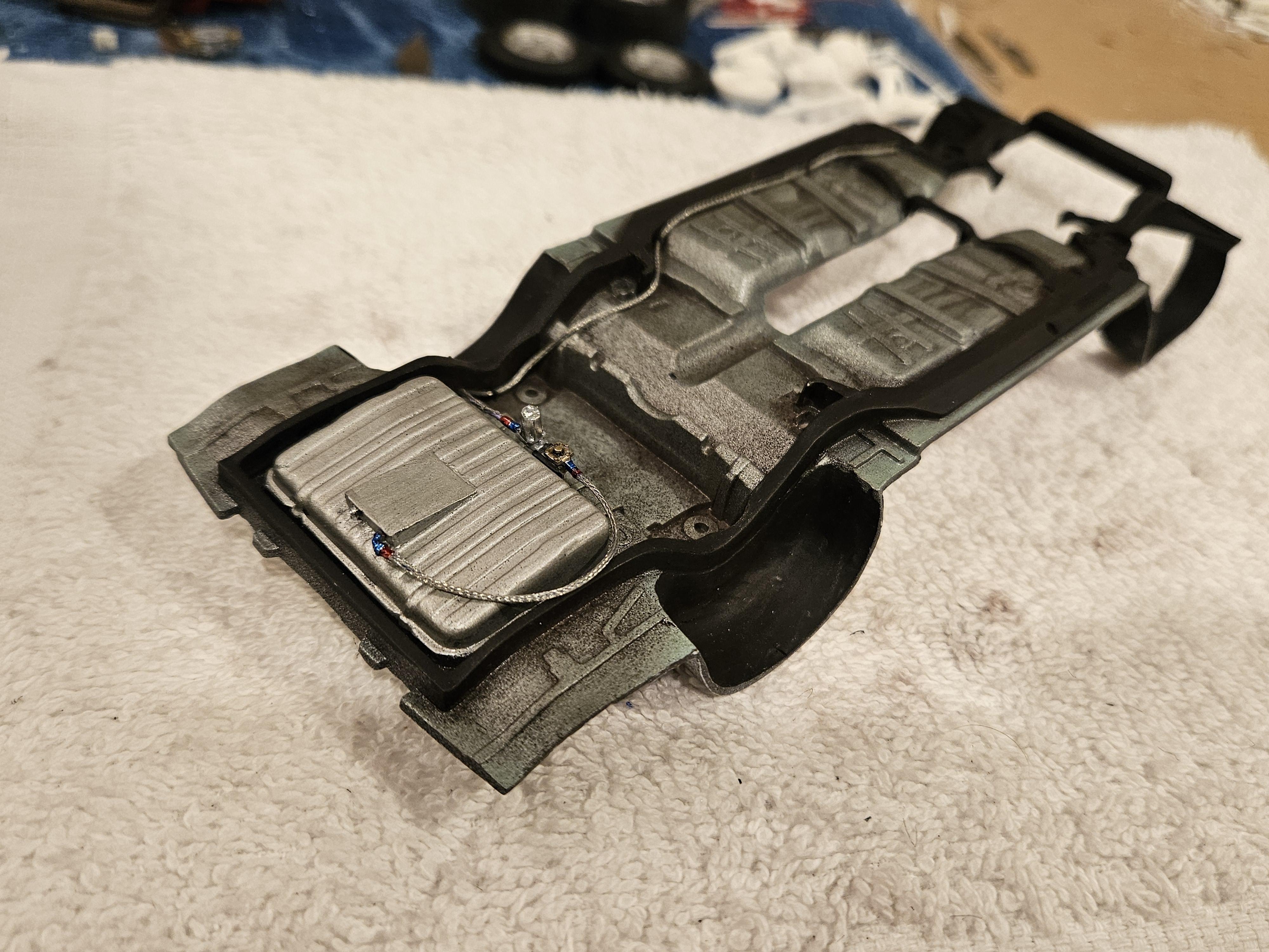

keviiin86 Posted July 26 Author Posted July 26 Added a sump to the gas tank and painted and dirtied up the chassis to make it look like a driver.

keviiin86 Posted July 31 Author Posted July 31 Added a braided fuel line with electric pump and filter to the chassis. 1

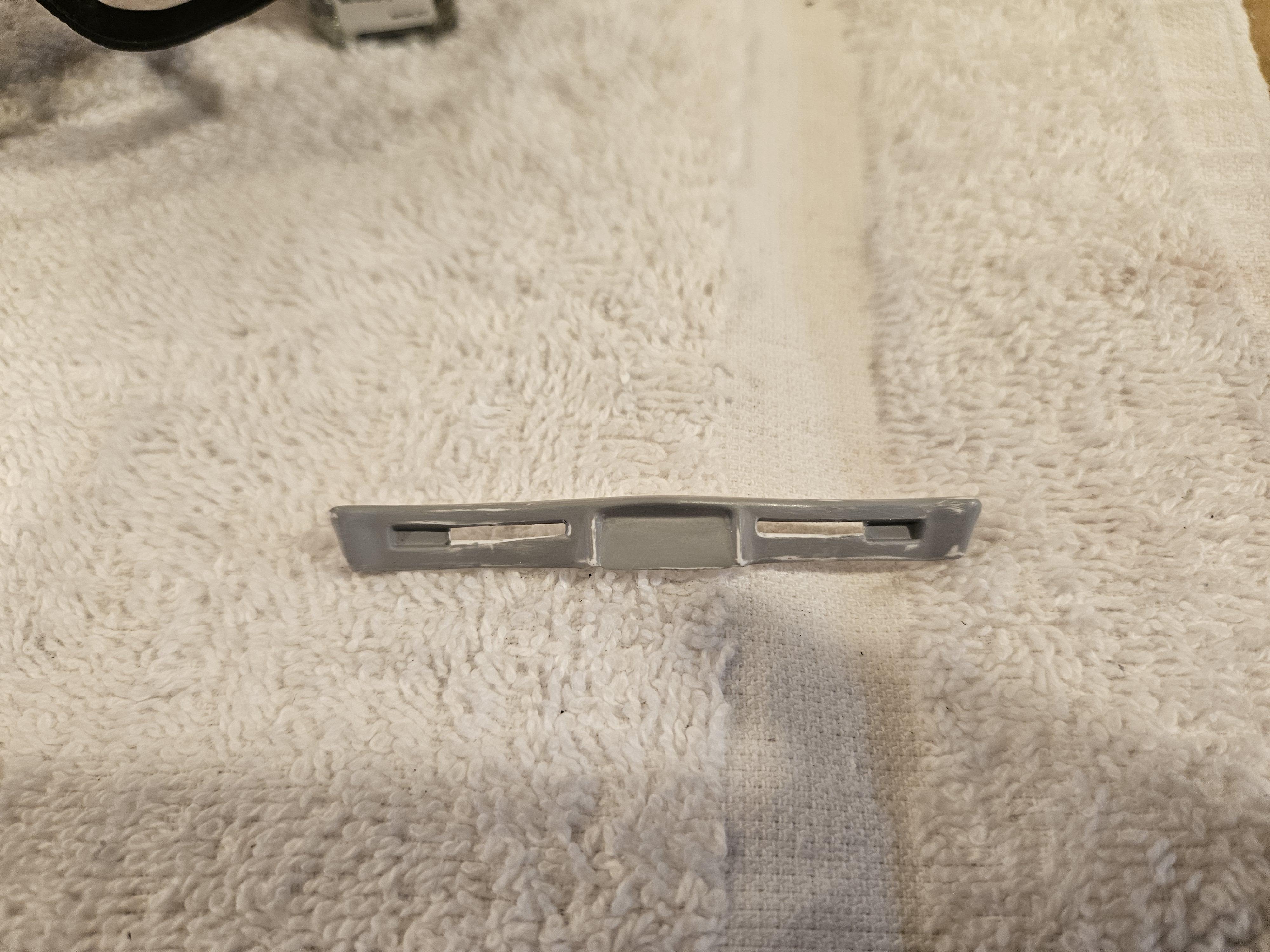

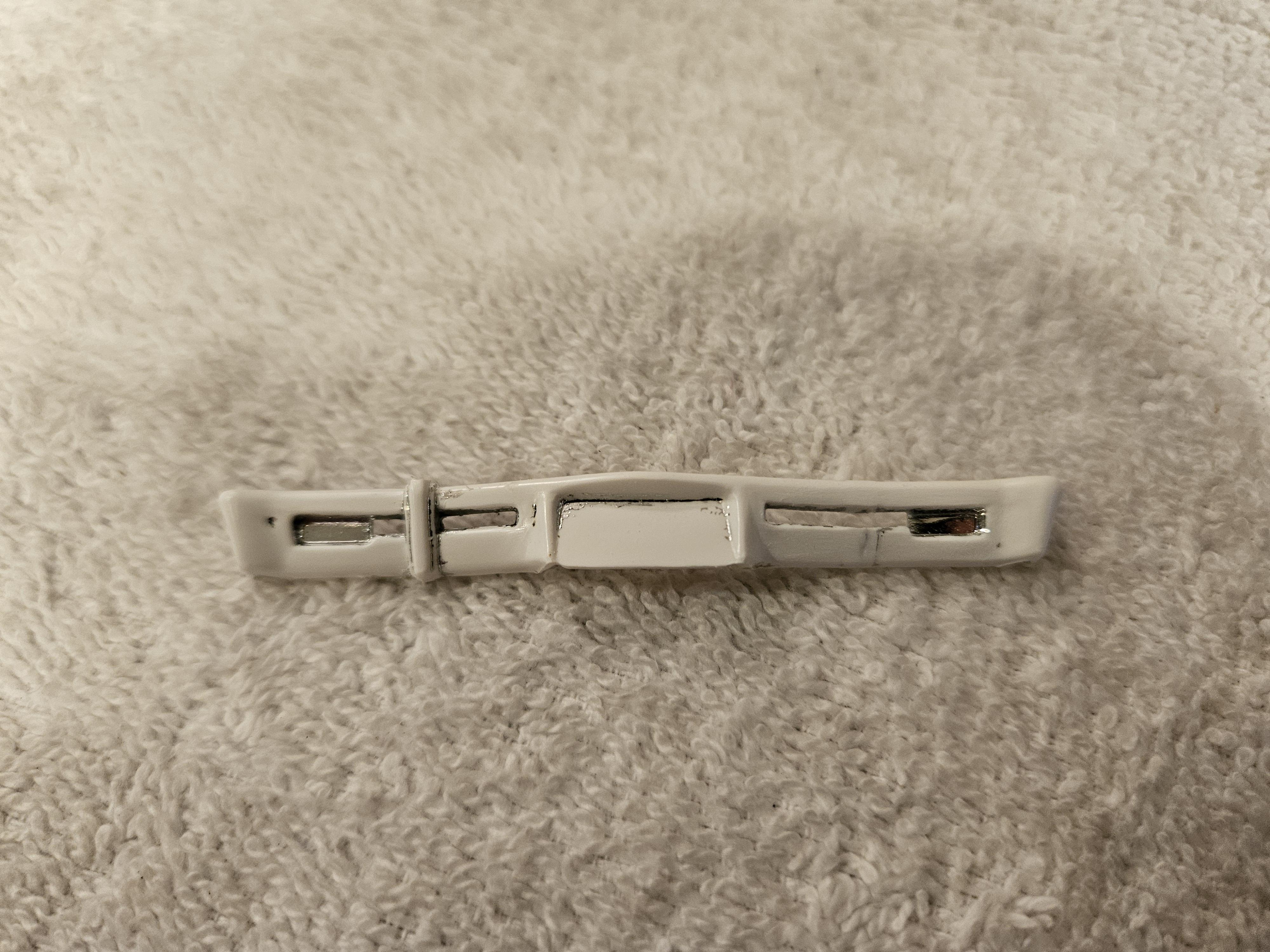

keviiin86 Posted August 4 Author Posted August 4 Tried to use the AMT front bumper from the el camino kit but it's too narrow for the revell front clip so I took the revell bumper and chopped off the bumperettes, sanded smooth and filled with a little putty, shot with primer and then Revell chrome.

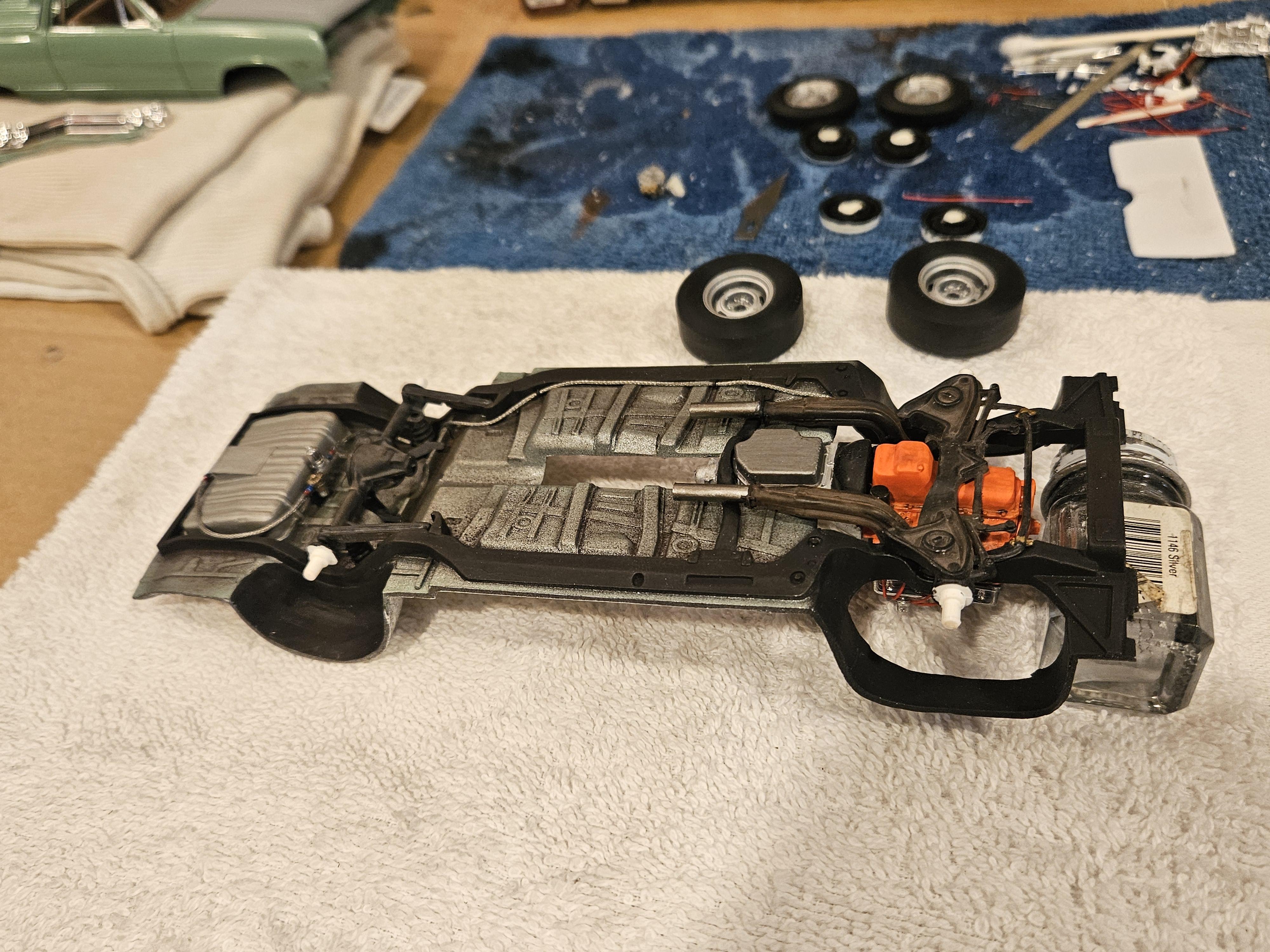

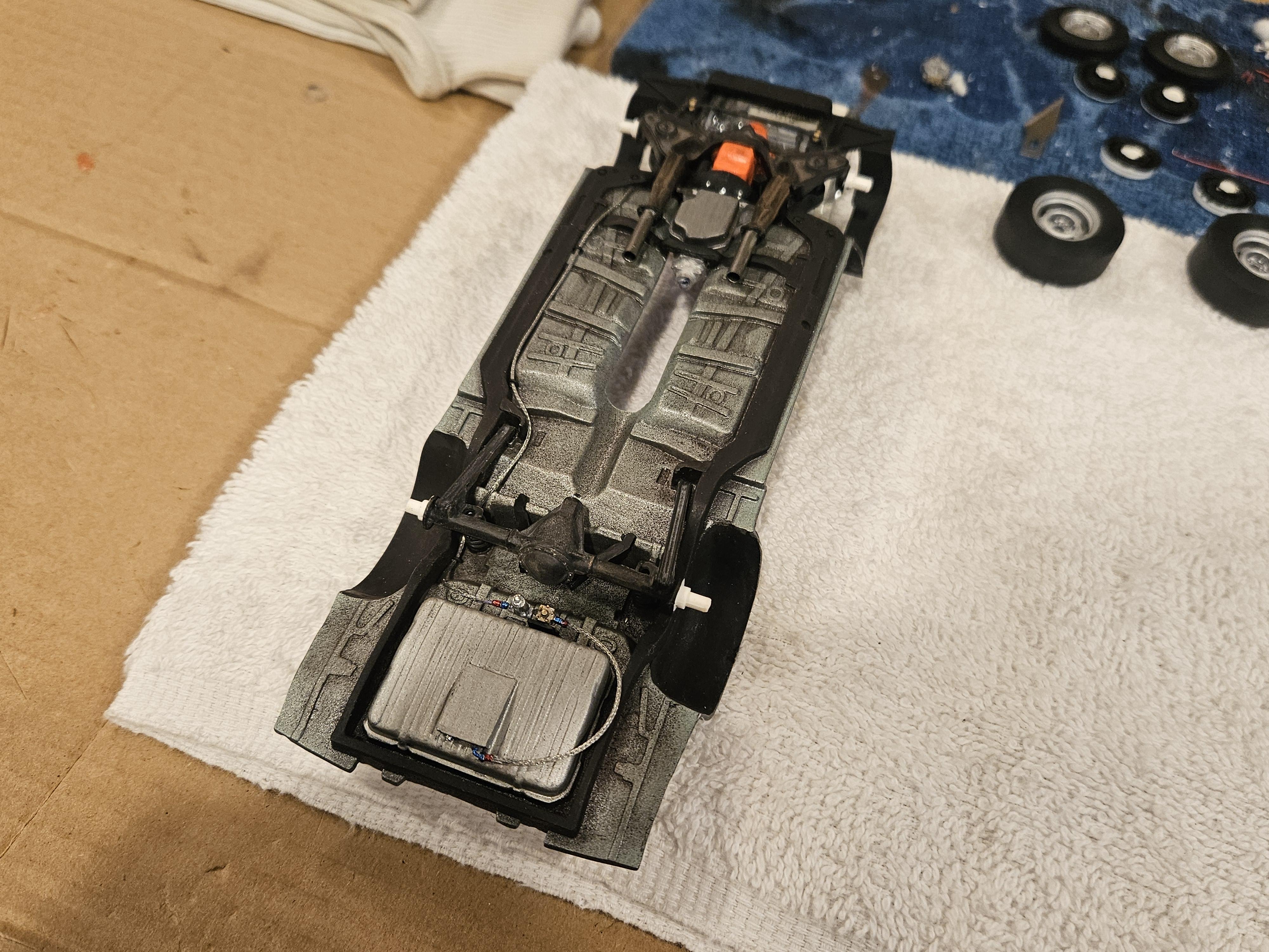

keviiin86 Posted August 5 Author Posted August 5 Still have to mount the shocks and drive shaft but otherwise the chassis is mostly done. 1

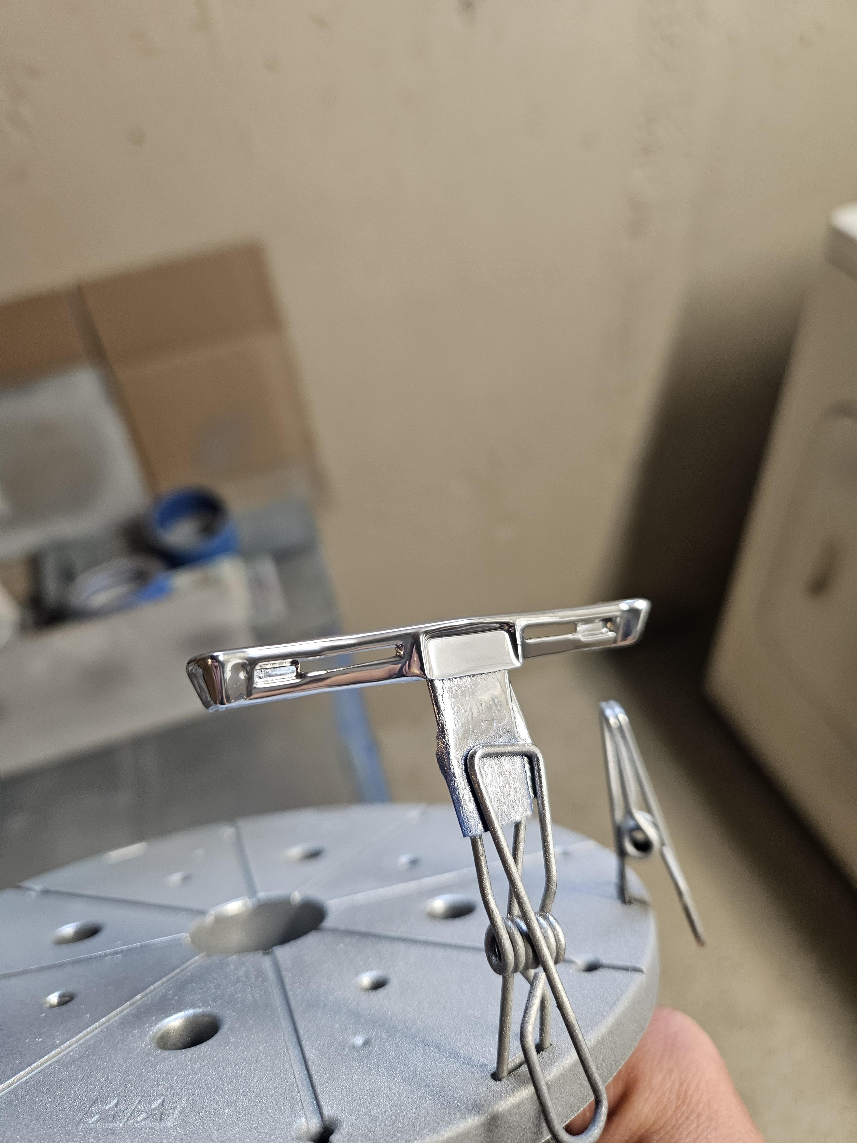

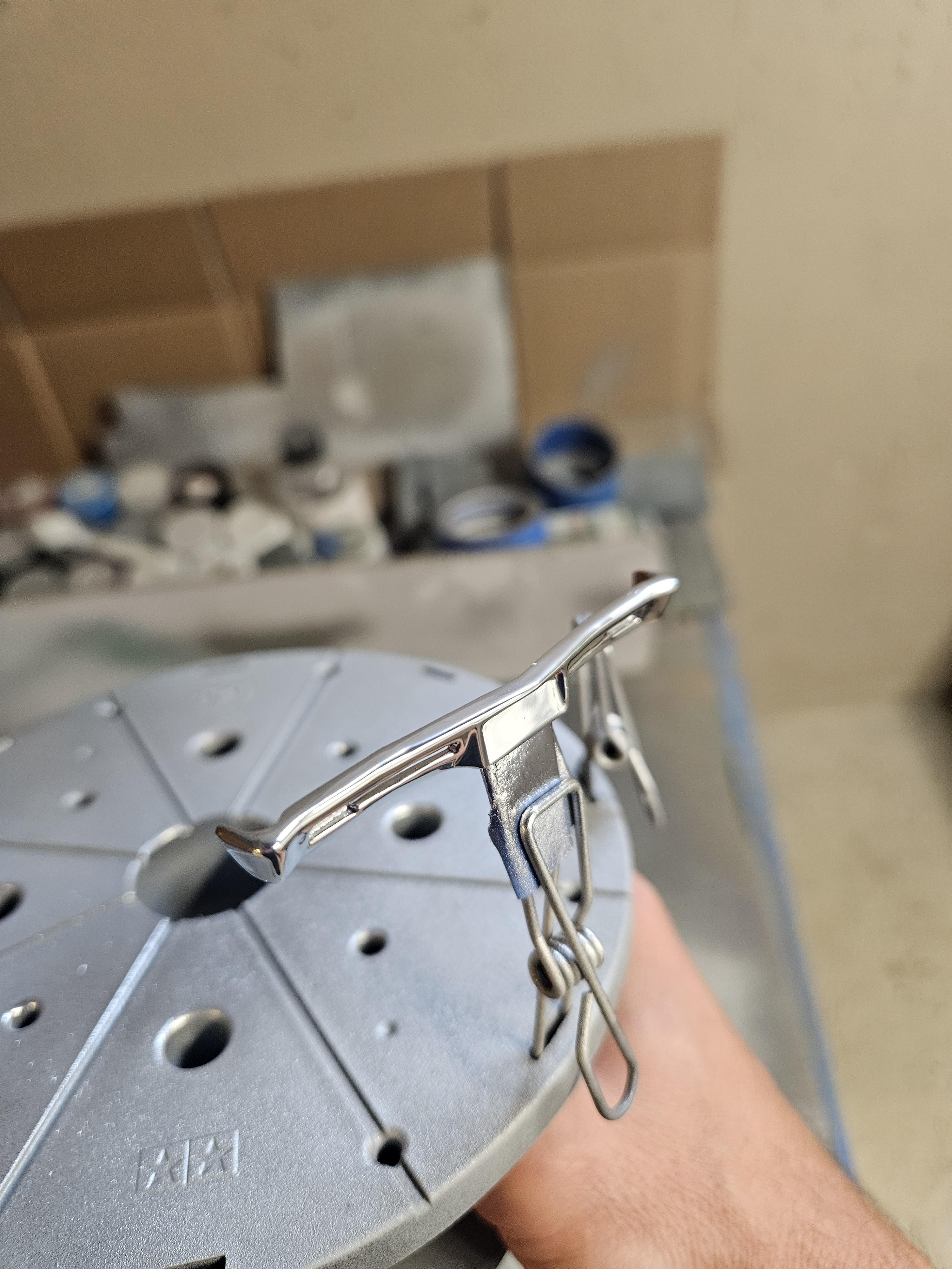

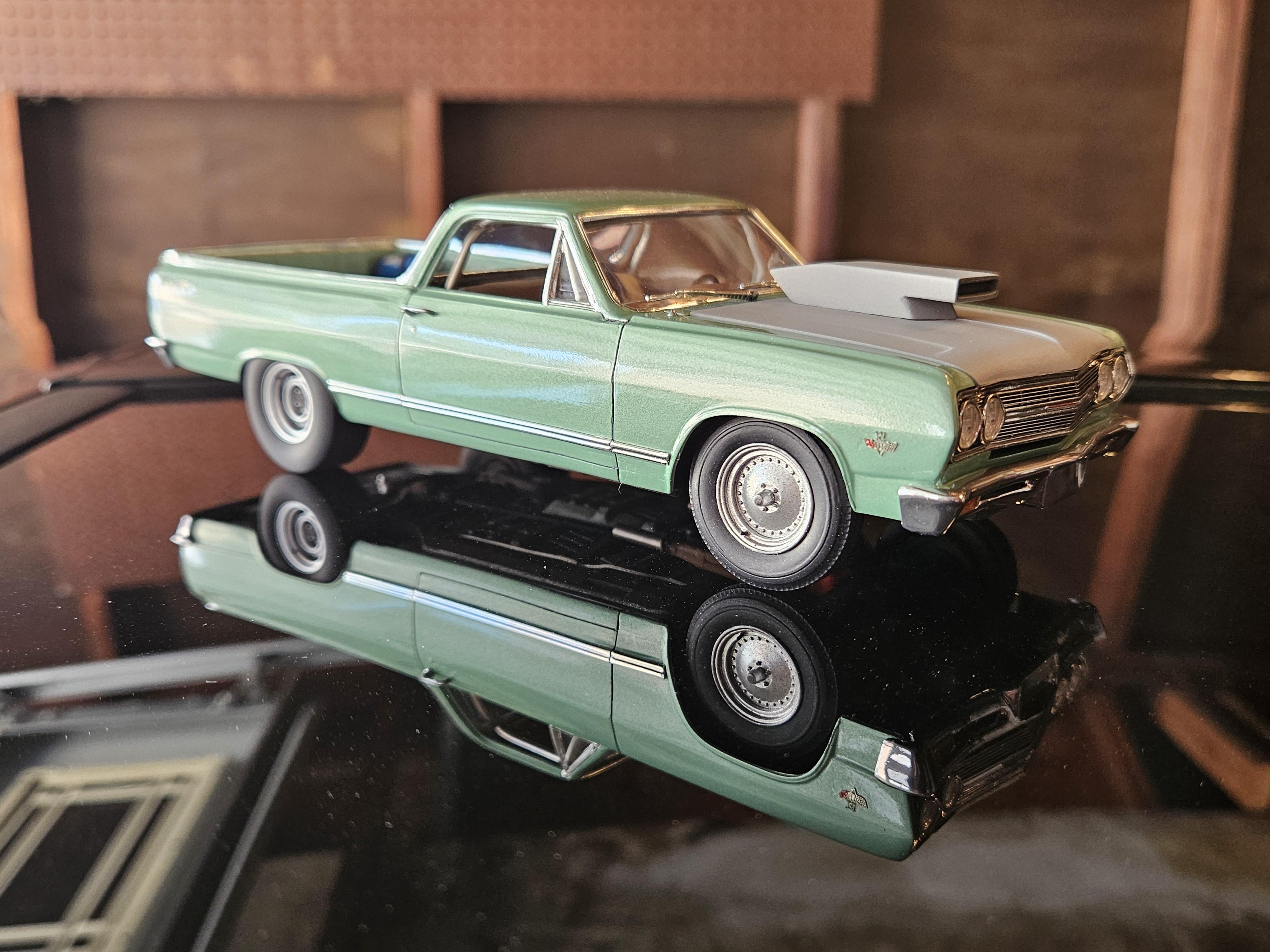

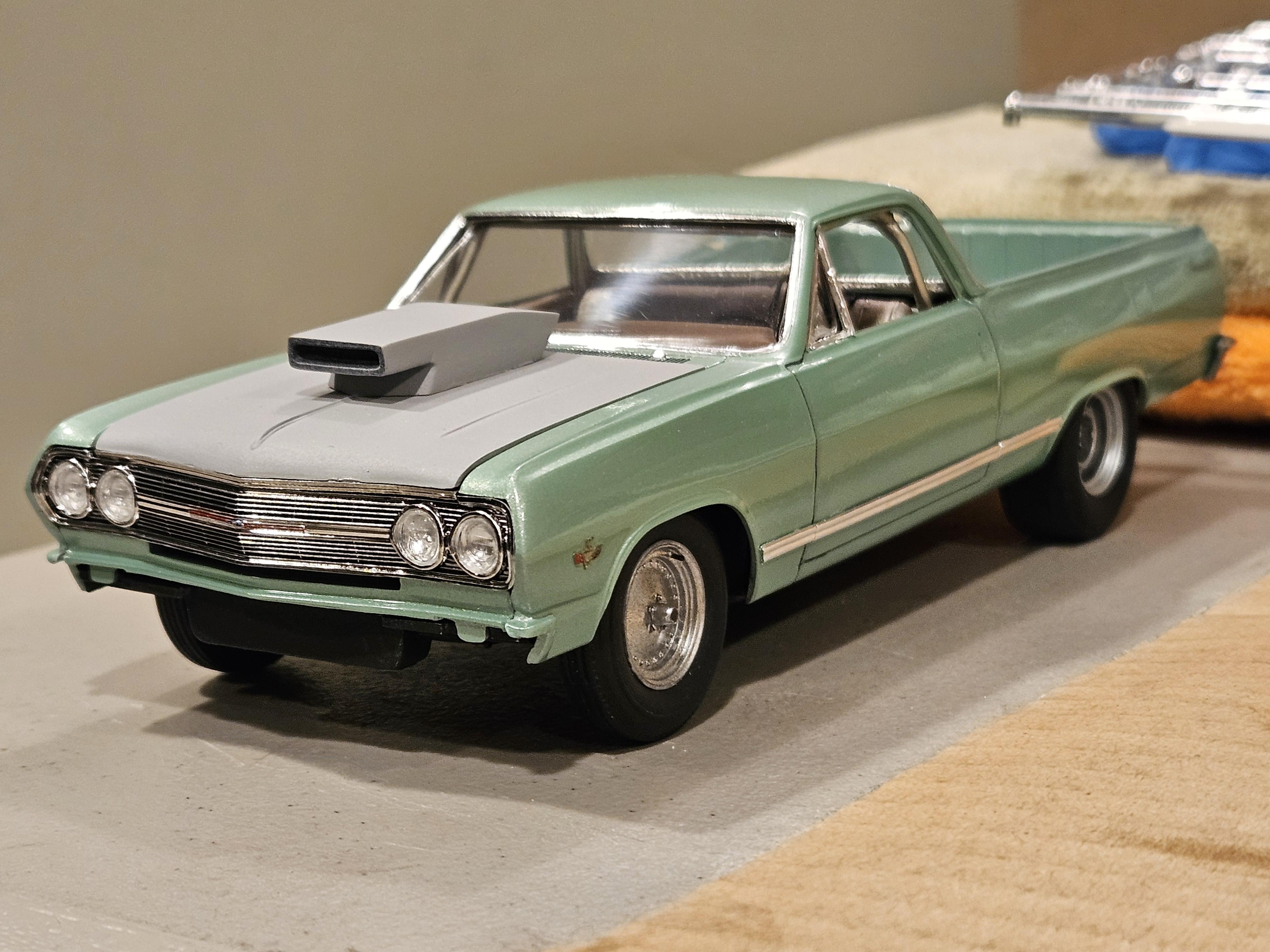

keviiin86 Posted August 29 Author Posted August 29 Stripped the chrome on the rear bumper, shot with revell chrome and installed the turn signal and back up lenses in both bumpers as well as giving the grille a coat of tamiya smoke and gluing in headlights. Had to grind the core support a little to get the lower grille valance to sit flush. Also foiled the belt line trim. Last bit left to foil is around the top sides of the bed but ill wait till the body is on the chassis to avoid having the foil ripped off with the body upside down on the towel. 5

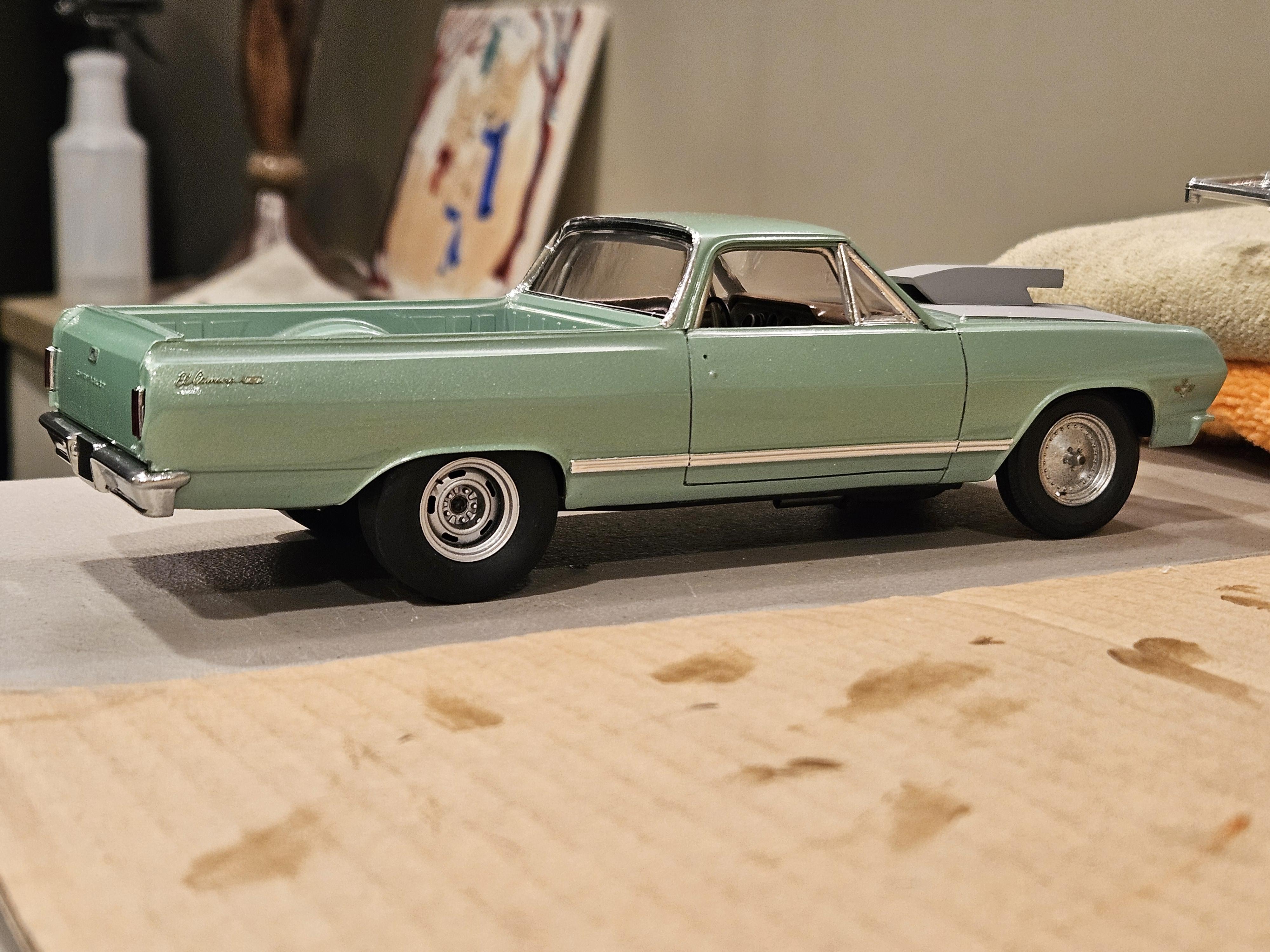

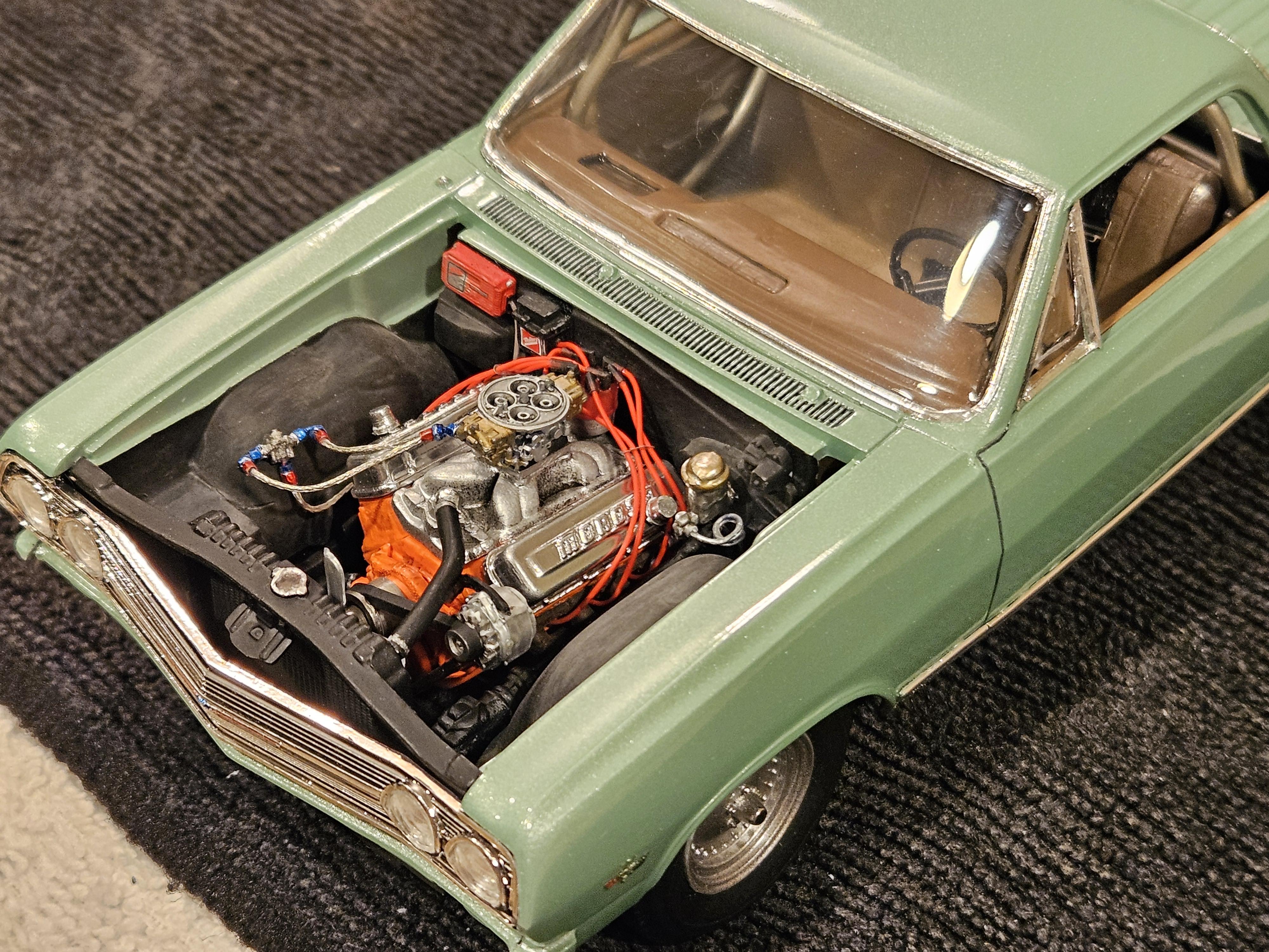

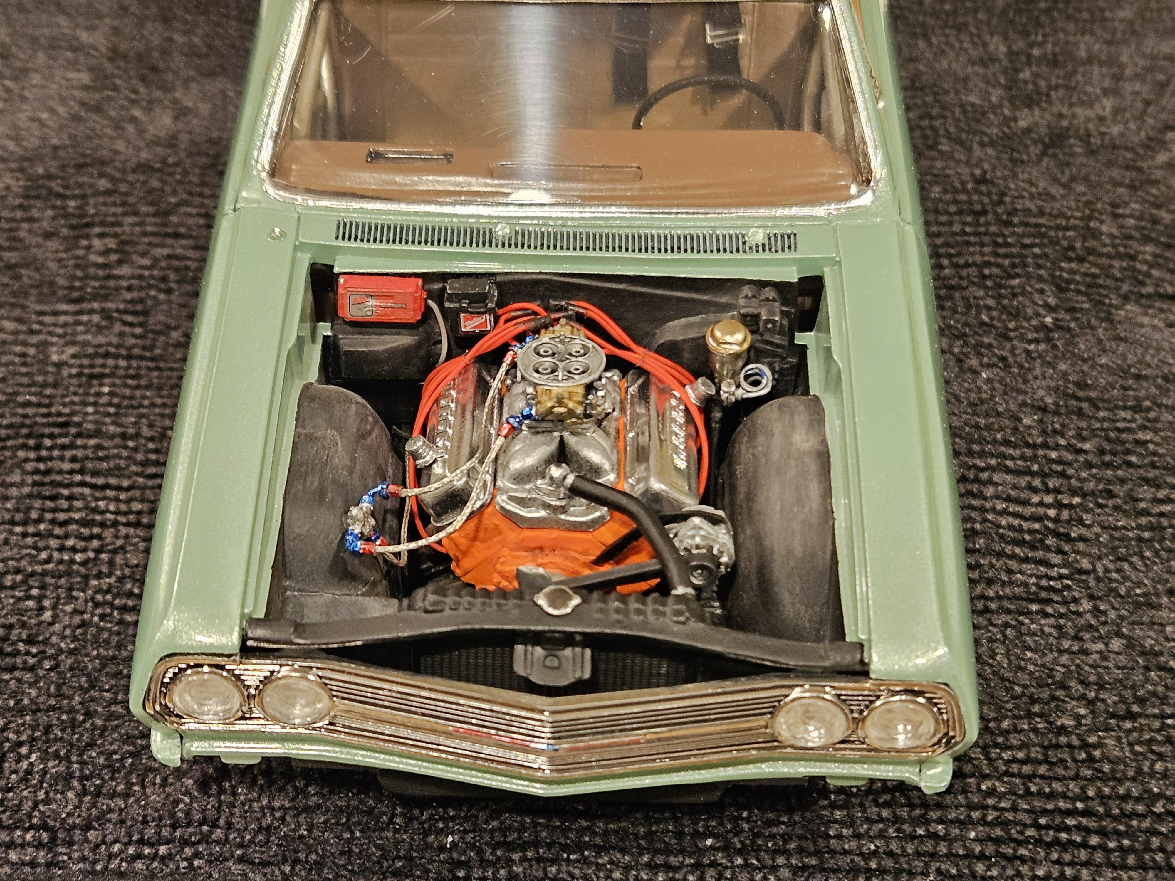

keviiin86 Posted yesterday at 06:09 AM Author Posted yesterday at 06:09 AM Close to finishing this one. Engine compartment is almost done, just have to put on the throttle linkage, then foil the last remaining bits on the bed rails and attach door handles, mirror and bumper. Should be done in the next few days when I get some more time to work on it. 3
