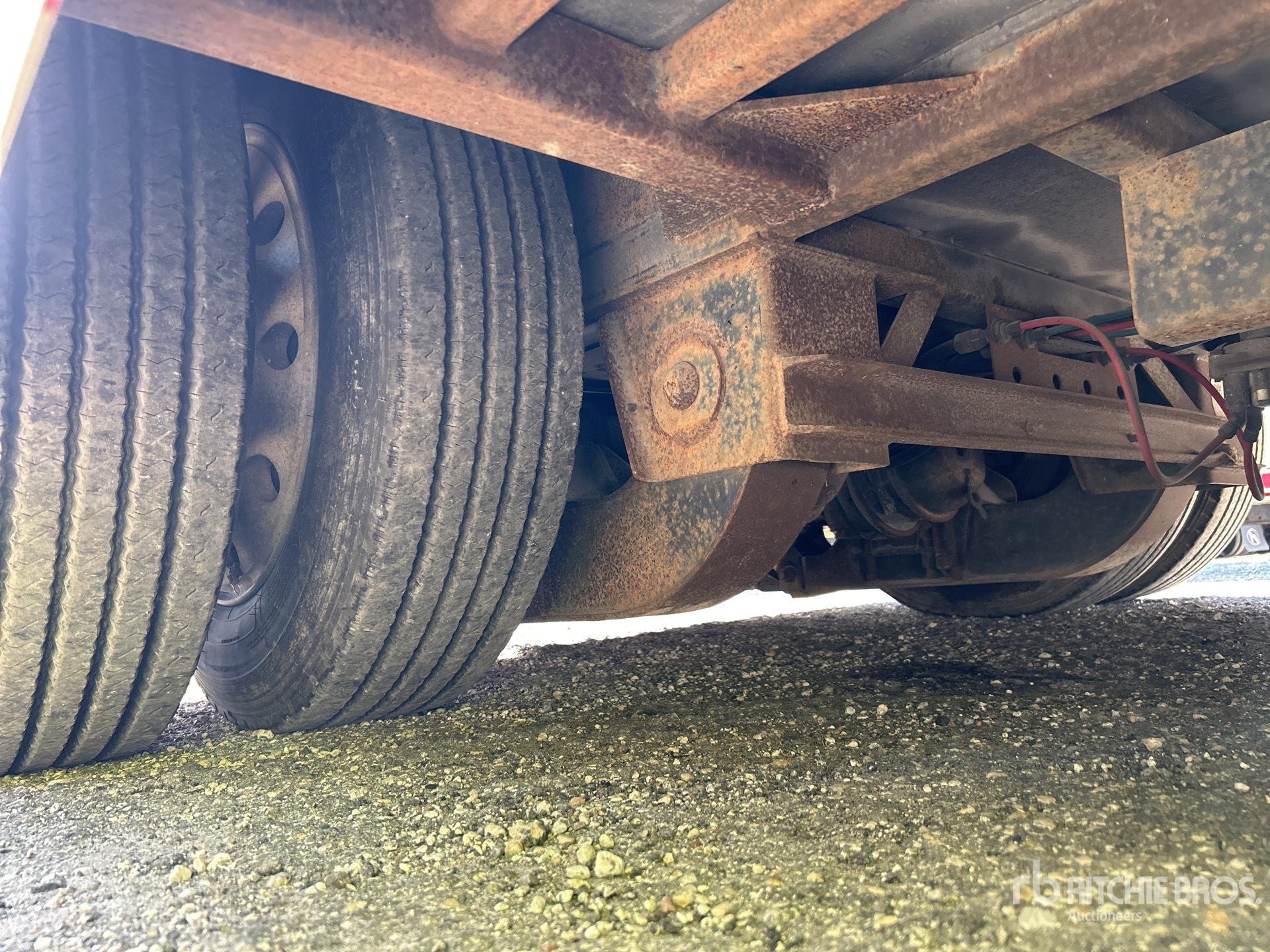

Thank you sir!! This will help me immensely. I've been searching like crazy to find shots of the frame / axles. These things are so low to the ground that it's seemingly impossible to find good pics of the "bones" underneath them.

The axles are low mount air ride axles and I have found a few pictures of the underside of a Featherlite trailer.

24 minutes ago, Force said:
No problem.
That answers a bunch of my questions and confirms, to me, that starting from the Moebius Smooth Side (or Great Dane but the Smooth Side's walls would be easier to clean up to mimic the sides of the Featherlite) is the best option. The underbelly of the floor on it is of nearly identical construction. Those axles don't look like they'd be too awful to fab up. I was genuinely confused how the real Featherlite trailer kept the floor the same height between the axles as the rest of the drop but that makes a ton of sense now.
