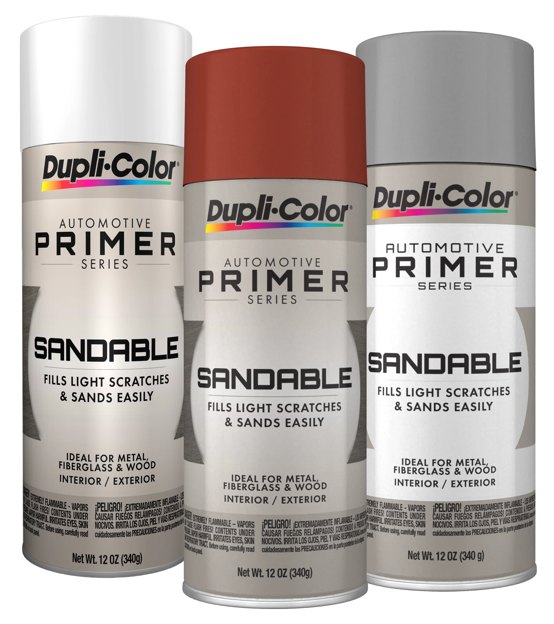

Mark W Posted 23 hours ago Author Posted 23 hours ago 2 hours ago, Shark said: I was going to say the same thing, but hesitated not wanting to mess up Mark's paint job. Duplicolor makes a white fine primer. 6 hours ago, Dave G. said: Several people here like Duplicolor primer to use under MCW lacquers. I don't know about Alclad. Dave and Todd, I also build model aircraft and was looking to keep my paint stock down to a minimum. But also I believe in keeping apples and oranges apart. (I.e. using totally compatible products) Since duplicolor makes a fine white as you said, I believe I’ll just go that route. Do you know the specific description or a label photo? I don’t want the thick one that fills scratches. thanks
Mark W Posted 22 hours ago Author Posted 22 hours ago I believe this is the one you are referring to, as their other primer says “fills deep scratches”. As always, I will do a test piece.
