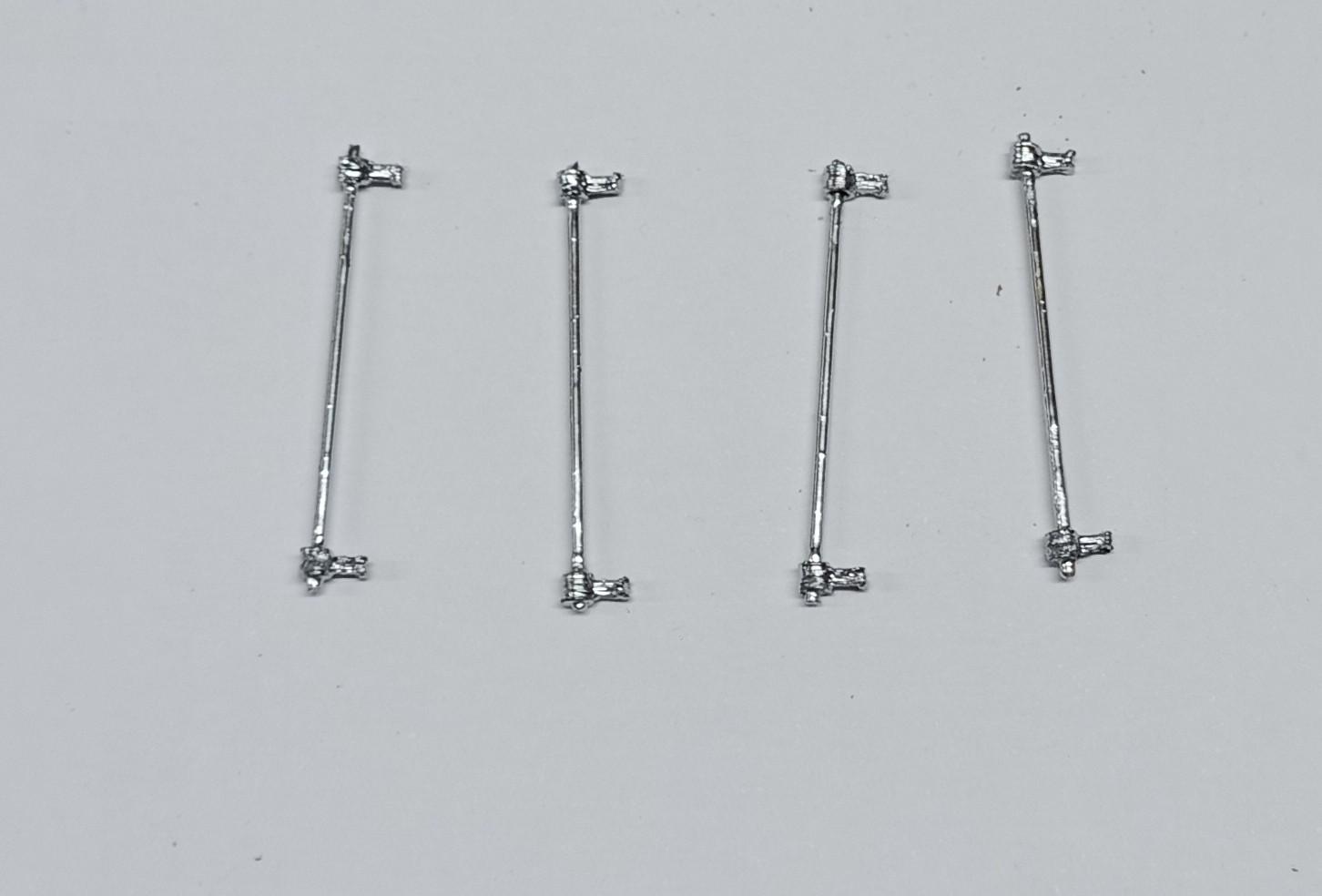

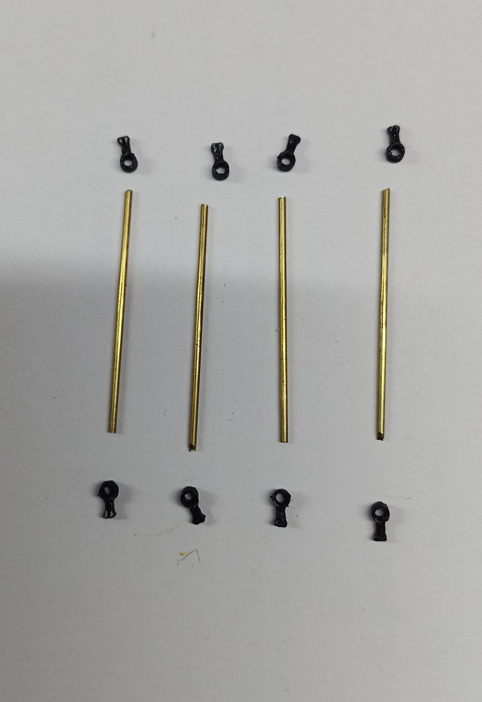

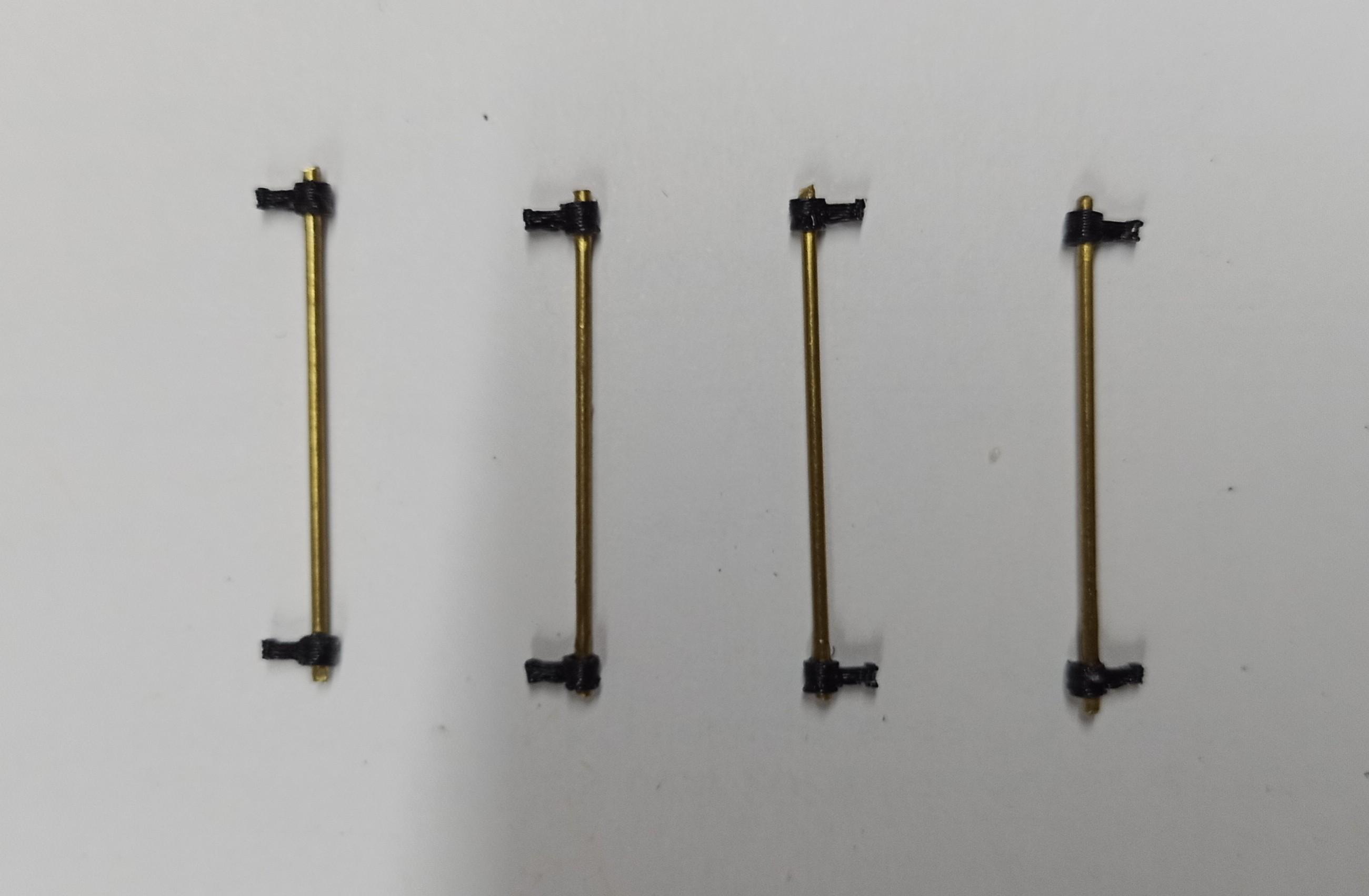

Some small stuff:
I made the hand rails out of tiny printed parts (I was amazed that they came out so well on my printer despite the size) and 1mm brass rod:
Perfect fit:
Finished:
  • Like 4
Thanks Brian!
Printing those tiny pieces is always an adventure.
I had done some adjusting in the slicer and it seems to have payed off!

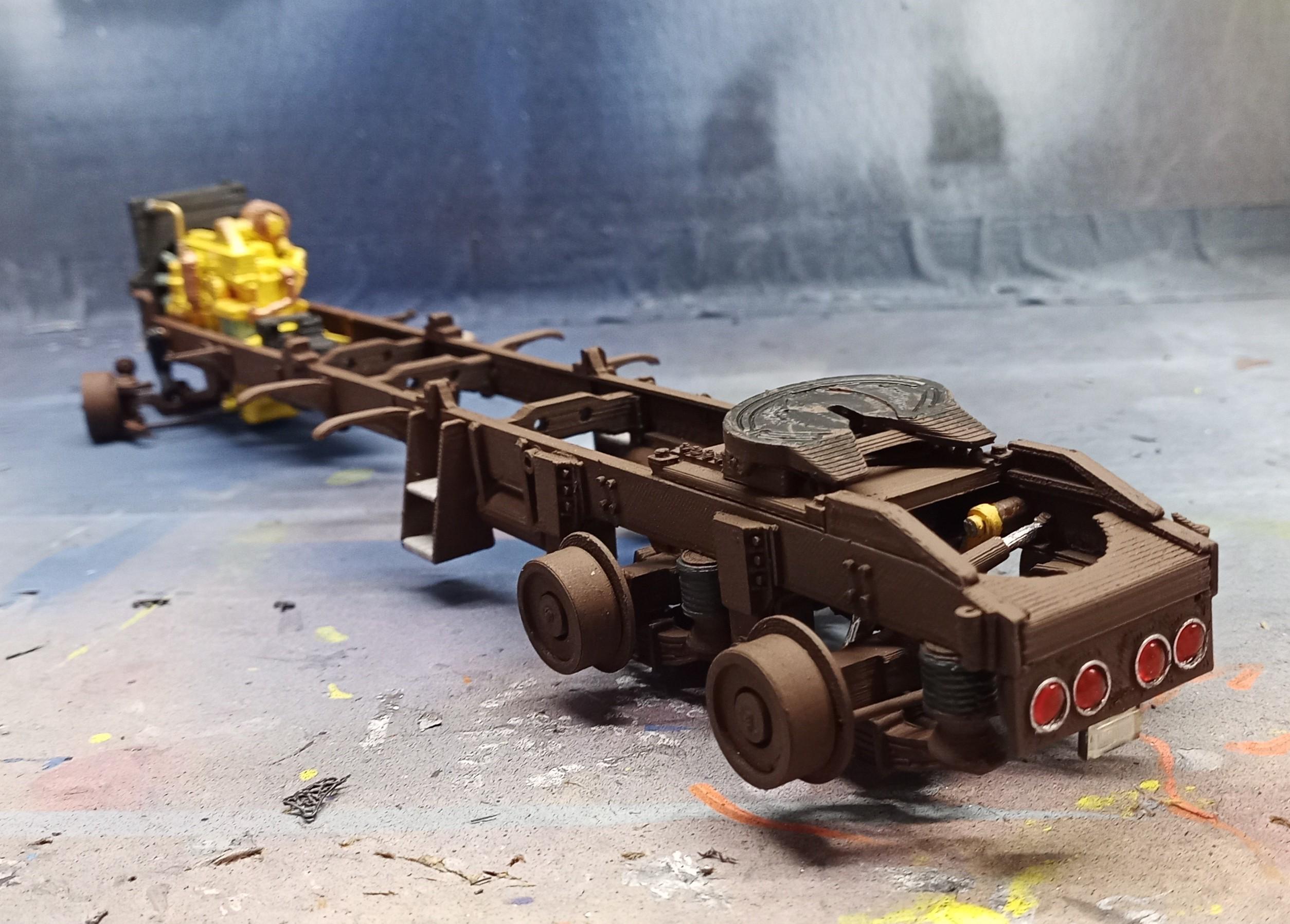

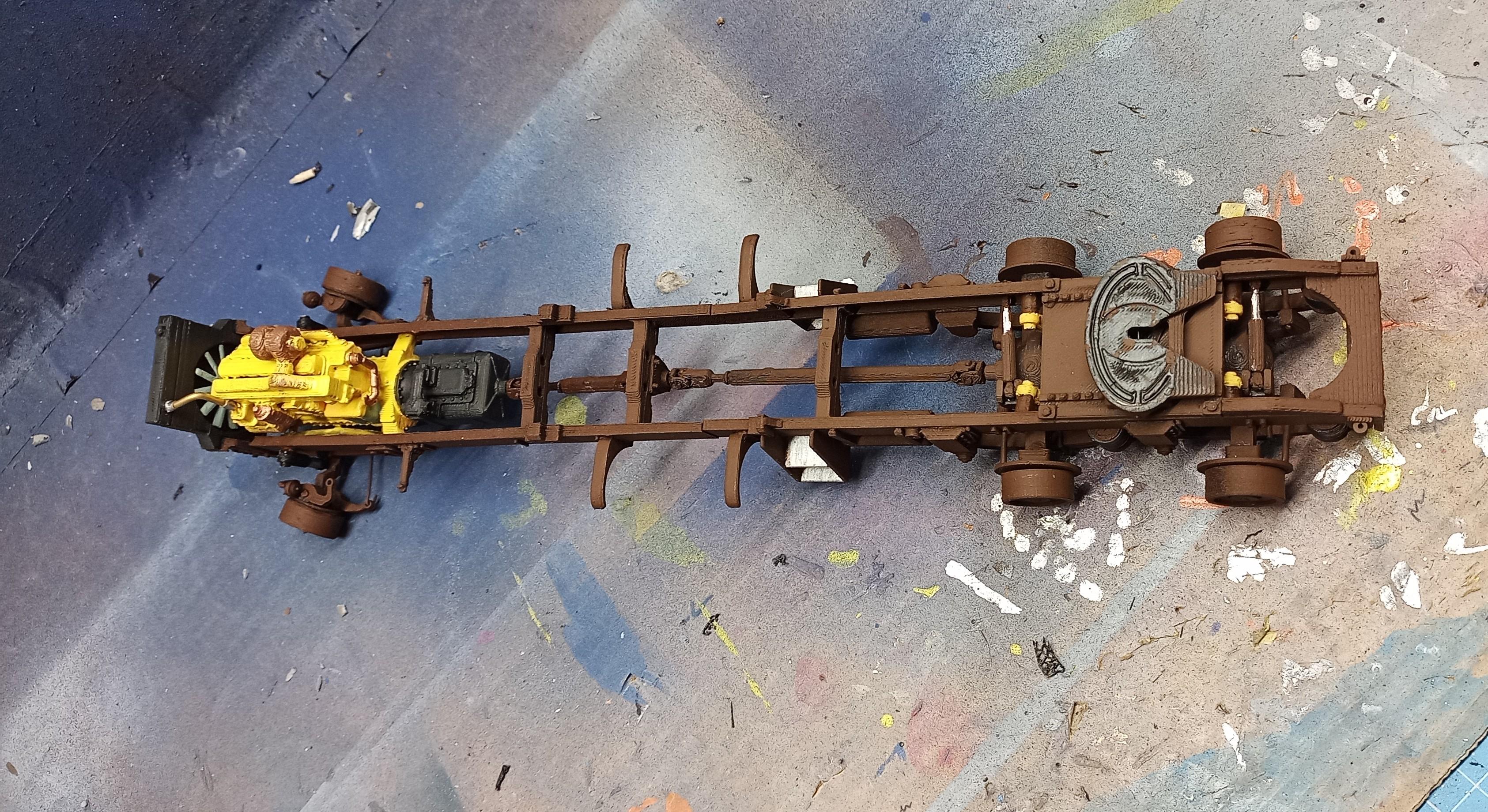

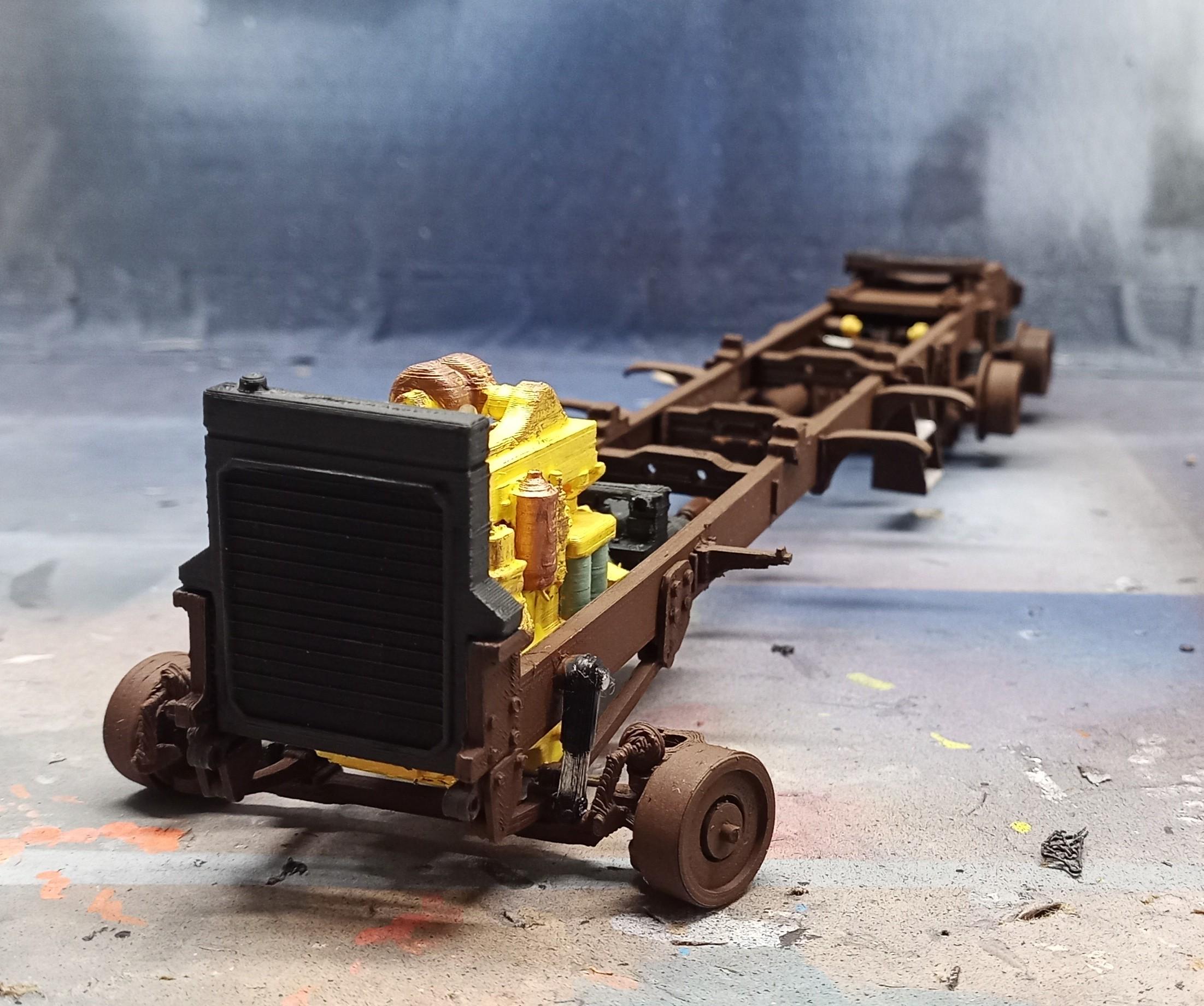

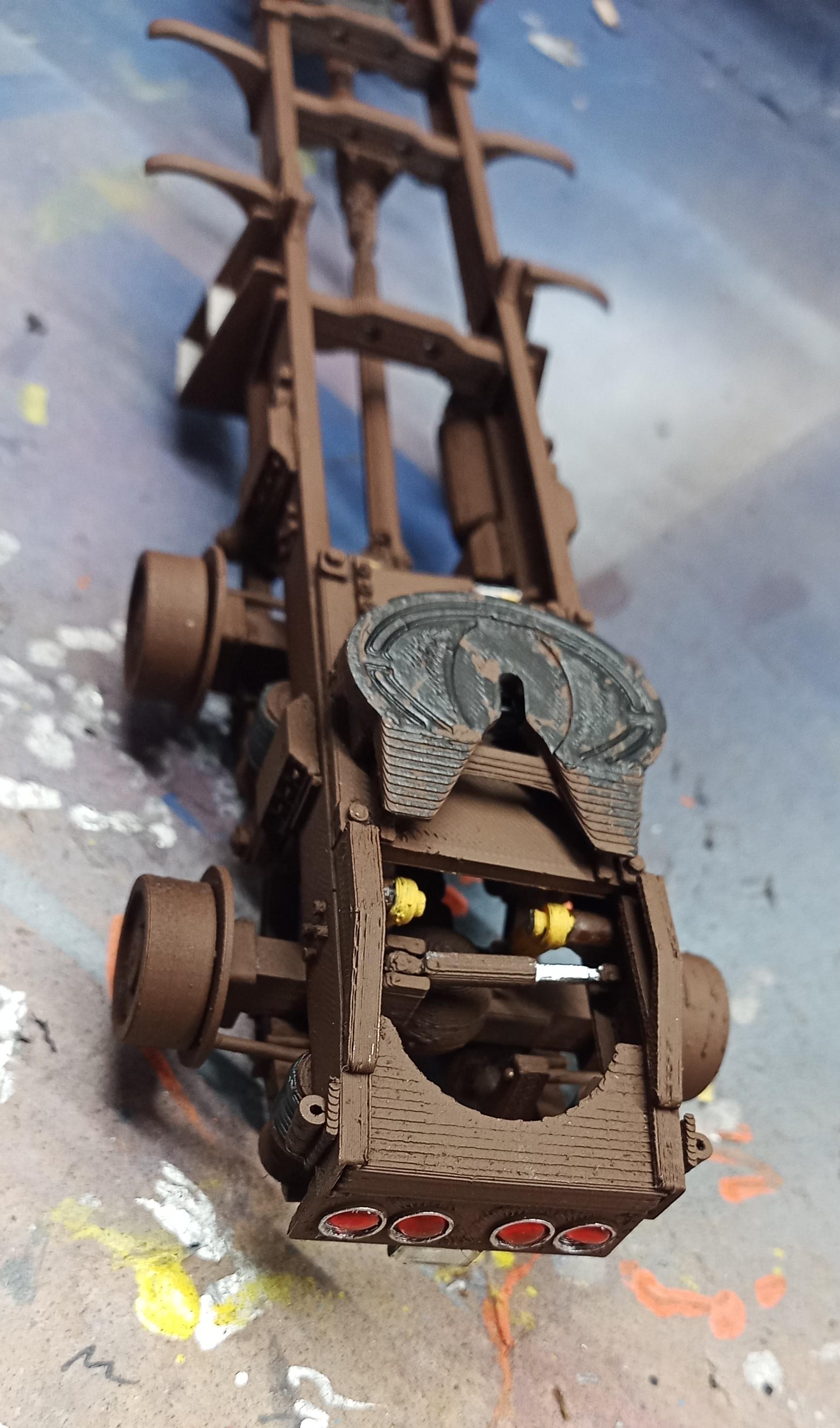

Chassis is painted now. Pics will follow when it's dry!
  • Like 1

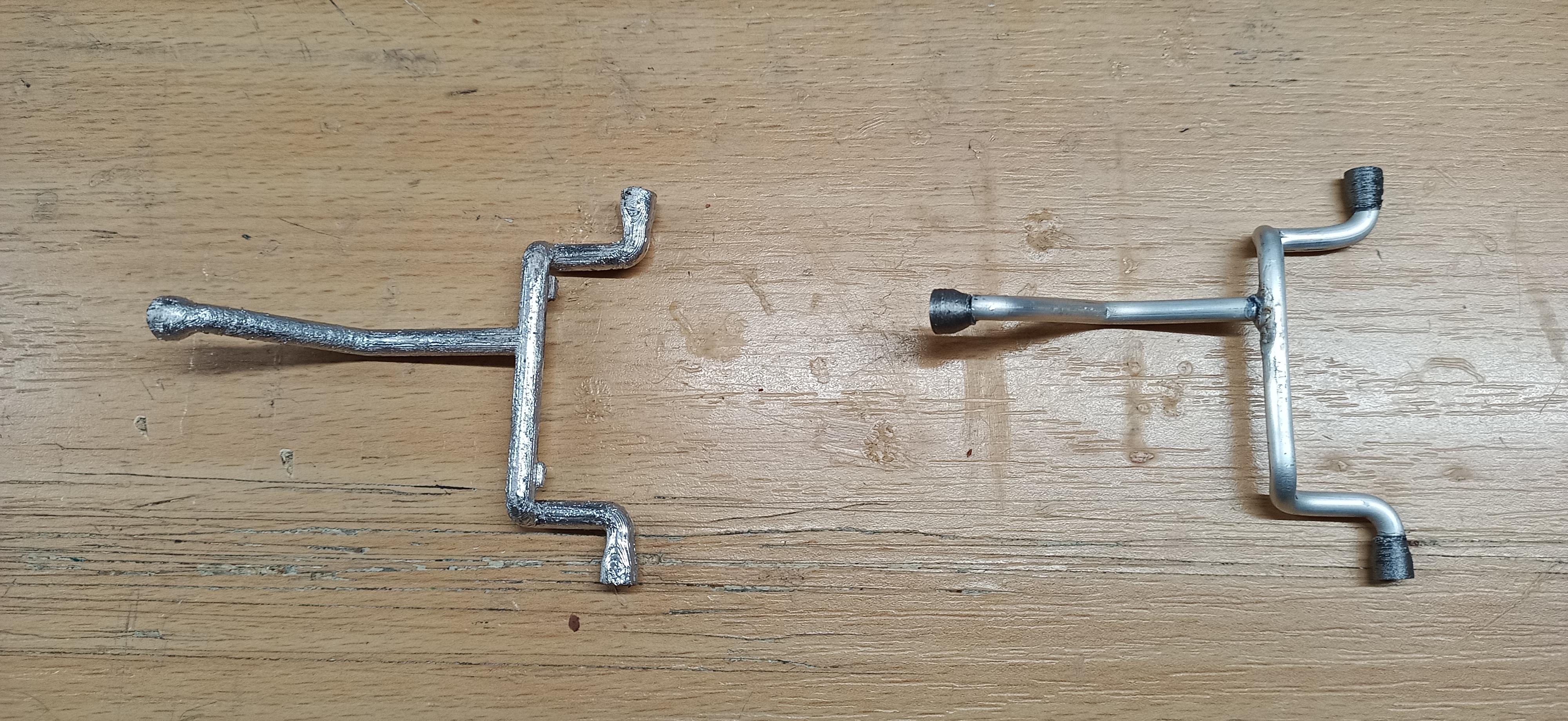

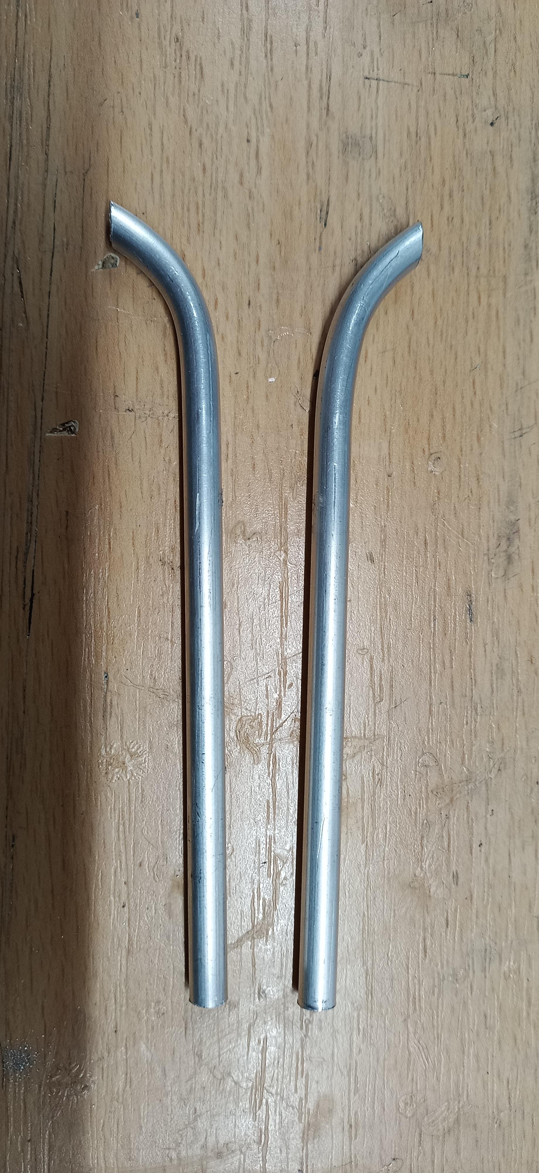

I didn't like the printed stacks, especially the bent part so I had decided to use straight stacks without heatshields.
That decision bothered me so I tried to bend a 6mm aluminium tube into shape!
I used a small vice which I had made myself back in school and carefully bent the tubes by hand.
The results were aching hands and these:
I think they look quite nice!
And these I will polish and see how they look.

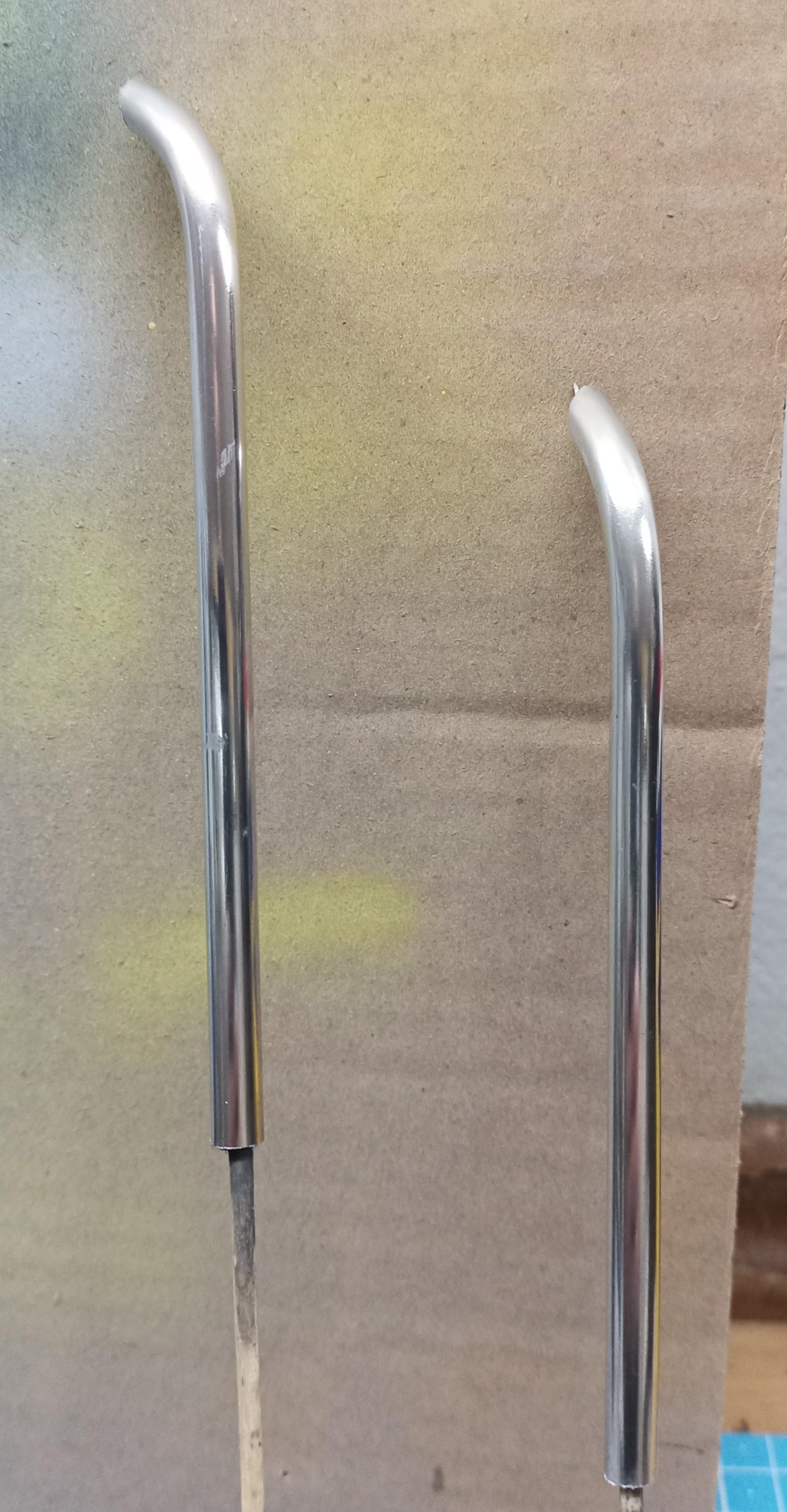

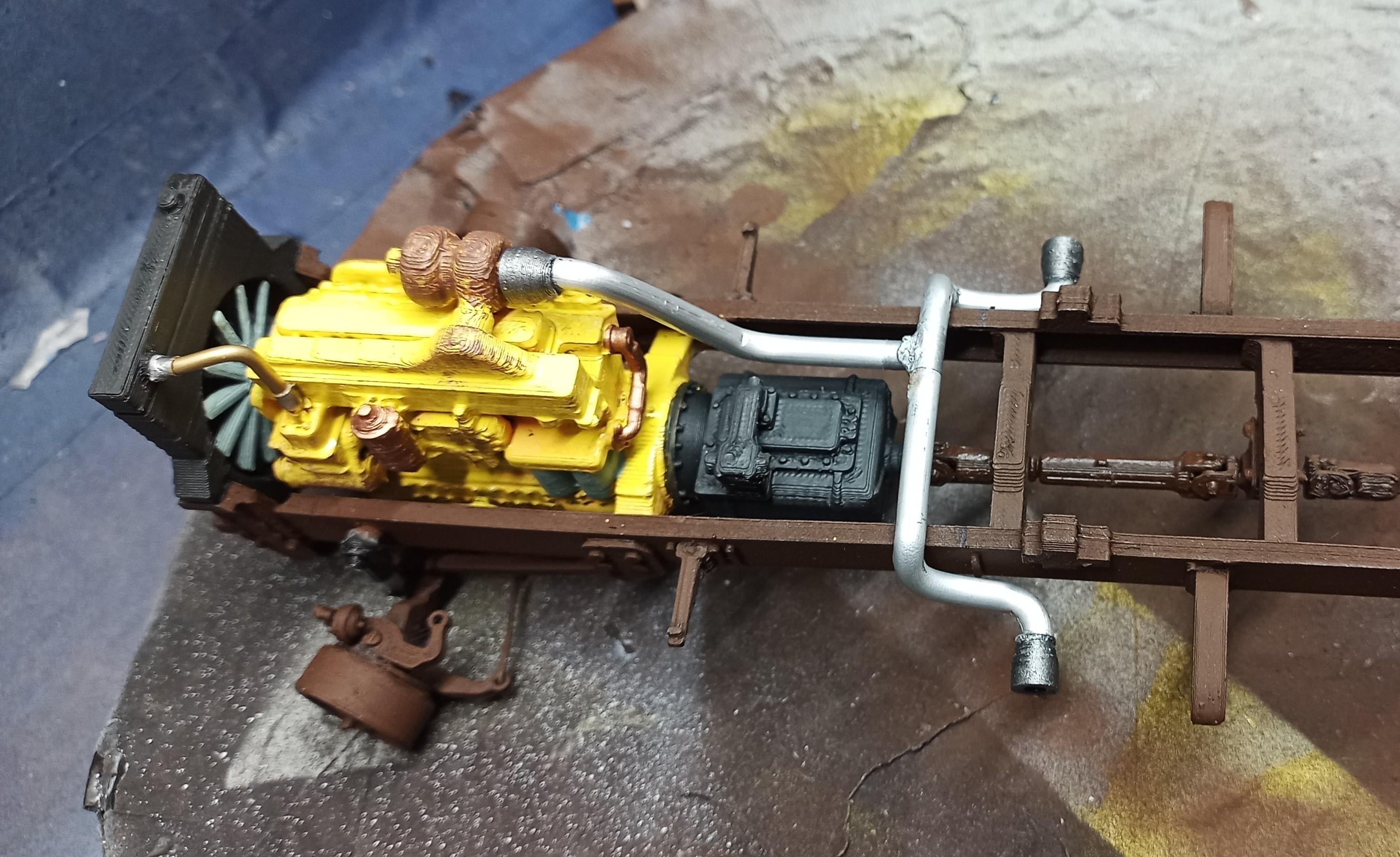

Since that worked out so well I decided to redo the exhaust tubing cause the printed one looked terrible!
The left one was the printed one and the right one is made of 4mm aluminium rod. I separated the end pieces in the 3D drawing of the left one, printed them in a better position and glued them on!
In place (not glued yet):
I like that much better!

I think it’s quite interesting, Jurgen - have been wanting to do a similar tally myself, but haven’t taken the time to do it.  Also, quite curious how you made such clean, tight, radius bends in your exhaust pipes, without crimping the aluminum.  Good job!
  • Like 1
Thanks Brian!
The bending of the stacks was tough!
I clamped them in the vice, of course with a cloth in between, and began to carefully bend them bit by bit. First really close to the Vice working myself more and more to the outside! If you only bend it by the millimeter you have a fair chance of not crimping it.
That's what I meant by hurting hands! 😉
Now they're polished too and I must say I'm more than pleased!

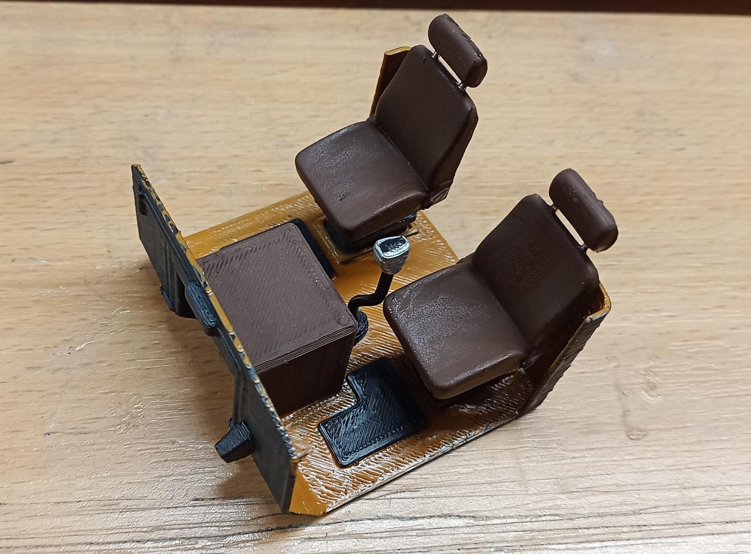

A first glimpse at the interior:
The dash is on it's way here from Canada together with the body parts and rims!

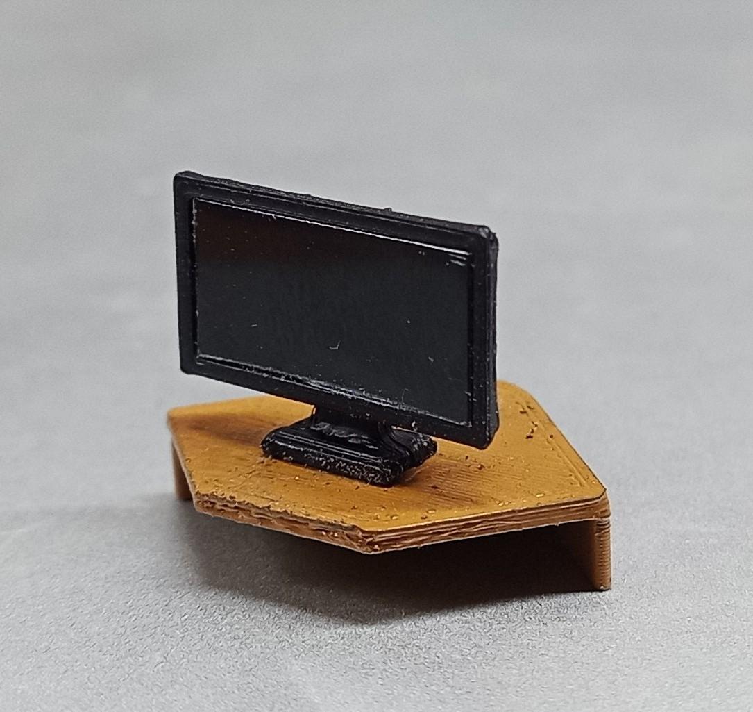

In the meantime I made a TV for the sleeper:
Edited by Jürgen M.
