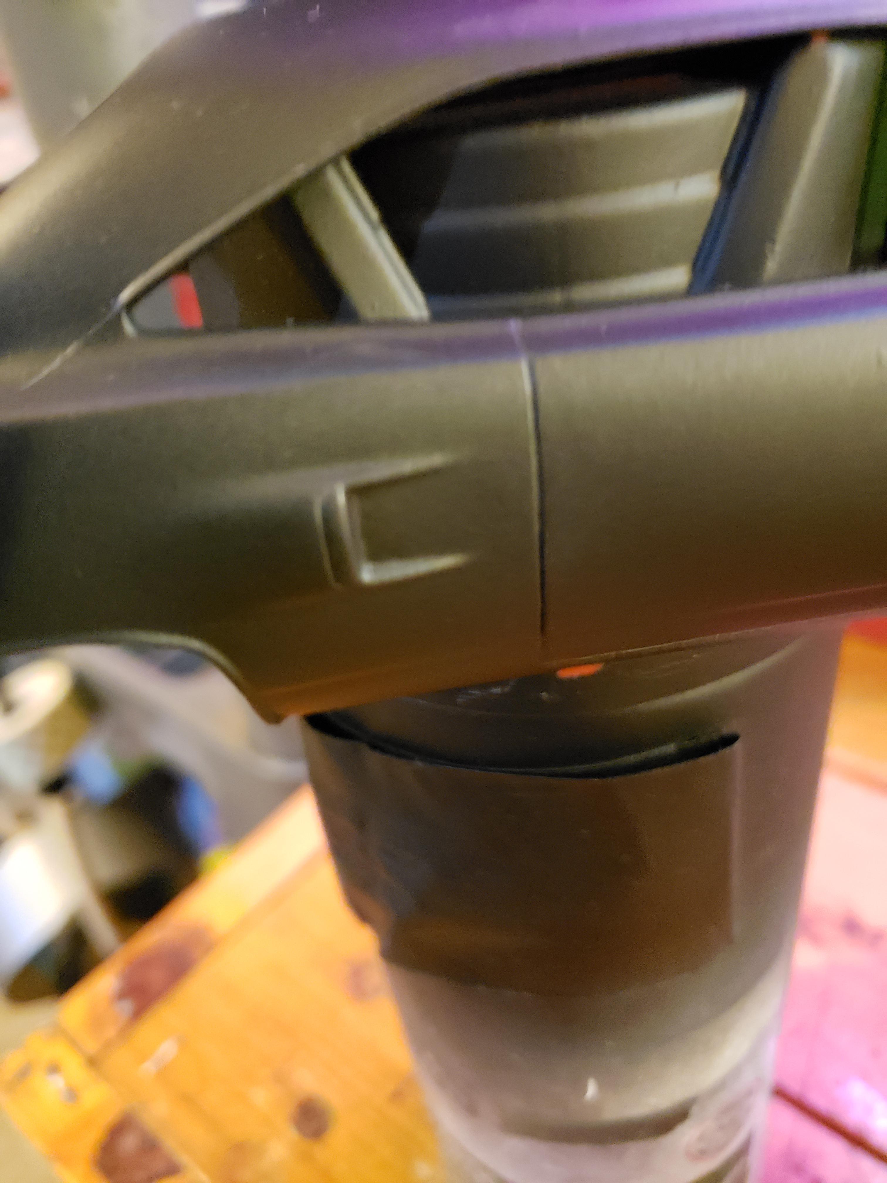

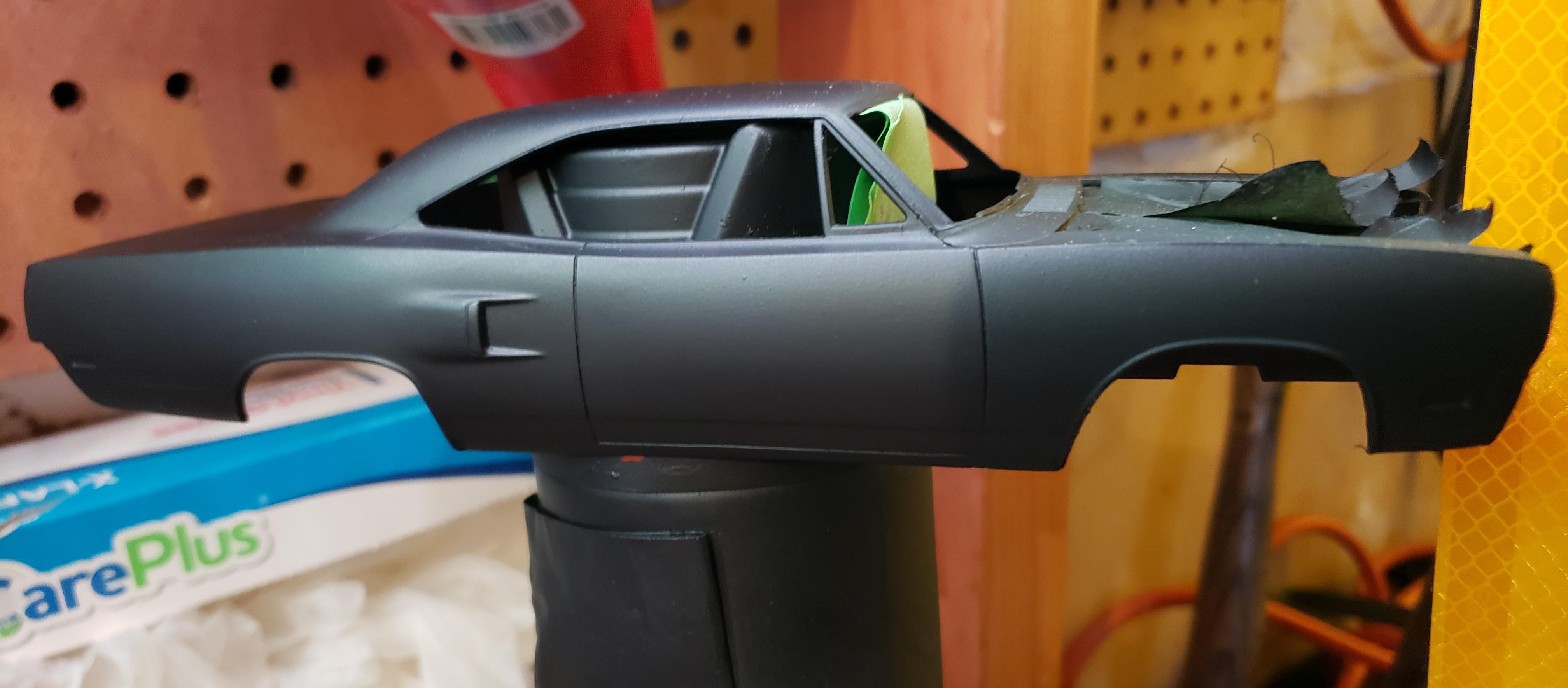

Many mistakes have been made along the way. I was originally going with a bronze spray paint for the body, but it never really dried, so I found this amazing flat black by Colorshot "blackout", it's soooo smooth. After I hit it with a gray primer, the flat black is the main body color.
I also shaved off the door handles. I've been scribing (inscribing? 🤔) door edges and vents and seams with a metal dental pick.

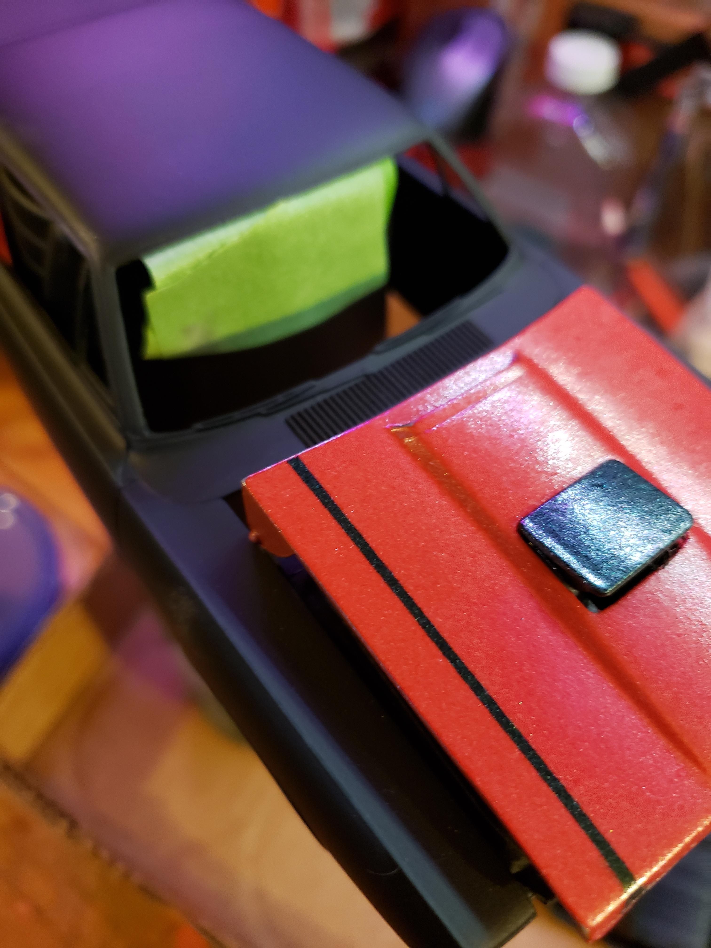

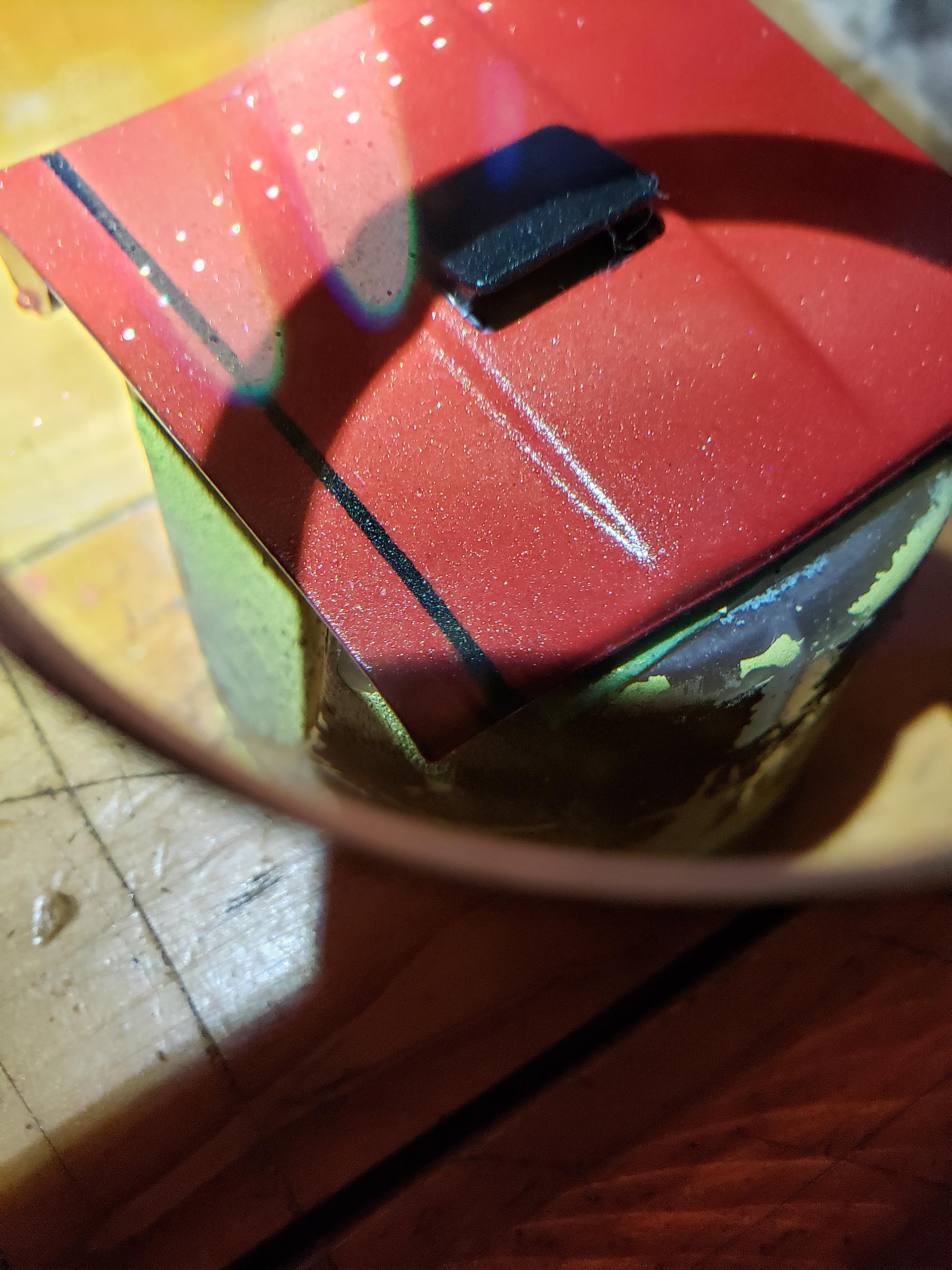

I wanted the hood to contrast the body, so I made it a gloss, I started with a flat red, then kept hitting it with a clear gloss iridescent flake by Colorshot called "pixie dust", sanded, paint, sand, paint, sand, paint, ad infinitum. The stripe is painted not a decal.

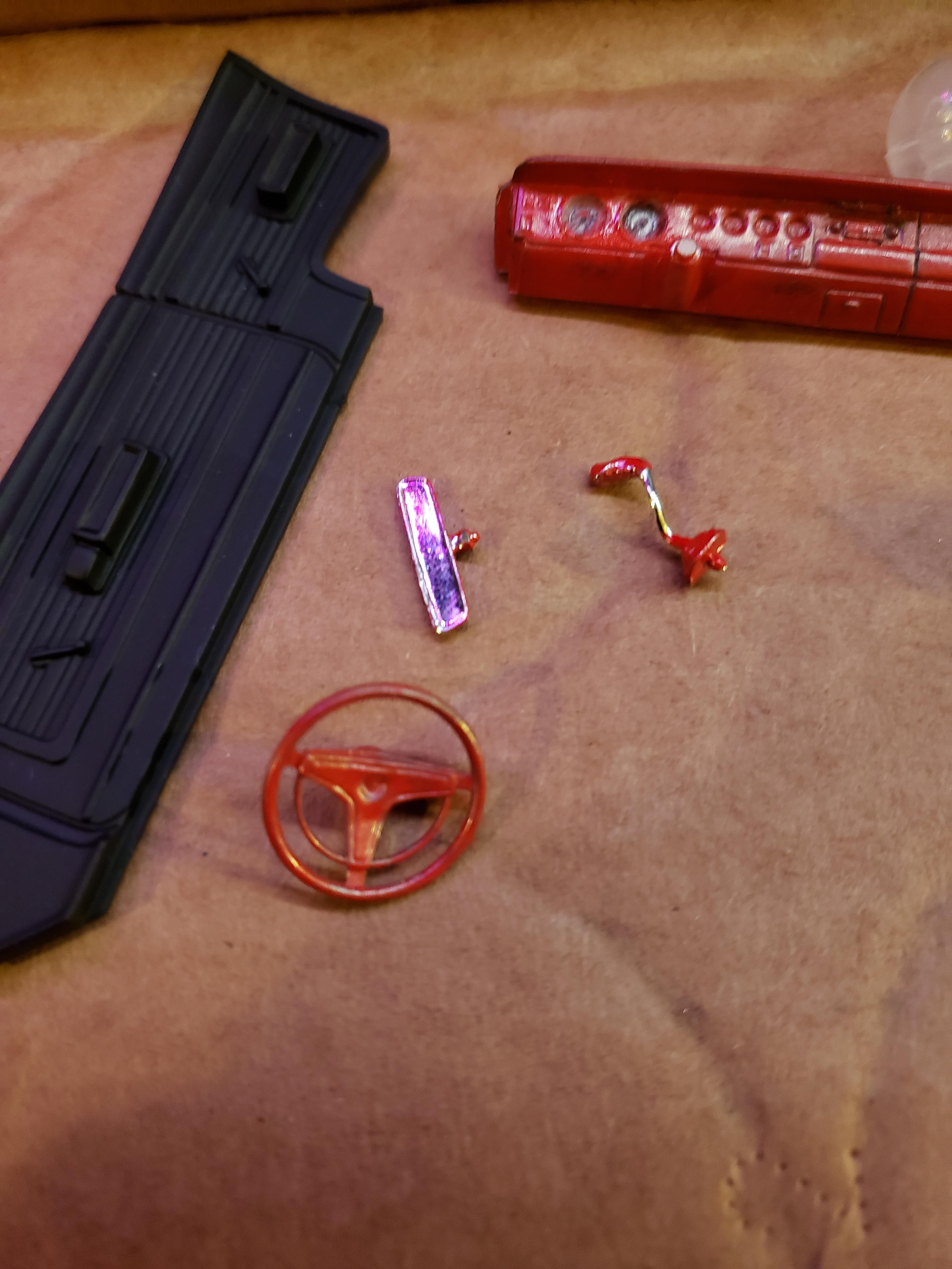

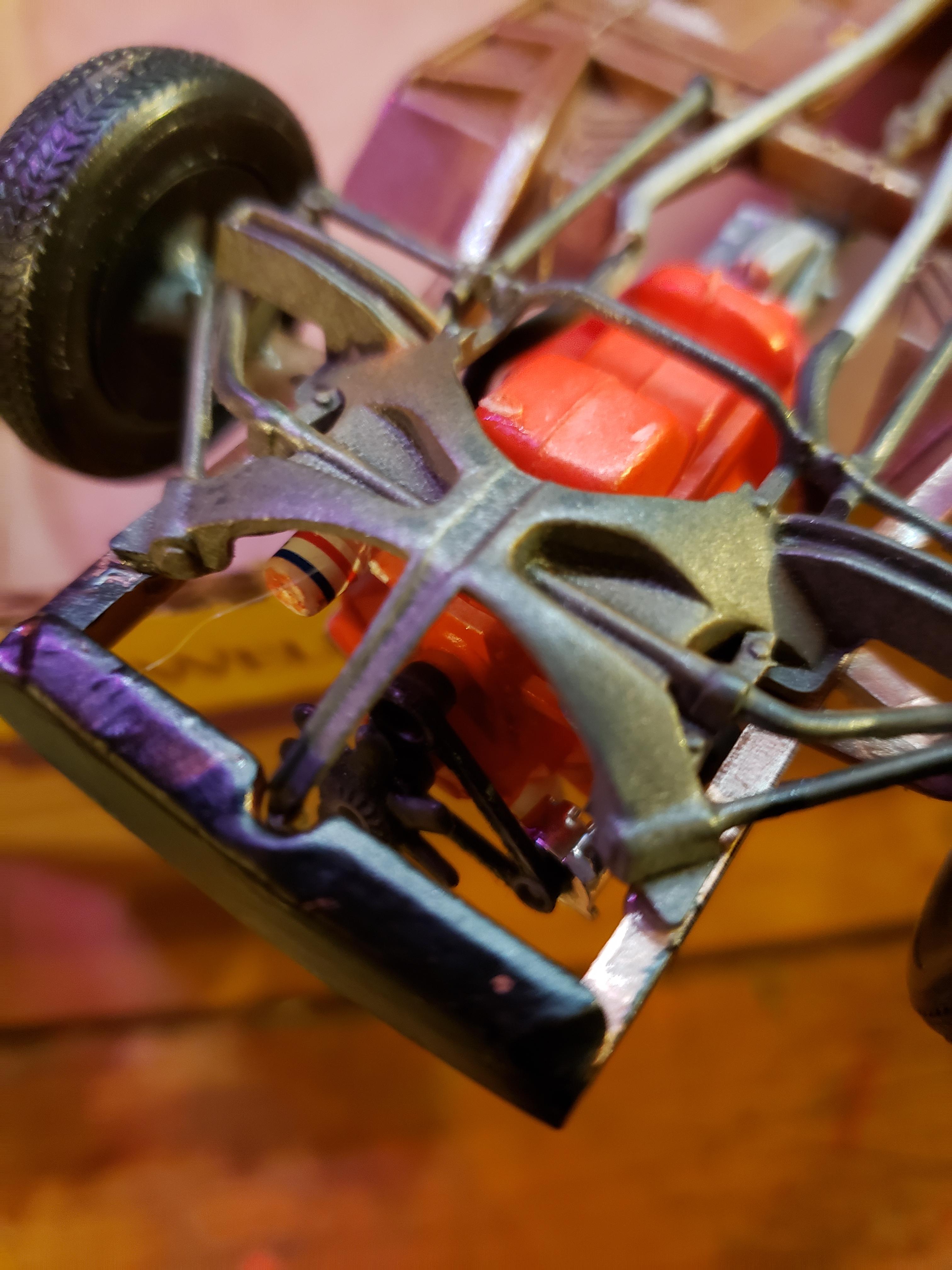

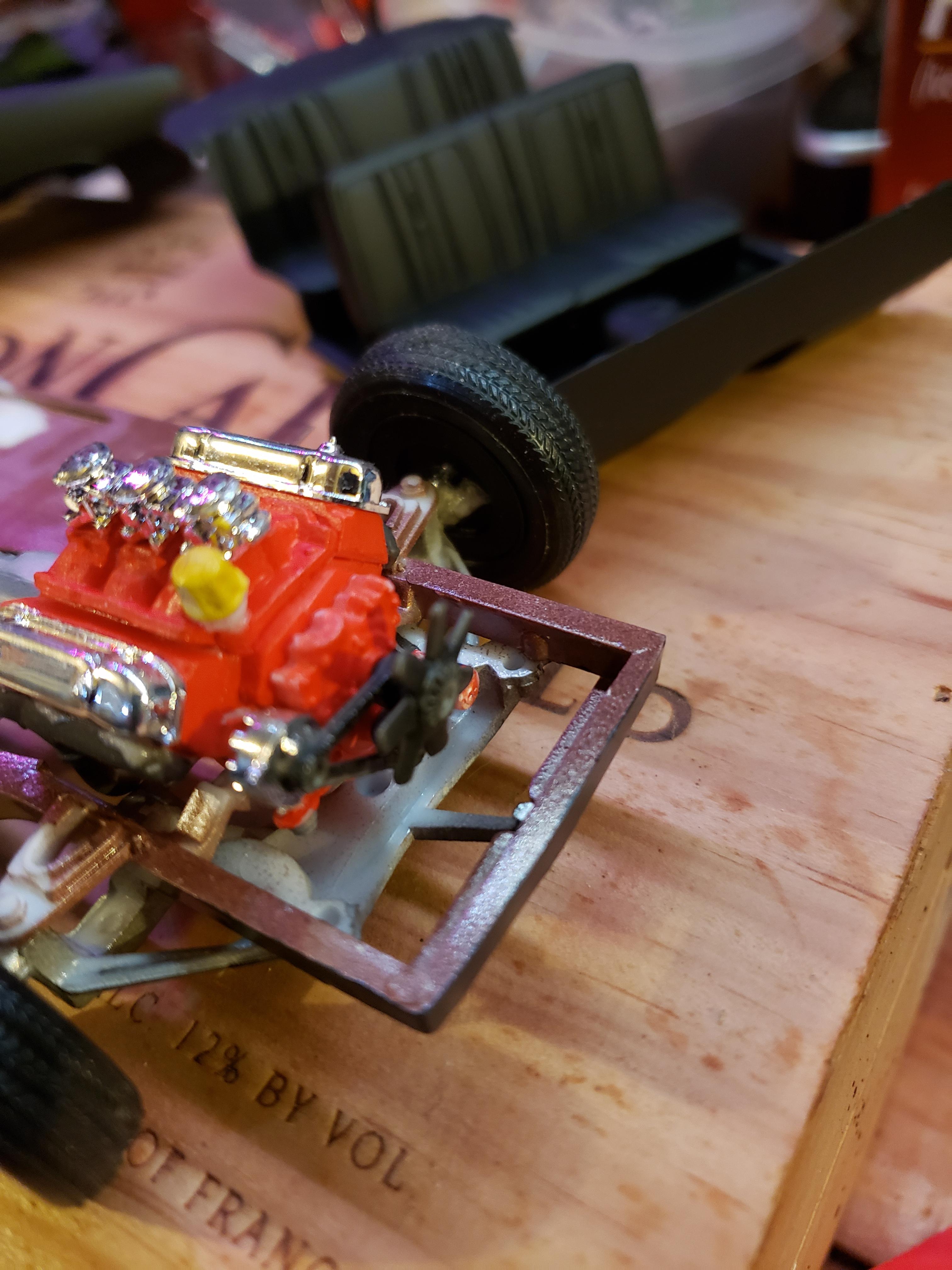

Went with Montana Gold (low pressure line, not color) flat "red orange" for the engine. Anywhere the instructions said "flat silk black" or whatever, I went with several coats of Plutonium translucent "Detroit Sky black" to give it depth. Fun fact, Plutonium spray paints have air freshener in their propellant! *inhales deeply* mmmmm

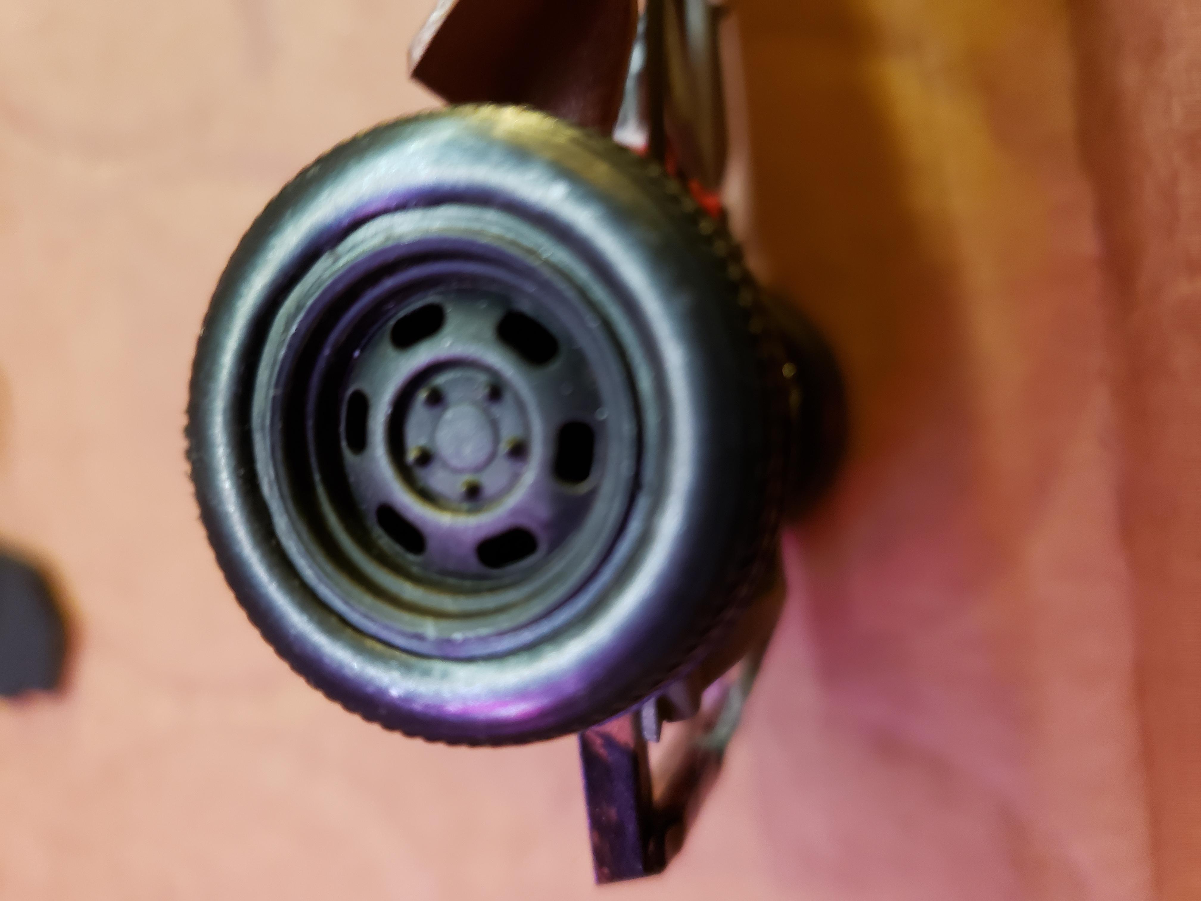

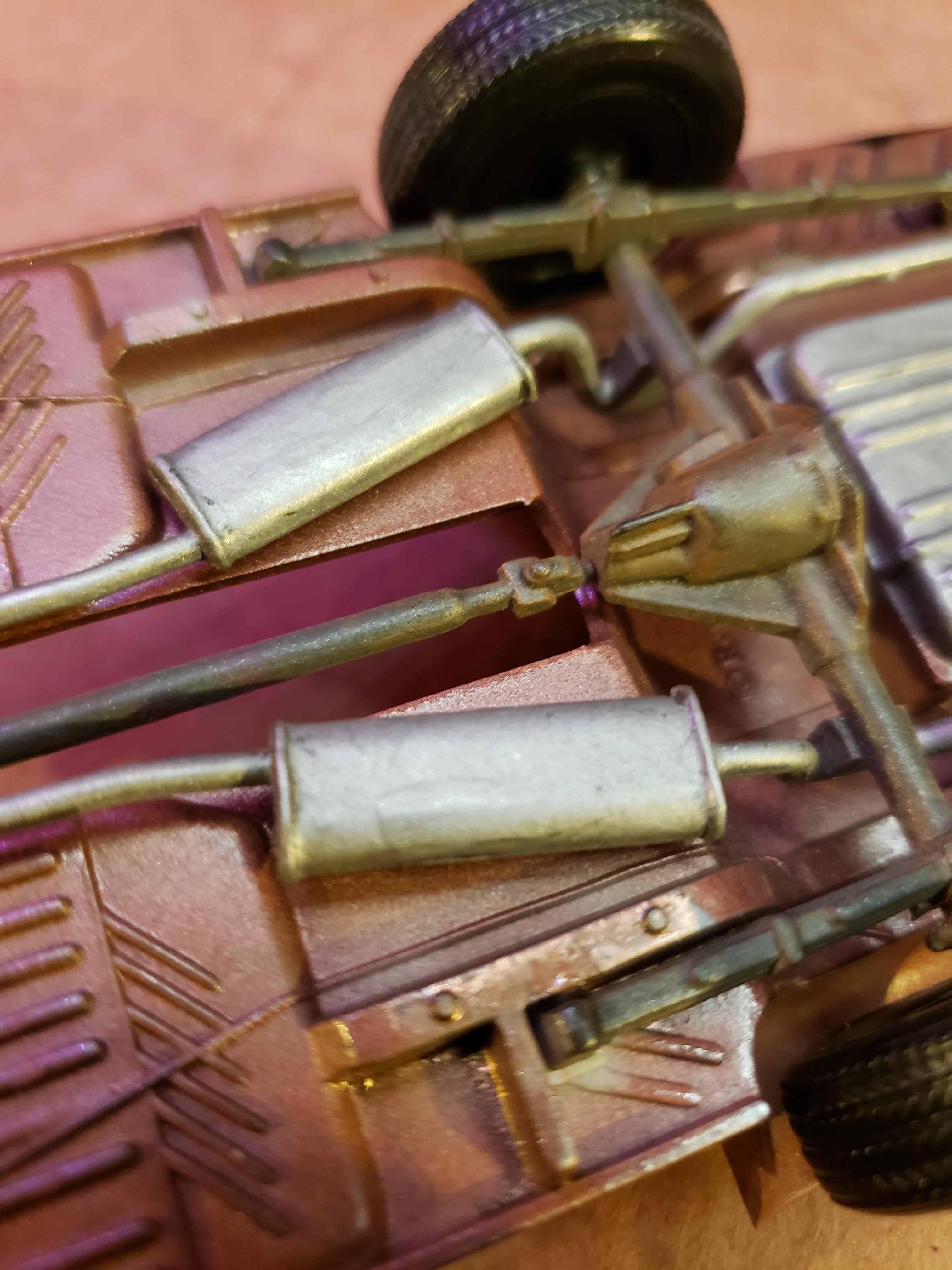

I'm using Tamiya Weathering Master C (orange rust, gun metal, silver) to weather the wheels and the undercarriage (I haven't weathered the engine yet, so don't judge ;) ).

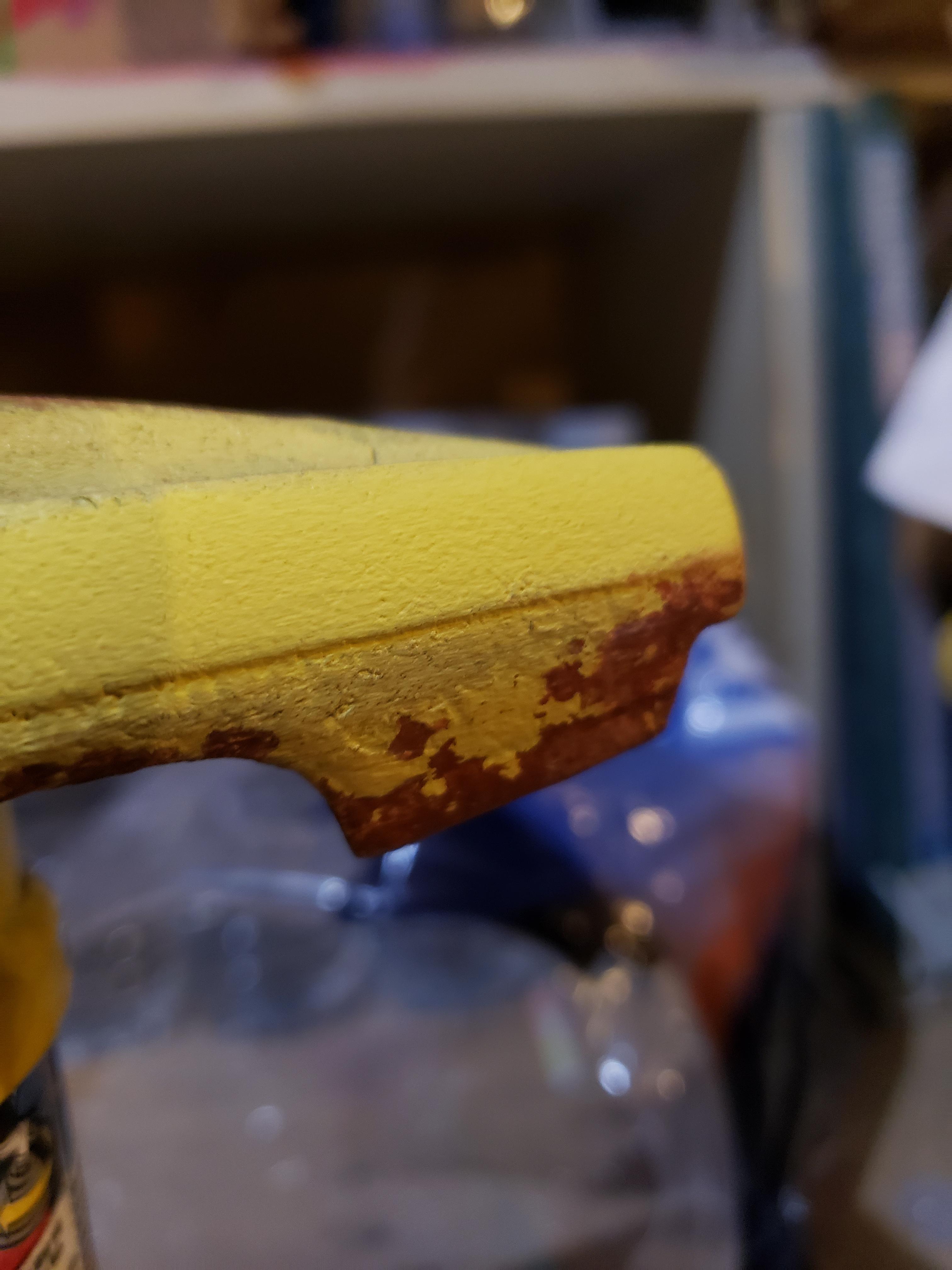

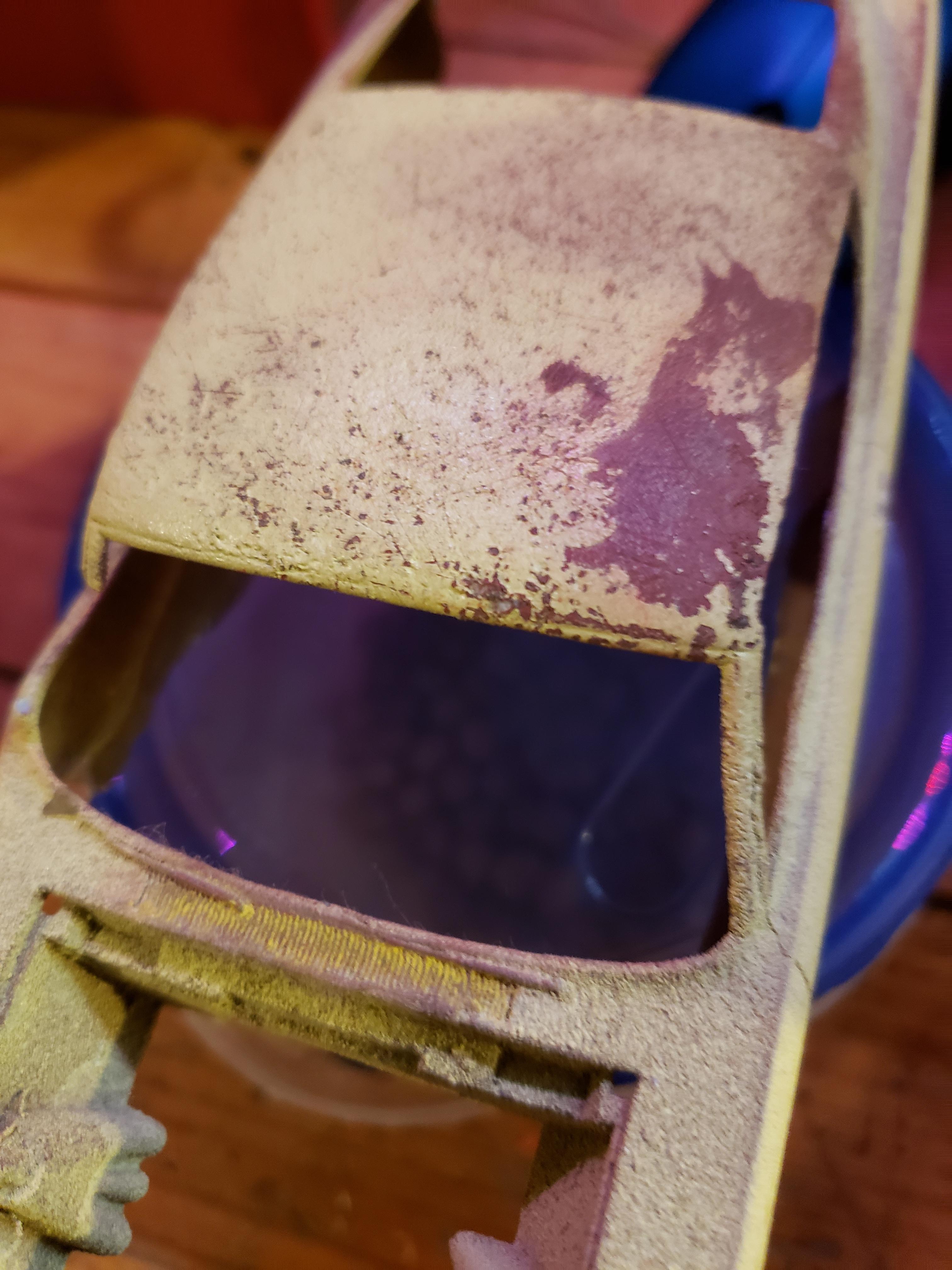

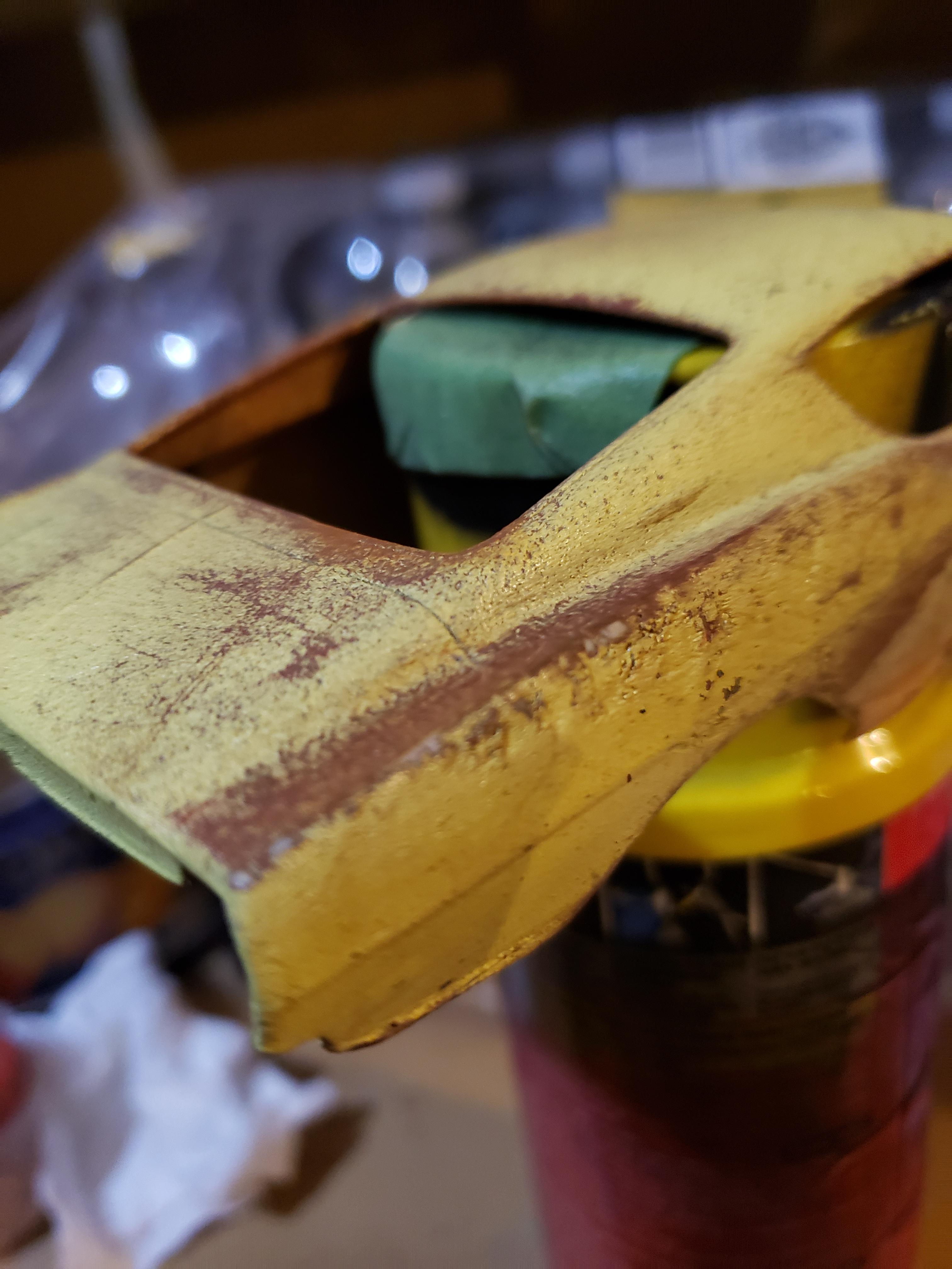

Now the ford has about eight thousand different rust and patina effects on it. Ironically, not the Tamiya weathering lol. I honestly forgot some of the things that I've done to it. In the shots pictured the rust is a Dang (spray paint brand) purple named "bruise" mixed with a Dang brown called "fossil". I hit it with some masking fluid, then Montana "butta" (yellow), then rubbed the masking fluid off and sanded it.
Ive done this plenty of times then redid it, because I was unsatisfied. This adds to the uneven surface which lends itself to a rusting under the paint look.

Here are a few more shots. Two closeups of the hood to try to better illustrate the aforementioned ׁׅ֒℘ɑׁׅ֮ꭈׁׅƙׁׅ֑ᥣׁׅ֪e꯱ׁׅ֒! It's still not really showing, despite the magnifying glass shot and the sunlit one. Perhaps one has to see it in motion to see it. Whatever.

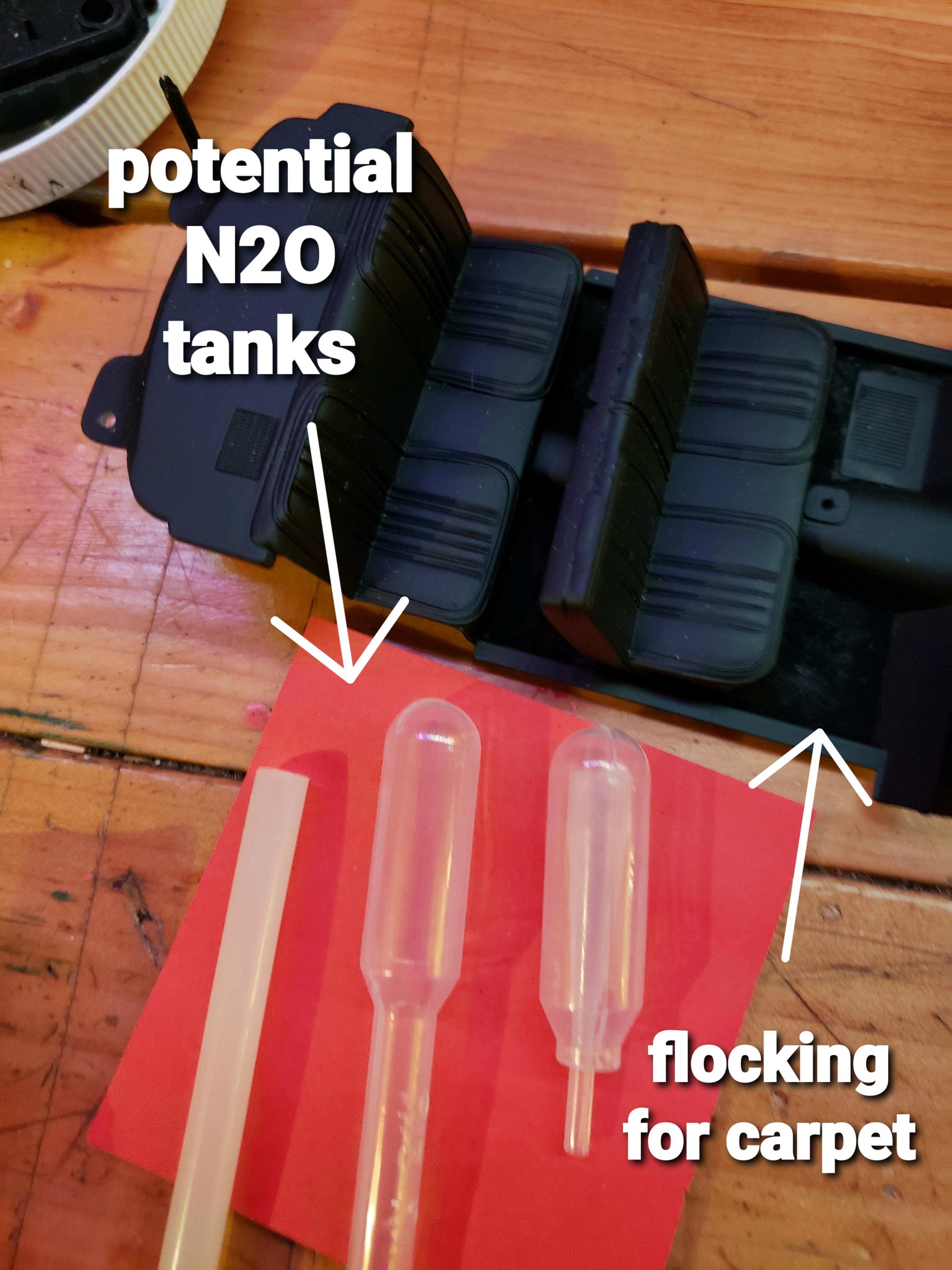

Speaking of not being able to see, try and see the flocking I did for the carpet. In the same shot, I'm playing with different objects to represent an N2O tank. Thinking of mounting it in the backseat or back window. Not pictured are the sprues that would make perfect little nitrous solenoids to mount on the firewall.
I took another pic of the body to show it better. The former picture that I posted didn't do it justice IMHO. Thanks for reading *salutes*
