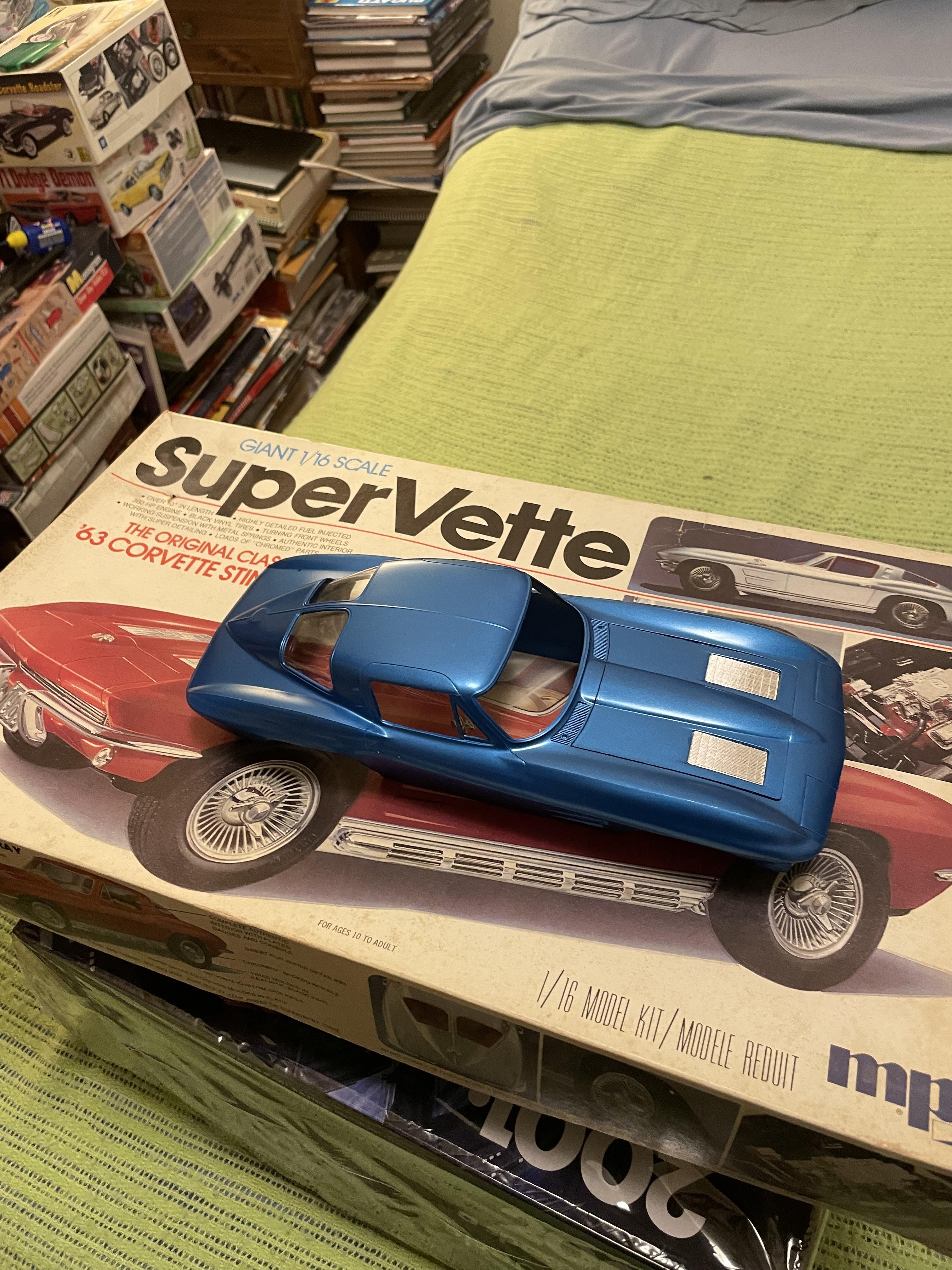

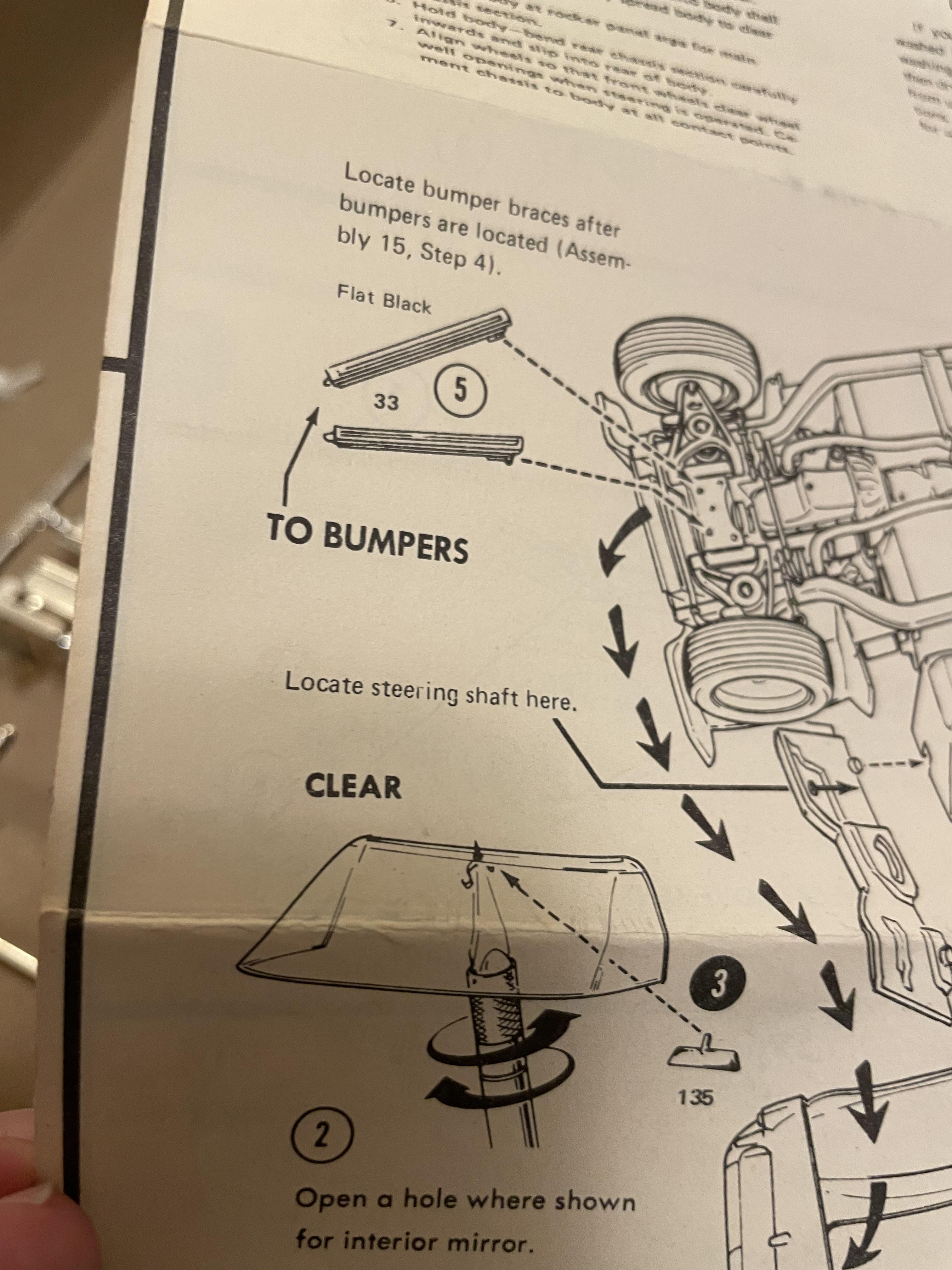

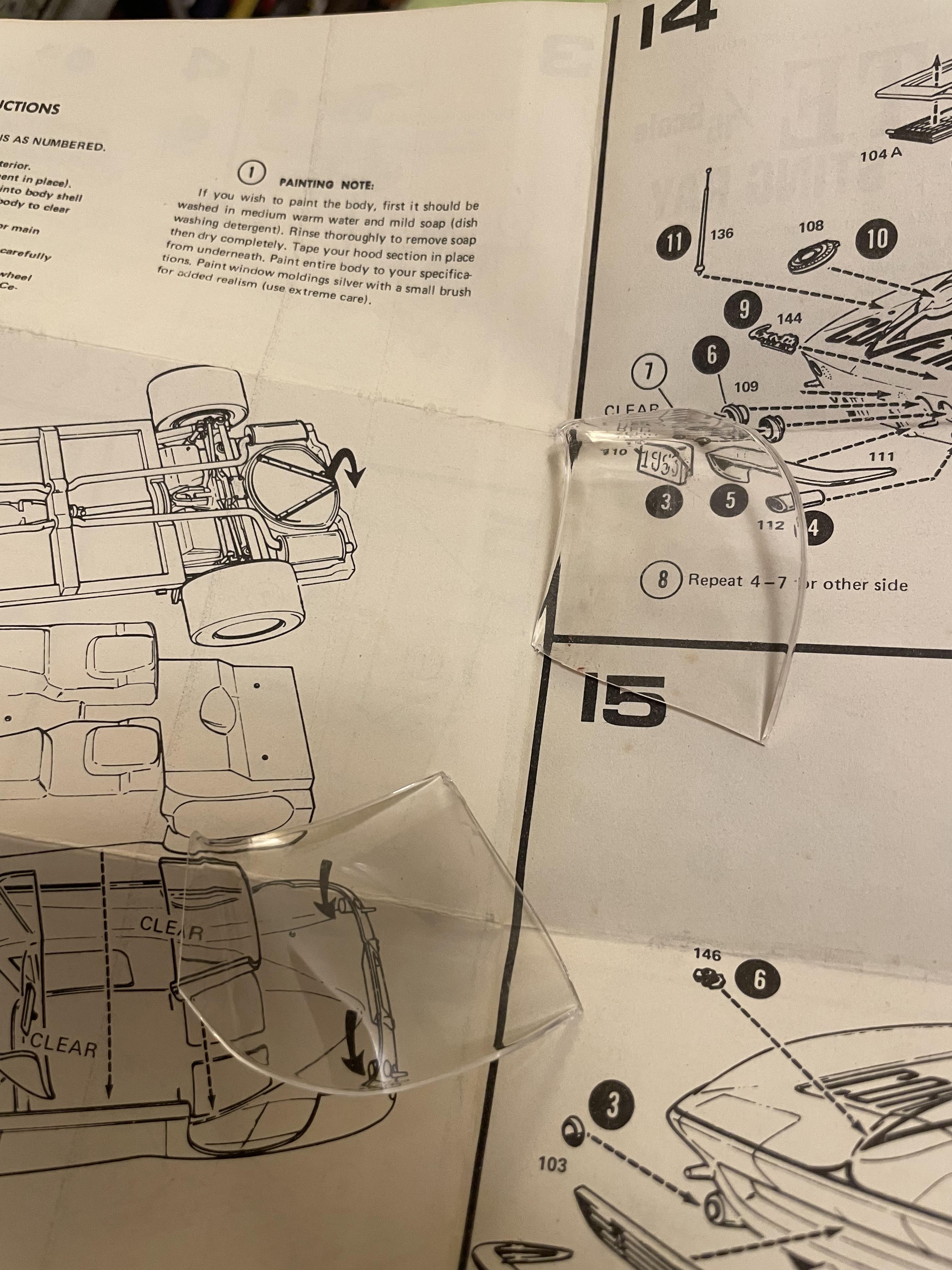

unclescott58 Posted September 14 Posted September 14 So far everything on my 1/16 scale 1963 Corvette Sting Ray build has been going really good. I have a beautiful Tamiya light metallic blue paint job on the kit, that looks great. It’s time to install the glass. The instructions say to drill a hole, with an Exacto knife, in the front glass to make a hole for mounting the inside rearview mirror. This is where I ran into a problem. As I’m working on the hole, the windshield ends up splitting in half. Now I need a replacement. Is there anybody out there who can help me? It would be greatly appreciated.

ybsluos Posted September 29 Posted September 29 Last thing. When you were boring the hole with the blade I bet it caught in the plastic windshield and cracked it with the torque that this method can induce. I hope I don’t come across as a know-it-all because I certainly am not, However I too have cracked some pieces with the X Acto drilling so here’s the way I solved it… very small drillbit ideally in a handheld pin vice. Just a suggestion. I guarantee you aren’t the first to break the windscreen using MPC’s method and again, I have cracked some pieces mentioned pieces doing this!
