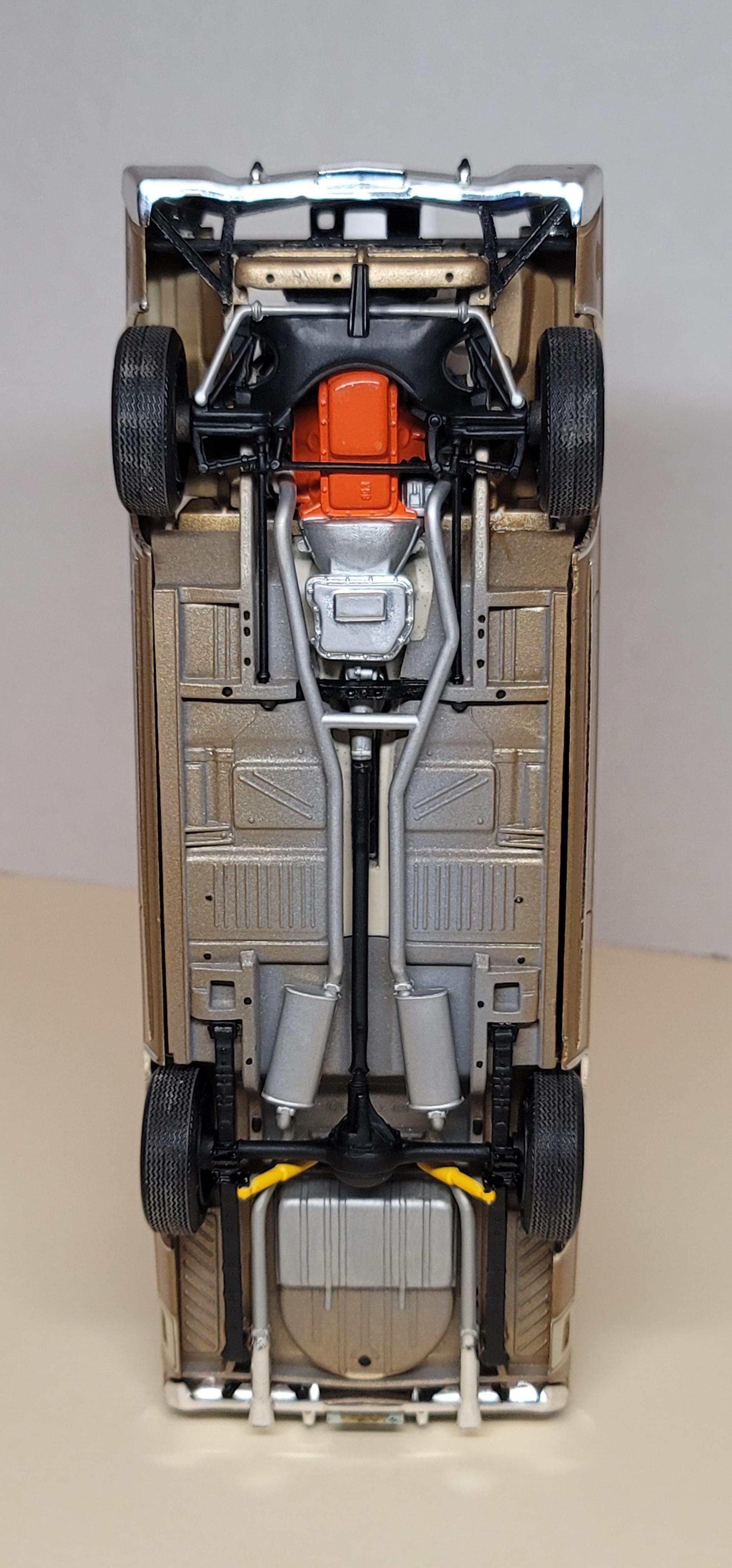

Keef Posted 5 hours ago Posted 5 hours ago As Chris said, medium gray primer with body colored overspray on the sides. I have seen some Mopars of that era that had undercoating in the front and rear fender wells as well as the driveshaft tunnel. Heres a picture I found on google of another members build from several years ago. 1
STU111 Posted 4 hours ago Author Posted 4 hours ago Thanks guys, I understand that underbody finish can be quite variable depending upon the day, assembly line worker etc, but this gives me something to work from. Much appreciated. 👍🏻
