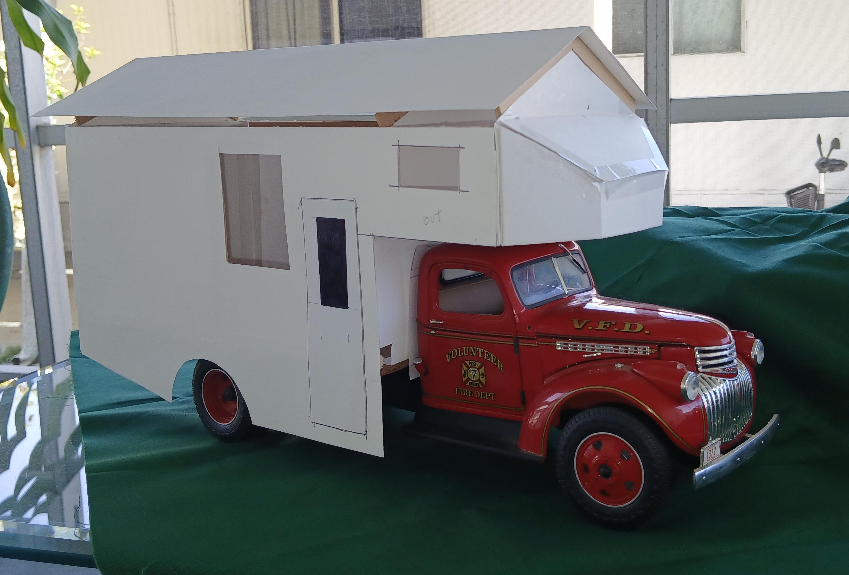

Big Messer Posted September 25 Author Posted September 25 (edited) 1 hour ago, Glassparman said: That is some awesome planning! I would have just started building and torn it apart 14 times until I get it right. I have a lot to learn from modelers like you Trying to design it like a full-size one. Currently making a light cardboard mockup to see how things look. Made it 1 ft lower, 12' currently. Edited September 25 by Big Messer 1

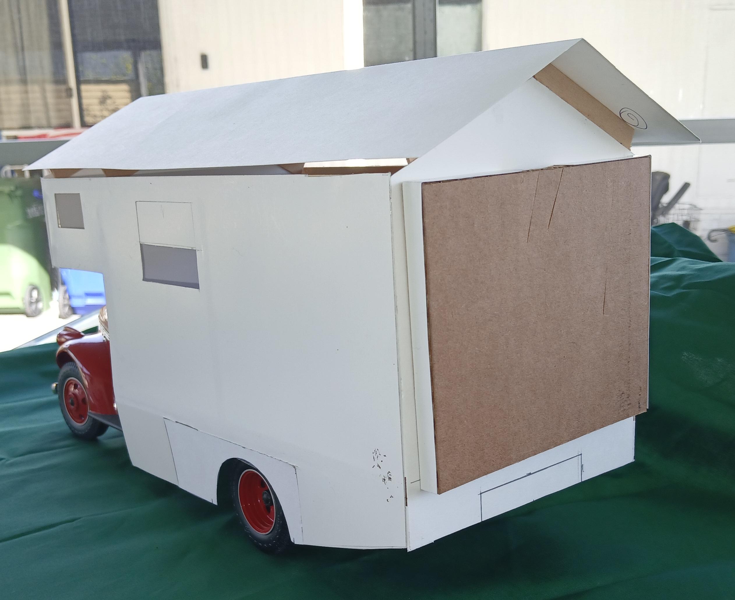

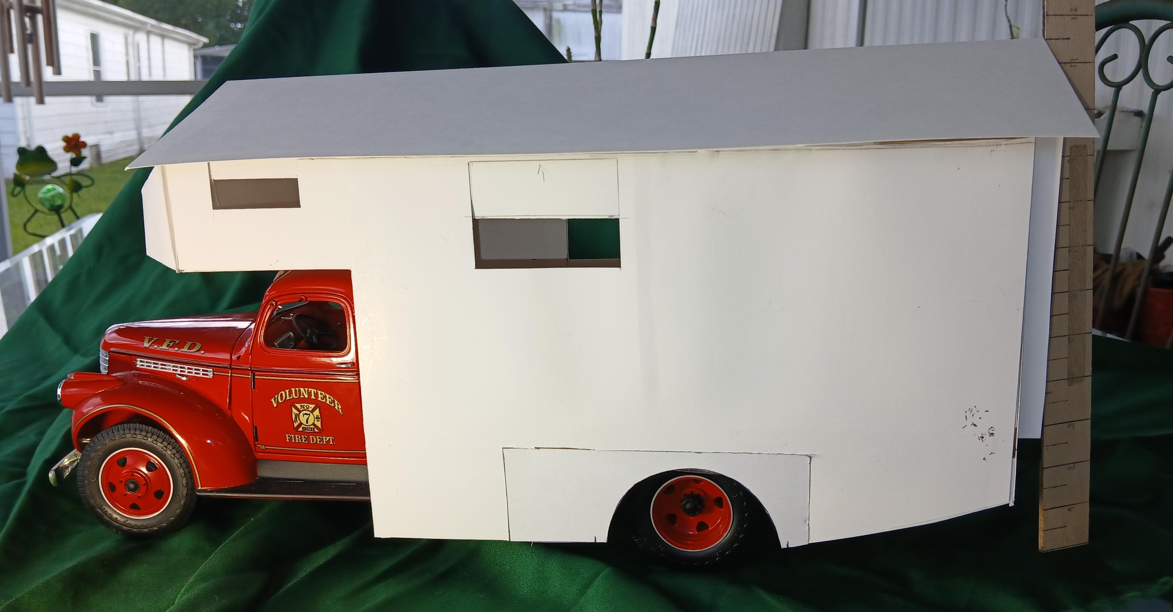

Big Messer Posted September 29 Author Posted September 29 Just finished a study model of it. Just cardboard to figure in 3D how things are going. Checking against the drawings will show several changes I did so far. Original total height was 13'. then cut it down to 12', then raised again to 12' 6". The only constant is change... 4
espo Posted September 29 Posted September 29 Good looking camper proportions. Wouldn't the roof design effect wind resistance at hiway speeds and low bridge clearance? like the fold down rear deck design.
Big Messer Posted September 29 Author Posted September 29 (edited) 3 hours ago, espo said: Good looking camper proportions. Wouldn't the roof design effect wind resistance at hiway speeds and low bridge clearance? like the fold down rear deck design. It is a vehicle intended to go from here to ?? at a leisure pace. As it is a 1941 truck speeds higher than 50 mph are not going to happen. So it will stay within secondary roads. Bridge clearances are a concern, that's why I may lower the roof height back to 12', but studies are being conducted about going lower. Aerodynamics... leave that for planes. Edited September 29 by Big Messer 1 1

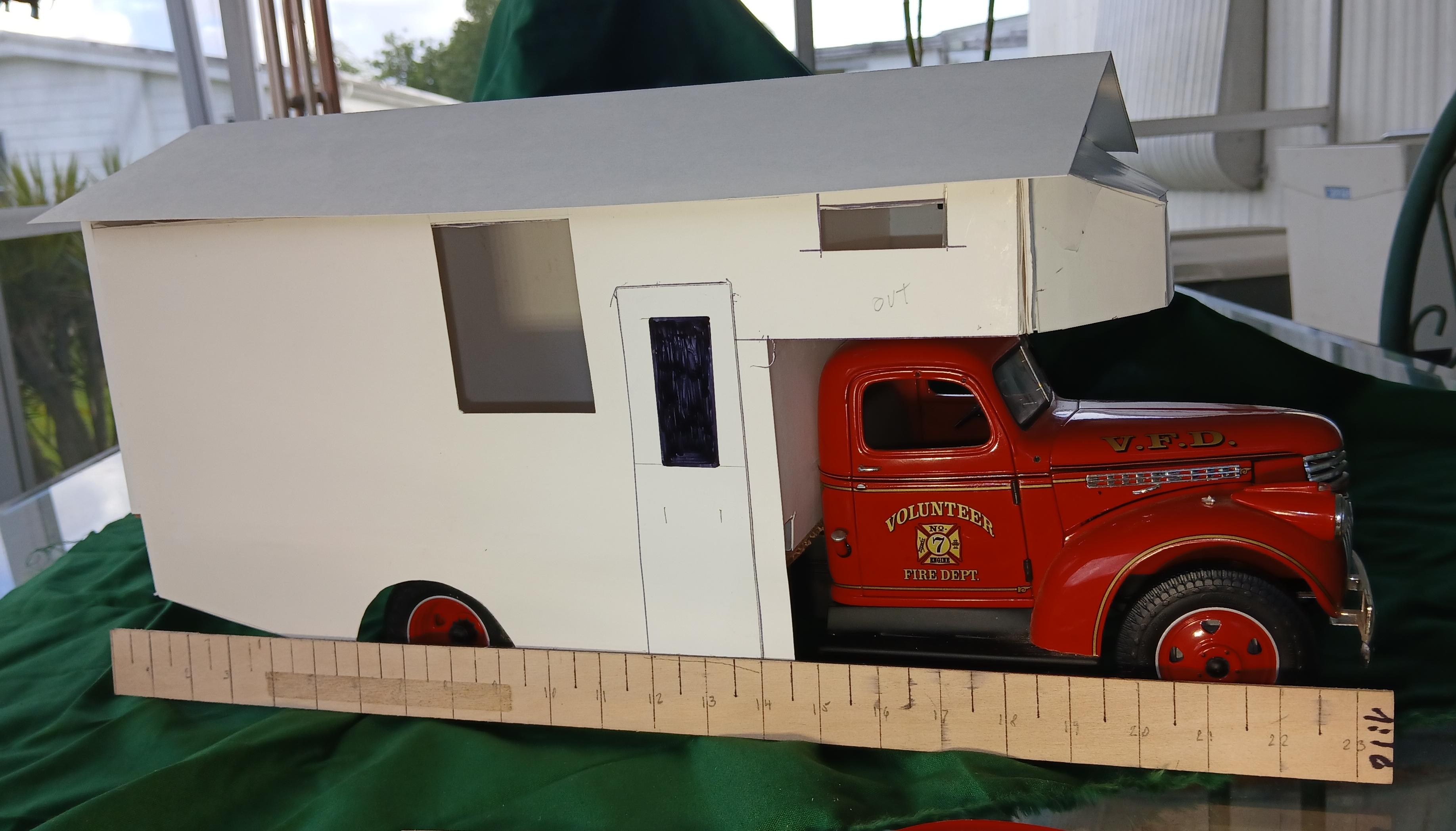

Big Messer Posted October 5 Author Posted October 5 Probably the final design phase. Roof lowered to 11' 6" by making it 6" lower at the center ridge, so interior from floor to center of ceiling about 8'. Front protrusion made shorter also. Next week a decision will be made about materials and hopefully start actual construction. 1/16 scratchbuilt ruler shown (ran out of bananas). 2

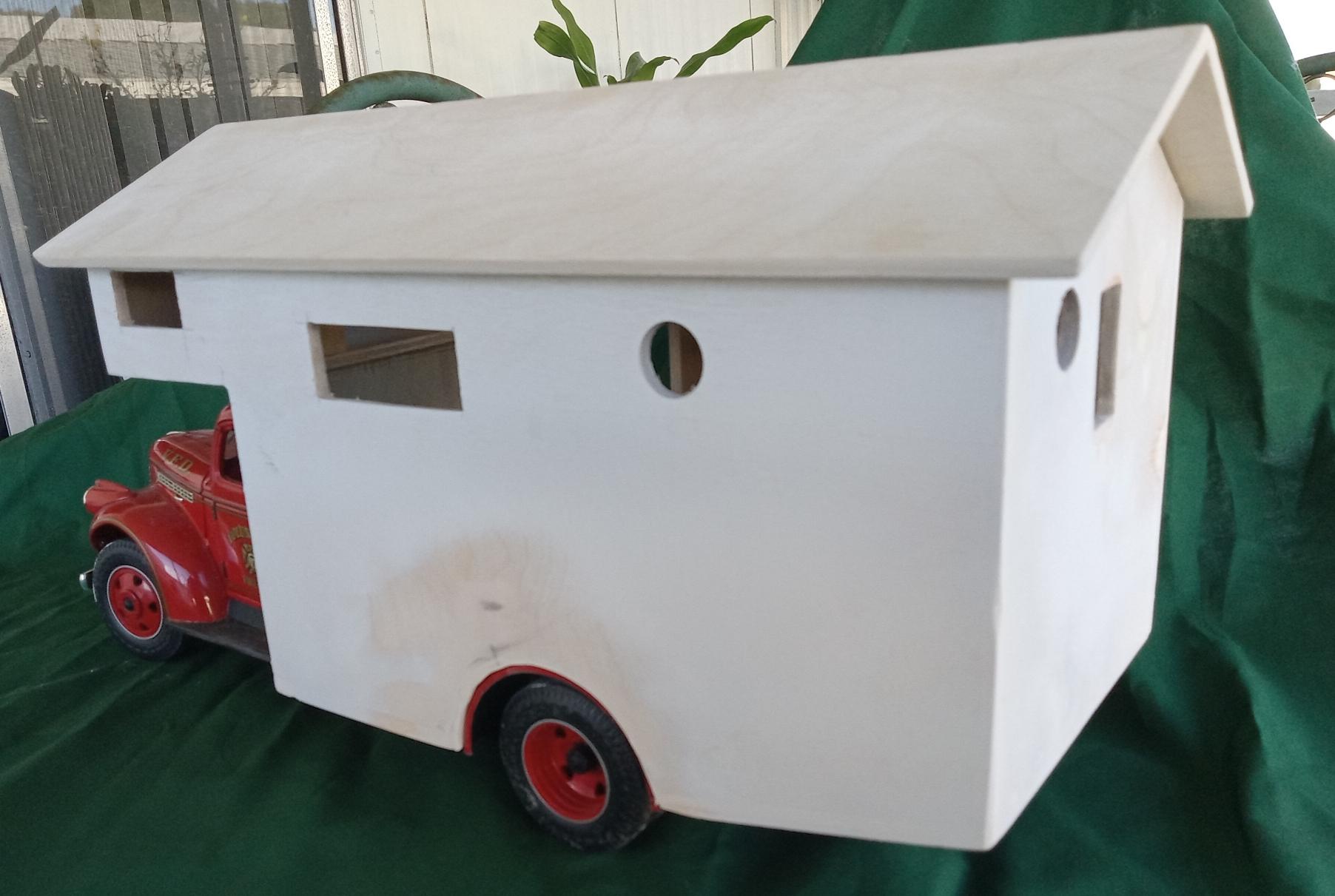

Big Messer Posted November 1 Author Posted November 1 FINALLY some progress!. Built the body out of 1/4 plywood. Windows not finished because I haven't made a final decision between house-type (square corners) or RVs (rounded ones). Also agonizing over fiberglass outside finish (smooth) or something else. See why things take like forever?.
Big Messer Posted November 1 Author Posted November 1 Thew a coat of white. Think I don't like flat and white, but change is the only constant here. 2
Big Messer Posted November 5 Author Posted November 5 Lesson learned the hard way: plywood intended for modeling is no good. Keeps delaminating... I am wasting more time fixing it that going forward. Probably will cover the whole thing with styrene sheet. OTOH windows will have square corners. Will fit better with the old style truck.

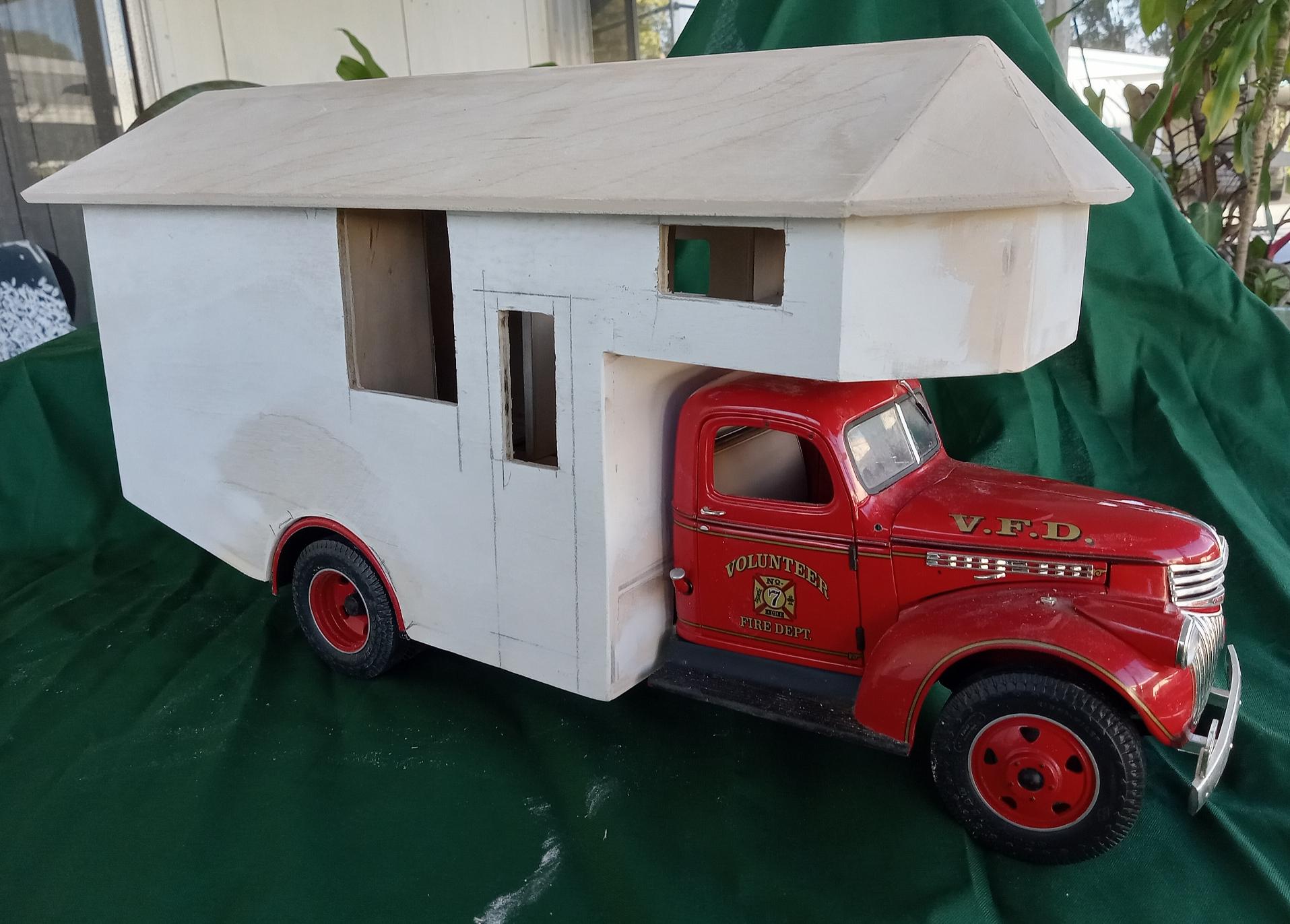

Big Messer Posted November 16 Author Posted November 16 (edited) Some work done. Front arrived to it's final (and 4th) shape. Roof done, needs final cover. Want to do metal because I like the sound of rain on it. Work done on rear fenders, but not final yet. Windows openings almost done. The big one on pass side will be a little lower on the top edge. Next start the interior cabinets. Edited November 16 by Big Messer
