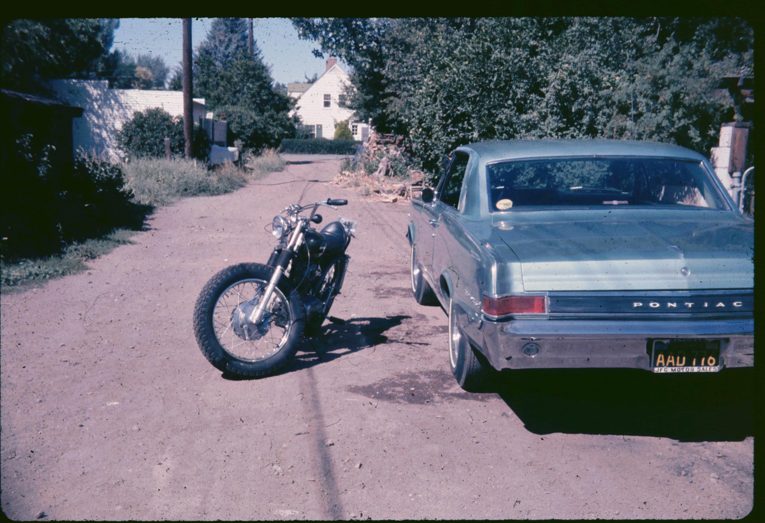

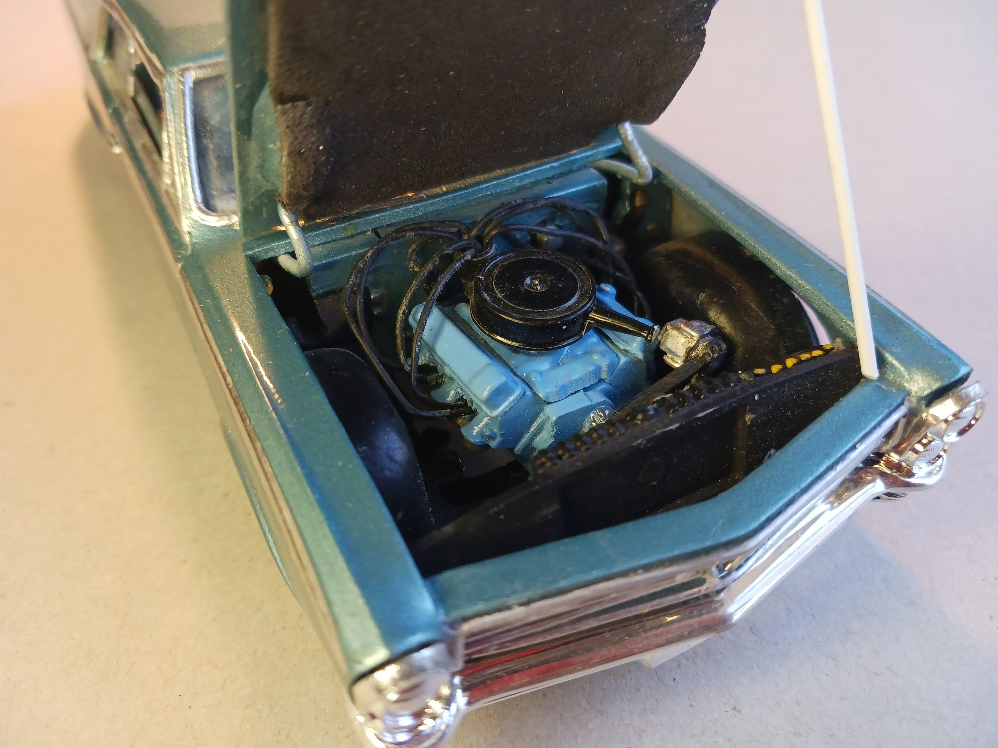

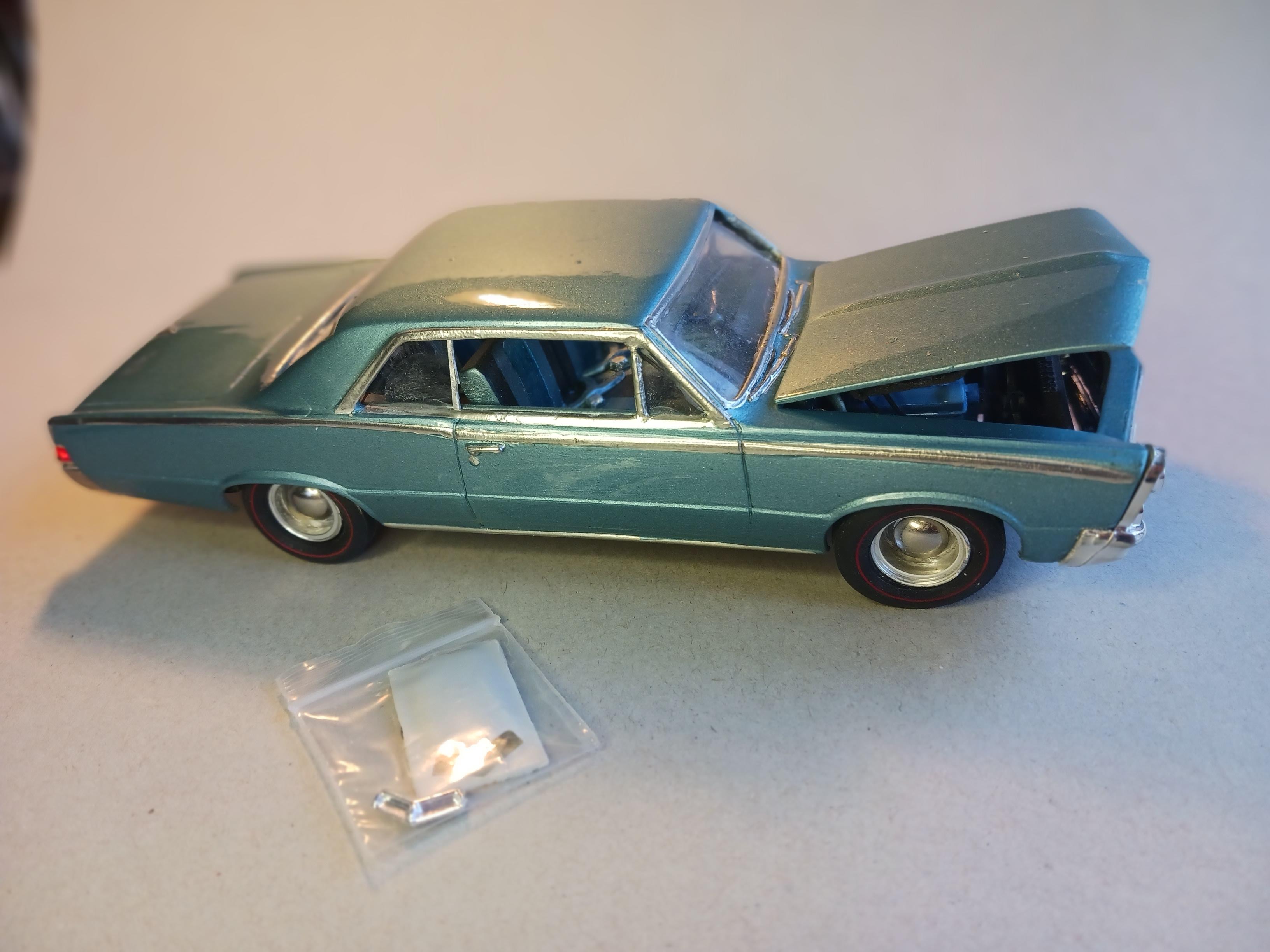

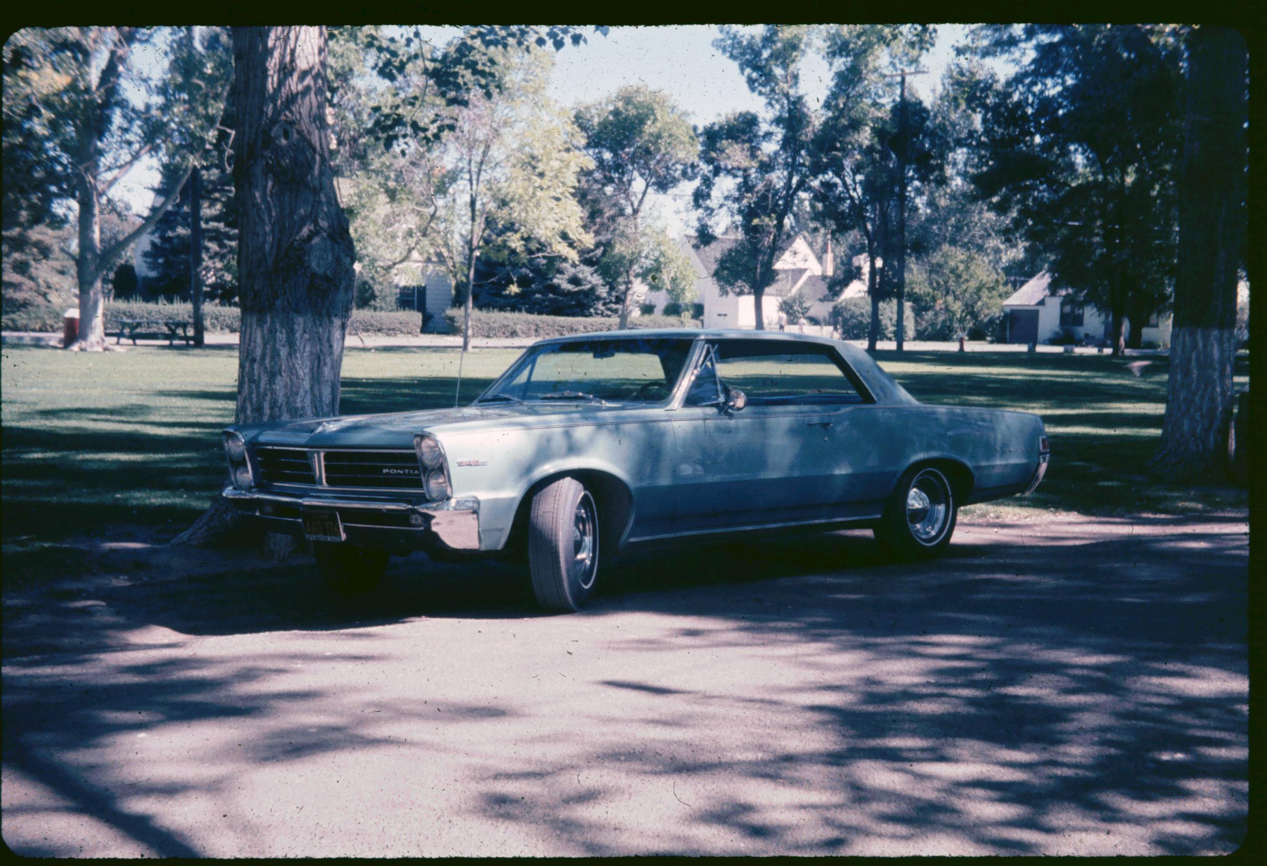

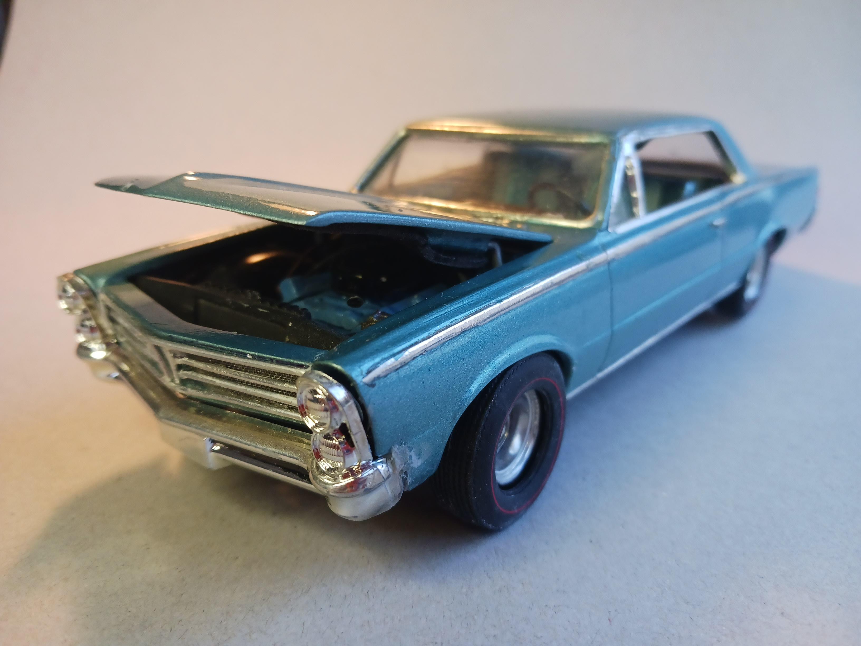

Wickersham Humble Posted October 5 Posted October 5 (edited) First, kudos to contributor Trent Christian for the neat conversion idea, and the very spiffy build; congrats! I did the GTO to Tempest conversion about 5-6 years ago to depict a favorite ride I had about 1967, before the Draft caught me in mid crazy youth, a '65 Tempest Custom 2-dr hardtop (326 base motor and 3-speed stick -- of course!) which I loved.* I'm always shocked at how mediocre my builds look in photos; guess that's reality, vs. my octogenarian eyes, huh? That year had a separate base model that didn't share the Lemans/GTO grille configuration; it looked (meant to, oc) cheaper -- but was still nice enough. My conversion wasn't hard under the hood; just build-down the Goat powerplant, and go with a single exhaust, etc. The 1965-65 basic models had a distinctive chrome (aluminum, actually) molding strip that ran over the fenders and door where the LeMans/GTO had a pinstripe, etc. and hard to get 'thin' enough! I just scribed a rectangle around the hood scoop, and filled the gap. Ironically, I lost it, had to make a replacement from scratch; found the original -- and then gave the repro to a fellow forum member who solicited one! Kismet! I wondered: were the Sprint/Tempest tail lights different from the LeMans that year? All the pics I've seen of Sprints have the base-line fan-shaped lens, etc. Also, I wondered if he mistook the windshield-washer cannister for an overflow reservoir? And is it the brake master-cylinder vacuum booster housing he names 'the brake drum'? I obviously had the same fit issue with the front grille/headlight/bumper assembly in my kit; not exemplary! Included are two shots of the 1/1 Poncho, plus my Ducati Scrambler from 1968 I hope he contributes more innovative builds, and keeps up the good research. The pics show engine compartment and interior detail to die for! Wick *Also done my first car, 1955 Chevy Delray rod in 1961, and 1951 Ford Club Coupe from 1964 -- I was a real throw-back, I guess! Cheap to keep! Edited October 5 by Wickersham Humble forgot detail 1

Wickersham Humble Posted October 21 Author Posted October 21 Hey! I ain't overly proud of my rendition of Tempest from GTO kit -- done some time ago; I do better engines now -- but I wanted to get it knocked out. The 326 is easy to adapt from 389; virtually the same engine (same crankshaft for sure, long stroke/oversquare) and it was a torquer, even with the two-bbl carb. In those golden days it was 'two doors/three pedals, or no deal' for me; this had the old Chevy/Saginaw three-speed with the four-bolt side cover, not the great later all-synchro Saginaw box. Before PMD had the Saggy, it bought three-speeds from Ford, who innovated the feature (as far as I know, and I know quite a bit!) Trivia: the Saginaw box had a Borg-Warner planetary overdrive in the tail-shaft housing as an option, and it could be combined with a Saginaw 4-speed to make essentially an okie five-speed. Trivia X-2: the 1963 Tempest/LeMans iron V-8, the one that replaced my Buick 215 alloy version, was actually a 336-cu.in. mill, but GM edict forced PMD to downsize the bore in '64, for the first A-body intermediates! DeLorean, again. Making a credible grille was the hardest thing on this replica, and it only came off so-so, vs. pics of the 1/1 car. The thin aluminum trim from headlight to taillight was just thin styrene strip, but not really thin enough to reall replicate the original -- still, it serves. I know of no source for '326' fender callouts, nor 'TEMPEST' logo, etc. alas. Oh how I wish I could afford another '65 Tempest coupe, but now all are about the price of a GTO, according to my bro-in-law, who spent years wheeling and dealing GTO's and muscle cars for a living. My first car was a '55 Chevy Delray coupe (hot 265, etc -- even lakes pipes; another replica I'm working on -- in 1961, and both our kids came home from the hospital in a '55 210 sedan, restored by me,.; another ride that has priced itself out of sight. This is my '61 Tempest coupe, pre-LeMans, and former '62 LeMans ragtop (had the 4-bbl. slant four, easily kept up with CA freeway speeds!) which someone else restored. Just put a 4-bbl. on the 215, plus duals so it sounds pretty rasty. Not; has a PowerGlide adapted from the Corvair... My first article for SPECIAL INTEREST AUTOS Mag was on the Tempest history in 1976; could still interview the guys who built and raced it back then!! As mentioned, I'm buying a '67 Sprint OHC six (engine only, cheaply) which may just be a conversation piece in the shop... Ole' Wick
