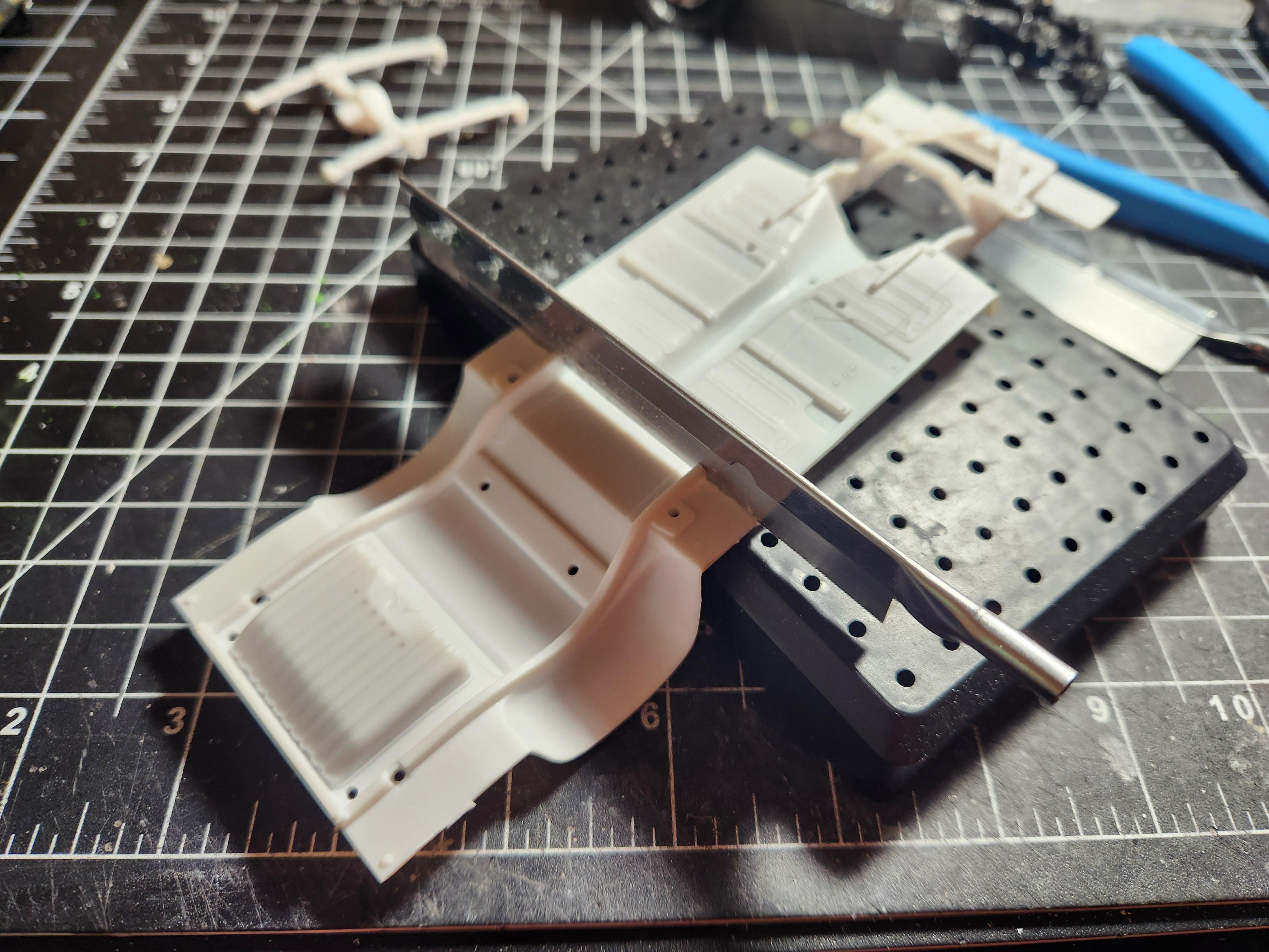

2nd the comparisons between the 62 Dodge versus 63 Dodge is minor, but noticeable and thus require some mods to the chassis to use it in the 62
White kit chassis is uncut in the '63
Painted kit chassis is modified in the '62
The front section I've highlighted in black needs to be removed. On both ends to make it fit / Plus the sides rearward of the rear wheel house needs to be narrowed a touch
BTW, The angled ends where I have pointed with maker DOES not need to be done. I got a little over jealous making cuts

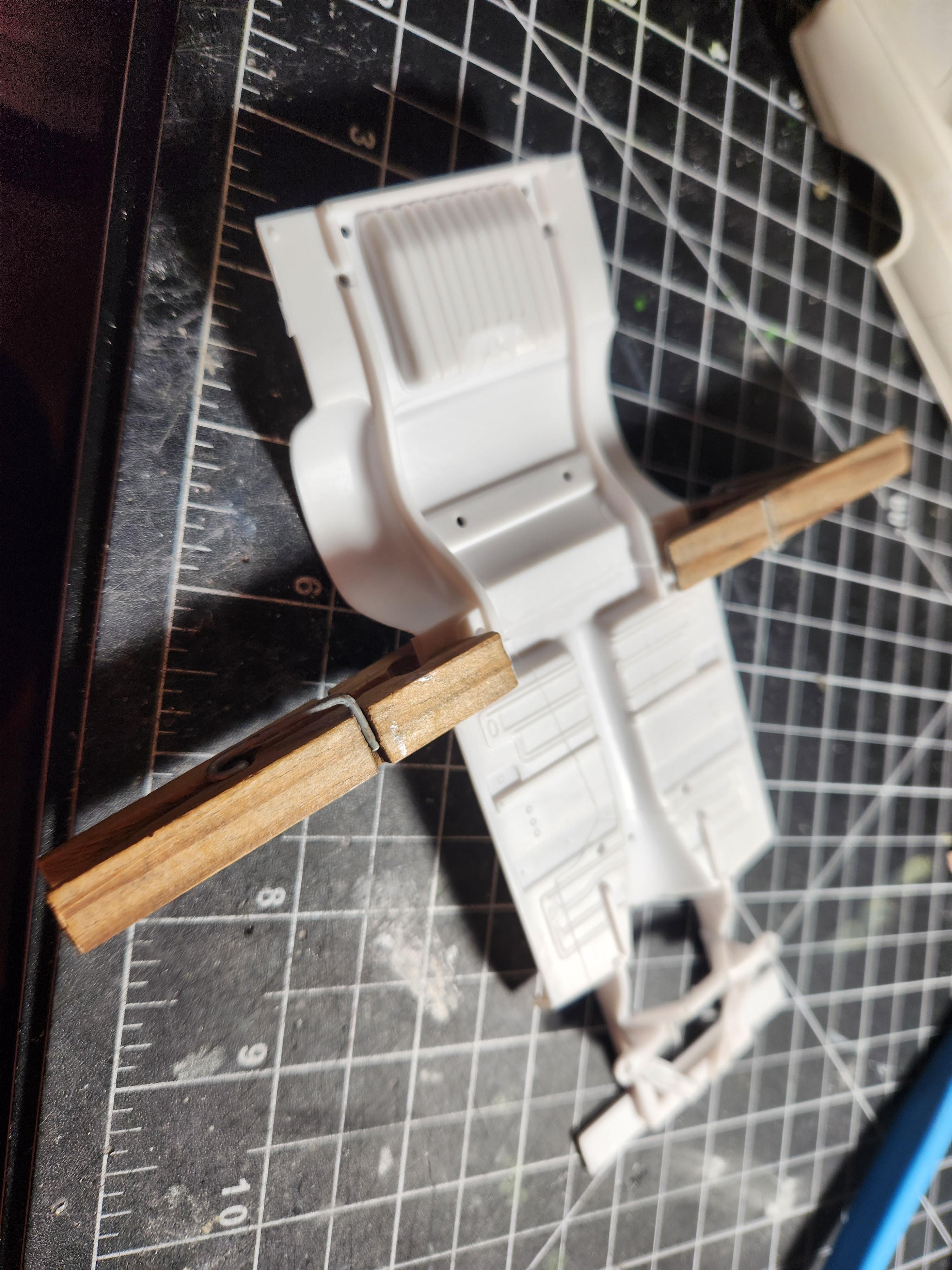

On the '62 Dodge body. After grinding out the radiator support you need to open it up a little behind the head light area to get the Lindberg radiator support / inner fenders to fit down in it right
Shown modified beside a unmodified '62 Dodge body
This area does not need to be done in the '63 Dodge body, shown beside the uncut '62 Dodge body. In this picture you can see the bump in the 62 that the 63 does not have. This bump needs ground down some. Dont go to crazy and risk going thru the body,  as not much is required

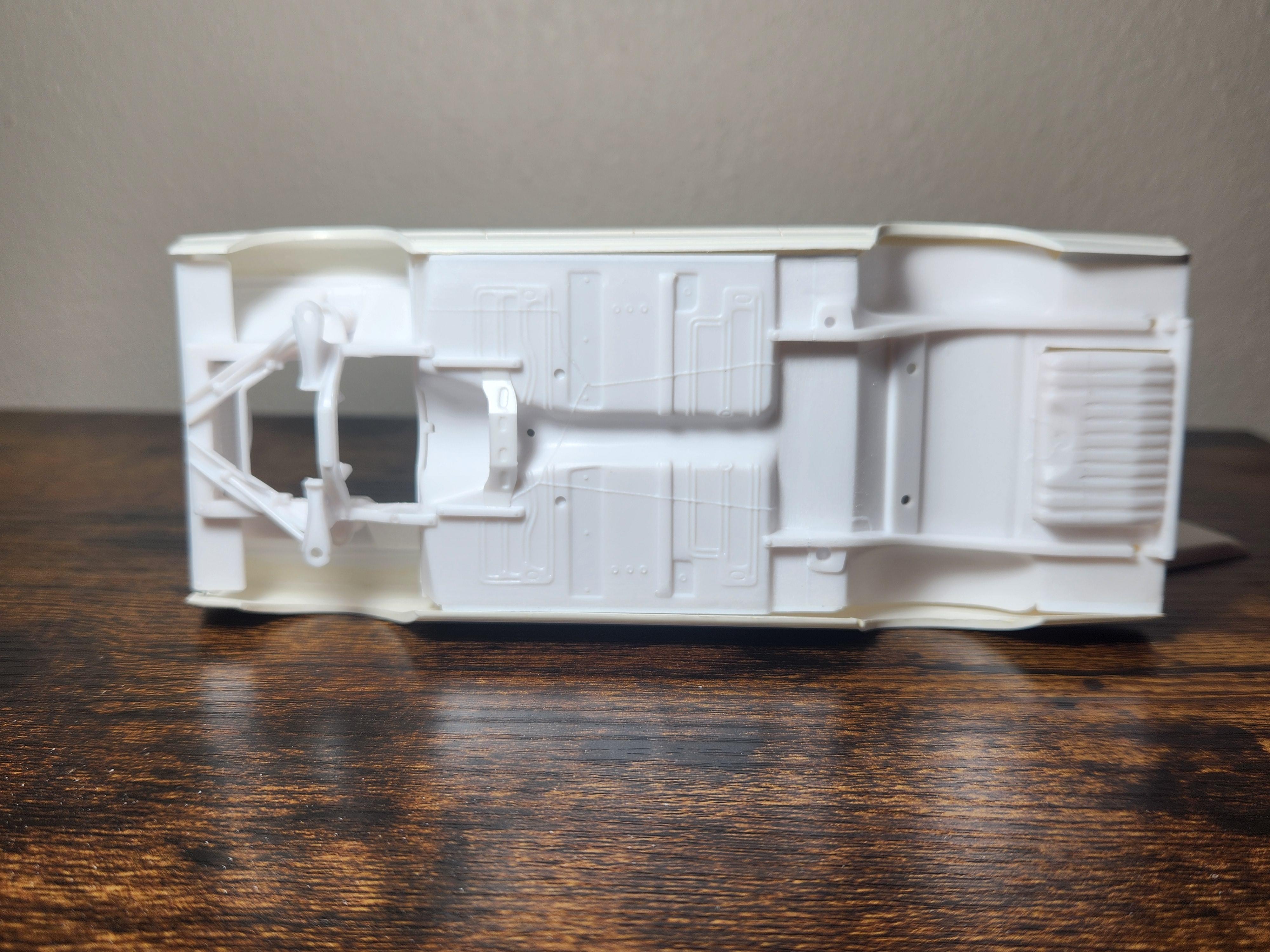

Wheelbase comparison between the 62 versus 63, is ever so slightly different . Enough to cause concern ? is up to the builder
Will I shorten it/ alter wheelbase ? Not likely
As well as Johan 63 Dodge chassis compared to Lindberg 64 Plymouth  chassis
