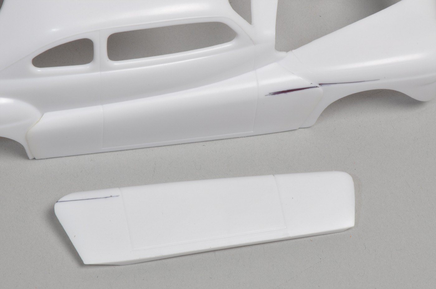

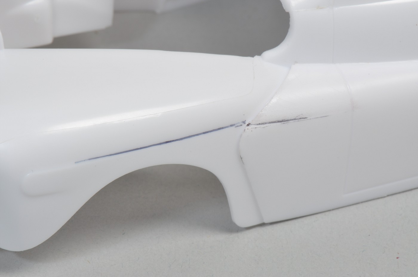

2.  I built my car using the optional fadeaway fender extensions found in the kit. If you want to keep the characteristic fender crease in the front fenders, you'll need to file a similar crease in the front edge of each of the fender extensions as shown here. Hold the fender extension in place and mark the crease with a pencil. Note that I aligned the fender extensions slightly upward (maybe 3/64") from their intended position, to lessen a "hump" from the front fender to the extension, which can be plainly seen on the box art model.

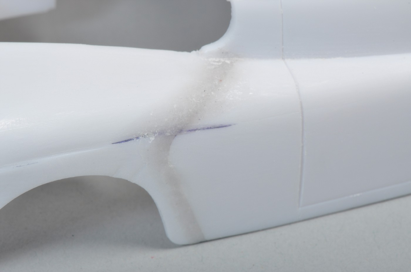

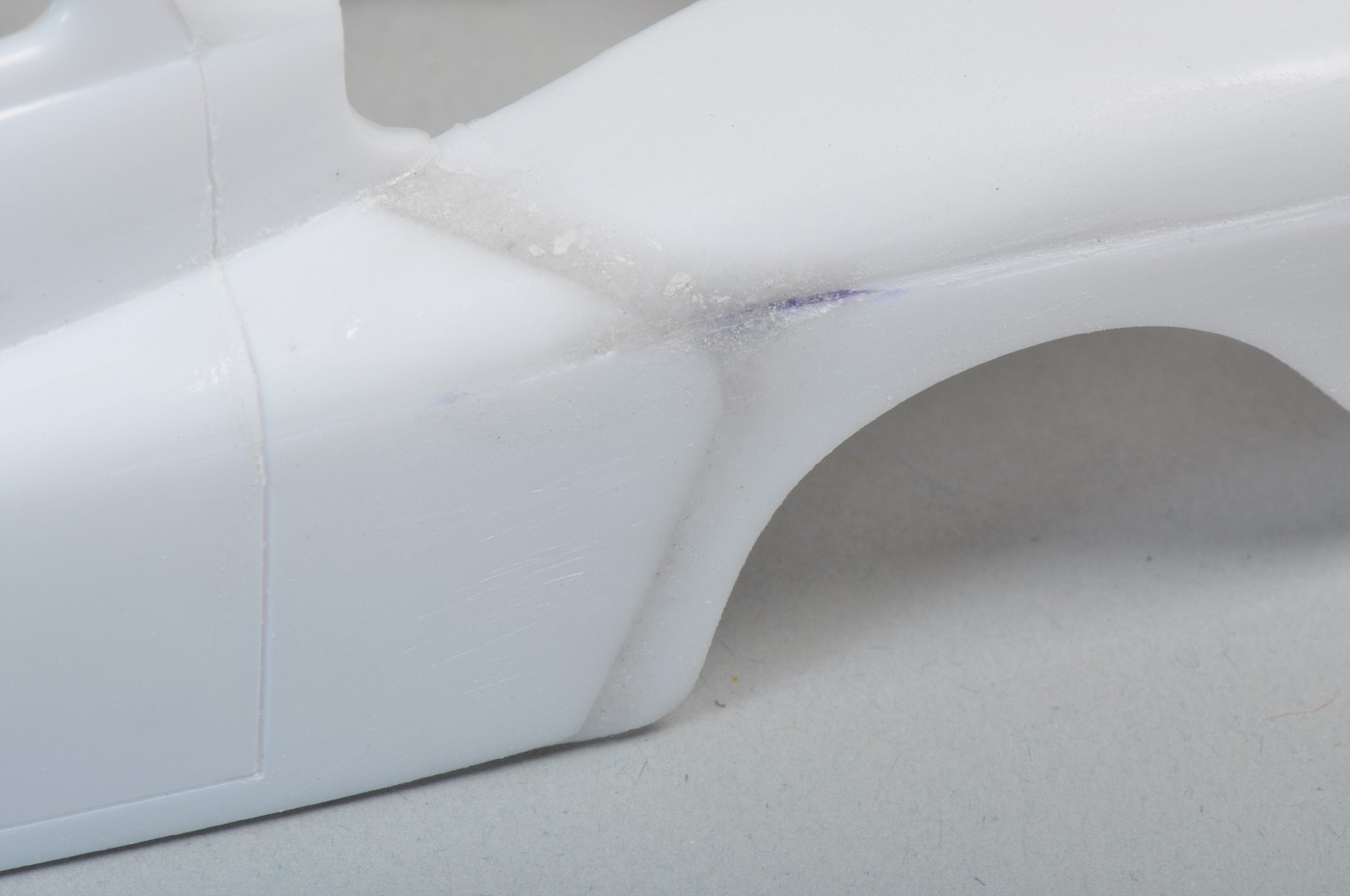

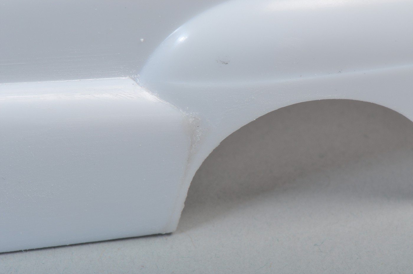

3.  Here the fender driver's side fender extension has been glued in place. You can see how much filler will be required here to deliver a smooth transition from the front fender to the fadeaway extension.

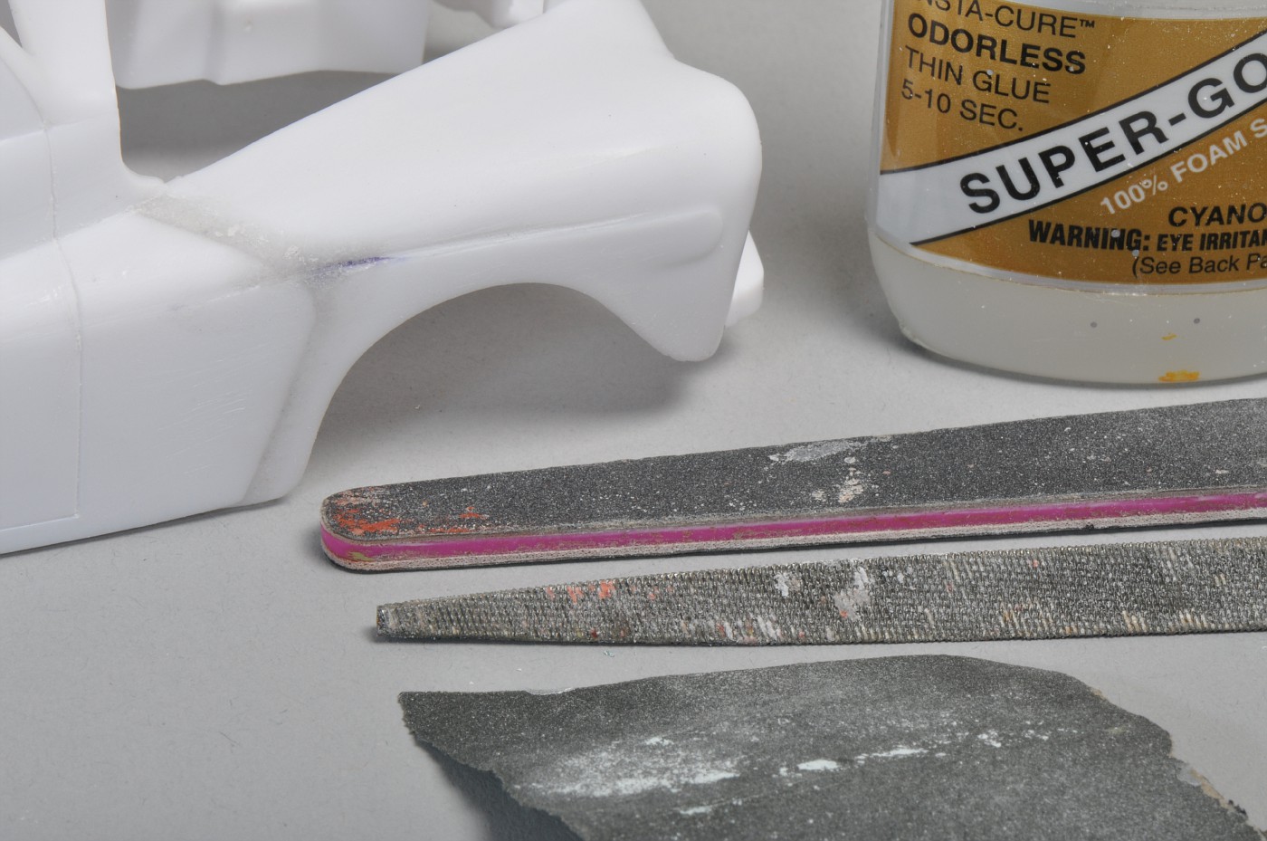

4.  At this point I began successive operations of filling the gap with CA++ glue, damping the glue joint with a Kleenix, filing the gap and letting the styrene 'bits' collect in the crevice where the glue is still wet, and then sanding the joint some more, repeating the above, again and again. After a while, most of the joint will be filled and will then be ready for some surfacing putty to finish the operation.

7.  Back to the driver's side front fender joint, I again marked the line of the fender character line and then ran a file along this line multiple times, to carry the character line back into the fadeaway fender.

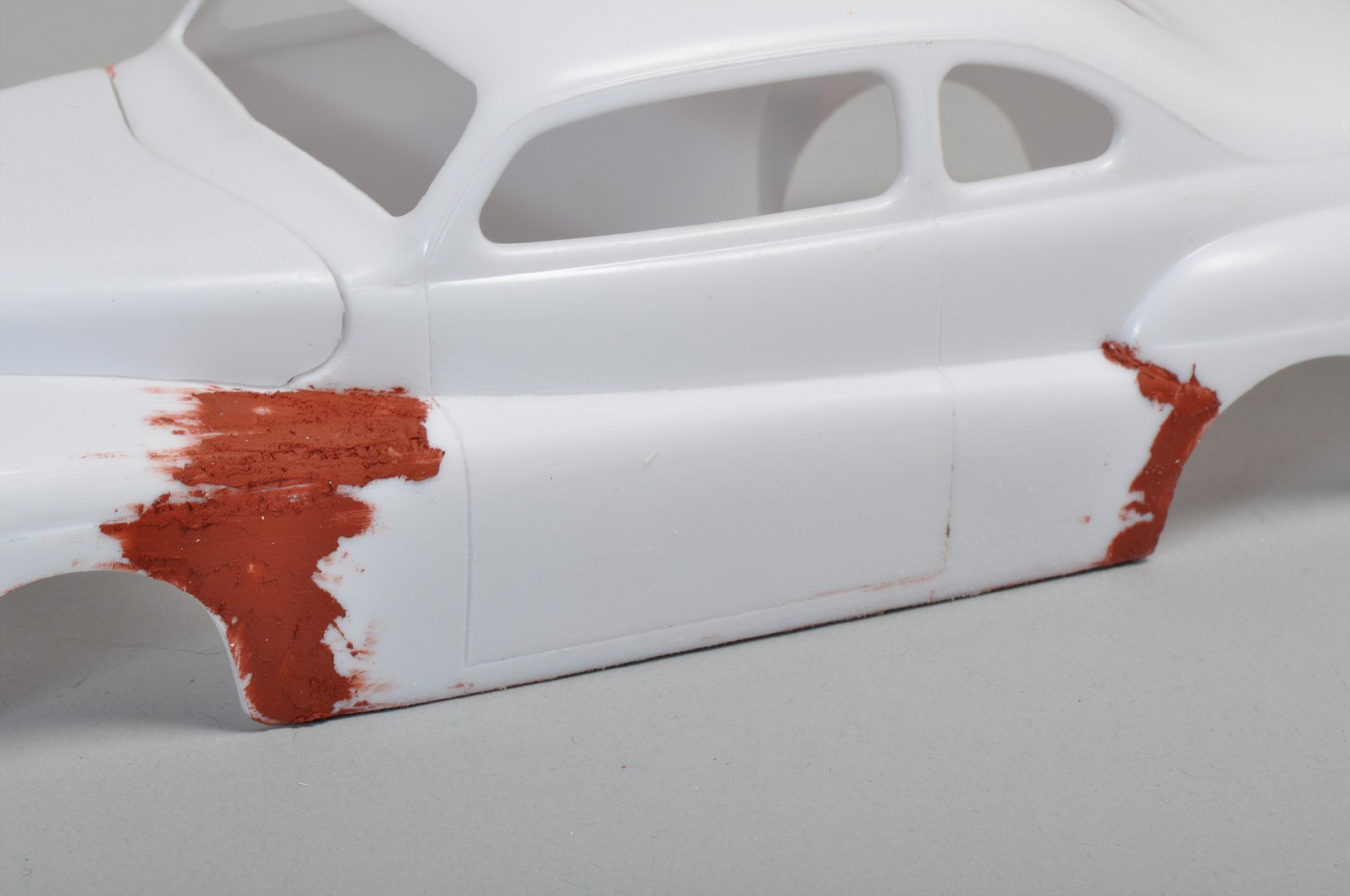

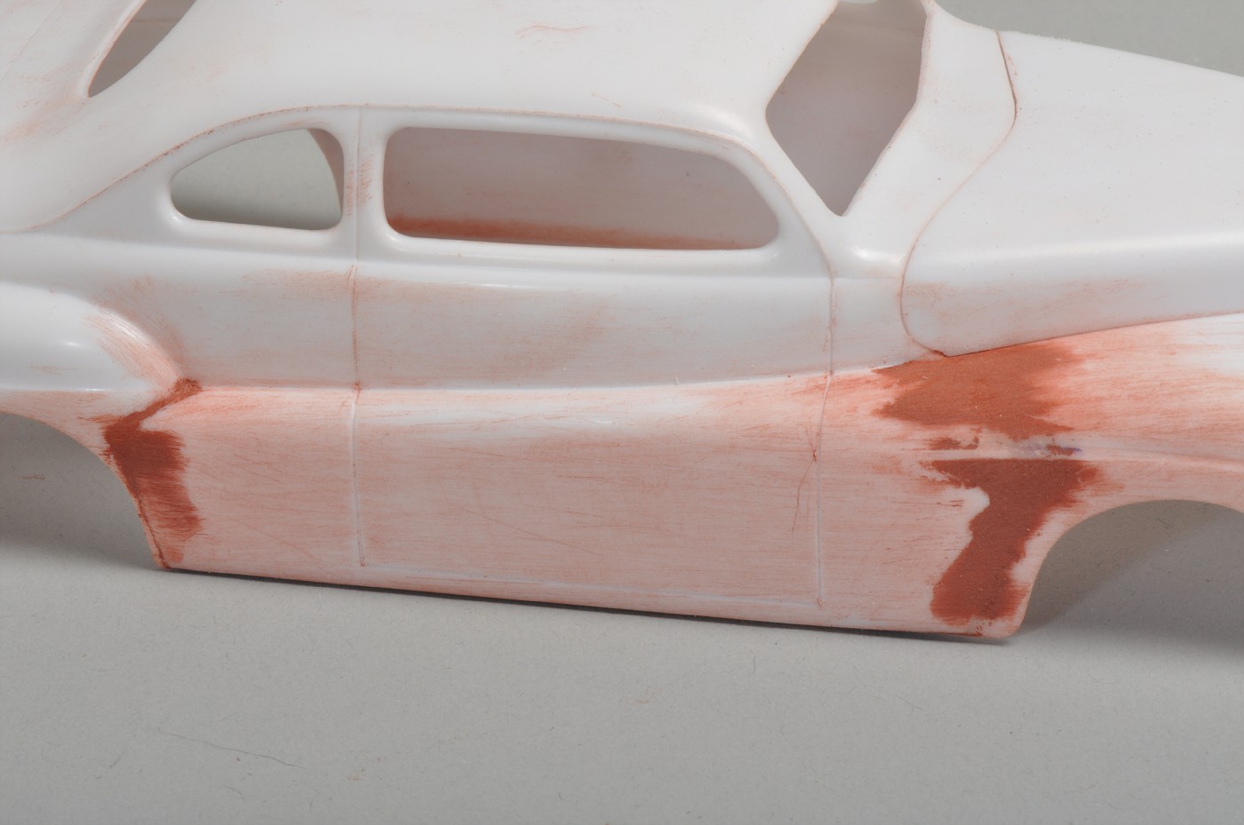

8. At this point, it was time for some body putty. I used automotive grade PPG DFL17 Red Cap Spot Putty. This putty comes in a large tube that can last for a decade's worth of modeling projects (my last tube actually lasted for two decades!).

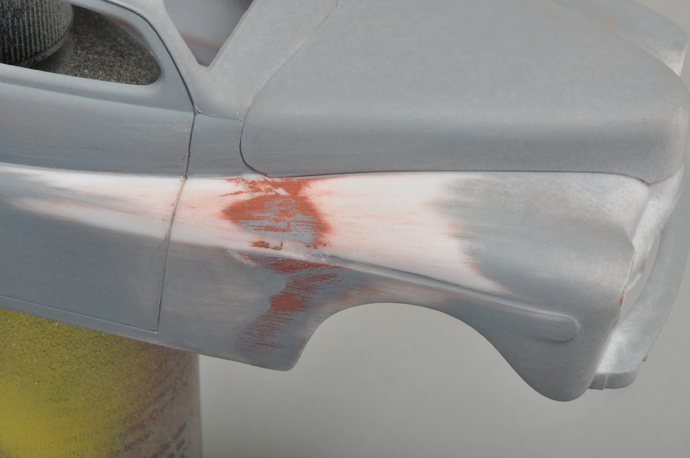

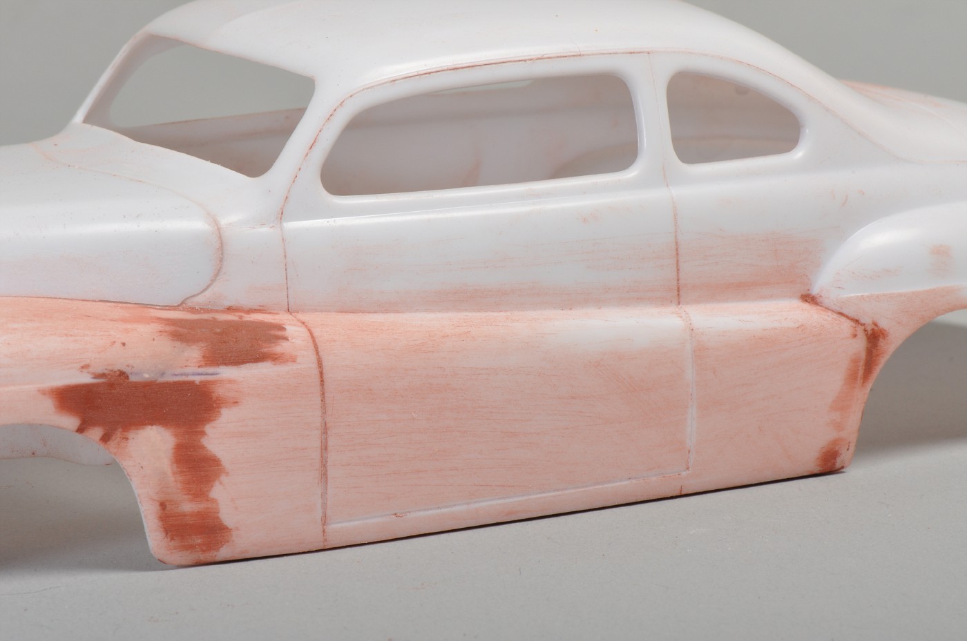

9. As soon as the putty dries (about 1/2 hour or so), sand the joint with sandpaper wrapped around a ruler or some other stiff backing. After sanding, the results should look like these joints on the driver's side of the body.
10. Here are the same surfaces on the passenger side of the body. Do your best to preserve the front fender character line when you sand the joint as shown here.

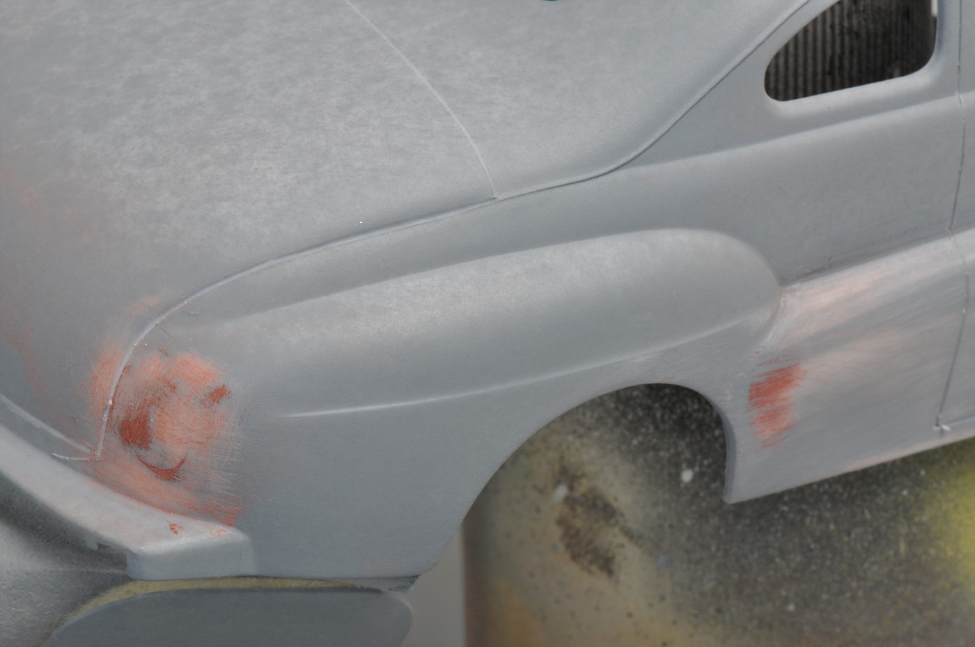

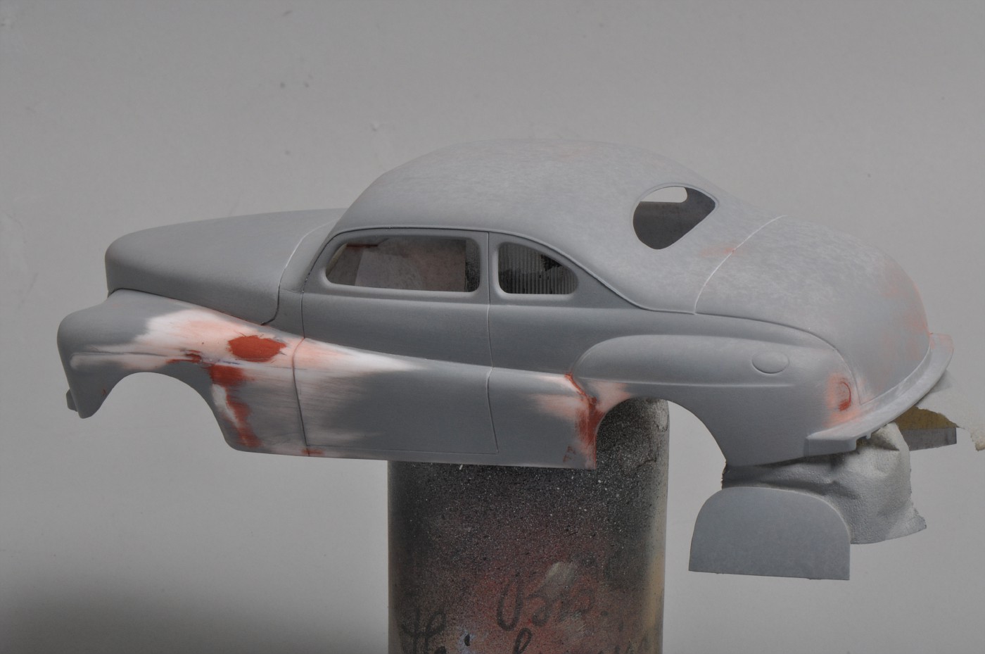

11. After a second round of bodywork and primer, the joint is again sanded, revealing some sunken areas (in gray) that still need further work. But we're getting close.

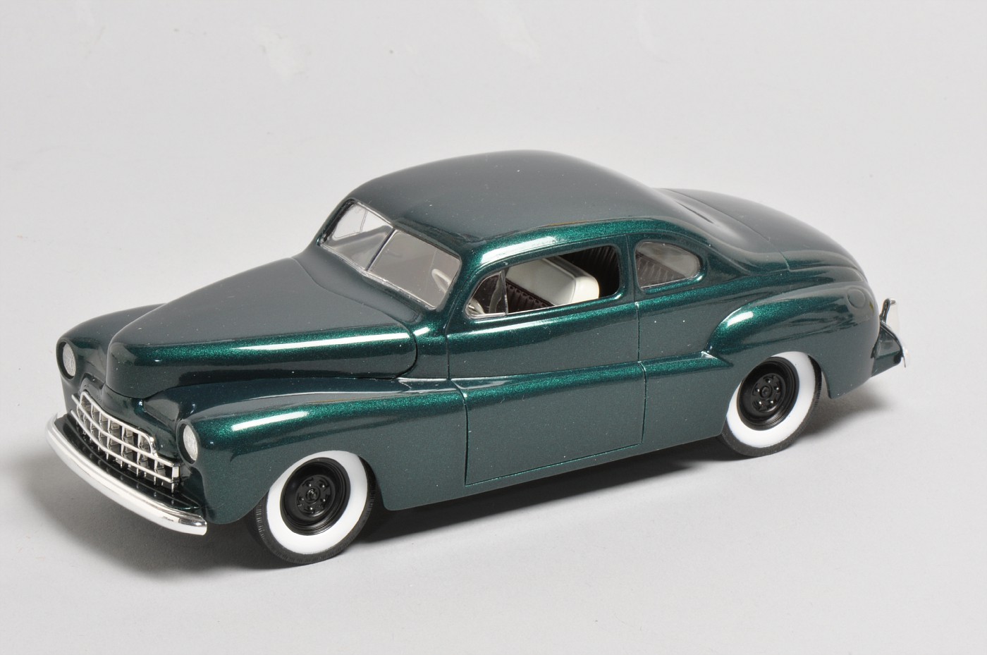

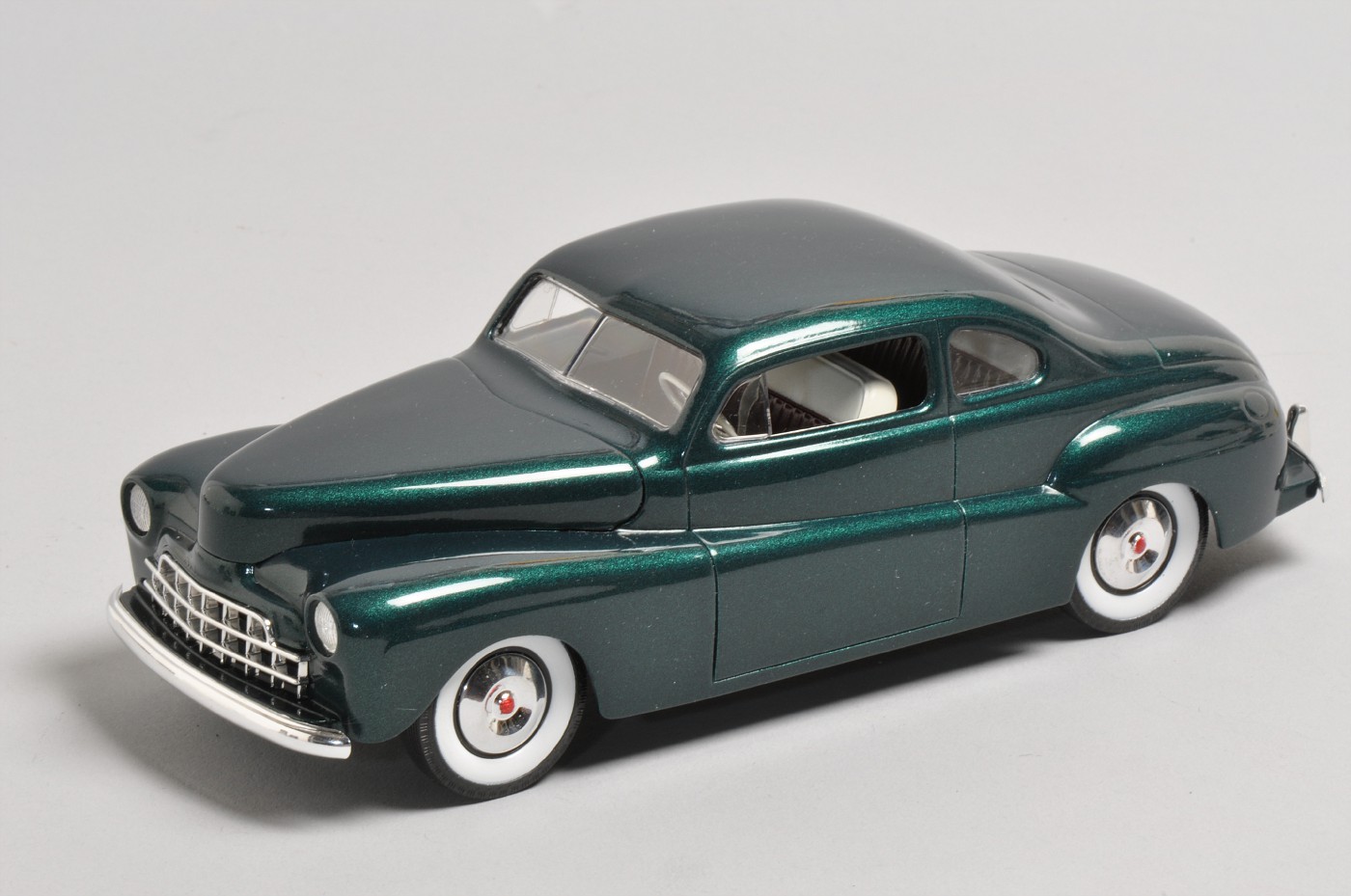

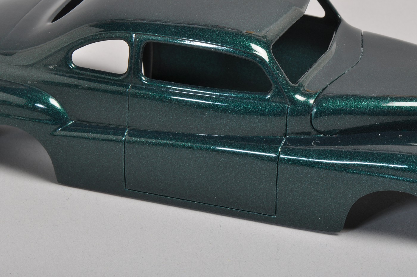

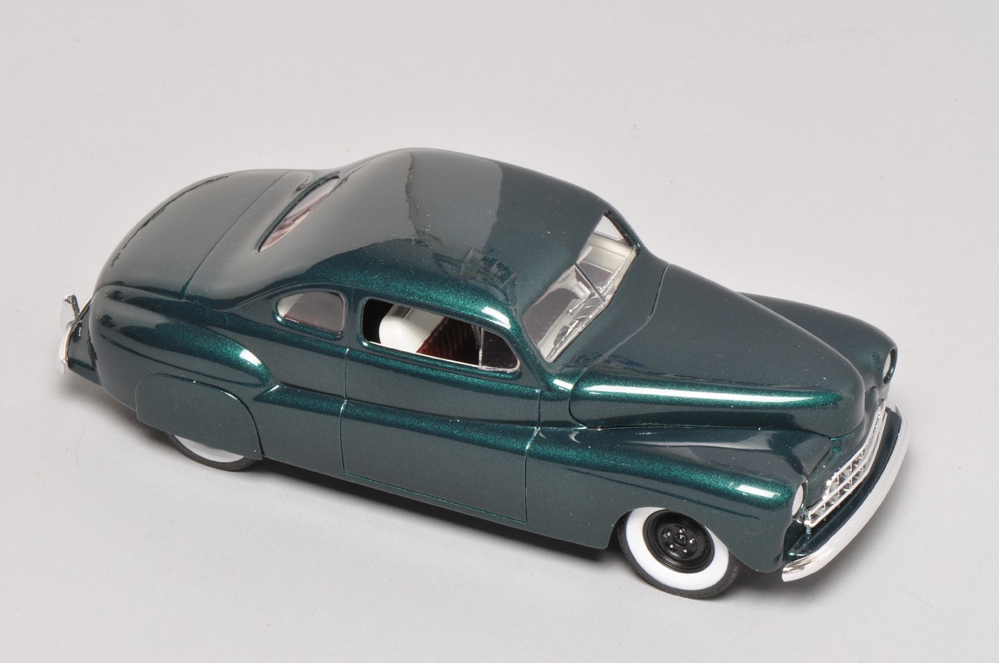

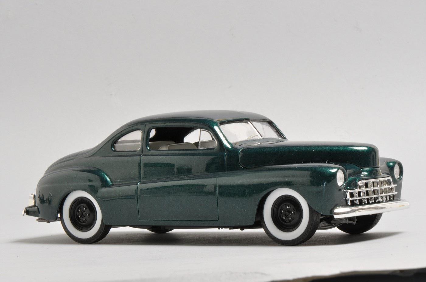

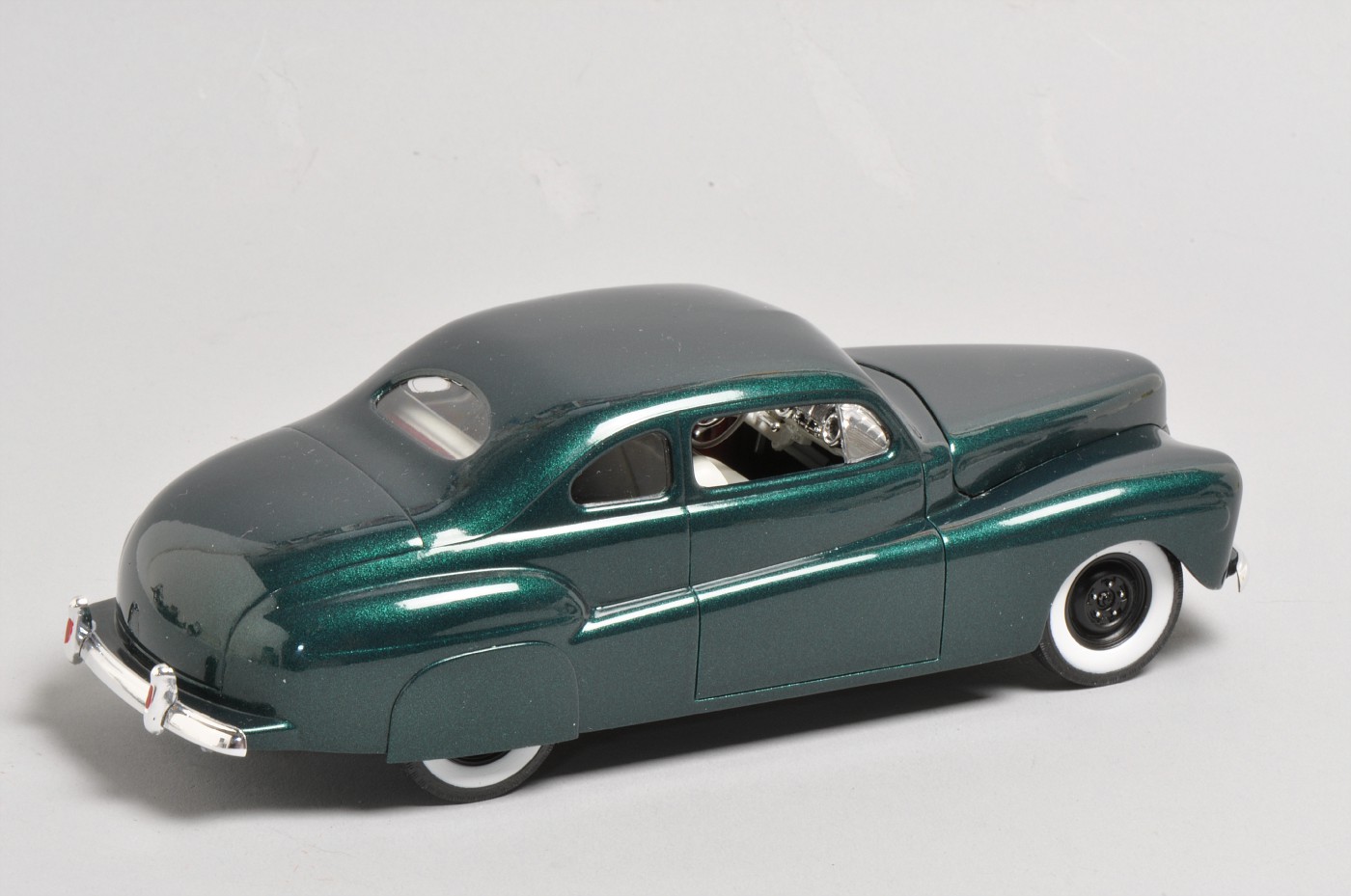

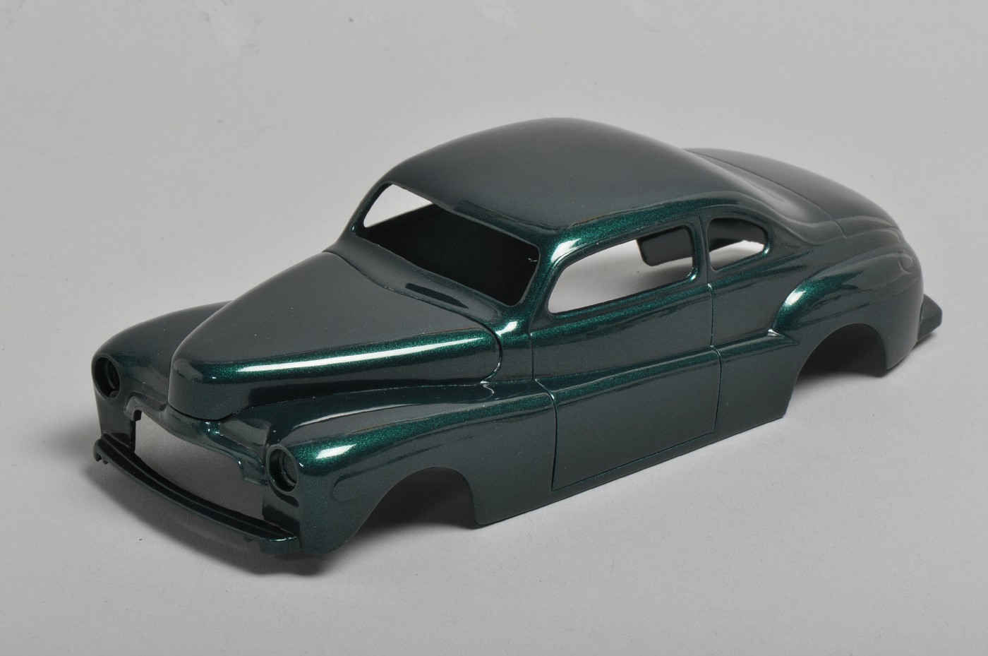

14. After several coats of Testors Lacquer 1996 GM Code 43G Emerald Green Metallic (sadly, no longer available) and Testors One Step Wet Look Clear, you can see the fine paint finish, and also the entirely smooth joints where the fadeaway fender extensions meet the front and rear fenders.

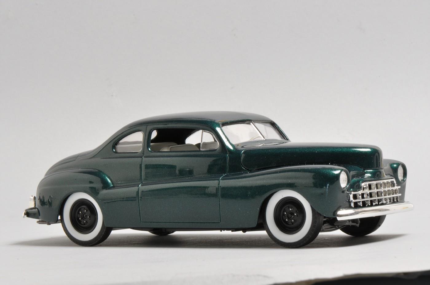

15. A look at the Driver's side reveals a similar result.
A few images of the completed project, fadeaways and all.  All of the steps of the tutorial/kit build, including interior/engine/chassis/exterior build options are shown at the link posted in the intro paragraph at the beginning of this post.  Enjoy....TB

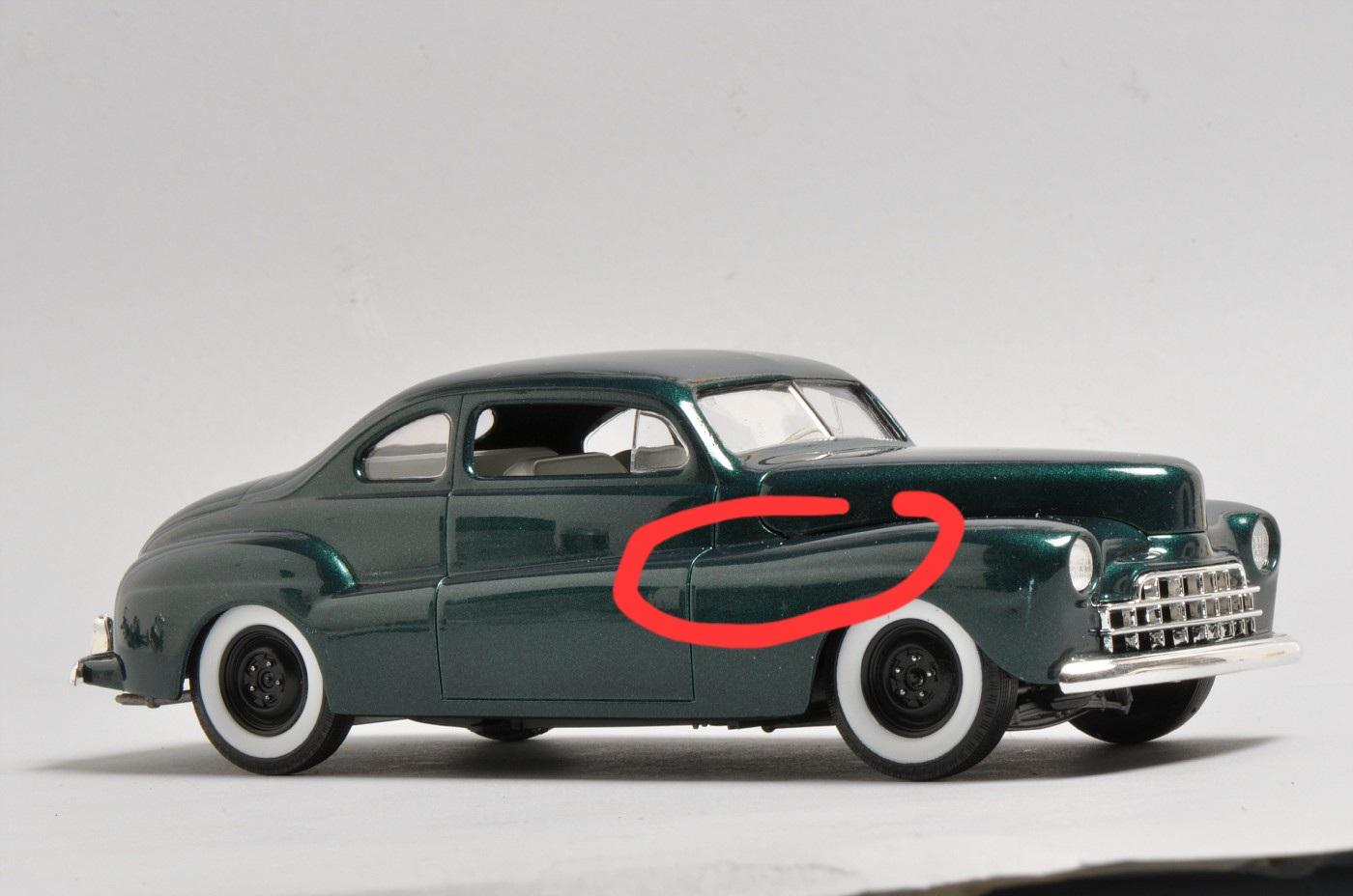

Looks pretty good there Tim! I use that CA filler method for big gaps as well. One thing that I think that could make it a little better if you didnt build it OOB is there's a little bit of a dip in the fadeaway by the cowl (circled in red), you could build that up and I think it would make the body lines flow much better. DSC_2232-vi(1).jpg.cf0e1e85957623bcdd29b13f4f2d0d88.jpg
I went over it with a little AI to show you what I mean.
Edited by FoMoCo66
Ace....thanks for taking the time to post your comments and show the difference via the AI/photoshop work.
My build was intended to show the kit-based parts and how easy it is to use them in a model build.  The additional changes you show are possible but would probably add considerably to the workload.  There aren't many 1/1s running around with added fadeaways, but the ones I am familiar with do generally show a bit of dip in the body to fadeaway join around the cowl area, rather than a straight line through that area.  I suppose that was/is a design choice to be made by the various builders involved.  I just checked the Modern Rodding car and it appears sort of in the middle between my original and your redo.
Anyway, thx again for the comments, and if any of you are considering finding this old kit and doing the conversion, please keep Ace's suggestions in mind....TIM
