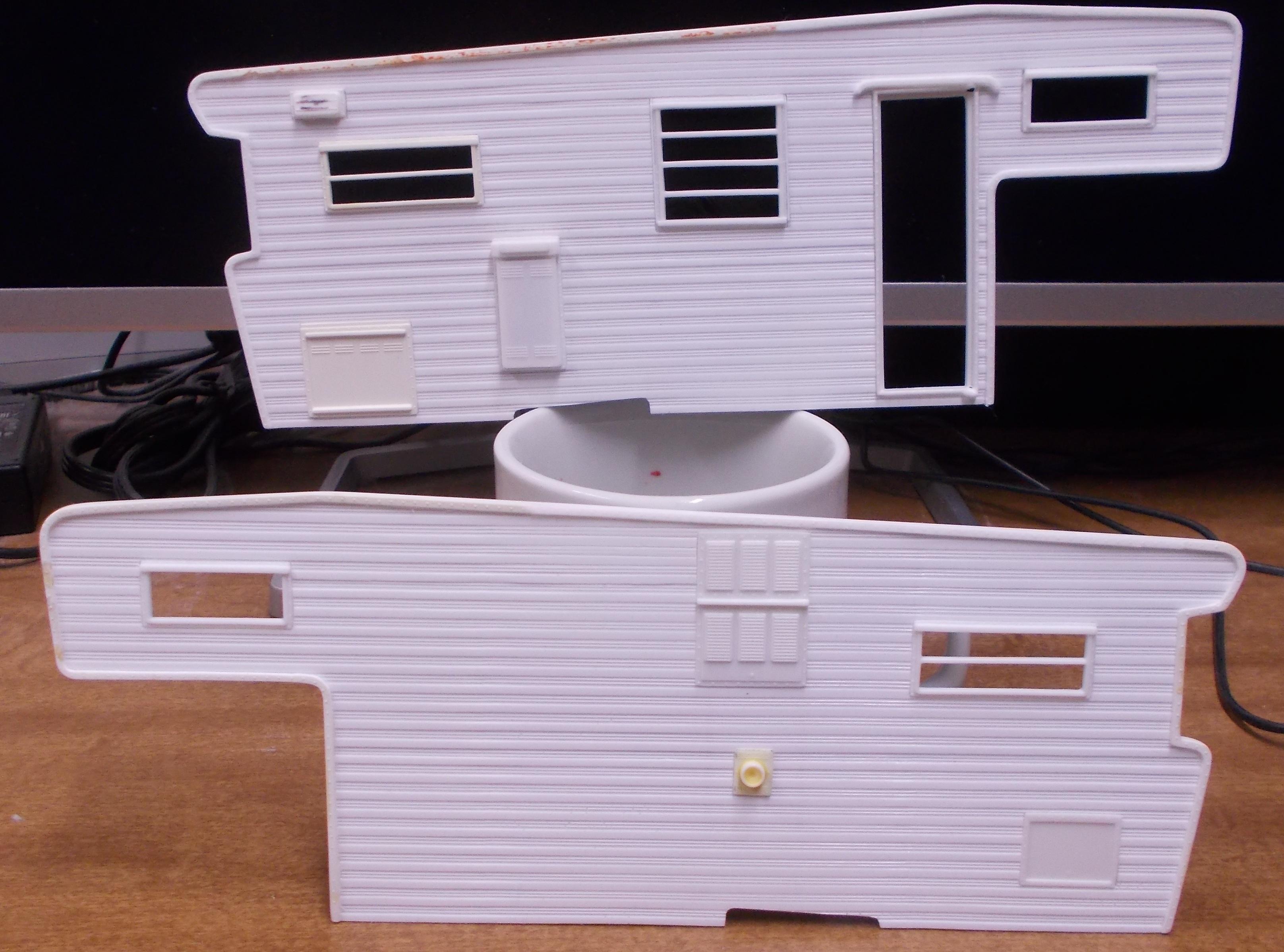

Repstock Posted 5 hours ago Posted 5 hours ago (edited) After finishing the Winnebago, I decided to make an Open Road camper. As nice as the Model King kit is, I have a great difficulty when it comes to building anything as it comes. The kit is an 11' camper so I decided to stretch it to a 15' camper, the Open Road Royale. I glued several sections of the side paneling together and cast it. I then connected several of the castings together and cast that. I was left with a large sheet of the side panel design. I glued the resin sides to .040 sheet styrene. From there, I cut out the camper shape. I then cut out all the detailing from the kit sides and glued them in the appropriate holes I cut in the sheet paneling. I am nearly done with the sides, and this is what I have so far. I tend to work on and off, so I'll update as I do something notable. I plan on using one of the Moebius Ford pickups for the cab section. Edited 5 hours ago by Repstock 3
