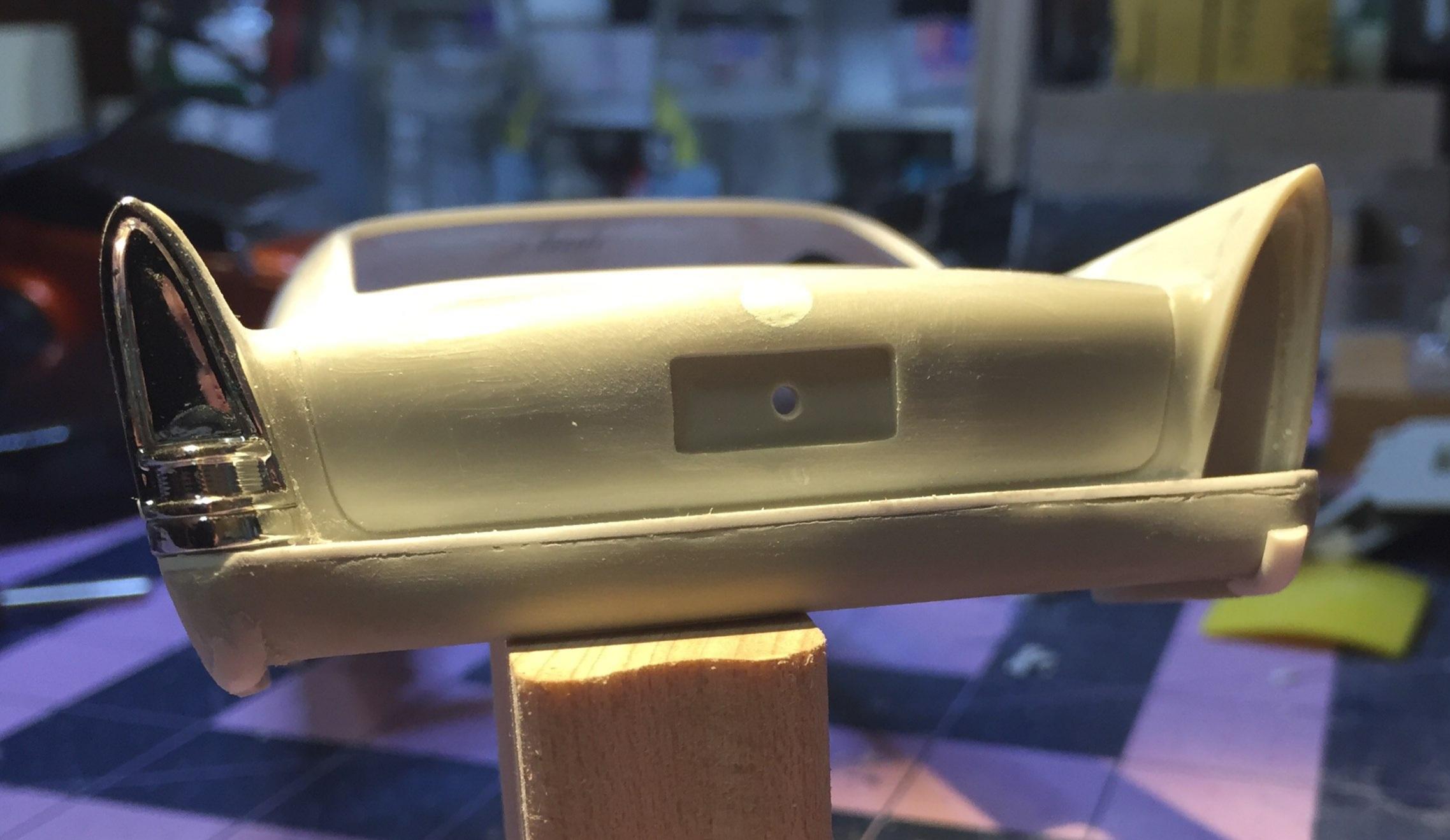

customline Posted Monday at 01:17 PM Author Posted Monday at 01:17 PM 1 hour ago, NOBLNG said: Rear end is looking good Jim. Heck, it’s all looking good.👍 I’m not normally a fan of fender skirts, but I don’t think they look bad here.🤔 I made the skirts from '34 Ford hood top panels. Not sure they'll make the final cut but I just wanted to see.
TopherMcGinnis Posted Monday at 01:22 PM Posted Monday at 01:22 PM The vent windows and skirts get a 👍 from me.
customline Posted Monday at 01:32 PM Author Posted Monday at 01:32 PM 3 minutes ago, TopherMcGinnis said: The vent windows and skirts get a 👍 from me. Thanks, Topher, I'm torn about the vents. I'll be working on the cowl area next and if I can, I will leave the vents. I like the skirts but it may depend on how it looks with the wheels.
Bullybeef Posted Monday at 02:25 PM Posted Monday at 02:25 PM Looking good Jim, I’m not 100% sold on then skirts but I’m liking the rear bumper treatment a lot? I think by seeing it with a proper suspension might change though.
LennyB Posted Monday at 02:32 PM Posted Monday at 02:32 PM 11 hours ago, customline said: I can't explain that. The Karman Ghia looks like a suppository. The rear of the Chrysler🤯 has these gigantic fins, Lenny! 🥴 It's actually this view I was talking about.
Kutnplastik Posted Monday at 02:54 PM Posted Monday at 02:54 PM 9 hours ago, customline said: It's going to get prettier, trust me. Great use of the rear bumper! The stock wheel openings on this build look great as is. The fender skirts make it look bulky.
customline Posted Monday at 06:08 PM Author Posted Monday at 06:08 PM 3 hours ago, LennyB said: It's actually this view I was talking about. Oh....yeah.....I see it now....😉
customline Posted Monday at 06:20 PM Author Posted Monday at 06:20 PM 3 hours ago, Kutnplastik said: Great use of the rear bumper! The stock wheel openings on this build look great as is. The fender skirts make it look bulky. Well....I think it looks massive due to the smooth slab sides and big fins. If I get it low enough, the skirts can find another house to haunt. I will never install "cruiser" skirts on anything. Flush types look good with big fat white walls, which will be the case here. Thanks for your input, Rudolf, it helps me take these life-altering decisions. 🤓

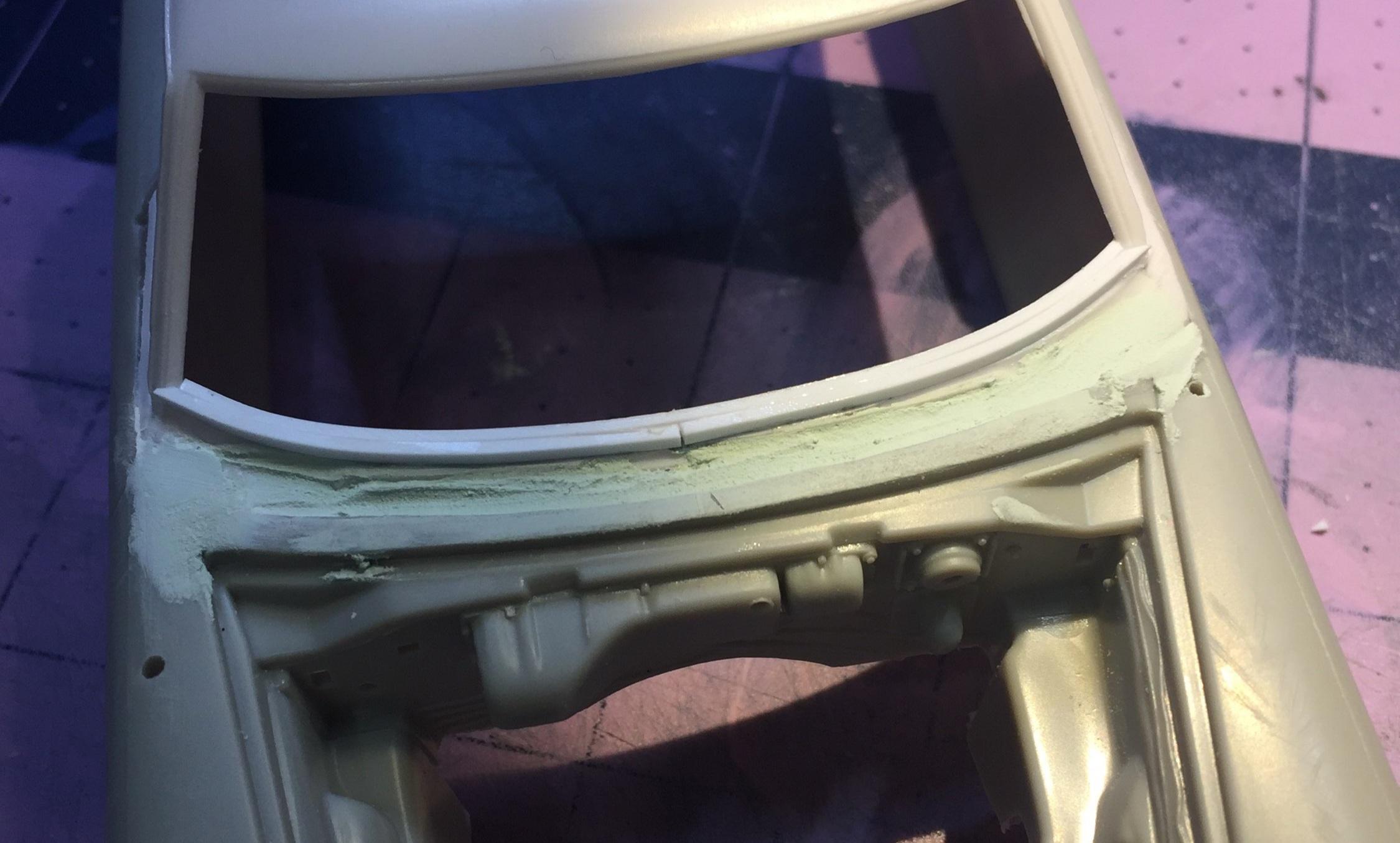

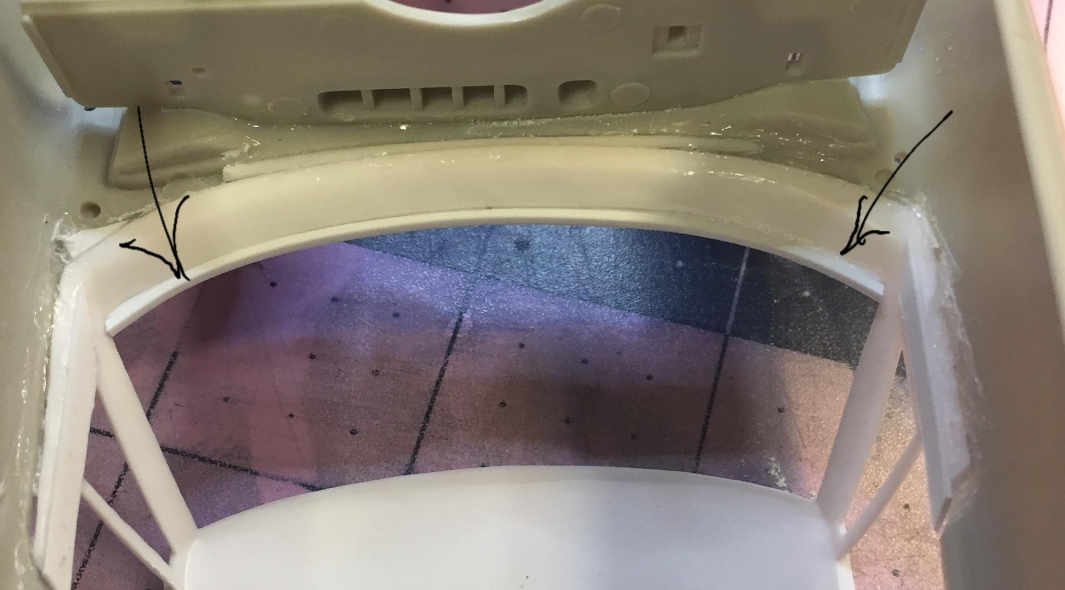

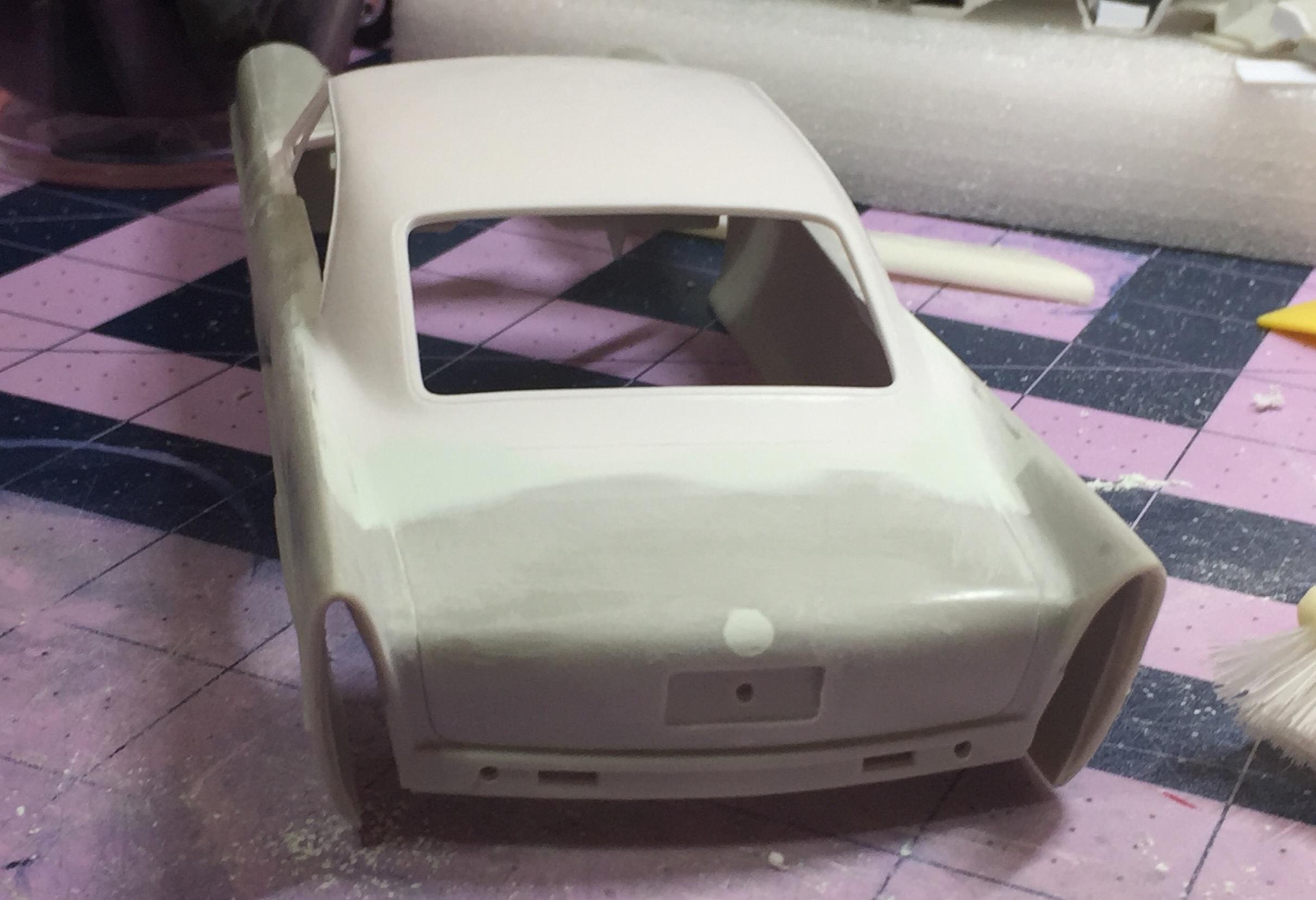

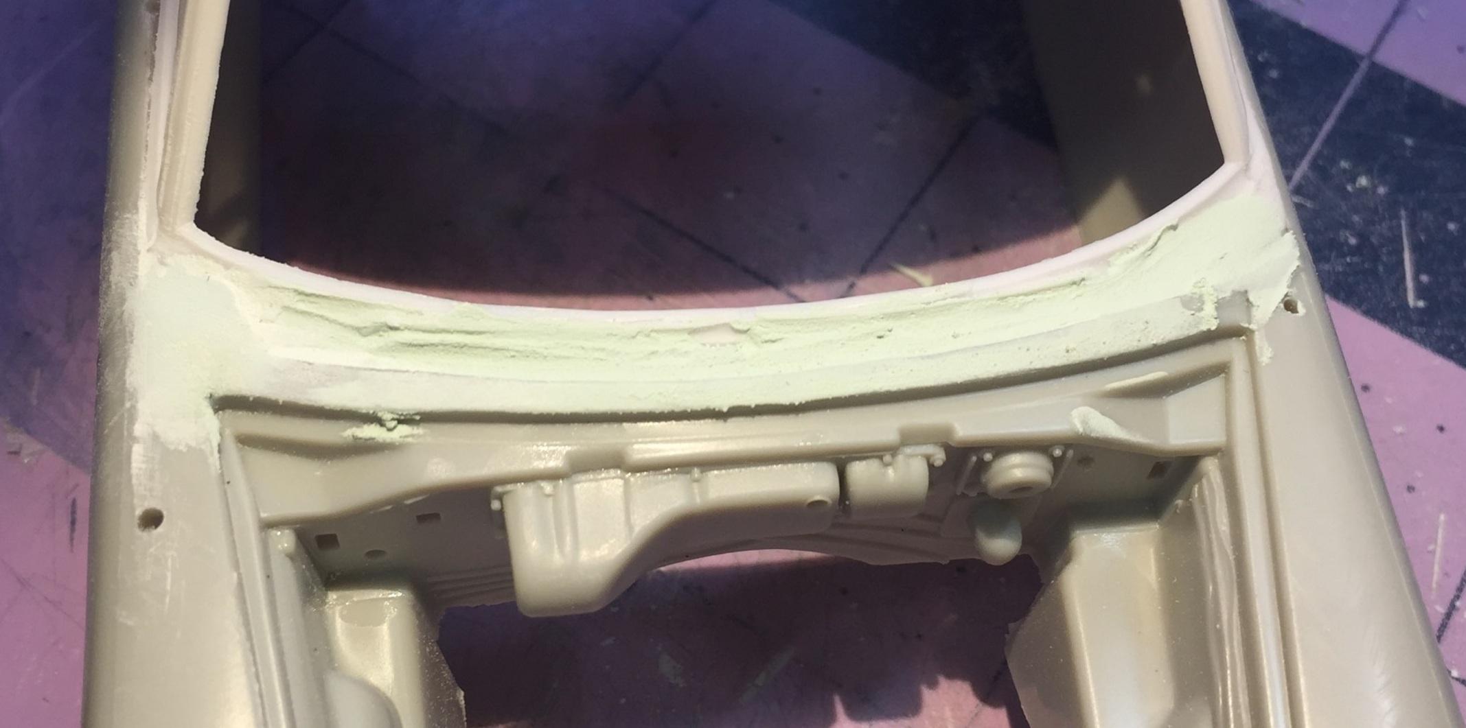

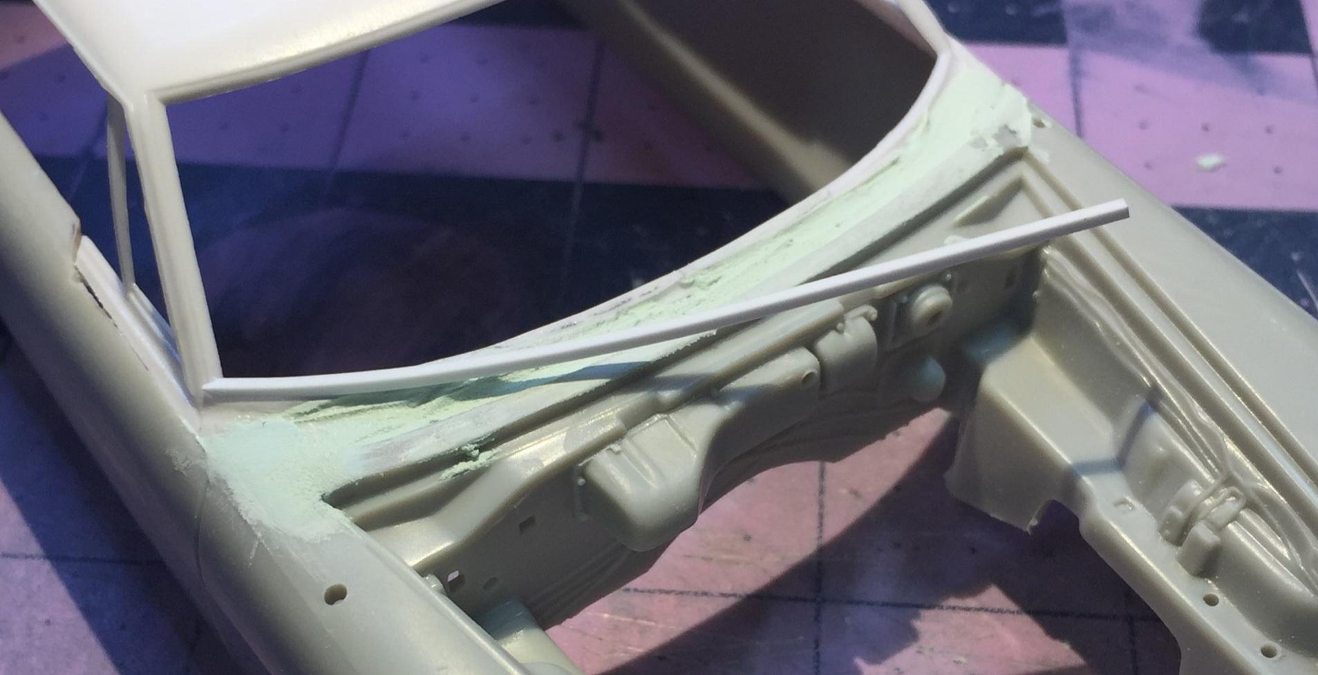

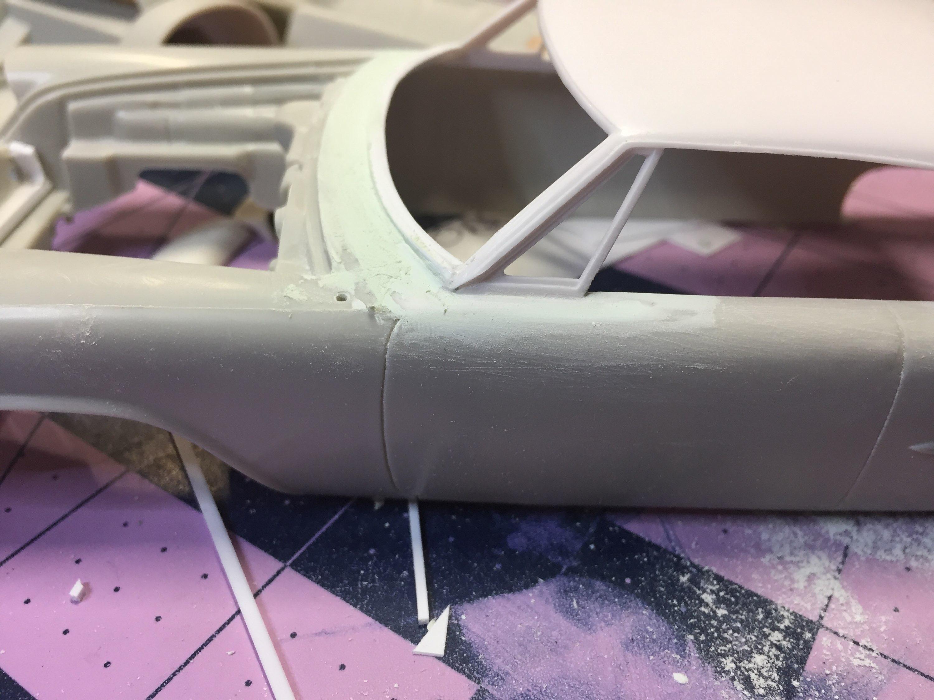

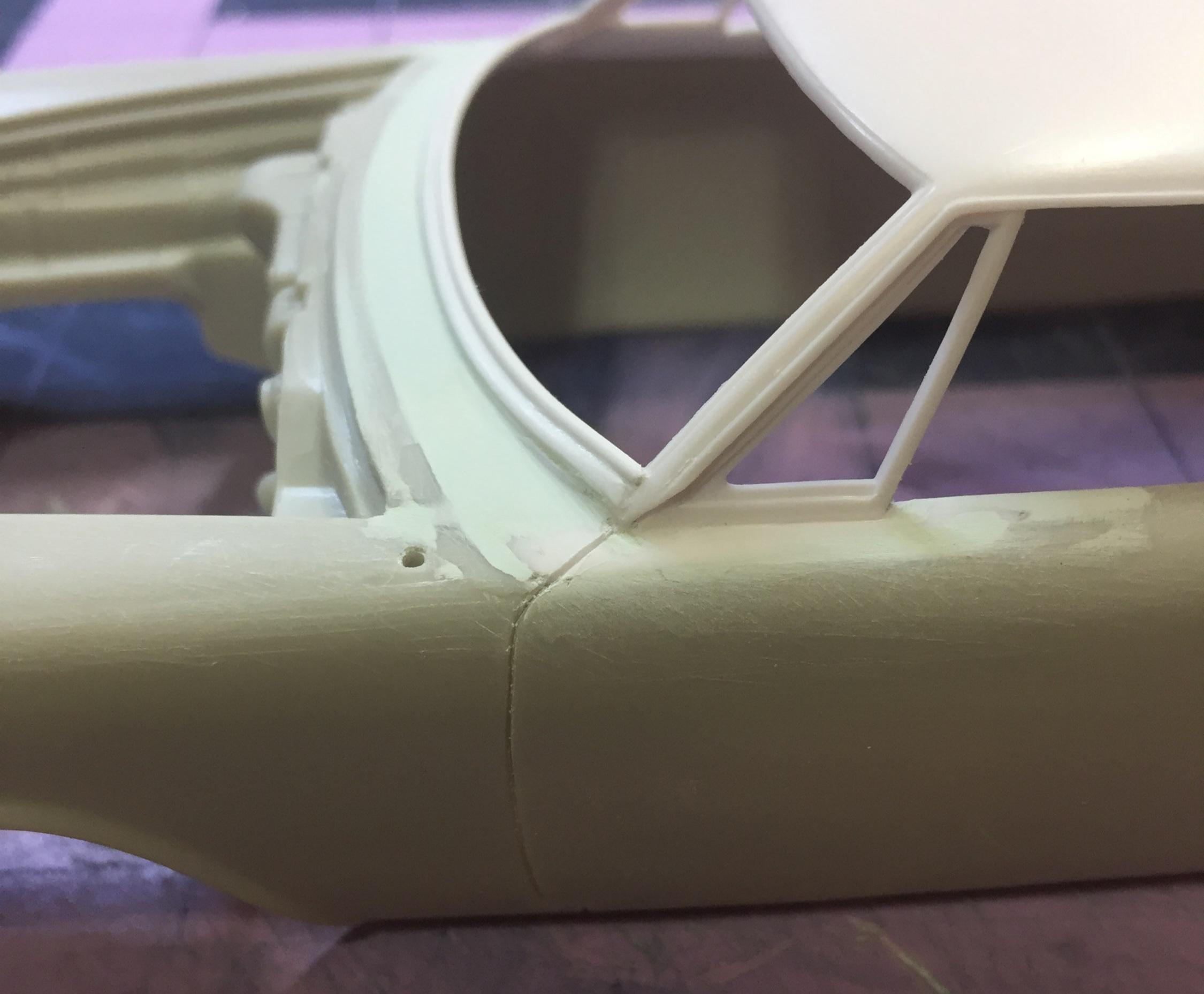

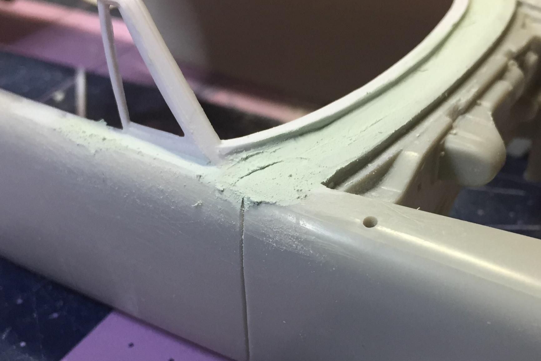

customline Posted 23 hours ago Author Posted 23 hours ago It was time to tackle the front attachment areas. Because of the way the alien roof/cowl mated with the body, there was some filling to be done here at the cowl. Of course the wipers on both had to be ground off. There is no longer any way to get fresh air to the A/C vents but I did leave the little windows because somebody reminded me about that. 😉 This is me adding a 40x40 to the bottom of the windshield to complete the frame. Another one was added to the first one, inboard. After the glue set I filed an angle on the inside to get a proper fit to the glass. The arrows indicate the added material that gets filed down to match the angle of the adjacent surface. Here you can see the scraps added to the new roof to fair it up with the body. Still got filling and sanding to do. It may be a while before it's warm enough to paint but there's plenty to do while I'm waiting to get primer on this. Like chasing panel lines 😩 Thanks for stopping in. Got snow? 🥶 5
