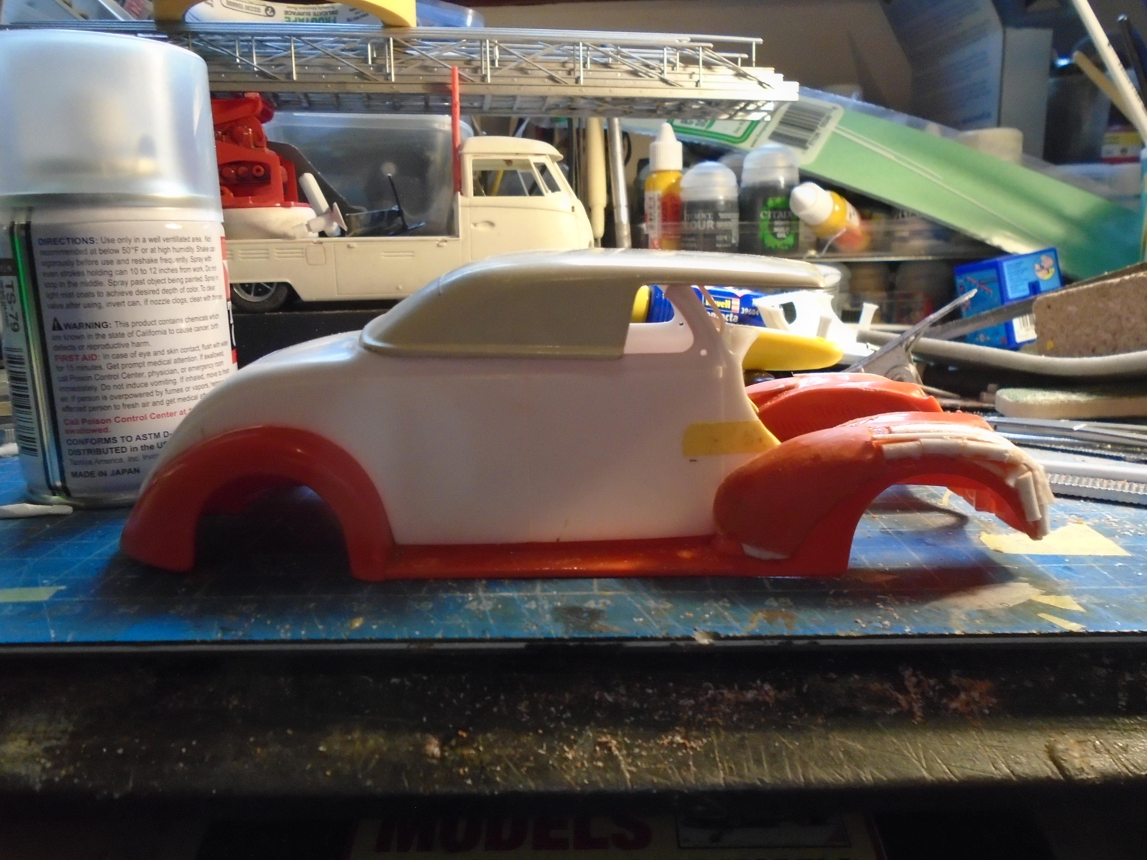

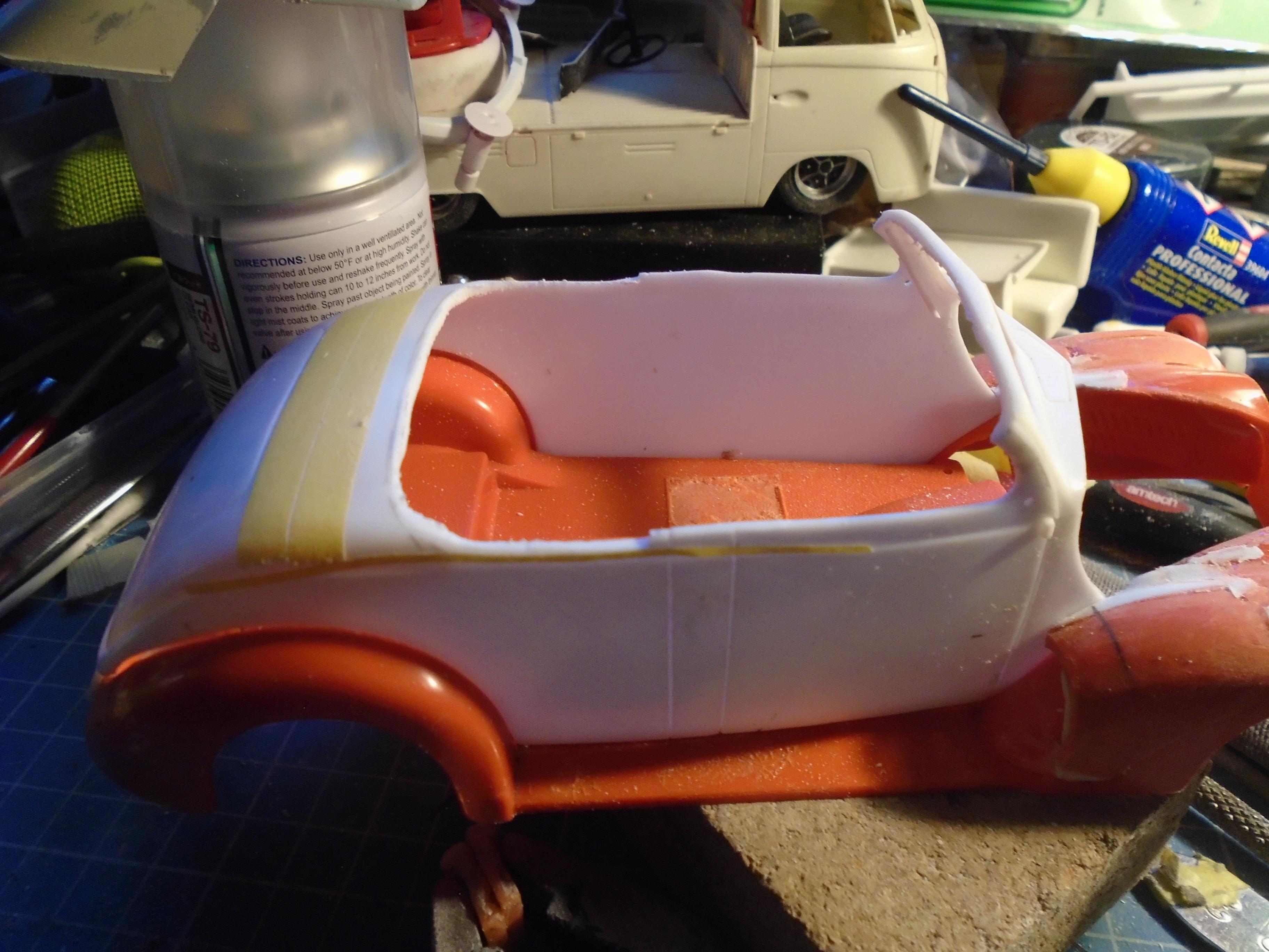

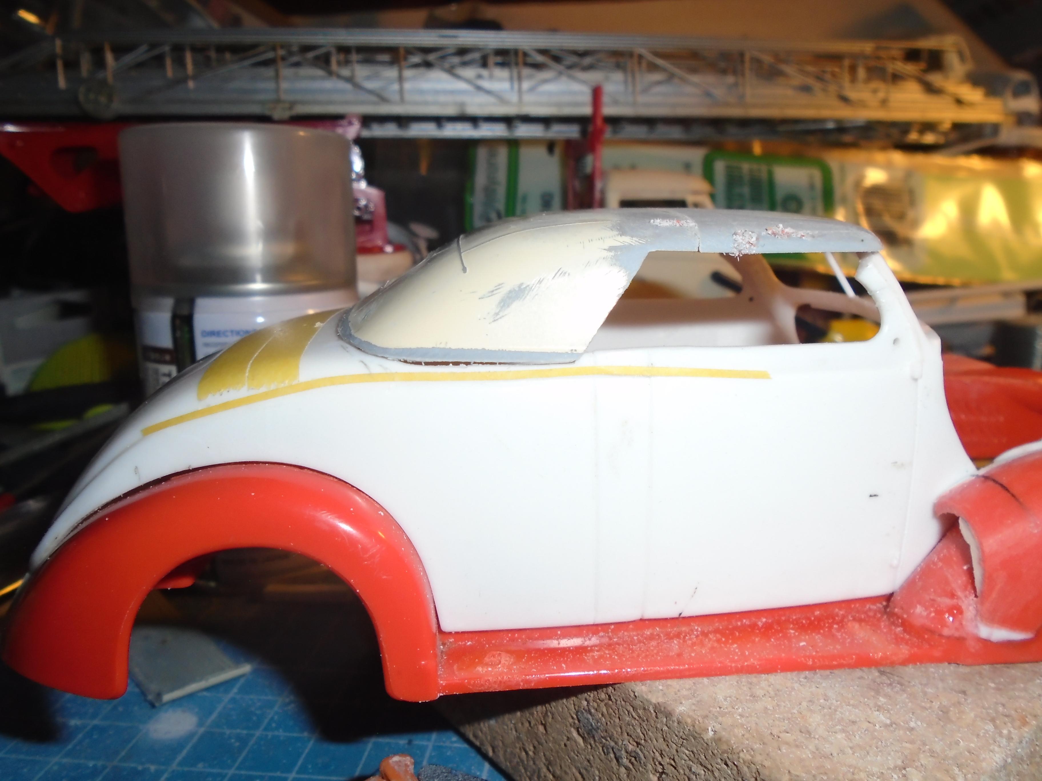

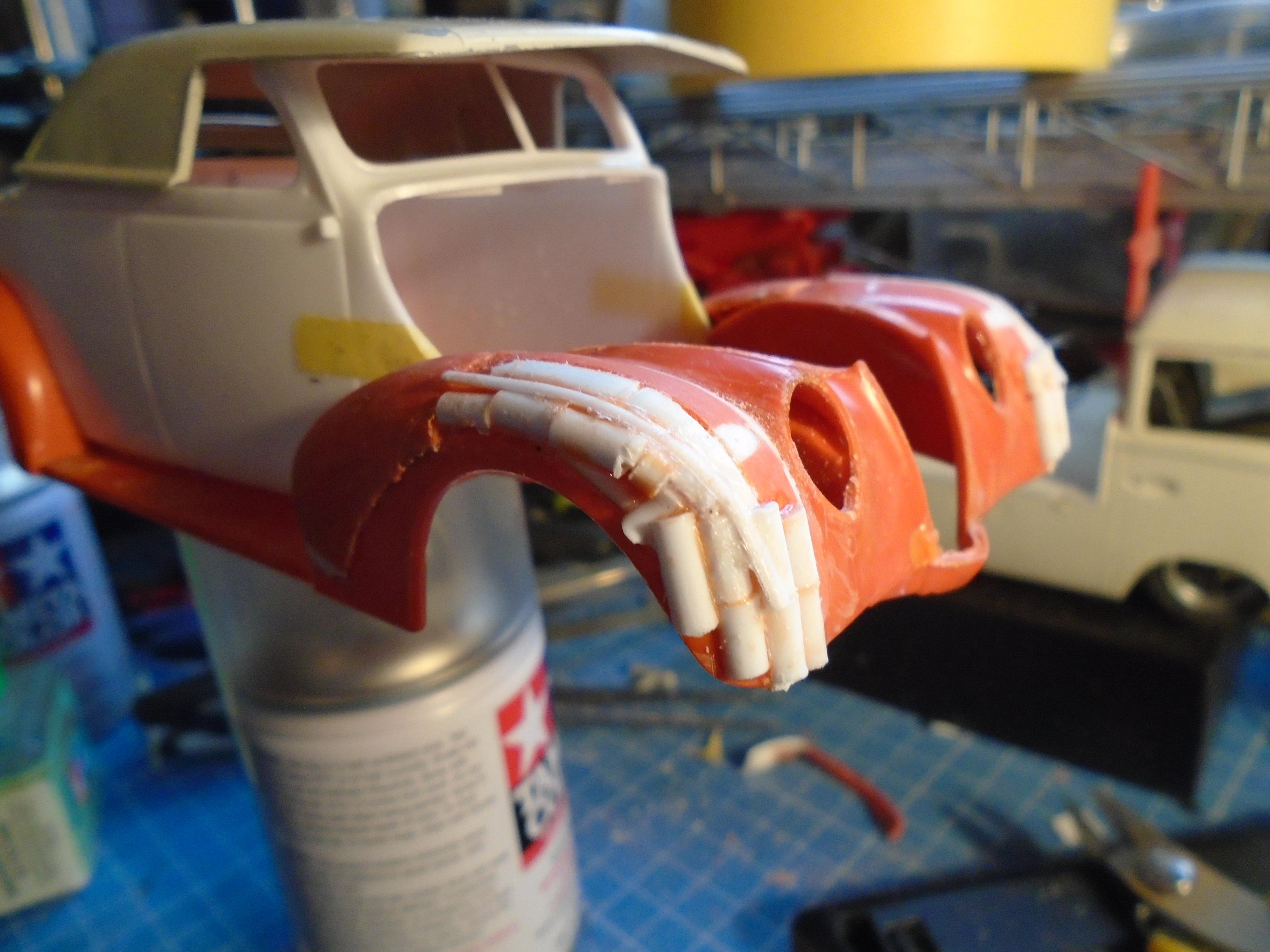

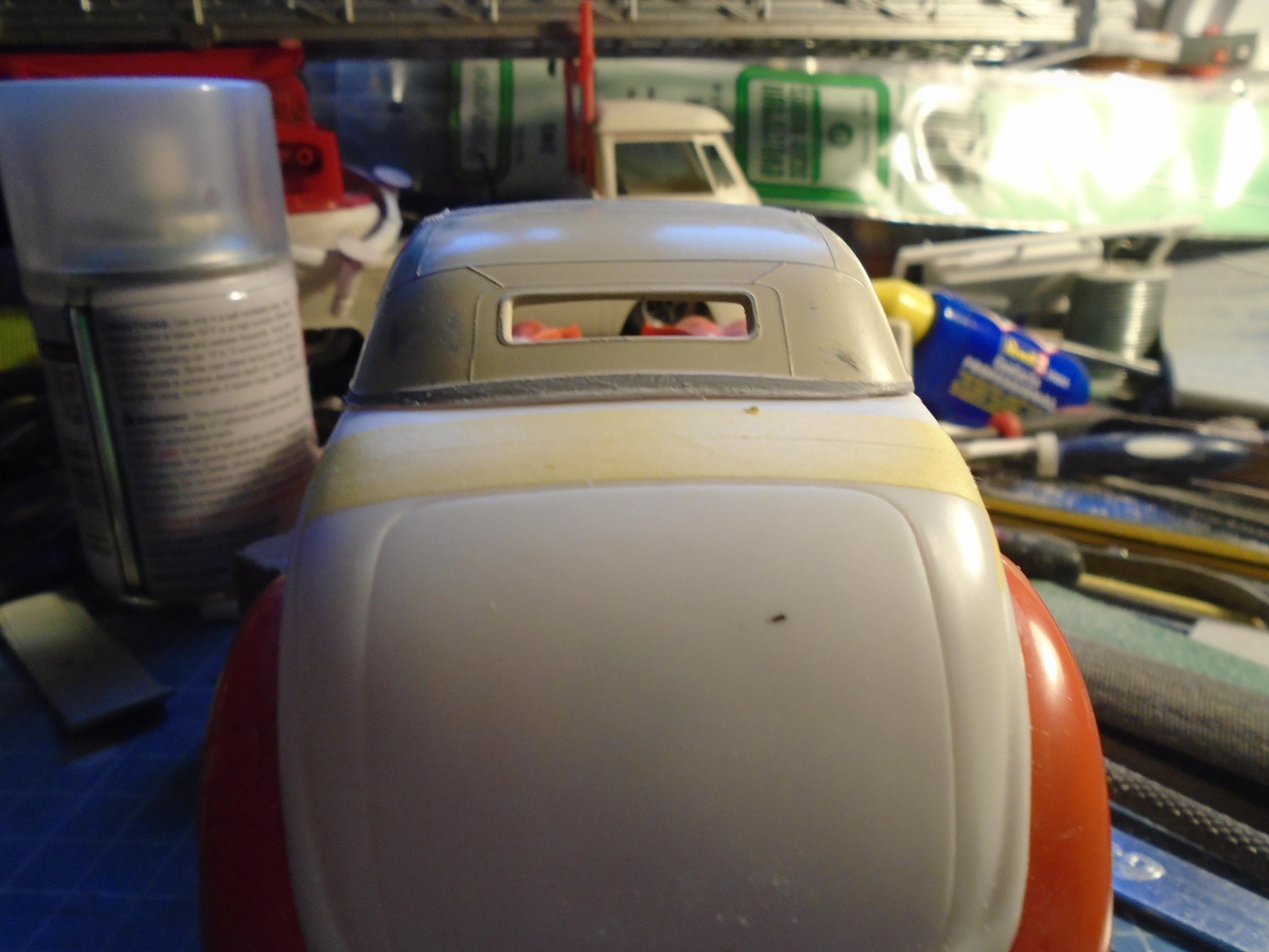

.So afte not making the finish line for the cannonball, and having numerous started builds in varying states of completion, I started another. I'm using the parts lot as it had a coupe body included along with the carson top from the amt 50 ford. its too long and its way too wide at the front but nothing a couple of slices lengthways wont fix. I started with the front fenders and briefly considered using 40 pick up ones but after studying them it was easier to mod the 37 ones. I used some left over shapes at the rear but i'll be working them to be shorter. At the front i cut the fender centre out, split it and glued it back with a spacer. This got the top shape close but the 37 fenders have a peak the 38 doesn't have, and the 38 is more bulbous. So out came the saw and i sliced along the peak and 4mm towrd the outer edge which i then filled with rod. I then built up scraps i can file back to suit. DSC03658.JPG.6f874ac4b9db4b8723c0feabfbb33c88.JPGDSC03659.JPG.6165cedbcf23365d3d40e14627952b03.JPG
