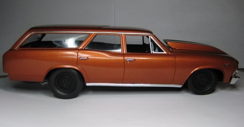

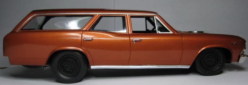

Kyle
Well I'm almost done now. I got the hood to fit and painted it. I will polish it tomorrow or Friday.

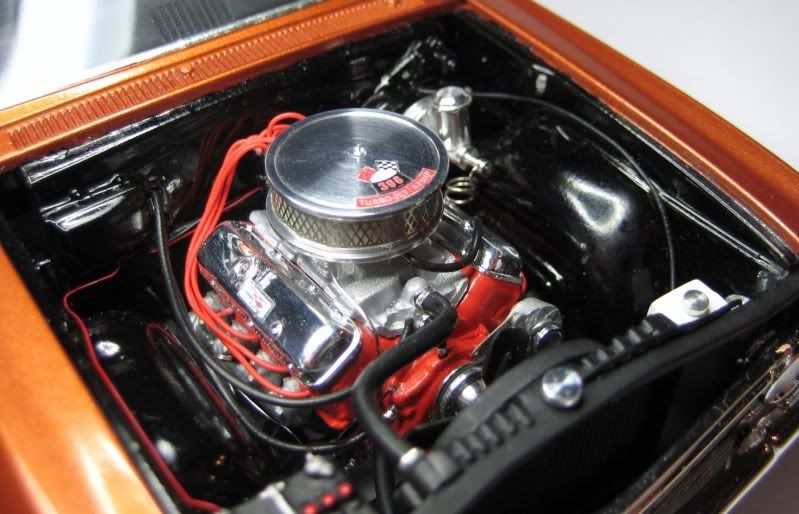

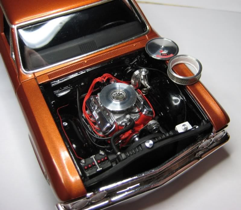

I have most of the p/e badging on. I made the air cleaner top, put the wheels on, and added a turned aluminum rad overflow bottle.
Now to just polish the hood, put the rear bumper on and make some liscense plates (any ideas for a custom plate?).
Pics.

Nice wagon! Very clean build. I can' t help myself, had to comment about the valve covers. It's my favorite issue...... :D You got the passenger side wrong. See, big blocks have an uneven number of bolts on the covers. So the side with four bolts should always go towards the exhaust manifolds. Next time, eh? Now you have two things to make better.... :D

I finished the car and posted it in the under glass section. Thanks again for all of the comments and tips!

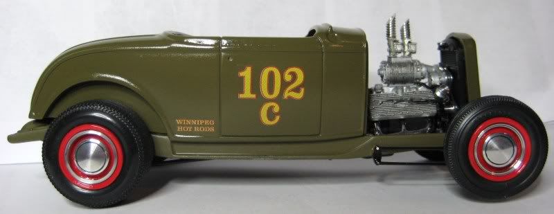

Roger - I'm not going with the hubcaps on this one, but here's a pic of some that I made for a '32 Ford. Like I said before, pm me if you need any parts and we can work something out.
