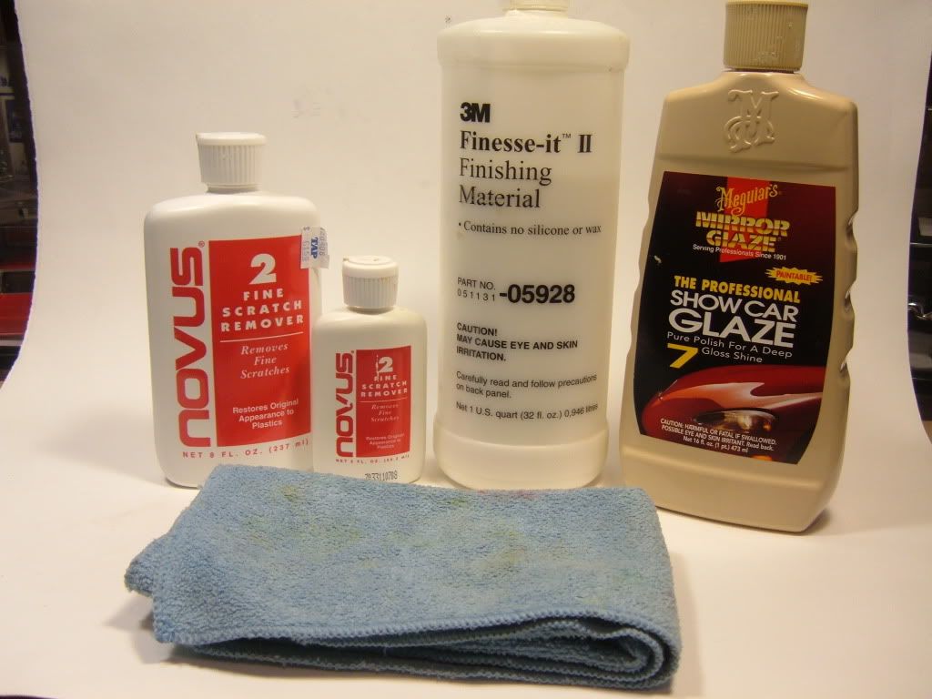

For me, Novus #2 works beautifully, followed up by 3M Finesse-it ll Finishing Material, that I get at a local auto paint and supply store.
After a week, as per the manufacturer, I wax with Meguiar's #7 Show Car Glaze.

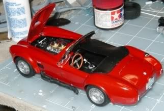

Thanks for the answers, have used Future with good results also. This Enzo I painted with Tamiya paints, it had a very mirror like finish while the paint was wet, but when it dried it got a bit dull.
Thanks again.

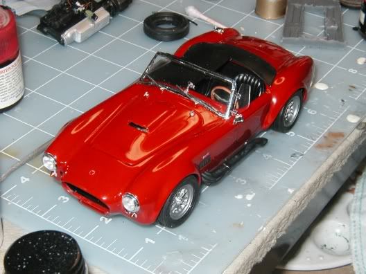

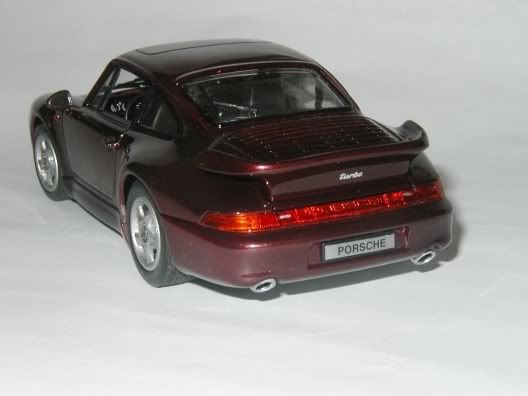

I found that to be the case with Tamiya sprays.
The red Cobra was Tamiya topped with Future.
The Porsche was Testors Enamal gloss topped with Future.

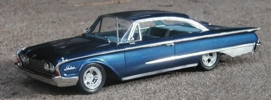

The Starliner was Testors custom mix - flat topped with Future.
So even flat base finish can be brought to a high gloss finish with Future.
