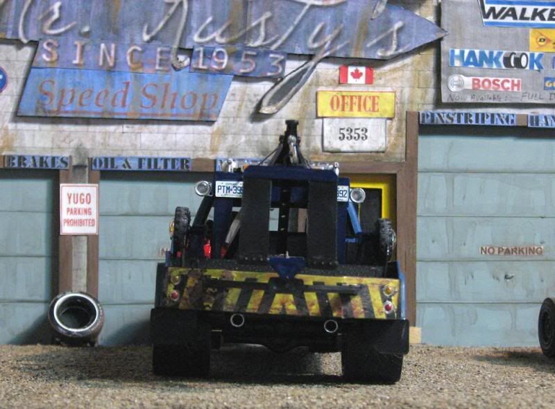

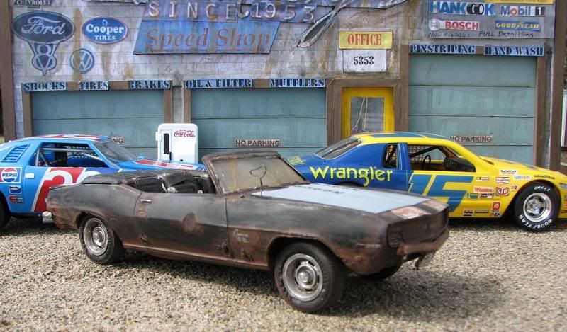

Tony T Posted January 21, 2010 Posted January 21, 2010 (edited) Here's my '58 Vette. I used a wash on the wheels, panel lines, and lower body. (The photo doesn't show this really well) Here's a Jalopy that I used more of a dirt wash, along with a black wash. Here's a '69 Camaro I did as a daily driver, with more of a rust and dirt wash, with black wash in the wheels. Ialso used some flat clear to flatten some areas more than others. The rear panel on the tow truck got more of a flat tan to show heavier dirt, and rust A picture is worth a thousand words as they say! More pics available in my album link in my signature line. Edited January 21, 2010 by Tony T
