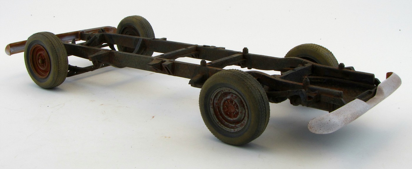

Dr. Cranky Posted February 12, 2010 Author Posted February 12, 2010 Thank you, there's more progress being made so stay tuned in for it. Getting the rolling chassis ready . ..
Dr. Cranky Posted February 13, 2010 Author Posted February 13, 2010 All right, some more progress for the night . . . The rolling chassis without any weathering in terms of powders. It's got one coat of Rustall and that's it . . . most of the effect was done with the airbrush stippling and salting . . .
