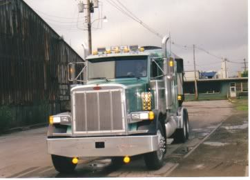

Casey429 Posted April 24, 2010 Posted April 24, 2010 (edited) Casey, wasn't your dad's a long hood 379? If so, there are several resin hoods available to easily convert the 378, move the cab and sleeper rearward, extend the exhaust and air cleaner piping, move the battery and fuel tanks back and everything should fit - just on a shorter wheelbase for a long hood. Tim Nope, dad's is a 119. He wanted an extended hood, but liked the specs on this particular truck, so he compromised andgot the short one. He grew to like it for the tighter turning radius, especially navigating some of the mills he went to, and the streets of downtown Pittsburgh. You can see the slope in the hood fairly well here. This picture was taken in 2000, when the truck was still new. No bumper guides or license plate mount installed yet. This pic is from last year. Showing a little wear, but this is a working truck. The short hood is more evident here with the more rounded grille shell. I'll need to get a set of cab lights from a 377, and track down two more square horns. Edited April 24, 2010 by Casey429

mackinac359 Posted April 25, 2010 Posted April 25, 2010 You'll need the resin low roof from Eric, the square horns (Sourkraut?) and the 377 roof lights and you're good to go! Tim Nope, dad's is a 119. He wanted an extended hood, but liked the specs on this particular truck, so he compromised andgot the short one. He grew to like it for the tighter turning radius, especially navigating some of the mills he went to, and the streets of downtown Pittsburgh. You can see the slope in the hood fairly well here. This picture was taken in 2000, when the truck was still new. No bumper guides or license plate mount installed yet. This pic is from last year. Showing a little wear, but this is a working truck. The short hood is more evident here with the more rounded grille shell. I'll need to get a set of cab lights from a 377, and track down two more square horns.

Casey429 Posted April 26, 2010 Posted April 26, 2010 I'll have to look in my Italeri accesories then! I have 2 from the Can-Do wrecker, along with the 1/2 fenders. Tim, what do I need to do to make the 119? I know you did it to the Bruce Dewey 379. Something about a pie cut section to the hood and lowering the cab. I believe you said the cab needs to come down a scale 2 or 3 inches.
Kostas Parchas Posted April 26, 2010 Posted April 26, 2010 Casey429, Your dad's 379 is very nice! Could you please send us some more detail pictures for inspiration? As far as I know, Tim has a short ''how_to'' video about to convert the 378 hood to a 379 119. wacthing Tim's video and follow it step by step you can convert the hood of the kit. I haven't try it yet, but you know as well that Tim has this gift and makes things look so easy to try.... I think that you should ask Tim to share with you the link of his video. I can't wait to see you building your dad's Peterbilt. Keeps us updated. Kostas.
