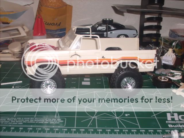

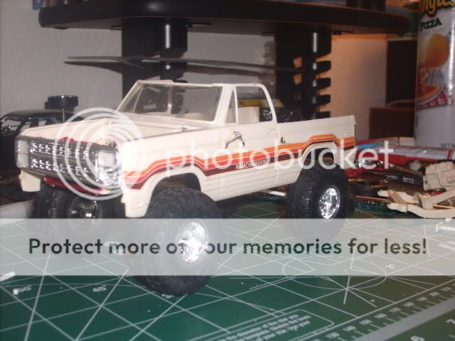

heres my new WIP it was a toss between a D50 drag truck or this , its a monogram 80s ramcharger gone fishin set that i saved from ebay ( 4.50) .. cheep.plans are as follows cut the roof off full cage , full workin jacked susp, with 4 wheel steer, on soreal 50in crawlers, motor toss for a HEMI or a 440..this will be a street crawler so no big body changes in the works....also it will have 2 aluminum dana 60s from my boy jb hobbies...the hood is not in these shots but i have already done the hood months ago it has the R/T scoop section from a 70 challenger molded on .
Edited by mopar01lee
that looks like a great candidate for a rebuild....not a lick of paint on her :D
and you say it came with a boat ?
very cool
well this is the truck that came with a boat butt it was long gone by the time i got it from ebay ,, butt i do have the gone fishin set unopend in my closet.... thank for the comment..

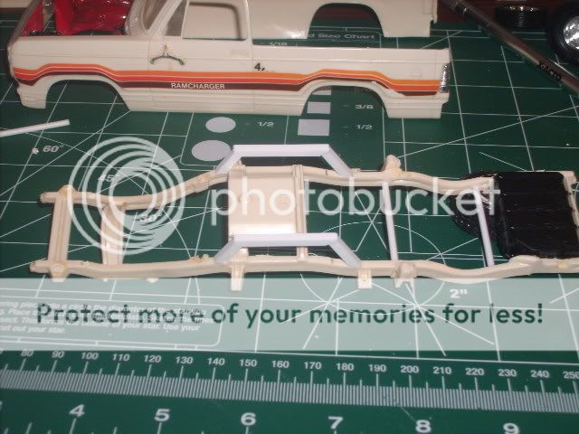

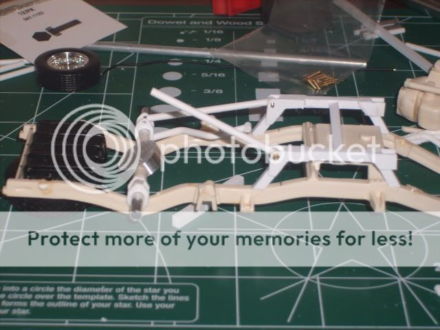

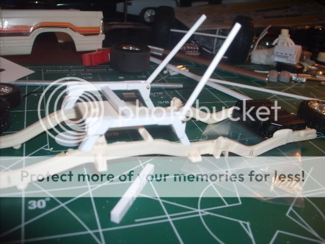

first i started by cleaning up the frame of all the unwanted molded stuff ( molded in exust ).. with that cleaned up i added some new frame rail dipps for the susp mounting points. an added some cross braces...

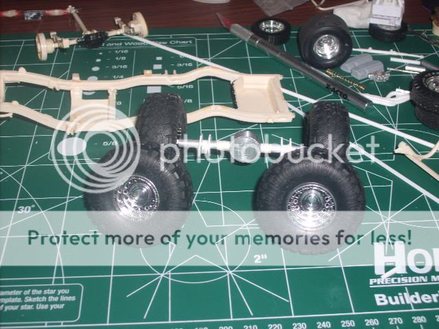

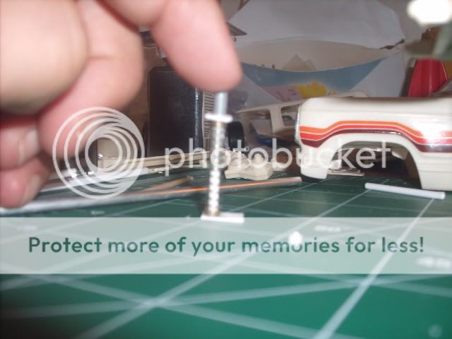

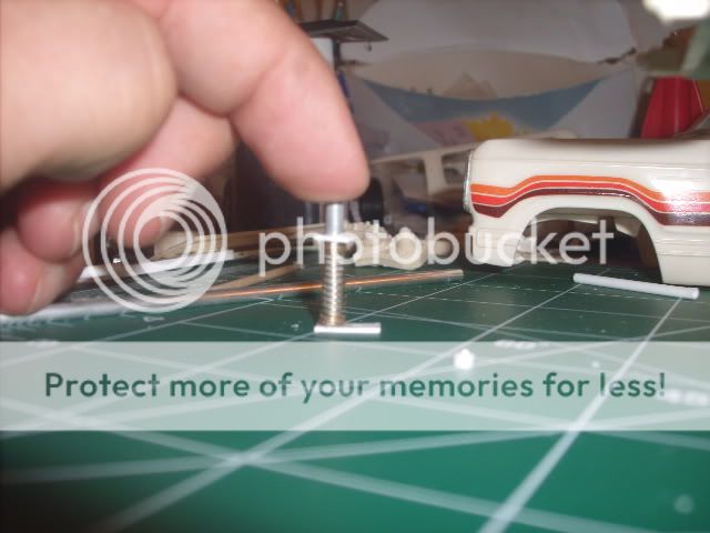

i also started to make the shocks that will be used. they are made from aluminum tube an styrenerod and a ink pen spring . there is close to 3/4 of an inch of movement or more...
sorry for the blury pic batteries went dead.... :D

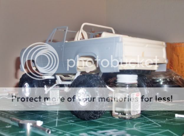

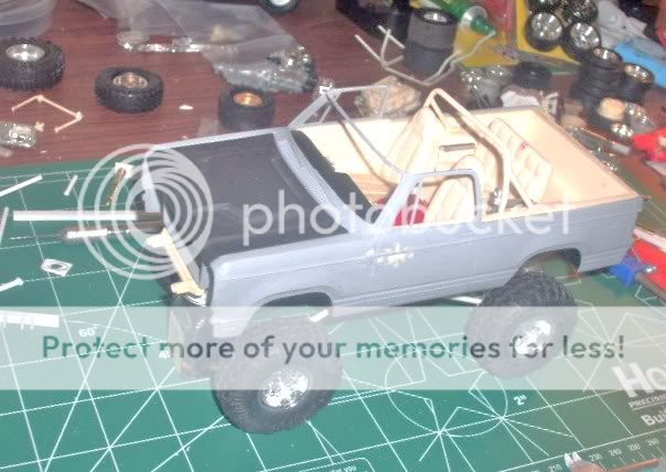

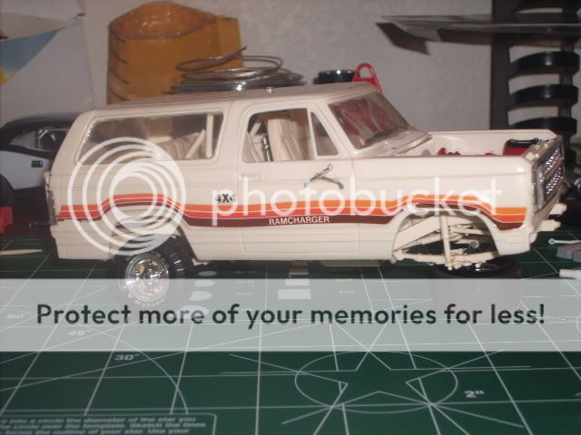

next i could not resist it mock up .. now this is not the highth of the truck it will be about 1 to 1 1/2 in higher... oh ya i also cut the roof off gotta lill more work on this.. B):D;)
Mmmmmmmmmm I'm liking that mock up , looks really nice , more please :):D

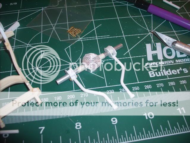

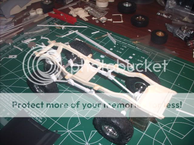

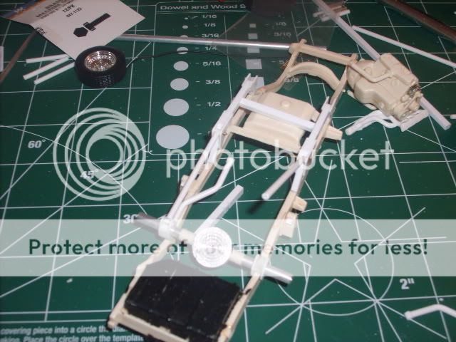

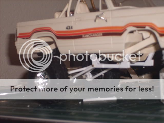

not a big update , took my kids to water park so not much done .. well heres some 4link pics these will be bolted with brass nuts an bolts... more soon i hope to have most of the rear done in a day or 2... enjoy.. B):D:D
this is the pic of the upper 4link bars...
heres a good shot of the fram with the brackets made ....

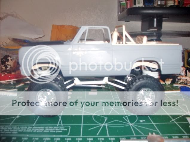

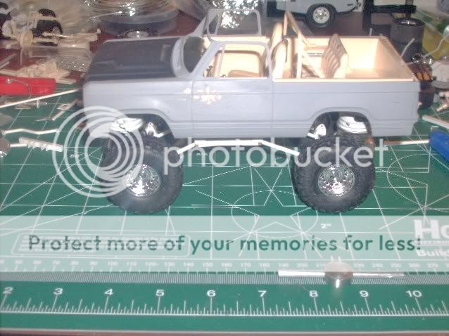

new pics ,, here is the ride hight of the ramcharger ... enjoy these pics there will be more soon......
the top 4link bars are not goin to be used i wanted them too , but for drive shaft reasons its not goin to so the top bars will look like the bottom 4 link bars...

the ride height looks perfect :) not too high and not where it's right on top of the tires.
have you thought about using a 3-link style set-up on the rear? a wishbone style upper link could work and solve the driveshaft clearance issues at the same time.

an ya ive been thinkin a 3 link but right now im sourcin somr ref pics to find the best linked rear for this build ...

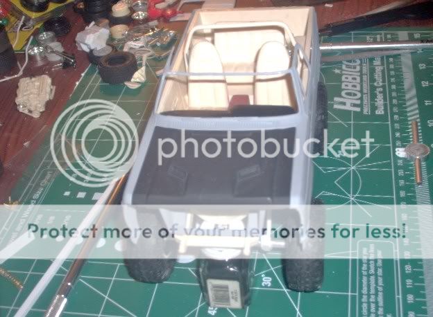

next pic you can see the hood . an also the rear diff its aluminum an has the brackets for the 3link wish bone susp im tryin to do
but with it bein alum it dont want to stay glued ,its glued for now ...lol
i started the body work . got some primmer on it to see if it had any issues that i need to fix.
to my suprise just a few glue spots an were the mirrors use to be ..
ok now i hope all you like mock up pics as much as i do cuz im realy likin the way this is turnin out..
