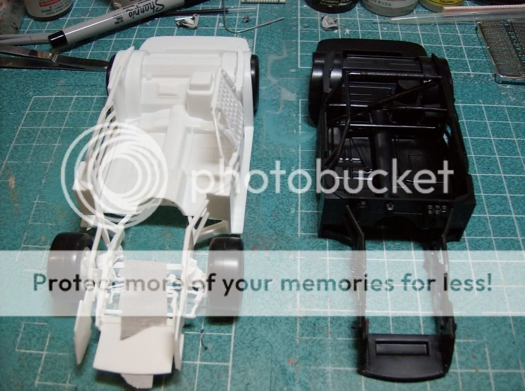

highway Posted July 23, 2010 Posted July 23, 2010 I checked out these two kits, and the Kevin Harvick car should probably be very close, if not exact, to the 06 Budweiser car. The height from the chassis to the top of the rollcage=1 7/8 inches. The wheelbase=4 1/2 inches. Front track=3 inches. Rear track=3 1/8 inches. I also compared the newer chassis to the older car's chassis, the older chassis is the same except for the width. The white frame is from the Harvick kit, and even though the rollcage width is the same, there is added chassis sides on the newer frame. I hope this helps you, and if not, give me the dimensions from the Nova (because I don't have one yet ) and I'll check some of my other NASCAR kits out and see if I can point you in the right direction. I have some older Monogram and AMT kits, and the AMT kits may work better for you, anyway, because, if I remember, the Nova is 1/25 scale, isn't it? The Monogram and Revell kits are all 1/24 scale, where the AMT kits are 1/25 scale, and the difference in scale may or may not cause a problem for you.

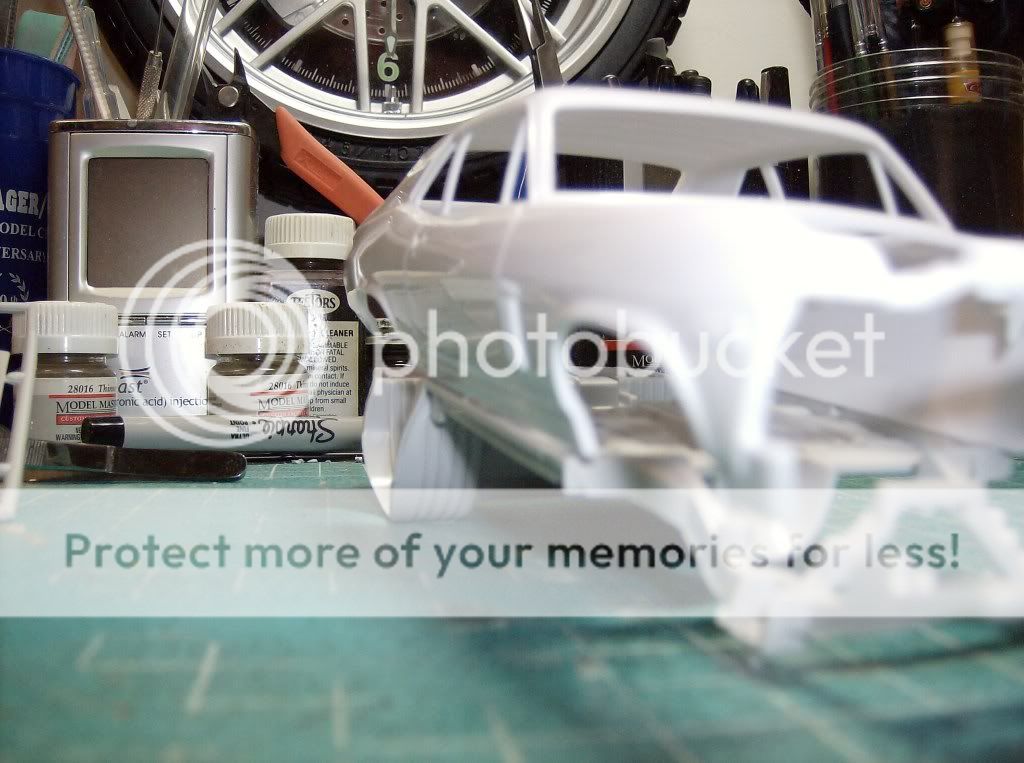

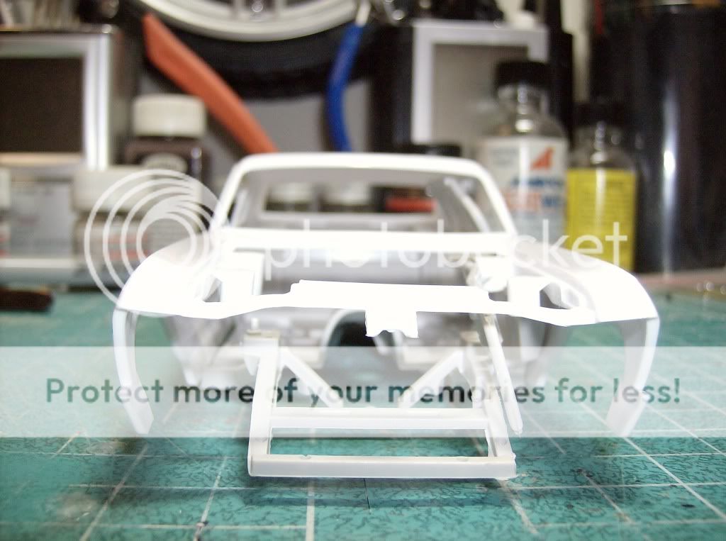

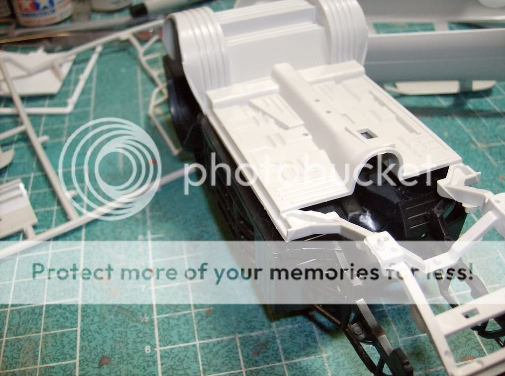

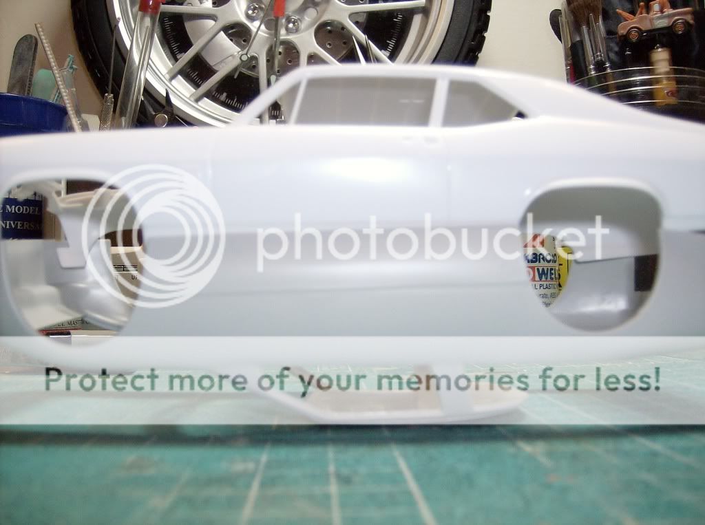

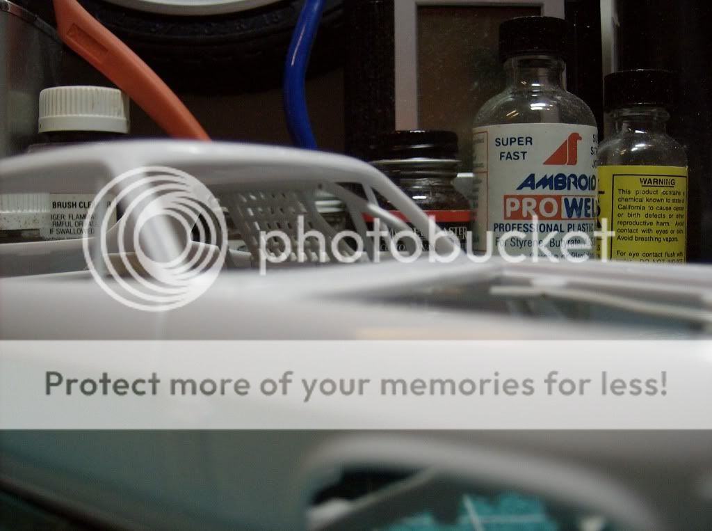

highway Posted July 24, 2010 Posted July 24, 2010 Nick, the AMT NASCAR kits would work alot better being that they're 1:25. Michael is absolutely right! I check out one of my AMT frames with my new Nova body, and I think something like this is definitely what you need. I even took a couple of mock up pics, and it looks like you may have to do some trimming here and there, but I was able to get it in the body, even though it spreads it out some the way it is unmodified. One place you would have to trim is the rear wheel arches on the frame to make it fit properly in the Nova's body. Here is an idea of the difference in the frame width compared to the body, and the difference in the thinner of my Revell frames. The difference between the newer white frame I pictured earlier, which is probably the one you have, compared to the AMT frame here is almost 1 inch! I also mocked up one side of the rollcage, and it looks to me like it would be a perfect fit. I also put the two bodies together, and wheel openings are very close to a dead on match. I hope this helps get your idea from the idea stage to the workbench, and if you need an AMT kit to build it, PM me, we'll work something out! The kit in the pictures is complete, and the parts inside were factory sealed until tonight to take the pictures!
