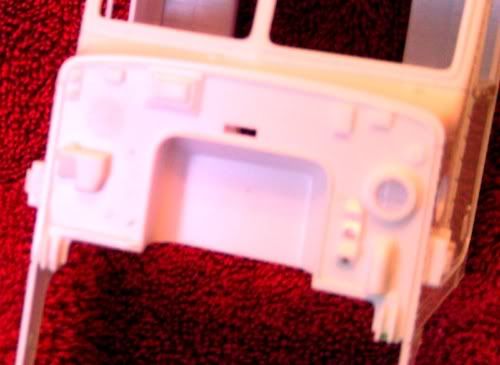

I recently purchased and started building the "New" Italeri 378. And I noticed that they seemed to have molded the firewall incorrect?
The first pic is the model cab.
The opening for the intake on the passenger side...Which I haven't opened up yet seems to be to high up the firewall?

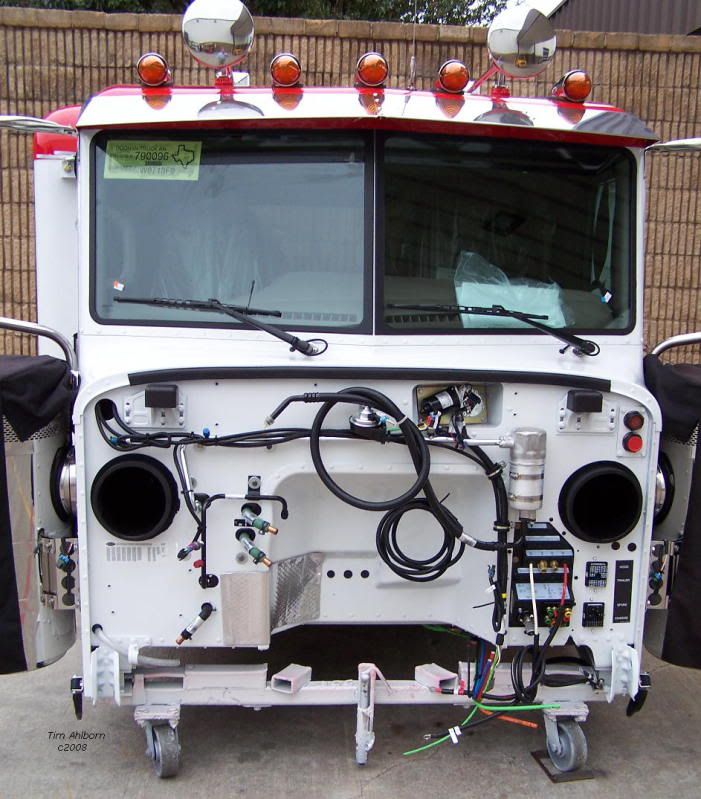

From Tim's site...

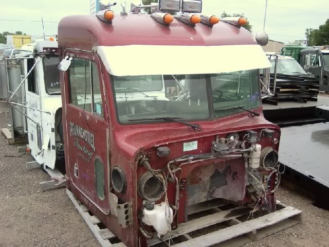

And off the web...

You do have a vailid reason for complaint as it seems the fire wall is a tad bit off, But we're modelers! Fix it and claim the bragging rights!
You're not being picky at all.
Italeri did several weird things on the firewall.. you'll note that the cover for the wiper motor is on the wrong side. The 2 access ports for wiring are on the wrong side.. it is as if they were making a mirror image of the firewall.
The cab in the photo from my site is a newer cab - the washer fluid tank is no longer mounted on the firewall.
Tim

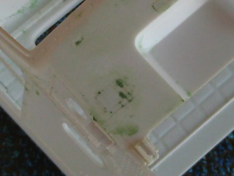

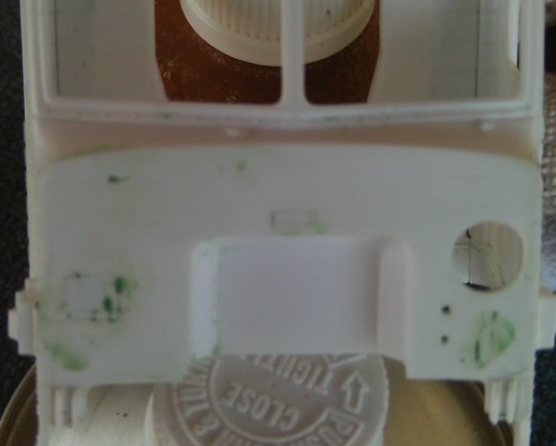

Well...after thinking it over....Here we go right or wrong!
Took every thing off...filled in the holes...You don't really know how much is missing until you get the fire wall cleaned up!

The pics on Daniel's Firewall Pics are an '08+ cab and the locations of things will be different than a pre-'08 truck.
Tim
Tim
I'm gonna need a lot of input...What I was looking at his pic's for was the placement of the hood bumpers and such. I'm not sure what year the "New Italeria 378" is...If I stick with the photo you took of the white cab on the rack and Daniel's pic's I should be o-kay? correct?
I noticed that the most of the electrical and thru the firewall hose's are the basically same between yours and his? This can be made as an '08 I hope?
Jeff
The kit represents a '95 - 04 378. In '05 the doors lost the vent window and the mirrors moved to the cowl. For '06 the window ledges slanted forward.
The firewall differences.. the windshield washer bottle moved to the radiator in later years. Extra heat shields were added. Depending on the specific truck you are building, there might be an overflow tank on the firewall. The basic firewall stayed the same.
