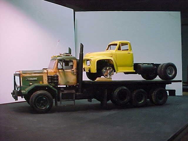

I´ve just started a another new project.It´s the conversion of an AMT ´53 Ford F-100 pickup into an Big Job F-800 truck.I´ll use the truck for my Twist´s Salvage diorama.I used the Ford F-100 Flipfront pickup for the cab,hood and fenders etc. ,the frame from an Ford Louisville shorthauler and the wheels from an Ford C-600 Stakebed truck.I shortened the whellbase to 195 inch and widened the front fenders on each side for about 0,3 inch with styrene sheet.I lowered the step and widened it to match the front fenders.I´ve done the same on the front bumper.It´s still a lot of sanding filling and glueing to that conversion.I´m still thinking about a correct engine to it. The engine I want to use for the truck was originally called Cargo King,it was na 317-cubic-inch V 8 engine.Maybe I could use the pickup engine or can someone give me an advice which engine I could use or convert into the needed one?Okay,enough words,let me see what you think about my start.
I have to add some sheet to the hood and the fenders and have to smooth all the parts for a nice look.
Thx for looking,

Looking through all my Ford reference material I can not find anything indicating the 317 was available in 1953,
I do find where the 317 was offered in 1954. I think the engine in the Ford C-cab will work and would not be considered unreasonable for your truck.
However, 1953 offered many different wheel and tire options for this truck- 22 x 7.5 inch wheels cast spoke or disc-- 20 x 7.5 inch rims and a two speed rear axle
10,000 pound max capacity, air brakes, overdrive tranny

Looks like you are off to a good start. I have plans (someday) to do something similar using the 1950 Ford.
There was an older SA article on building a 1950 F-8. In the article the builder made a 337 ci starting with a Thunderbird engine block and using parts from various other sources.

thanks for the compliments.I´ve made some little progress on this one.Made a little bit of sanding and filling to the front end and also placed the stake bed of the AMT Ford C-Model stake truck to it.I´ll rework the wood on the bed with real wood.
