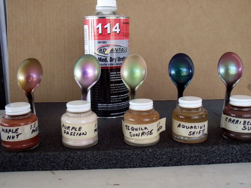

Mike Kucaba Posted September 26, 2010 Share Posted September 26, 2010 I was out of the build loop when these were intro'ed. Anyone know about a spoon test? The black base.Does that only apply to the colorshift hues? Quote Link to comment Share on other sites More sharing options...

Mike Kucaba Posted September 26, 2010 Author Share Posted September 26, 2010 When I moved to Mesa I checked out body shop supply stores for the usual stuff and came across "Space Age Paints" . I took the KK and asked the rep there about the recommended reducer.He stated that they used to sell it and had good results with a couple of different reducers. I went with his suggestions so I'll be testing( spoons) tomorrow. I'm interested in the colororshift line. I'll shoot these over the black base that came with the set and see what happens.BTW these sets are going dirt cheap on ebay, so I don't have a big investment in any of it. Quote Link to comment Share on other sites More sharing options...

Mike Kucaba Posted September 26, 2010 Author Share Posted September 26, 2010 >What were the couple of reducers he recommended to you? I am going to try lacquer thinner, even though they are enamel, I had heard that it would be quite effective< The reducers are made by Advantage. He recommended either the #114 Med. Dry Urethane reducer, and/or the #112 Fast Dry Urethane reducer. I bought a quart of each for about $7.50. I'll do a test today on spoons with the Med Dry reducer. Quote Link to comment Share on other sites More sharing options...
Mike Kucaba Posted September 27, 2010 Author Share Posted September 27, 2010 >What were the couple of reducers he recommended to you? I am going to try lacquer thinner, even though they are enamel, I had heard that it would be quite effective< The reducers are made by Advantage. He recommended either the #114 Med. Dry Urethane reducer, and/or the #112 Fast Dry Urethane reducer. I bought a quart of each for about $7.50. I'll do a test today on spoons with the Med Dry reducer. Quote Link to comment Share on other sites More sharing options...
Mike Kucaba Posted September 27, 2010 Author Share Posted September 27, 2010 OOPS forgot to mention pic in previous post! Quote Link to comment Share on other sites More sharing options...
