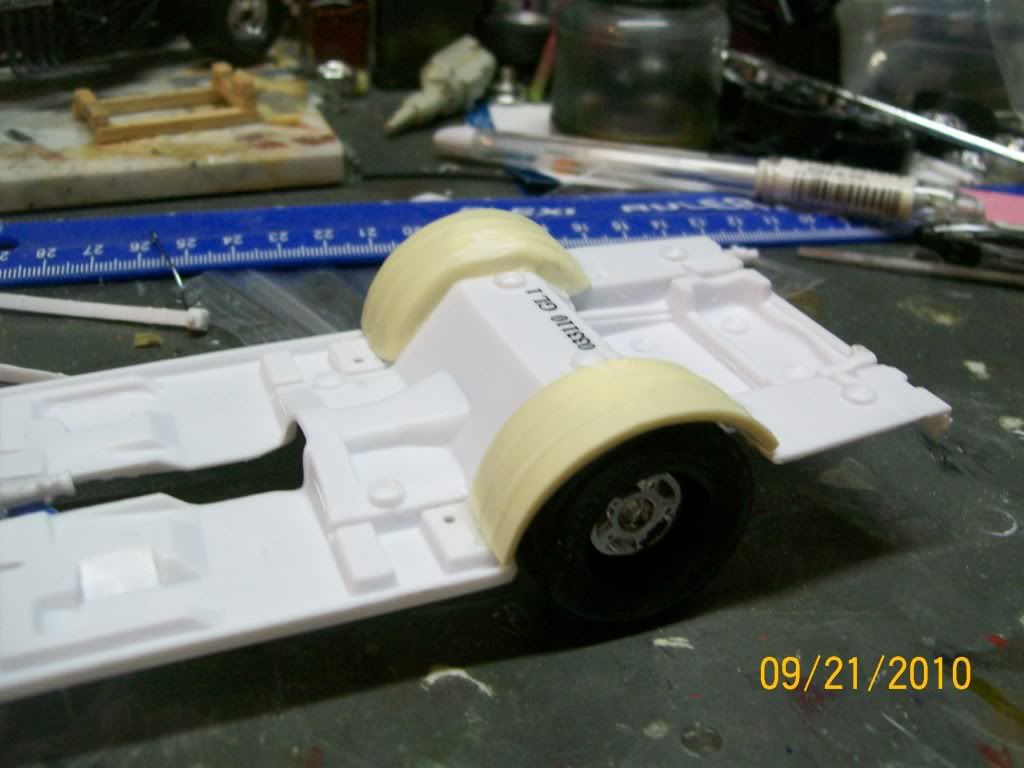

So I wanted to fit a bigger than stock tire under the car with out going the whole pro street route with big silly tubbs and all....

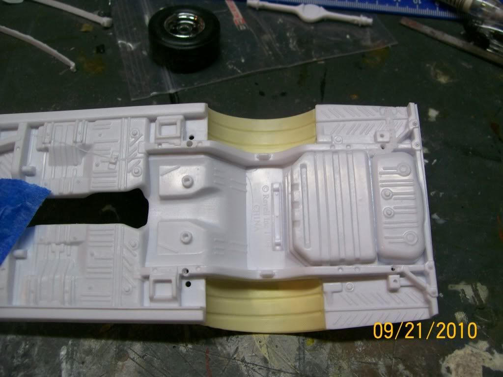

So I took an old resin back half that I had doing nothing and cut the tubs free from it, and added them to the 67's Chassis.
This way I could use the slicks and and rear end from the HEMI Dart kit....

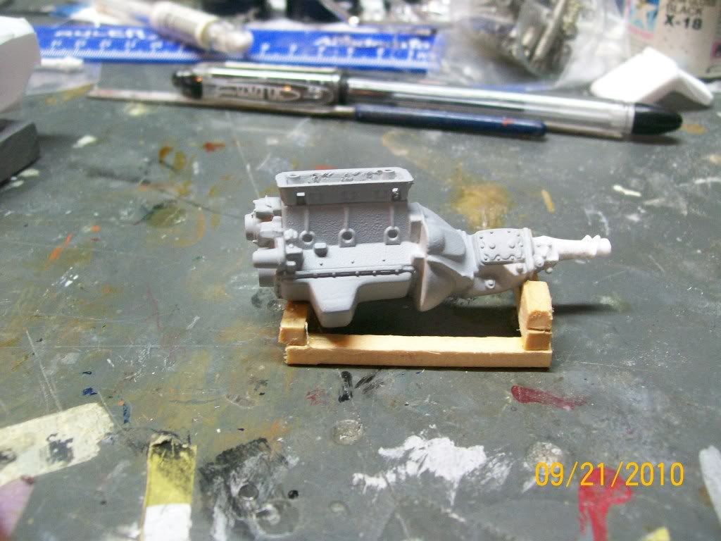

Next I decided that I may need a bit more oil capacity on a street racing HEMI so, I extended the sump on the stock oil pan like a lot of the junior stockers used to do...

Len are ya gonna hafta mod the interior to fit the tubs? I think them big ol tires look alot better when the interior isn't chopped up. Looks good so far!:D:angry::D
Len are ya gonna hafta mod the interior to fit the tubs? I think them big ol tires look alot better when the interior isn't chopped up. Looks good so far!:lol:B);)
George,
The modifications to the interior wont be noticed, I only had to shave the bottom of the pacakge shelf, and if I was more careful, I would not have even broken through. I took a thin sheet of styrene, and made a new floor. Anyone will be ahrd pressed to notice, with the flocking and paint on it...Well, back to the bench....

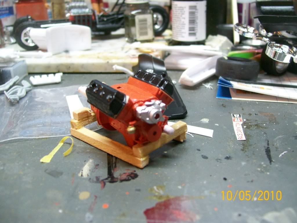

Started doing some of the preliminary paint detailing on the engine. Drilled the plug holes in the rocker covers for some rubber boots. First coats of paint on the oil filter and the fuel pump. Forgot to drill the pump for a fuel line prior to painting...

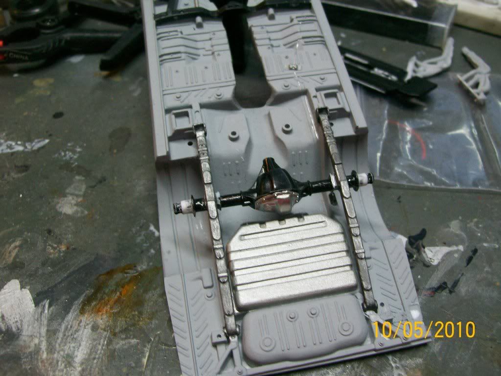

Last but not least, here is the DANA rear end from the HEMI Dart kit installed in the Charger chassis, along with the "mini-tubs" I added.
I also started the interior door panels and flocking the floor. I have a lot of little things getting in my way on this build, for example my Aztek airbrush finally took a dump, after upteen years, so I need to send it back and have it repaired. On top pf that, I am waiting for a couple parts too...
