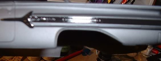

Is this the look you're going for? (a nice, shiny dark chrome look that is not as bright as regular chrome)
if that's the look you want, then you'll need to spray whatever chrome parts you have with Testors transparent black (window tint black), this:
The Black Chrome from BMF is this, and it's not transparent:
Just trying to help, since black chrome is not the same as solid black B)

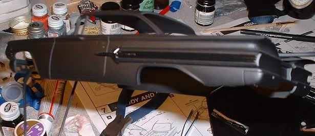

Here’s the chrome painted with Testors Gloss Black, that I painted last night.
The Testors Transparent Black was hard to come by, spent my lunch today tracking a can down. I'll let you all know how it turns out and what I decide to go with.
