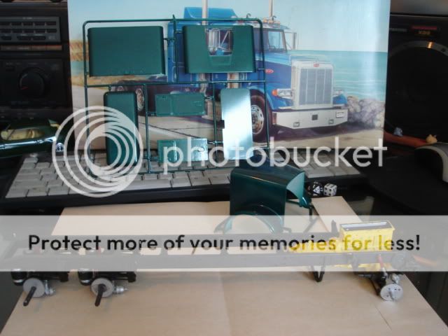

Hello. This is my first try at building a big rig. I started this model last year when recovering from surgery .
I really like all the work you guys do.

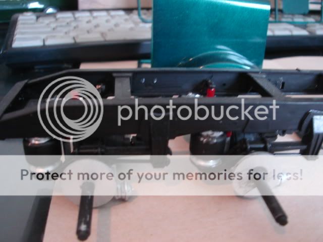

This is what i have started so for. I have the Italeri truck add on pack. so I will make a diamond plate headache rack and rails.
Comments and tips are always welcomed.
Thank you
Thank you

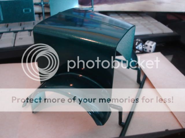

Looking Good !!! Paint work looks very slick. I like the color, what is it ???
Thanks Porky .
The color is Testors Model Master GM Emerald Green metallic straight from the can.
Looks good so far. Don't forget to paint the underside of the hood and fenders the matching green.
Tim
Thanks Tim. you are the master love all of your trucks your scaled shop and your website. Thanks Tim. I was wondering about that since its fiberglass. My uncle mentioned about stanless steel Fenders on the front Did Peterbilt have those?
The entire hood would be painted - underside and all.(see attached pic). On the aluminum hood models, there are sound deadening panels under the top of the hood and the fenders can have a plastic rock liner (matte black in color).
The polished aluminum fenders were on the special edition "379X" and looked really cool.

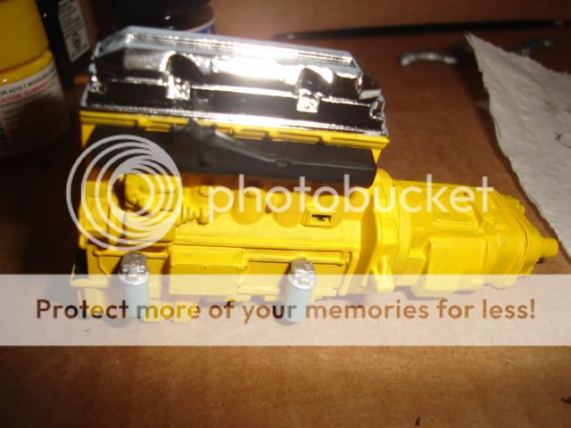

Since Watching paint dry in not fun. I Pulled this baby out of the bin to start working in the engine.
This is what I have so far. Waiting for more paint to dry.
Thanks for looking.
haha! you got it wrong! that is a detroit series sixty motor and if you want an accurate one its gotta be that alpine green not caterpillar yellow/...unless you want to consider it a c series? :lol:
Sorry Bandit....Alpine green isn't even the correct color for that engine series........Most likely would be blue/gray color of the 60 series....could even get by with silver from the silver series 60...I'm just sayin'.................Matt
tamiya x18 is pretty close to the "green" its suppose to be!
sorry its not alpine green but its....DETROIT GREEN!
Alpine green is correct for 2 stroke detroits...the 60 would be detroit BLUE.....which is actually blue gray.............Matt
thats cause you know that im not a detriot person but i am a sucker for kitty power! :lol: :lol: :lol::wub:
