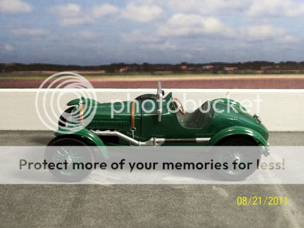

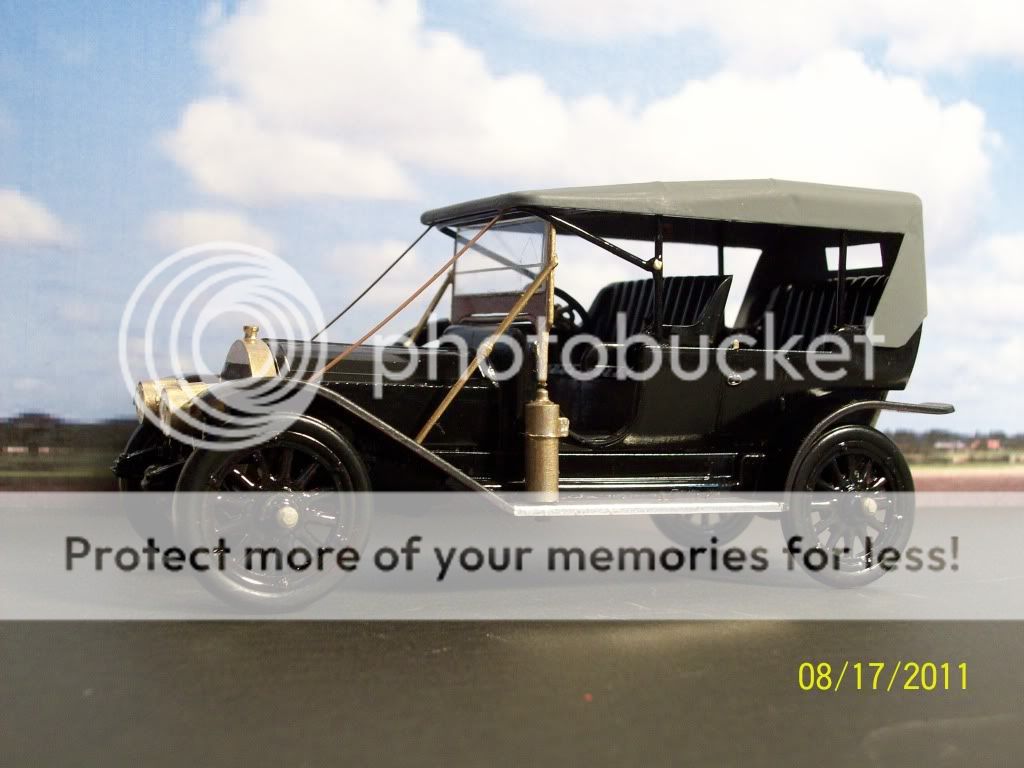

Grey sandpaper is the easy way to go for me. Here's a couple of examples:
180 grit (no weathering done on this one
80 grit (lightly weathered)
It's so simple to apply. I use LePage's carpenter's glue spread thinly on the base and then use some telephone directories to hold it in place for a few hours until it dries. You can stain or weather it to suit your needs with thinned out acrylic washes, sand the surface in the direction of travel for a worn look, or add tire tracks in heavy travelled sections.... whatever you dream up!
