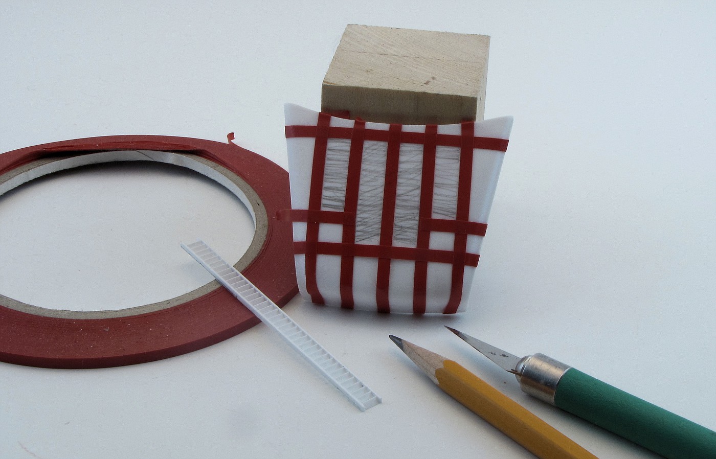

Dr. Cranky Posted February 25, 2012 Posted February 25, 2012 Steven, you need N gauge ladders from Plastruct. You can find them on line or through your LHS. Here's what they look like when they are finished: And here view . . . You have to work slow and take your time, and they'll probably look a little rough, but you can smooth them out with a little putty.
blazefox Posted February 25, 2012 Author Posted February 25, 2012 Ok so you cut the holes in the hood then make a slanted stack of louvers the place them inside and glue. Then putty to smooth?
