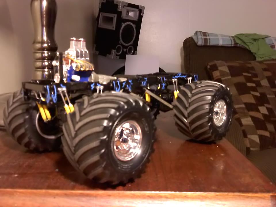

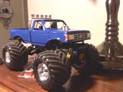

lvnlwd Posted May 31, 2012 Posted May 31, 2012 been 3 weeks and alot of research to make this kit...... custom made fuel lines, throttle linkage, and shifter, also added pinstripes on frame the assembled pic is a dry fit while body paint cures before i do decals clear coat and metal foil..........
Trans Am Erik Posted May 31, 2012 Posted May 31, 2012 Lookin great! Most people wouldn't notice the pinstripe detail on the frame. Old monster trucks were real showpieces.

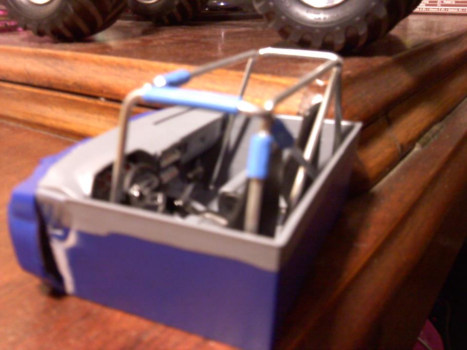

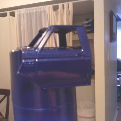

lvnlwd Posted May 31, 2012 Author Posted May 31, 2012 went to hobby store and well.......found a closer color match for body......its repainted lol....de ja blue

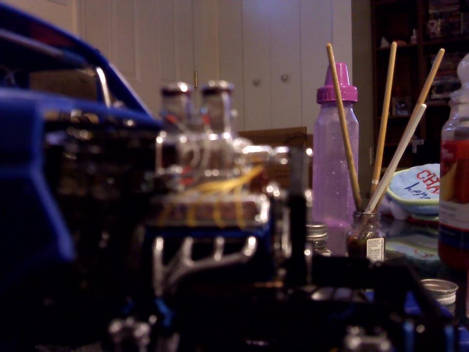

Fat Brian Posted June 1, 2012 Posted June 1, 2012 (edited) You did right by going for Bigfoot 3 with this kit, it's closer to 3 than it is to any other truck. Still there are some issues though. First, Bigfoot 3 had an engine with Boss heads for its entire lifetime as a competition truck, you can always tell 3 from 4 or 6 and 7 by the Boss heads since they had regular 460 style heads with Bigfoot cast into them. The engine in the kit is totally wrong, it's an FE family engine (390,427,428) with 385 series (429, 460,514) valve covers intead of being the correct 460 based engine in the actual truck. Second, the non-planetary chrome wheels in the kit were never used with the body in the kit. Around the same time that the truck was rebodied with the 87-92 style body it was also updated to planetary hubs like Bigfoot 4 had. It wouldn't be very hard to make the correct hubs since the hub faces used were just flat pieces of steel with eight or ten bolts around the edge. Here is a great source for monster truck photos, almost every truck ever made is shown here although some of the sections are a little disorganized: http://monsterphoto....com/gallery.htm Here is a link to a history of Bigfoot 3: http://www.bigfoot4x...f3_history.html Here is a pic of Bigfoot 3 with the original body showing the Boss valve covers and the non-planetary chrome wheels: Here is a pic of Bigfoot 3 with the body in the kit with the planetary hubs and white wheels: Here is a pic of Bigfoot 3 today. It was sold as an almost bare chassis sometime between 2000 and 2004 and was robodied and repowered first as the Dixie Thumper and now Legend. Edited June 1, 2012 by Fat Brian
lvnlwd Posted June 1, 2012 Author Posted June 1, 2012 in my pic of 3 with the small truck beside it it dont have planetaries it was taken just after rebody.....and as far as the engine goes you are right but it does match another bf so i just made it like that
lvnlwd Posted June 1, 2012 Author Posted June 1, 2012 the kit is a mix match of 3 and 4 ....amt just used the same frame from the bf 1 kit ....im just trying to make the best of it without to much scratch building

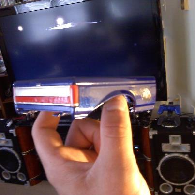

lvnlwd Posted June 1, 2012 Author Posted June 1, 2012 beds been foiled and tail lights on may foil the ford on tail gate instead of painting it
lvnlwd Posted June 1, 2012 Author Posted June 1, 2012 there is a pic of 3 on dennis tafts album that shows the motor that is in my kit!!

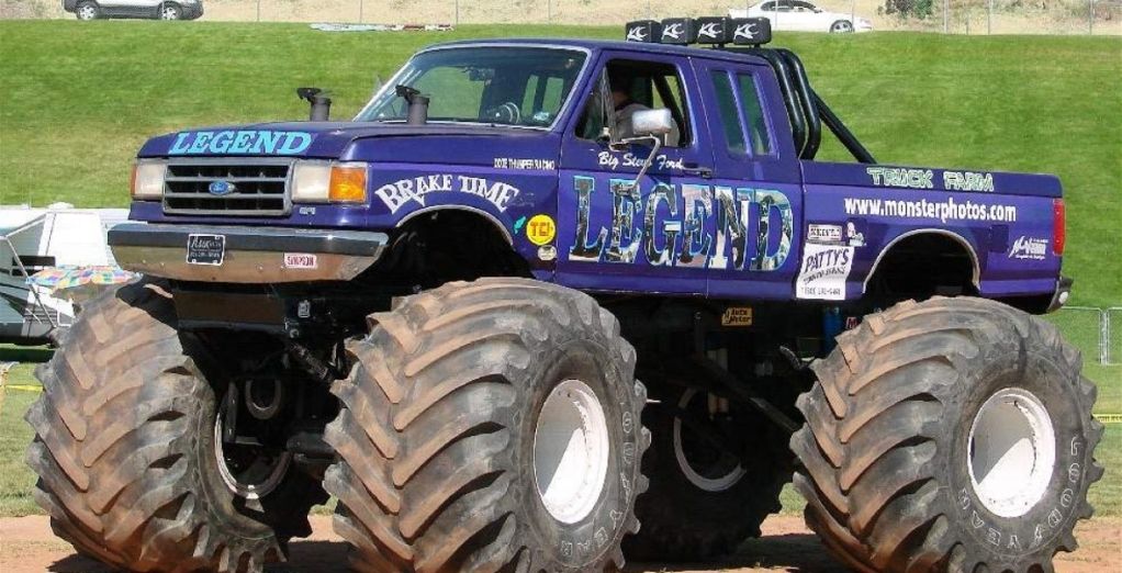

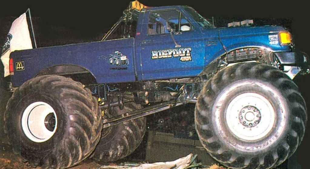

Fat Brian Posted June 2, 2012 Posted June 2, 2012 Unfortunately Dennis doesn't know 3 from 4 from his own behind, half of the pics he has listed as 3 are 4. The tell is that 3 has a drop in the frame under the cab because it used a strengthened stock truck frame where 4 used the straight frame rails from a semi truck. Look at the frame right under the rear corner of the front fender of the first pic compared to the same spot on the second pic. The first pic is 3 the second is 4.
