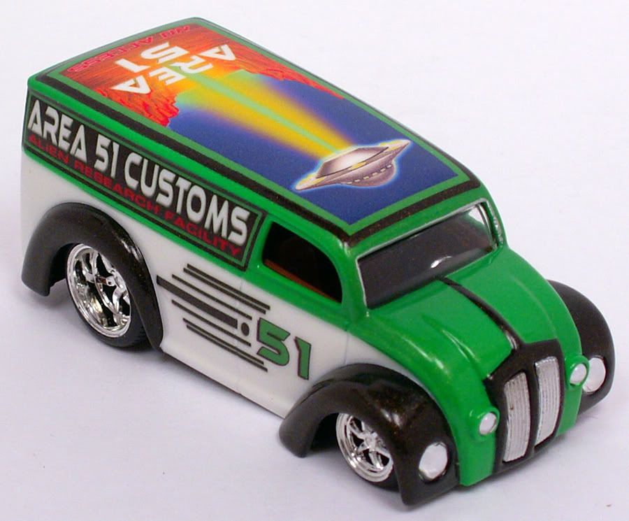

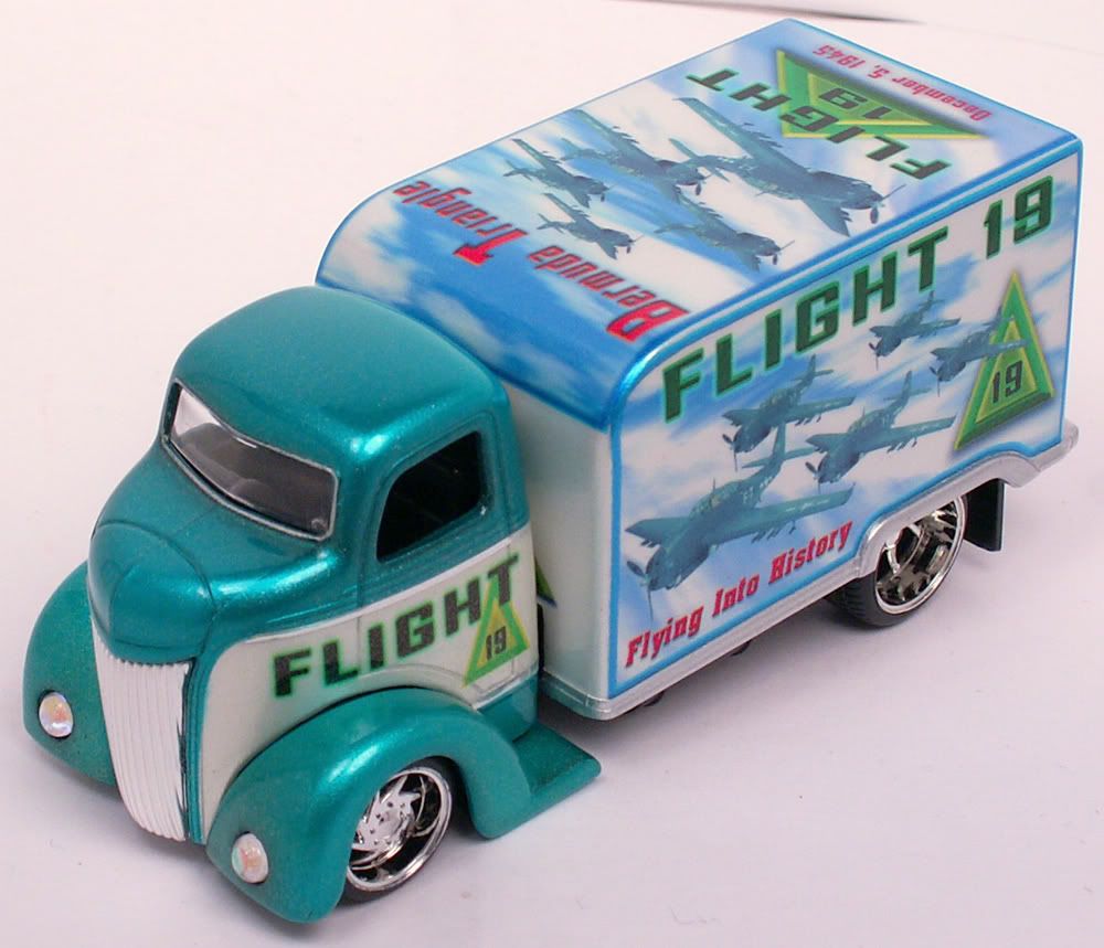

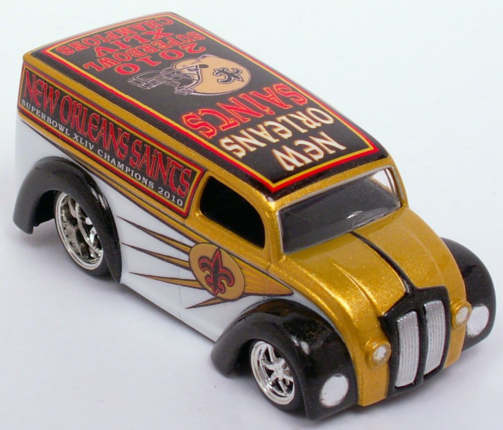

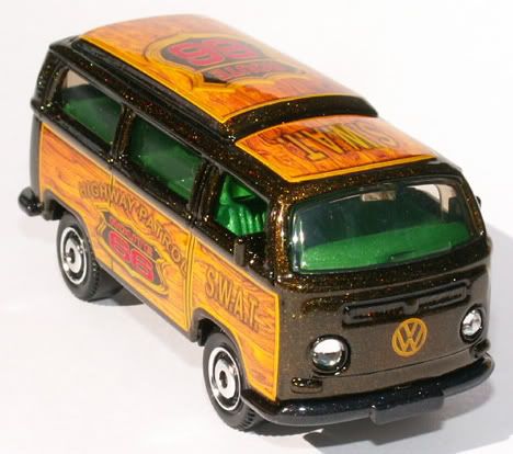

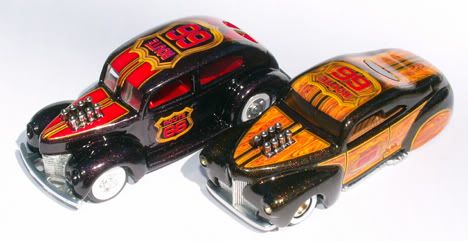

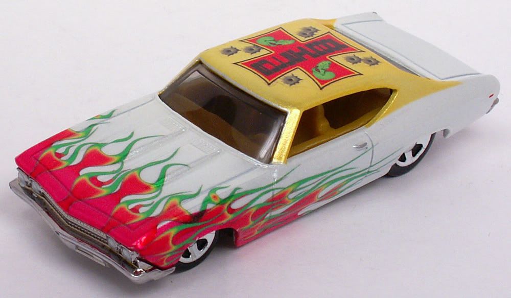

Here's a few shots of my Decals over House Of Kolor Paint,
I lay down my Decals over basecoats, over candies, even under candies for ghost effects, and all are clearcoated with House Of Kolor Urethane Clear.
Using my CadillacPat Ovens I can Clear over my Decals in 45 minutes,
All Products Used Are Exclusively House Of Kolor, Of Course!!!!!!!!!!!!!!!!!!!!!!!!!!
