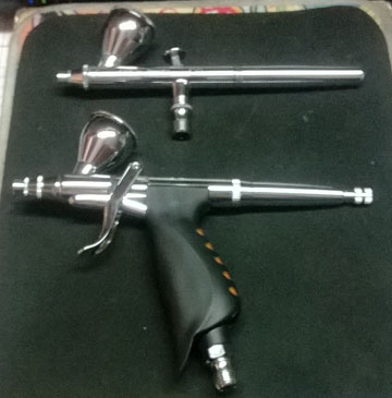

questions on the Iwata Neo
fatkidd replied to Mrdarkmonkey96's topic in Model Building Questions and Answers
As I stated above, I have run House of Kolor, DuPont, PPG, etc through my NEO without ANY issues. I've even sprayed 2 part clear through it, without ANY issues. -
The NEO TRN I is a true gravity feed where the TRN II is a side feed. But, to answer your question...no, it isn't a fan spray. I do own 2 Iwata Kustom HP-TH fan spray airbrushes that I use almost daily. -
which NEO did you get? I have the TRN I (trigger style gravity feed) and the CN (gravity feed). The TRN I comes with PTFE seals and is safe for solvent based paints. I'm not sure what the CN comes with, but I have used mine with solvent based paints (House of Kolor, Nason, DuPont, etc) without a single issue. -
