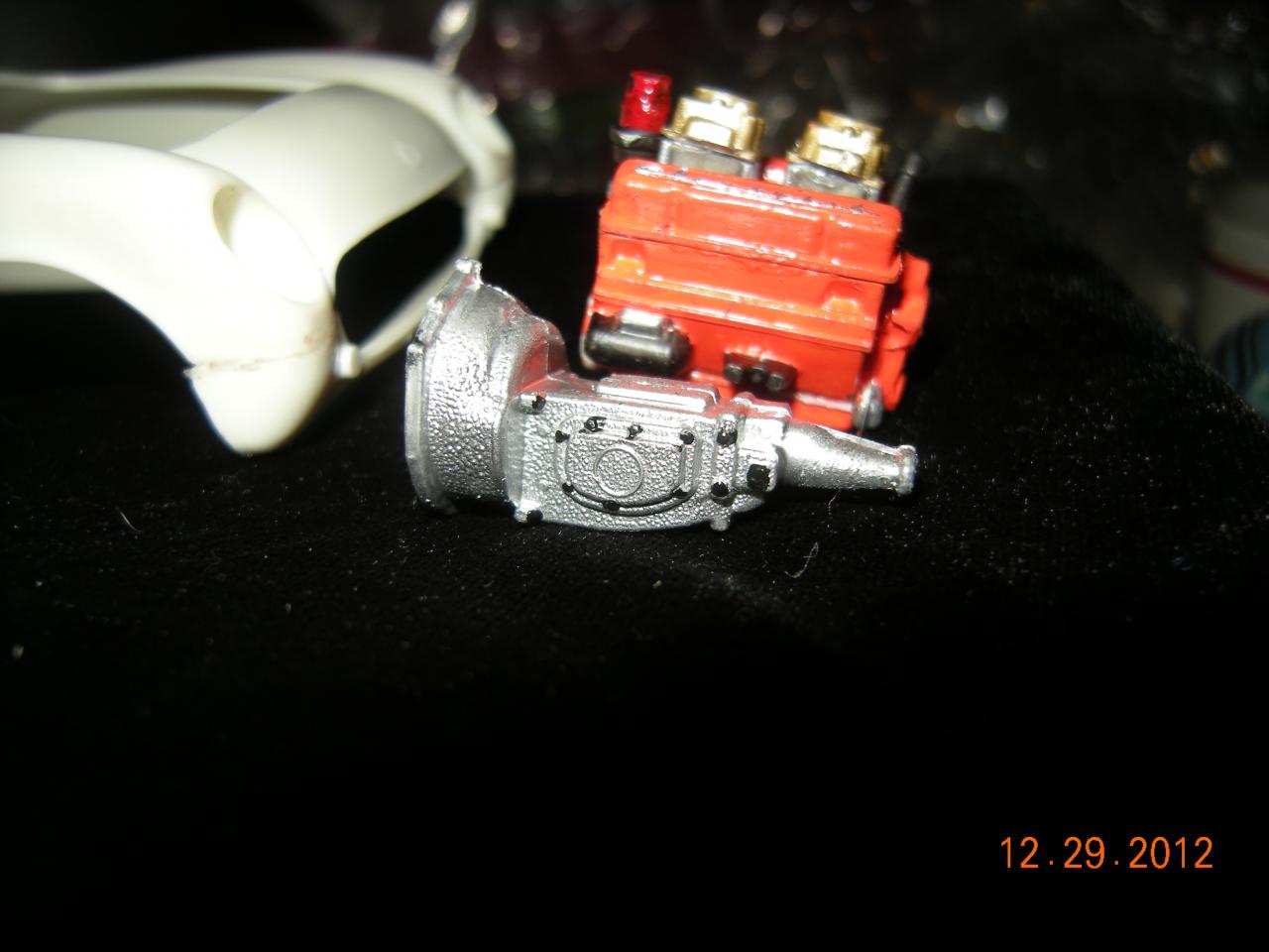

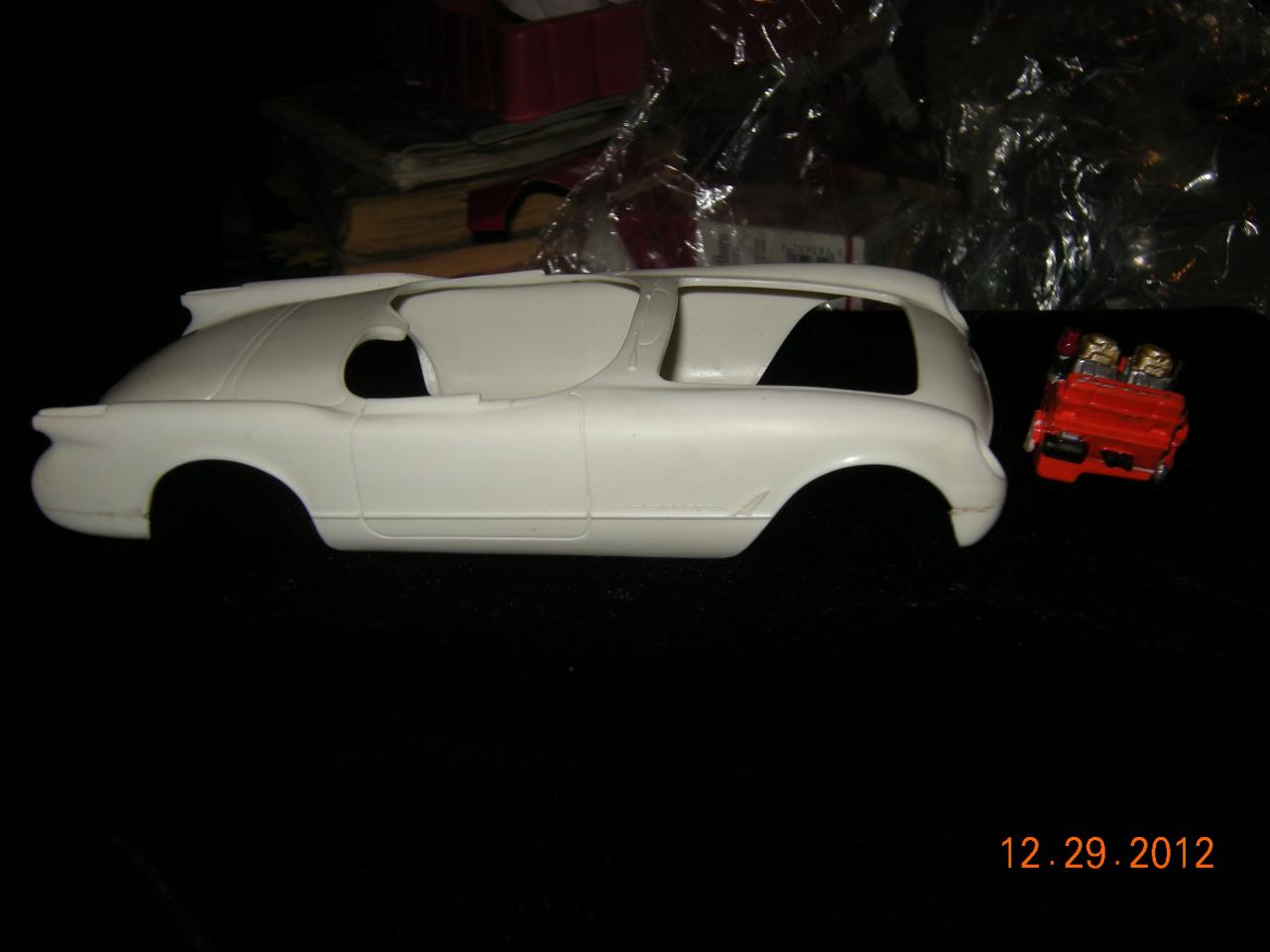

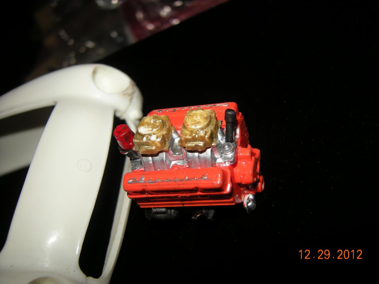

I like the way you handled the script on the engine. I've built this kit a few times and there are some issues. The front sits a little high for me but, easy fix, relocate the spindles upward by cutting them off and regluing them, or turn them up side down. The windshield is a horrible fit and may require some trimming so the dash fits right. I think it was designed to be fully assembled before paint. I've ran into a few problems with things fitting after paint and would suggest assembling as much as possible before paint, like the chassis and interior. There always seems to be a problem getting the rear wheels centered in the openings, i would suggest leaving the rear springs unattached until you have the axle exactly where you want it. A lot of people have said the side trim appears to go up hill. On one of mine I trimmed the front fender off a little at the bottom behind the wheel opening, this seemed to help to my eye. Hope that's not too much information, I just get excited when I see someone building this kit. Hope this helps and doesn't confuse you.
thanks for the tips il be sure to do some more assembly before paint still cant decide on a color so if u have pics of yours i could use some ideas

I LOVE corvettes, and it looks like you're off to a great start. Are you planning on wiring the engine? I have a '60 vette that I built a while back and it has some of the same problems that Ron mentioned. But they are a beautiful car. Next on my list is an '82
looks great the real cars all had the same slope to them so i think il leave it on this one but definetly gotta do something about the ride height gotta get it lower

it was my first try at wiring a motor the wire was something I had laying around from one of the rc cars a better job next time
